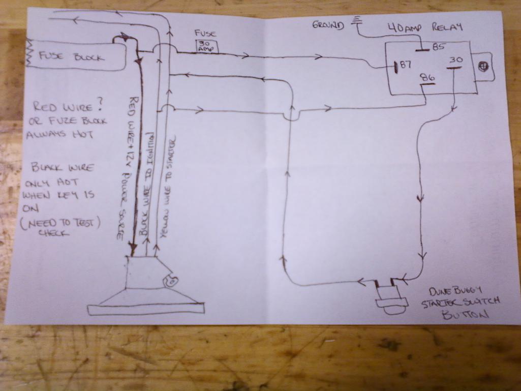

I have had several ignition switches fail in m 1973. I am on the third "new" ignition switch in 4 years. I think these are a repro part and not up to the original standards. What usually happens is either the ACC does not switch on so the fuel pump does not run or the starter does not switch on leaving me stranded. Are these 3 position switches or just 2? Does anyone have a diagram for how to wire a switch for the ACC and a starter button? I notice there are 6 terminals on an ignition switch module so I assume this is not simple. I would keep the key just for unlocking the steering column and maybe rig a second, hidden switch for the fuel pumps. So far my engine has been very reliable and it has always been electrical problems in the relay board (now thankfully removed by Joe O'Brien from Series9) and the stupid ignition switch that have caused my car to not run. Thanks, John |

WLD419 Hello John, here's a diagram of what I did for... Mar 31 2015, 03:57 AM
jim_hoyland Does the yellow wire going to the original ignitio... Mar 31 2015, 06:40 AM
WLD419
Does the yellow wire going to the original igniti... Mar 31 2015, 08:54 AM
Bartlett 914 I think this is a good case for the "hot star... Mar 31 2015, 09:50 AM
patssle I'm using this push button...it handles the am... Mar 31 2015, 10:45 AM
FourBlades How much load is on the accessory part of the swit... Mar 31 2015, 12:12 PM
