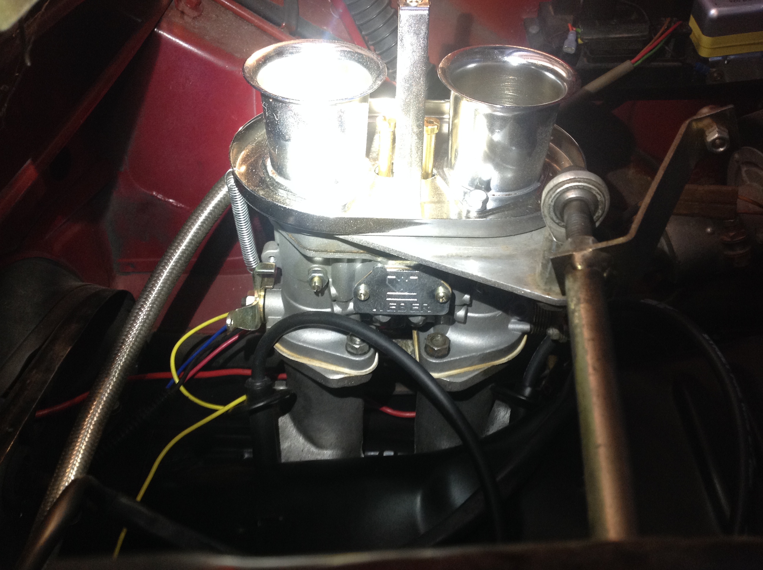

Following up on my emulsion tube issue this week:
These carbs were purchased from Webercarbsdirect.com and were represented as genuine Webers.
They are not. They are Chinese knock-offs.
The retailer refuses to take them back.
You've been warned!
Do everyone a favor and spread this around to help others from getting screwed.
Series9
post Apr 9 2015, 08:18 AM
Lesbians taste like chicken.
Posts: 5,453
Joined: 22-August 04
From: DeLand, FL
Member No.: 2,602
The only thing on the carb that says "Weber" is the cover plate and two stickers with "serial numbers":

From Bud Pauge at Redline Weber (apparently the real deal):
Joe
I will send you two each F11 e tubes
but I will note
these are not Weber Carburetors, These are one of two versions
Note one you did not send any pictures of your Carburetors and those numbers you mentioned are not Weber identifeing or production reference numbers.
I believe you have if you see a weber logo cast on the carb body it will be on a Flat side of the carburetor.
the other side of the carburetor will be rounded.
These are alternative branded Webers assembled from parts of no identity or known manufacture and assembled in the Edlebrock Weber production plant in North Carolina. They are not a Genuine European Weber Product.
Im sorry to give you this bad news.
Weber Carbs direct is not a direct importer of Weber Carburetors and more commonly supplys Chinese alternative product and supplies them as Weber with out any real note that they are only Weber like they have never seen the inside of a Weber Production facility.
At one time when there was an issue with Weber Production ( at one time the plant was closed for just over a year due to a labor issue) during this time they recived permision to offer alternative product. This time has ended Weber has been back in production in Spain and has been producing product at there own plant now for 8 years.
This has been the plant of supply for Weber for nearly 20 years now.
So pending your pictures to confirm I am wrong you can confirm if you note a flat sided carburetor with logo cast on the flat side or no logo anywhere other than a round sticker the serial number is just there way of selling the belief you have a real weber give it a serial number it must be real.
again Im sorry for your issue
can I ask are you a Worldpac customer or is series 9 a worldpac customer
If the purchase was under 9 months ago you could return them as not as ordered required Genuine European Webers.
At this point they are what they are.
Should at some point you have other issues or lack the performance expected from a Weber we understand the frustration in good faith you thought you had a Weber. We will offer to sell at redused cost a Genuine set because we did not import or sell these alternative carburetors we cannot exchange them or sell them below cost.
The bad news is if they are the chinese Copy they are selling them at weber like prices ( you would have to confirm what you paid ) but commonly the square sided US carburetor is something like 100 dollars a pair less in value and the chinese ones to give you an idea of how they are made are a full 100 dollars a carb less expensive you can usually purchase a chinese conversion kit for something like 450 to 499 not more than 600.
The flat sided carbs I believe are also in the 599 range.
In the future please be aware, Redline fuel managment and WEber Carburetor conversions is a division of Worldpac. Redline has been a Weber direct importer for over 45 years. I personaly have worked for some form of US direct importer for weber for over 55 years. We currently are one of only two world direct distributors of Weber Carburetors .
We have been supporting and supplying only genuine Weber Product. We do manufacture our own adapters , linkage parts and specificly calibrated and set up Weber Conversion kits. When we supply a carburetor in a conversion it has been opened float levels checked and set and today a specific calibration change for the current emissions fuels
you note your in Florida the pump fuels in the south east are blended to meet emissions standards using up to 18% blend alcohol /or ethanol as an emissions supplment thus it is not posted on the pump. I have worked very closely with some of the chemical team at Joe Gibbs racing and would suggest in there studies to creat there new fuel additive line the Engineer Lake Speed Jr has found that in just the mid atlantics over the last year there have been no less than 167 different fuel variations all with Oxygenated or alcohol related chemical additives. Which is why like Lucas fuel additives Gibbs now supplies a line by the name of Driven fuel additives and fuel stabalizers.
Many of your customers have noted mood swings in there cars you will find weber carbs will wake up some times over night and simply run like Sh---- and you may have just performed a tune up. the fuel swings can be over night.
So with that
in the future if we can help with your shop Weber needs tuning guidance and any tuning and install information we are glade to help
I will note that the carburetors you have at best may as well be a Dellorto you can tune them to function they will run the car.
What they will not do is tune to the same fine detail and if we use lap time as a reference to function quality they simply will not get with in 1.5 seconds of a weber tuned car. ( tuned right that is )
Several companies were given the right to use the license to copy a Weber
Solex, Dellorto, Mikuni, even the SK made in japan for Toyota. each make a nice looking replica. Back to back on any given sunday a weber application will simply out perform all of these applications.
Our frustration is there are people out there that simply take advantage of others a domain name is not a registered legal name. Weber carbs direct is not a registered business name it is a domain name because of that many people think they are purchasing a real weber from us and are simply purchasing from an importer and packager that is not related.
I am very sorry for what might be bad news
I am interested to hear any comments you might have observed. and any pictures of the carburetors and the serial numbers or other details you might reference..
WK288 is not a Redline carburetor conversion
;I am very interested to confirm any numbers from the carburetor base and any pictures you might be able to offer.
I will send out the e tubes because at this point you believe you have a Weber. We can deal with that fall out down the road.
Thanks for your input comments and I hope future support of Genuine Weber Products
