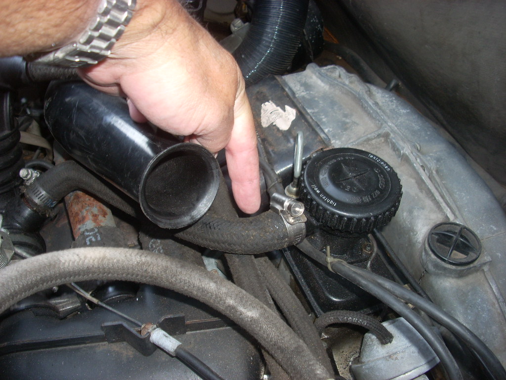

I drove the car fine this morning. This afternoon when I started it, there was a loud "bang" almost like a backfire sound, then the motor died and wouldn't restart.
Upon inspection I found that the hose from the oil filler (see attached pic) had completely popped off, on both sides.
I reattached it and added some hose clamps. Now the car starts, but idles VERY roughly and when I press the gas the revs don't increase at all.. the car just stalls.
So, what should I be looking for here?
1974 1.8, FI.
Thanks!

Backfire may have killed the AFC unit.

i was told not to clamp those hoses,as backfire will blow them off,if clamped more serious damage may happen

OK, thanks for the tips. I'll take the clamps off.

Pull the air flow meter off the intake and see if the flap in it opens and closes smoothly. If not, you've found your problem.

Air flow meter damage does sound likely. I tried starting it again later in the day and it started right up. But the idle kept jumping all over the place... running rich, then lean then rich, then lean...
I found the following on AutoAtlanta's site:
"The 1.8 air flow meter often fails when a cold engine lean backfires, warping the sensor flap. this warped flap sticks in the bore causing a rich mixture and an idle that goes away as the engine warms. replacement is the only solution, however it is important to cure the lean running engine that initially caused the problem, change the gas flooded oil and never again depress the accelerator pedal when starting a cold engine."

As to what the others have already posted, your air flow meter is junk. This happened due to a backfire, which then caused the flap within the airflow meter to warp. With the airflow meter flap not moving correctly, your fuel to air ratios are all out of wack. So, this too is my diagnosis of why your car now runs shitty. To take this cause and effect scenario to the next stage, we need to figure out why your car back fired to begin with, which is usually caused by vacuum leaks.
I personally know this game all too well. Back in high school, I had a huge vacuum leak due to a big crack on that rubber S boot thing and was waiting for AA to mail me a good used one. Months went by, so I made due by taping this crack with many rolls of electrical tape. I went thru 3 perfectly good air flow meters (on my dads credit card (IMG:style_emoticons/default/happy11.gif) ) with this taped up S boot. Tweeks made some good money off of me during those years, till I finally got a better S boot.
