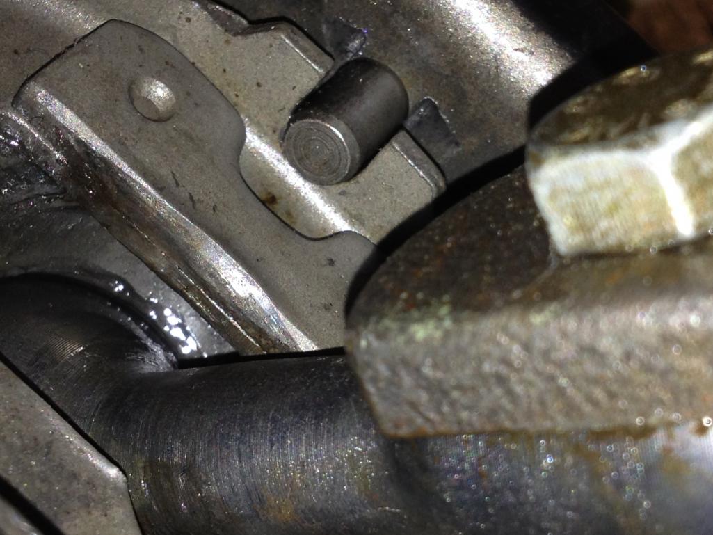

I decided to replace the ball socket on my 1970 shifter . I didn't realize the plate springs were under so much tension. I haven't found a way to put them back.
Any body have an idea ?Attached Image

mepstein   Leather gloves. Safety glasses vise grips. I used ...   Apr 27 2015, 04:09 AM
jim_hoyland   There is an easy way, i recently did it. Forget ex...   Apr 27 2015, 04:49 AM
saigon71   Oh yeah...good times with those springs! I pu...   Apr 27 2015, 05:55 AM
maf914   It can be done, but what a pain! I launched t...   Apr 27 2015, 07:03 AM
rhodyguy   Put one end of a spring near a hole. Push one of t...   Apr 27 2015, 07:22 AM
bdstone914   Cap'n Krusty replied to a thread explaining to...   Apr 27 2015, 07:22 AM
Brian_Boss   First off, if you are not holding the housing in a...   Apr 27 2015, 09:55 AM

pgollender   Thanks everyone: With the advice given, I found it...   Apr 28 2015, 03:18 PM
