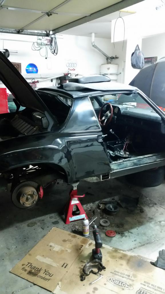

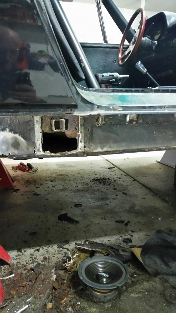

Looks like a good car, right? Gandolf had recently redone the engine and trans and shift linkage and, in fact, it runs and drive really nicely. The trans works well also. After it took 3 weeks to get the car from MN, I was pretty excited, and I already had a full 5-lug conversion ,sway away axles, 17" Fuchs, new tires, konis, Boxter brakes from Rich Johnson, etc sitting in piles waiting for the car.
Car arrived late Wednesday and I drove it, cleaned it up and parked it in the garage. Yesterday afternoon, this happened:
LeftCoastErik
post May 14 2015, 09:59 AM
BADPNNY
Posts: 173
Joined: 23-March 15
From: United States
Member No.: 18,555

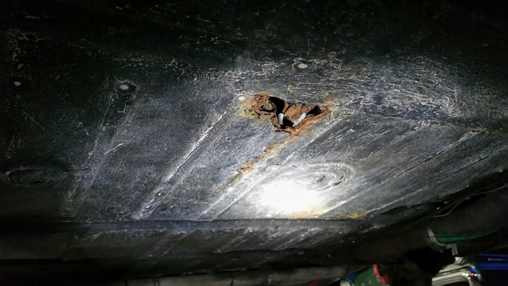

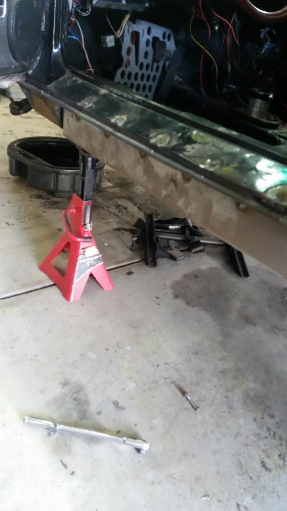

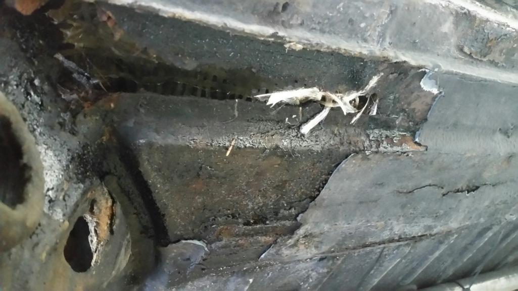

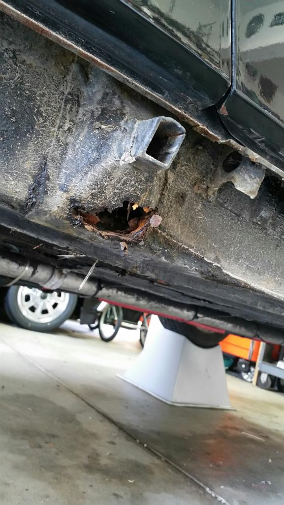

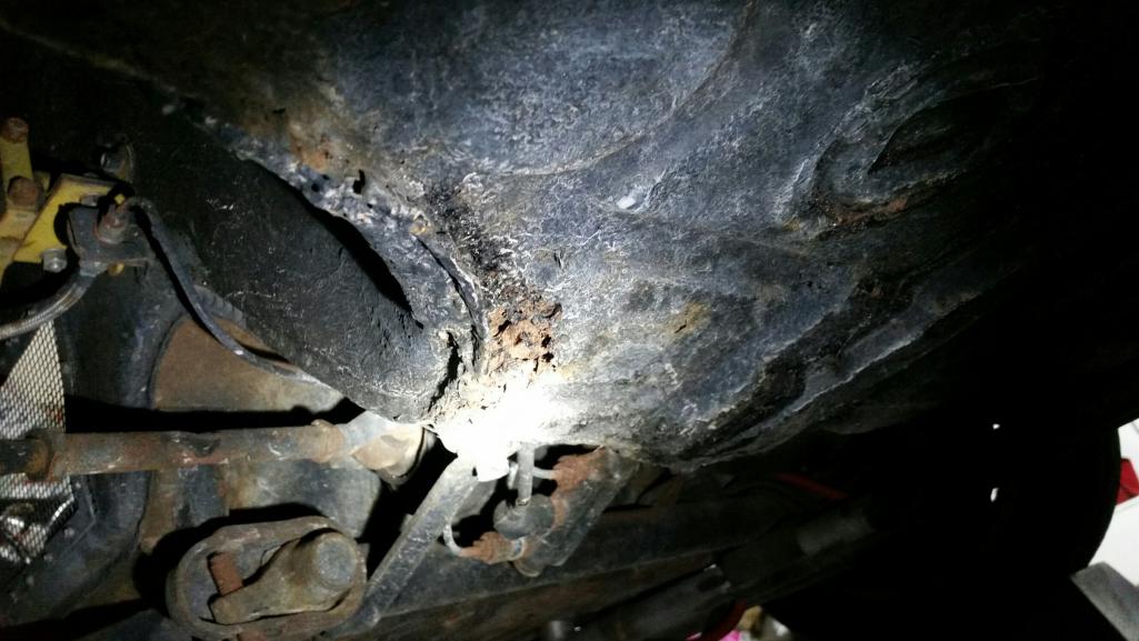

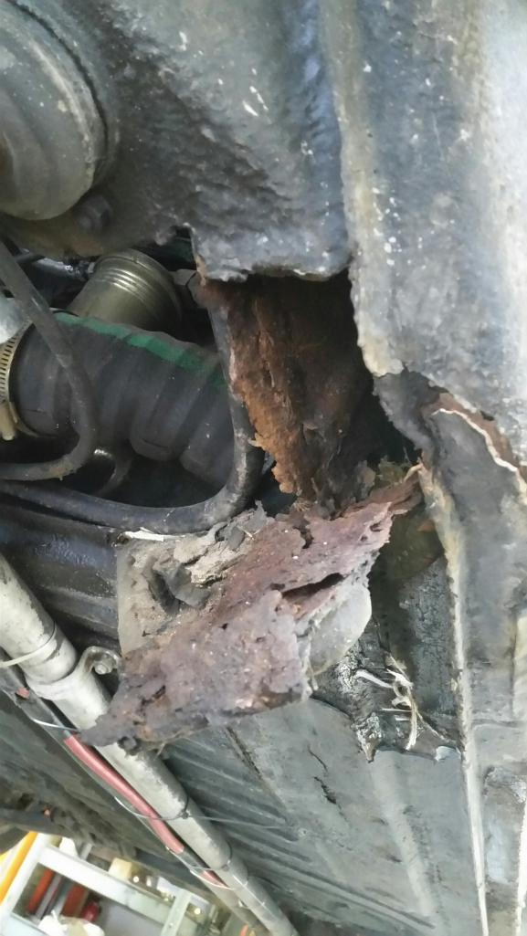

I yanked the rockers and my heart started to sink a little. I NEVER buy old cars without looking at them first...I made an exception in this case and it bit me in the ass. In Gandolf (steven)s defense, he did nothing except the mechanicals on the car when he had it and barely drove it. BUT, the rust is pretty ugly.
Hell hole is good (probably because the car was converted in 1984 and the battery moved to the front trunk). BUT the long is hammered, as is the passenger jack point. The inner long is surprisingly OK. Front of passenger footwell is separating. Pedal box has some rust, drivers inner fender and master area have been repaired from an accident, I imagine. Drivers tub is pushed up some, but not wrinkled. Passenger rocker area was poorly repaired with fiberglass and was holding water. I found standing water under the floor mats and seats. Passenger quarter is separating from the sail panel (fixable)
Also, the front fenders are molded into the cowl, so they have to be cut out. I have QRS GT flares and front end to install in the car, so that is on the list also.
Its a good running car with some nice parts, but its kind of a mess compared to the 73 I just restored.
Wiring was a mess, power windows only sort of worked. Extra gauges were old school and one of them was arcing on the subwoofer installation..Arggg...
Anyway, teardown happened in one night, so today I get started on installing Brad's Long kit, the gt chassis reinforcement and a bunch of patch panels.Attached Image Attached ImageAttached Image

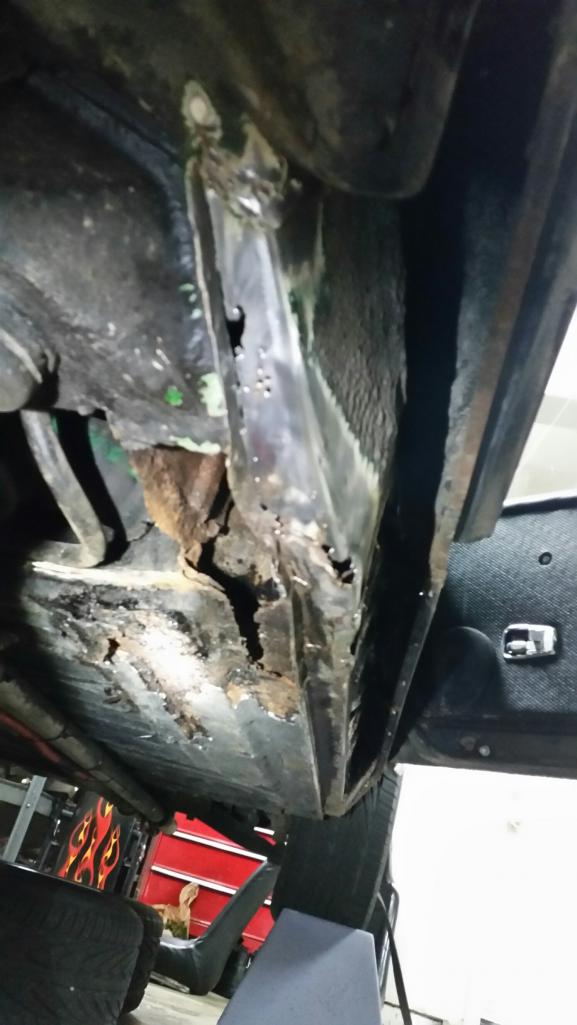

More picsAttached Image Attached ImageAttached Image

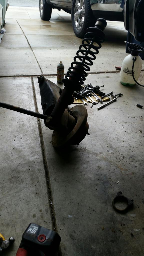

and some more

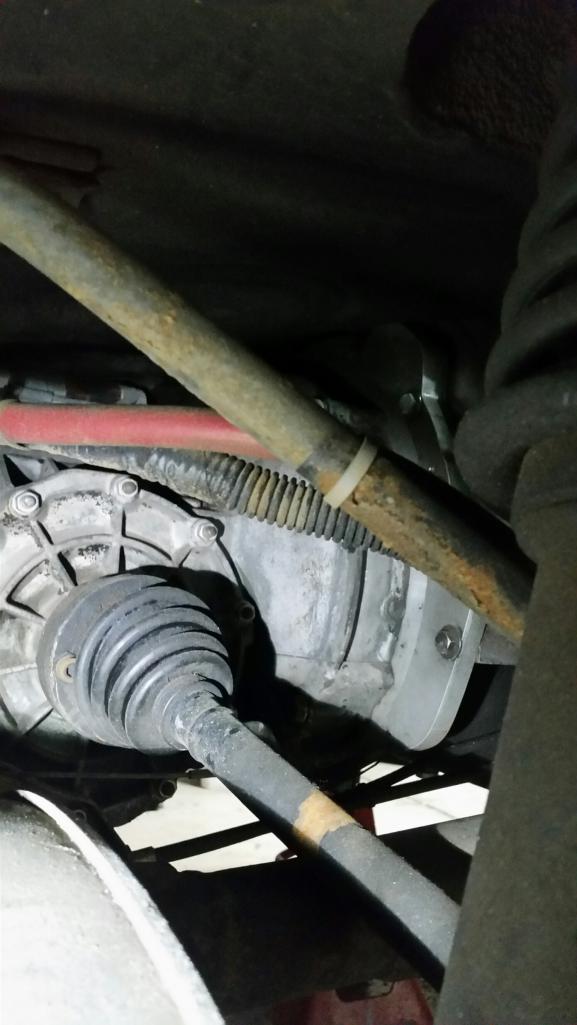

No problem zip tying the battery cables to the rear swaybar, right?? It should be ok.. (IMG:style_emoticons/default/headbang.gif) Attached Image Attached ImageAttached Image

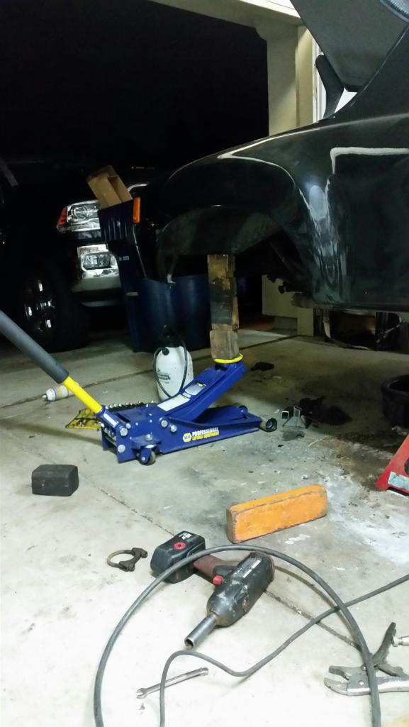

So, yeah...going to be doing a lot of this (IMG:style_emoticons/default/welder.gif) for the next few days. I hope to get the longs in by tomorrow so that I can support it there and yank the front and rear suspension to bring down to the 914 swap meet in san jose on sunday
Wish me luckAttached ImageAttached Image

Ouch....using the speaker to pick up the metal scraps?

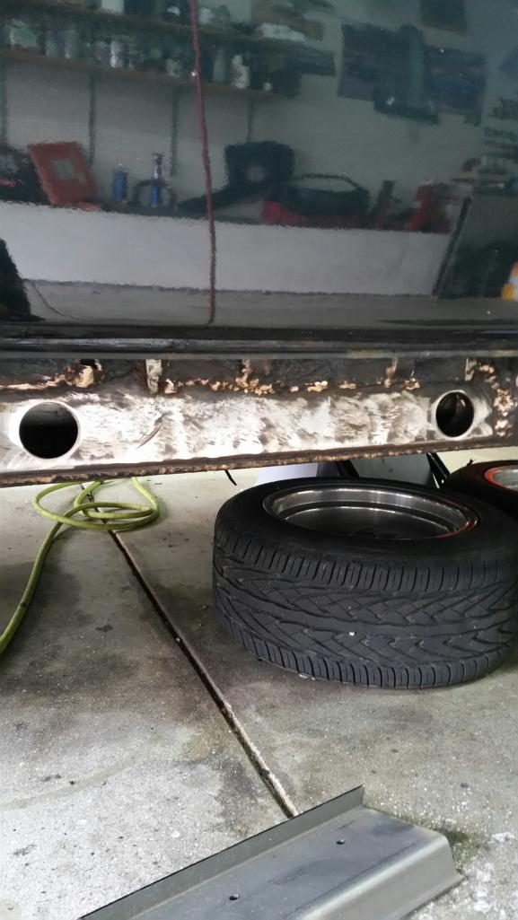

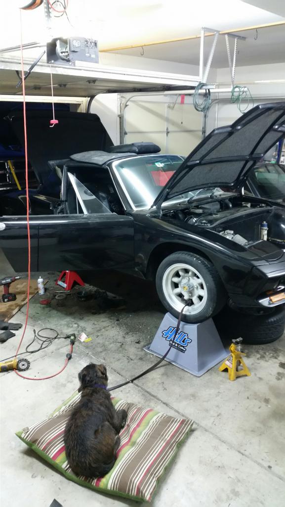

Day 2 saw the removal of the rear right suspension, complete with a broke off trailing arm console bolt...HOORAY! I soaked them for 2 days. 2 came out like butter. One rotated half a turn and snapped...Should be fun to remove.
It also appears that the long has been patched full length at some point in its history. Metal is good, and its gas welded with a goldish metal that is hard as hell. Not sure what it is, but I am guessing the welds aren't factory. The longs look nothing like the ones on my 73. I had to make spacer pieces to weld to the long to get the Mayeur kit to but up to and be able to plug weld. No biggie, but one more thing to deal with..
Hoping to get out today around 10am and put some more hours into it.Attached Image Attached ImageAttached Image

Holes were added so I could spray Ospho in there all over...Attached Image Attached ImageAttached Image
