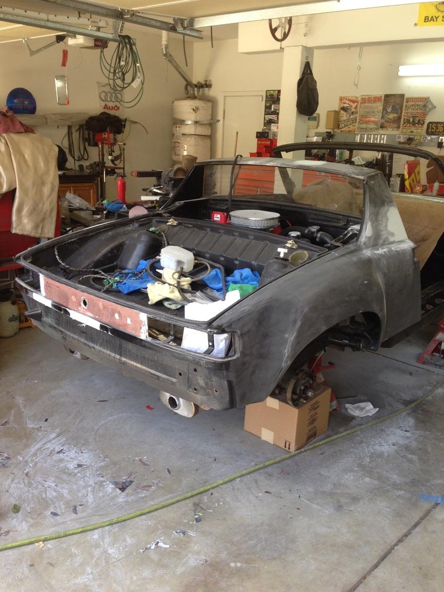

OK, so I was the *lucky* bastard who ended up with GandolfTheGrey's (previously MichaelT55's) 1972 V8 Car. Specs were as follows.
Engine:
-1962 Buick 215 Aluminum V8
-STD bore, 10.5-1 (stock) comp ratio
-Cyl heads-ported exhaust ports, 3 angle valve grind with hi-retainers-shaft rocker stands shortened .060"-pushrods shortened .125" for geometry correction.
-Camshaft-M-488 custom ground by Shadbolt engineering(Vancouver B.C.) C/W hydraulic lifters
-Spheroidal graphite iron crankshaft, 5 main journal center, thrust mains, .010" under -Rods ground .001"
-New rings
-Hi volume oil pump, Buick V8 filter housing
-Facet electric fuel pump-GM canister filter
-Offenhauser alum intake
-500 cfm Edelbrock carb C/W electric choke
-Buick distributor with Unilite conversion
-Kennedy engineered product #1000 Buick to Porsche adapter
-KEP 9" Flywheel, clutch and throw-out bearing
-Custon h.d. radiator w/ twin Spals
-Toyota Corolla heater
TRANSMISSION:
Custom built V8 side shift trans by Dr. Evil.
Custom ratios
1st gear lock out
Fresh rebuild, newly installed
BODY:
-Rayco FRP front fenders
-Mitcom 916 rear quarter panels
-P.B. Tweeks FRP flared rocker panels
ELECTRICAL:
-Hella H-4 Q.I. headlites
-Eurolens rear tail lites
-Tach converted to 8cyl
-Mechanical oil pressure and water temp
-Alpine CD
-Electric windows
-Updated blade style fuse blocks
SUSPENSION:
-H & H Carrera 19mm adj front sway bar
-Addco 16mm rear sway bar
-140# rear springs (100 stock)
-Stock front torsion bar
-Koni adj front and Koni H.D. rear shock absorbers
-BMW 320i front brake conversion
-Stock Porsche rear calipers
-All four calipers have stainless steel liners and completely rebuilt.
-Adj proportioning valve
-19mm 911 master cylinder
-All rotors have been crossdrilled
-All flex lines are braided stainless steel
-Pagio performance brake pads, all four wheels
-Carrol Shelby Mini-Europa wheels 7/15 front 8.5/15 rear
-Custom roll bar with rear chassis supportsAttached Image

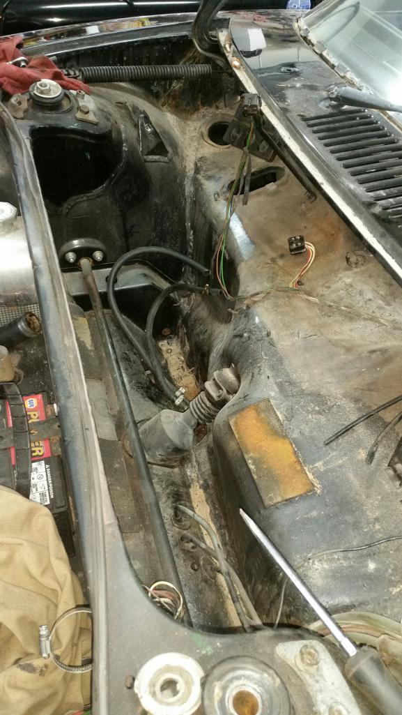

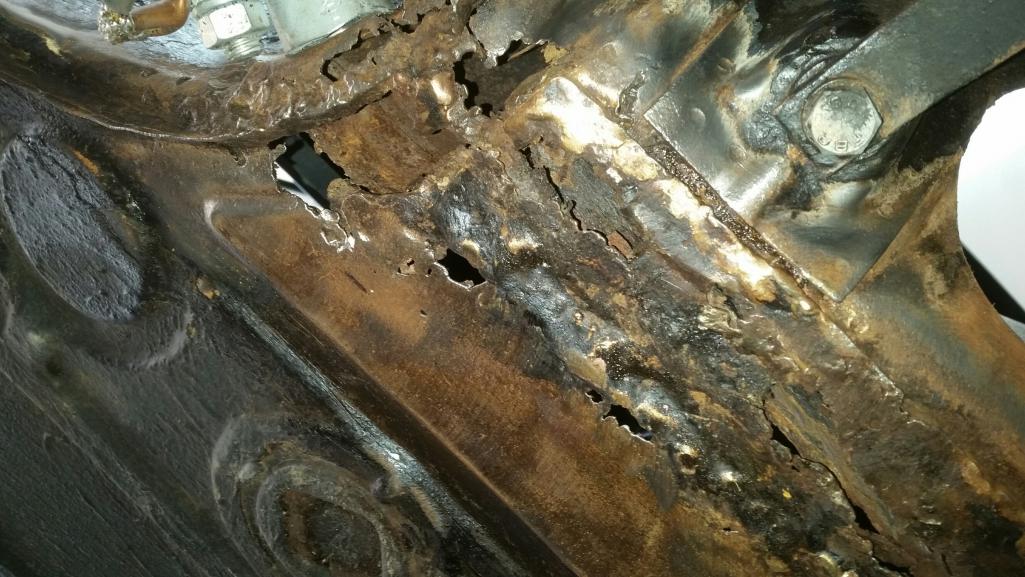

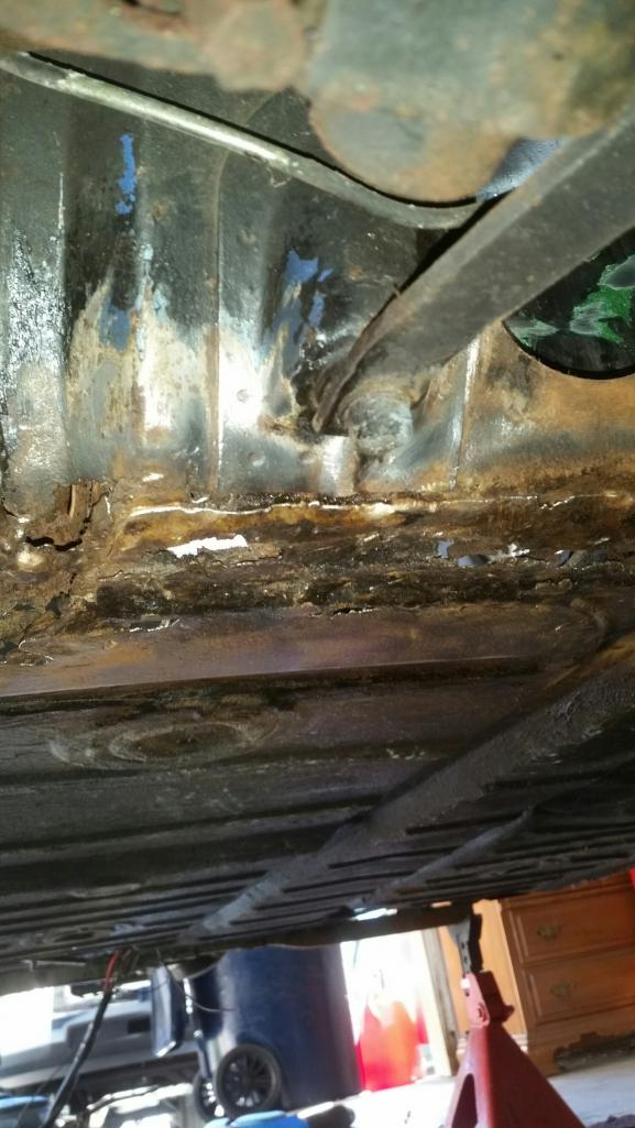

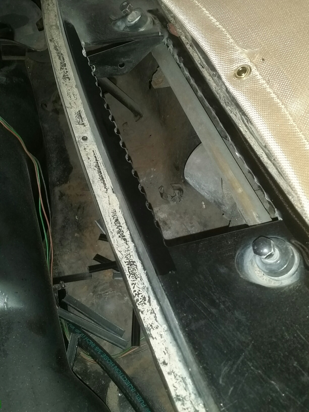

LeftCoastErik   I yanked the rockers and my heart started to sink ...   May 14 2015, 09:59 AM
LeftCoastErik   More pics   May 14 2015, 10:03 AM
LeftCoastErik   and some more No problem zip tying the battery ca...   May 14 2015, 10:05 AM
LeftCoastErik   So, yeah...going to be doing a lot of this :welde...   May 14 2015, 10:08 AM
rhodyguy   Bummer   May 14 2015, 10:15 AM
rjames   Bummer indeed. At least it looks like you have th...   May 14 2015, 10:44 AM
Mueller   Ouch....using the speaker to pick up the metal scr...   May 14 2015, 10:55 AM
matthepcat   Bummer about the rust. The car is going to look ...   May 14 2015, 11:50 AM
LeftCoastErik   Yeah, definitely a bummer, but stuff happens. My ...   May 14 2015, 12:03 PM

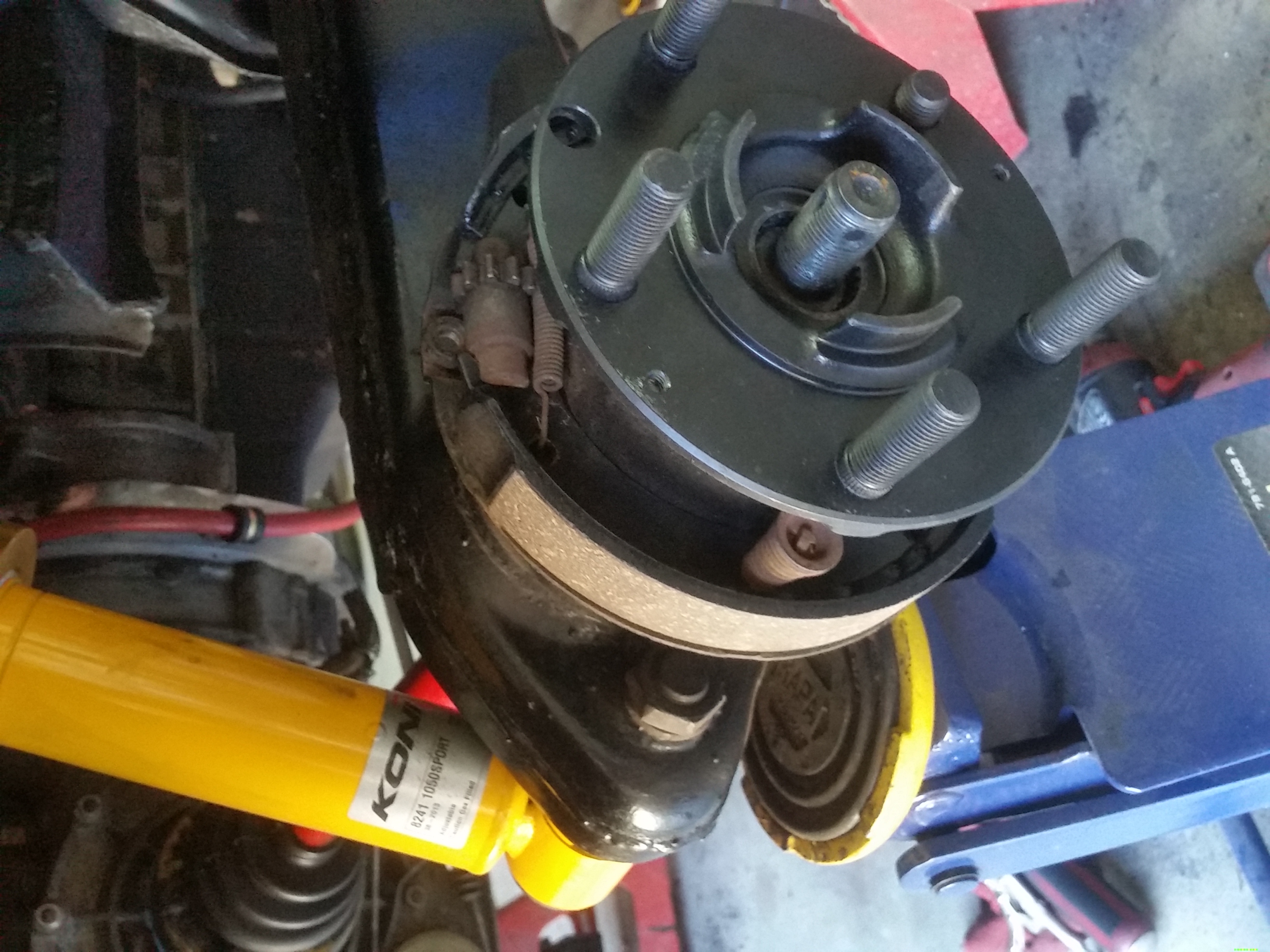

LeftCoastErik   Day 2 saw the removal of the rear right suspension...   May 15 2015, 10:13 AM
LeftCoastErik   Holes were added so I could spray Ospho in there a...   May 15 2015, 10:15 AM

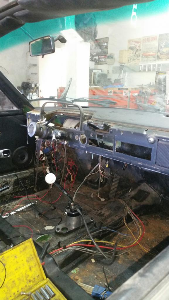

LeftCoastErik   No updates for a while, sorry. I did get the inter...   May 27 2015, 10:34 AM

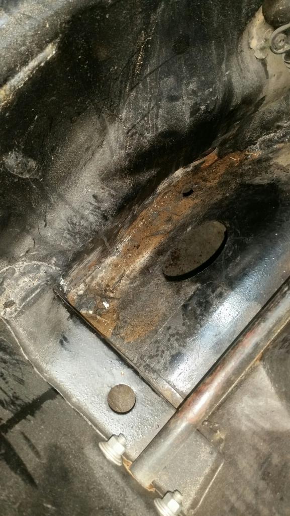

LeftCoastErik   Yesterday I got the rear inner fenders cleaned and...   May 30 2015, 08:20 AM
arkitect   Yesterday I got the rear inner fenders cleaned an...   Jun 5 2015, 04:53 AM
LeftCoastErik   More   May 30 2015, 08:20 AM
LeftCoastErik   Trailing arm   May 30 2015, 08:21 AM

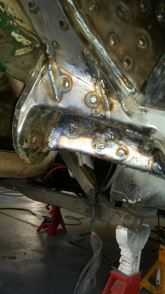

LeftCoastErik   More pics from the weekend. Got the entire GT rei...   Jun 1 2015, 10:33 AM
whitetwinturbo   Had this on "watch" too..........and I...   Jun 1 2015, 10:25 PM
whitetwinturbo   Is the white GT front fender replacement fiberglas...   Jun 1 2015, 10:34 PM
LeftCoastErik   Yes. From QRS   Jun 1 2015, 10:36 PM
Andyrew   My my my thats a lot of welding!!   Jun 1 2015, 10:48 PM
LeftCoastErik   Yeah. They seem like small parts..but it adds up. ...   Jun 1 2015, 11:05 PM

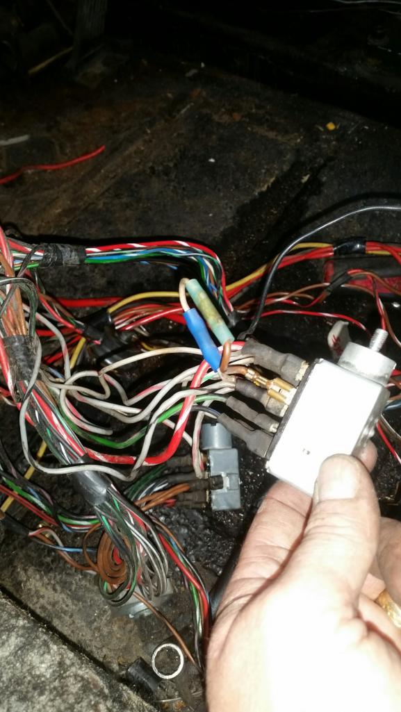

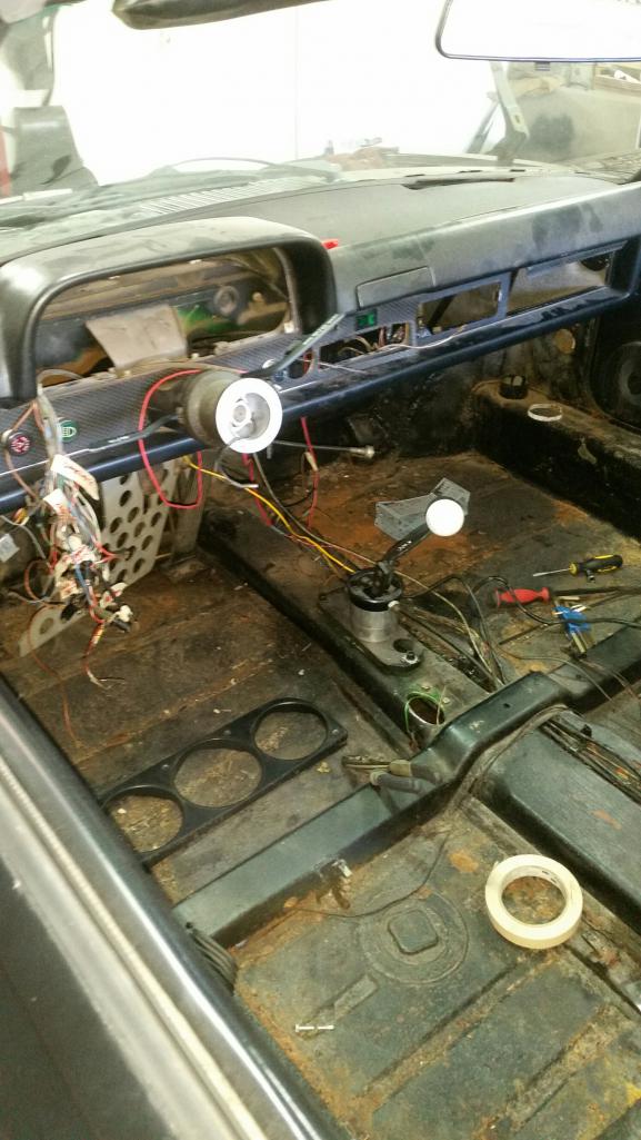

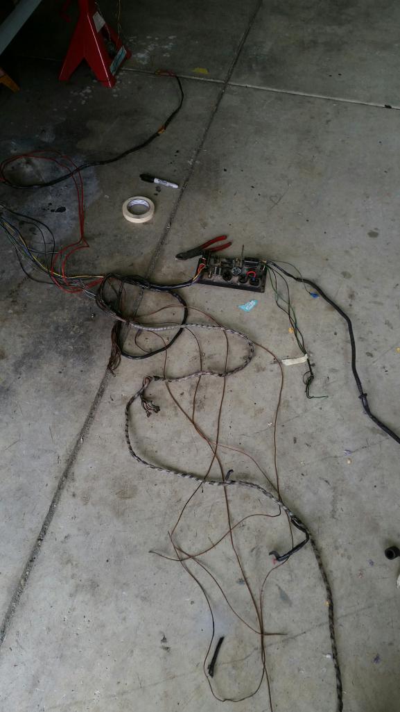

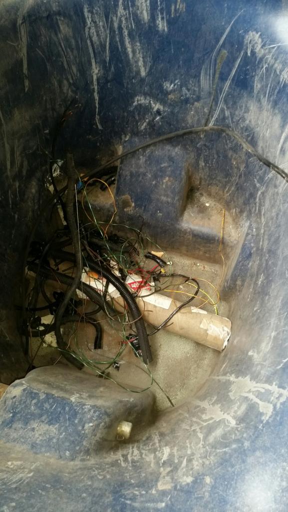

LeftCoastErik   I decided that the old, hammered relay board and a...   Jun 4 2015, 01:12 PM
whitetwinturbo   I decided that the old, hammered relay board and ...   Jun 4 2015, 04:26 PM

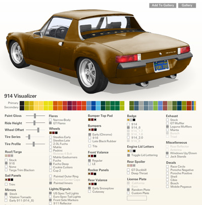

howlndog   Regarding colour... have you ever played around wi...   Jun 5 2015, 11:41 AM
LeftCoastErik   Holy crap!! That is awesome! ! Tha...   Jun 5 2015, 12:12 PM
LeftCoastErik   I took a stab at it... I will be making a custom m...   Jun 5 2015, 04:03 PM

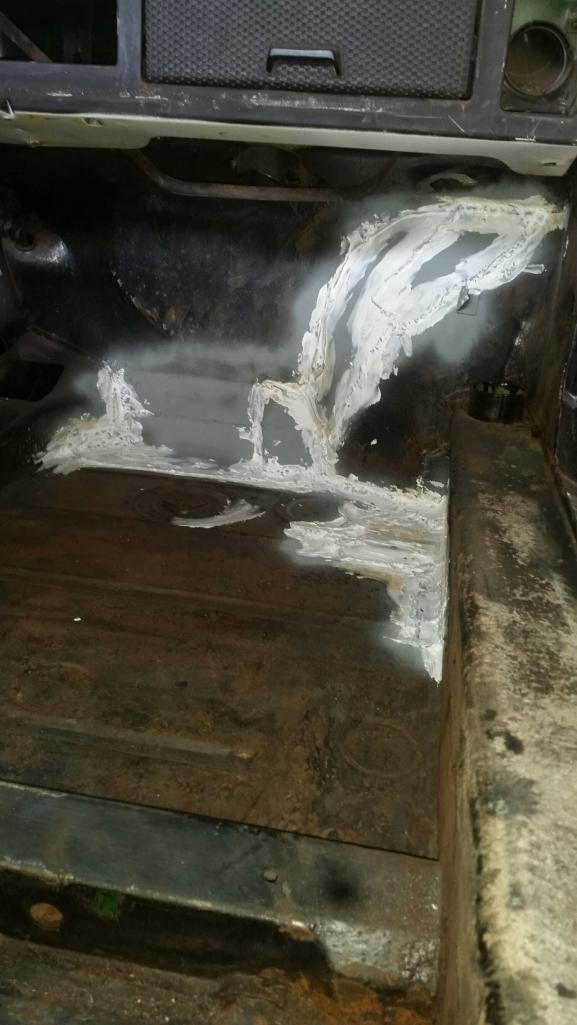

LeftCoastErik   I got a lot done this weekend. I also cursed a lo...   Jun 8 2015, 02:59 PM
LeftCoastErik   Here are some pics of the "Not-so-significant...   Jun 8 2015, 03:02 PM
LeftCoastErik   and the fixing..   Jun 8 2015, 03:04 PM
LeftCoastErik   last pic for now...More to follow after I get the ...   Jun 8 2015, 03:05 PM

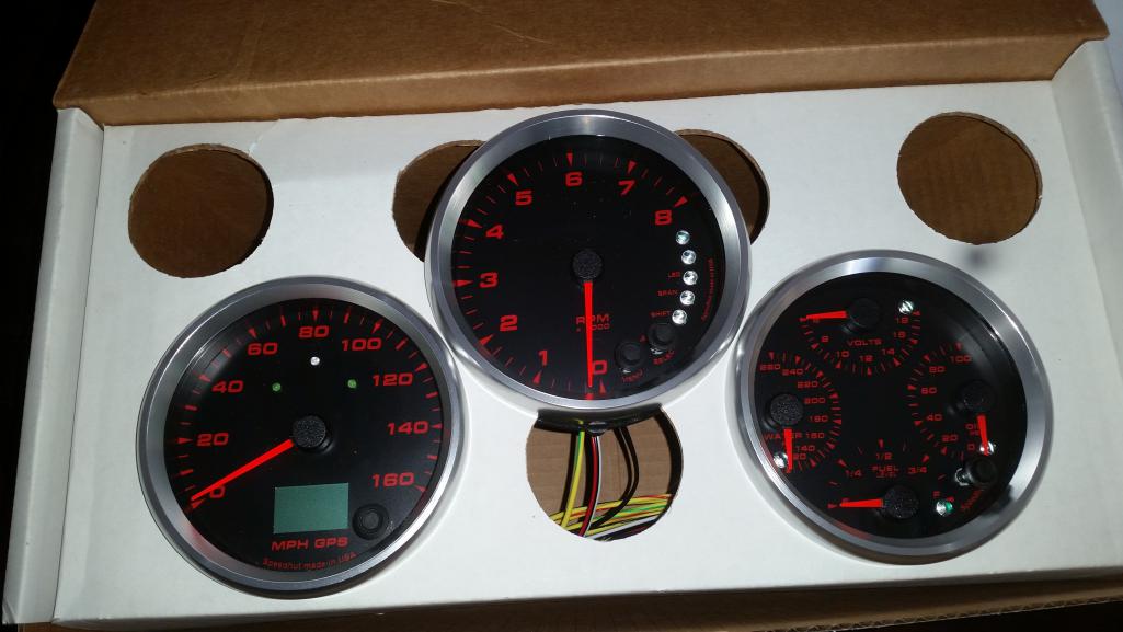

LeftCoastErik   On a positive note..I just came home to these beau...   Jun 8 2015, 05:38 PM
matthepcat   Nice! My GPS speed hut gauge took like 3 weeks...   Jun 8 2015, 05:48 PM
LeftCoastErik   Iirc they are 4" and the tach is 4.5   Jun 8 2015, 06:06 PM

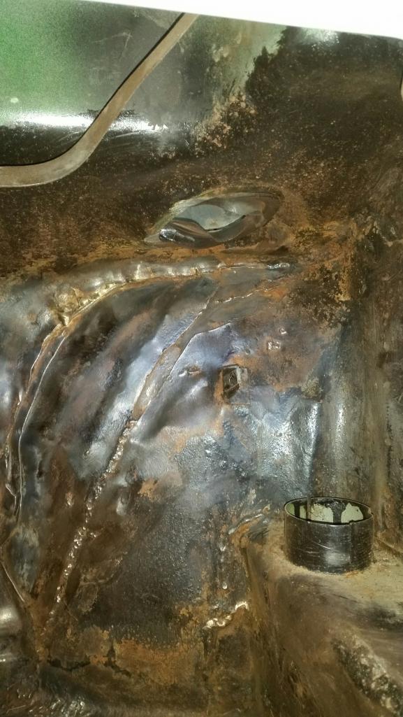

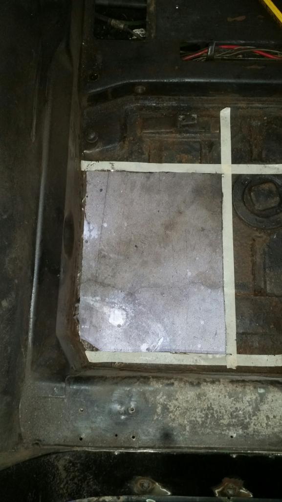

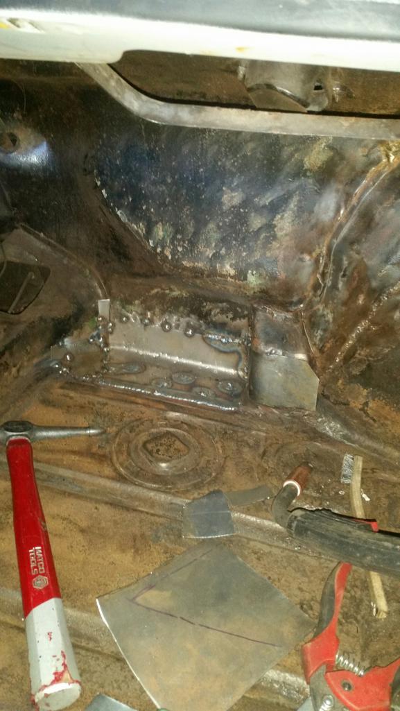

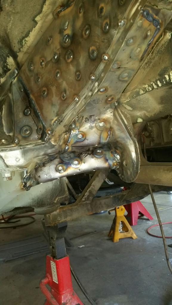

LeftCoastErik   I had a busy weekend of exciting rust bucket work....   Jun 15 2015, 10:36 AM
LeftCoastErik   more   Jun 15 2015, 10:38 AM

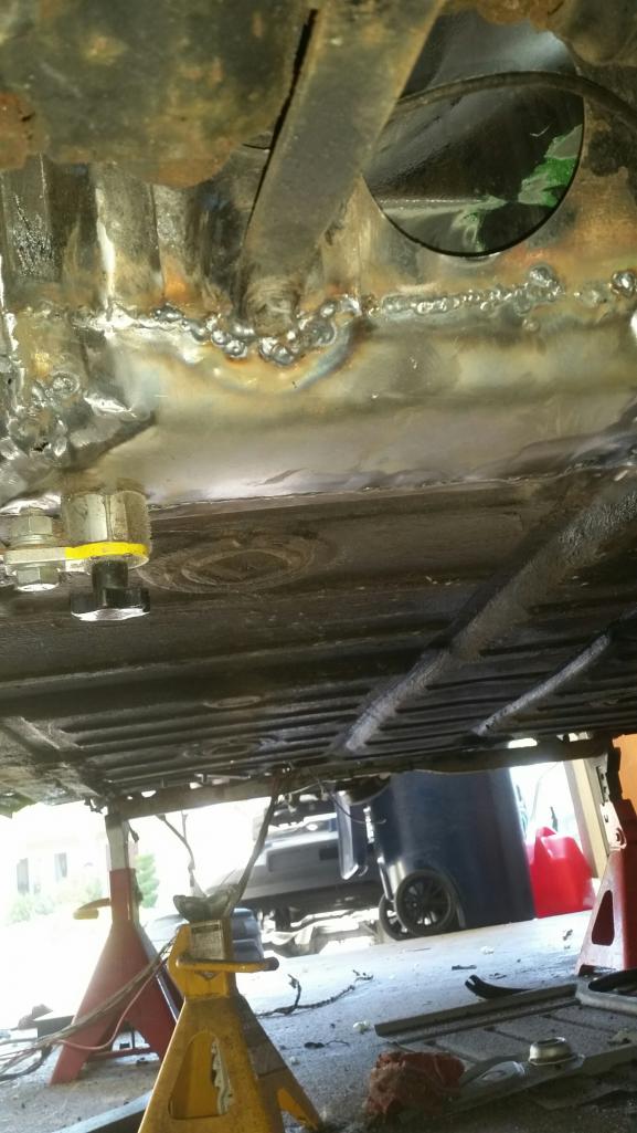

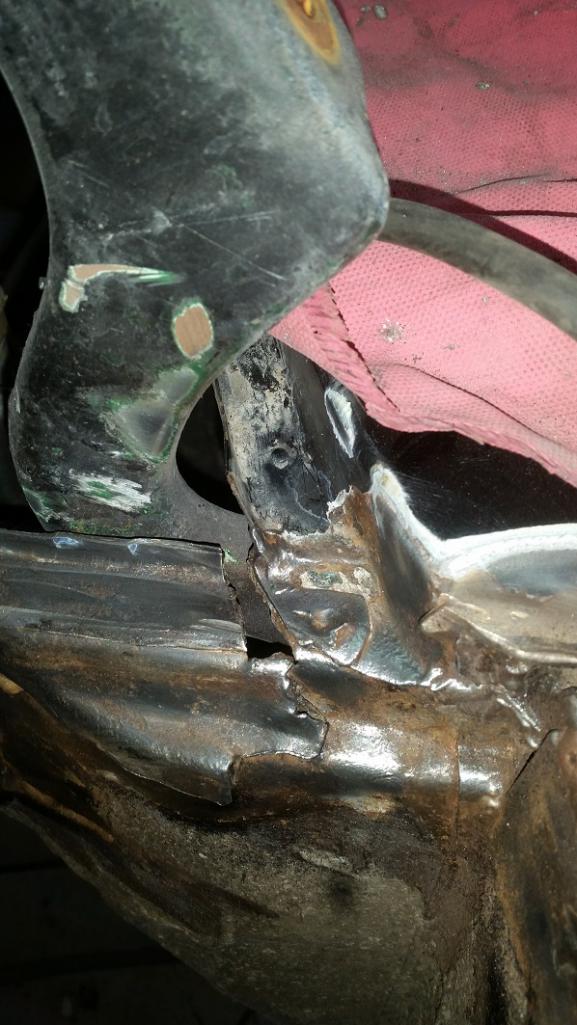

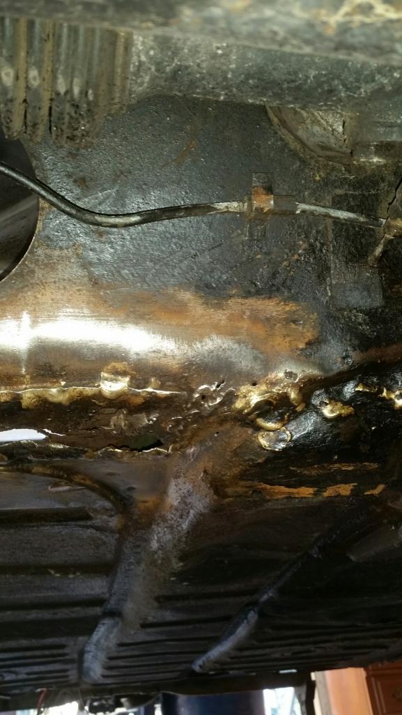

LeftCoastErik   I then moved on to the front of the car and discov...   Jun 15 2015, 10:47 AM
LeftCoastErik   Here's the drivers side...some of the spot wel...   Jun 15 2015, 10:49 AM

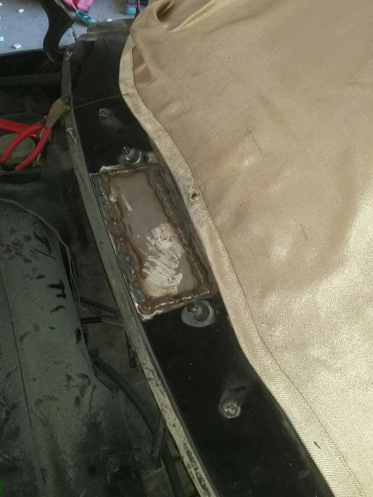

LeftCoastErik   I got everything seam welded up and then made new ...   Jun 15 2015, 11:27 AM
LeftCoastErik   I still have some work to do in the exposed corner...   Jun 15 2015, 11:36 AM
whitetwinturbo   Eric, you are the "welding MAN"! :w...   Jun 15 2015, 11:36 AM

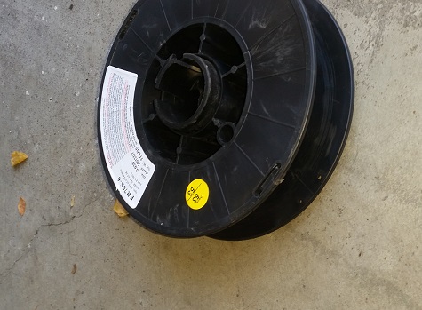

LeftCoastErik   I am on my second big bottle of gas, and this spoo...   Jun 15 2015, 11:37 AM

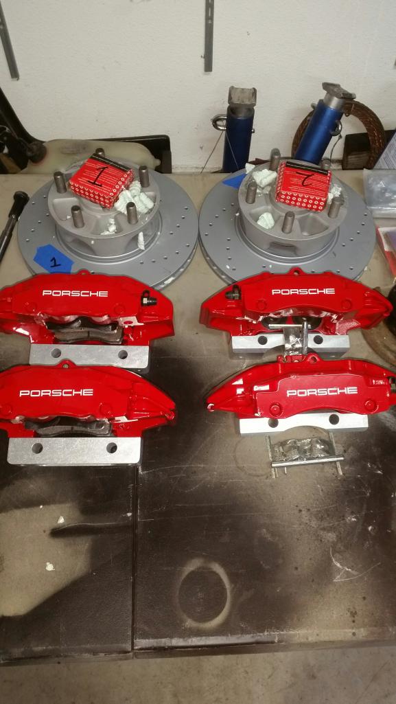

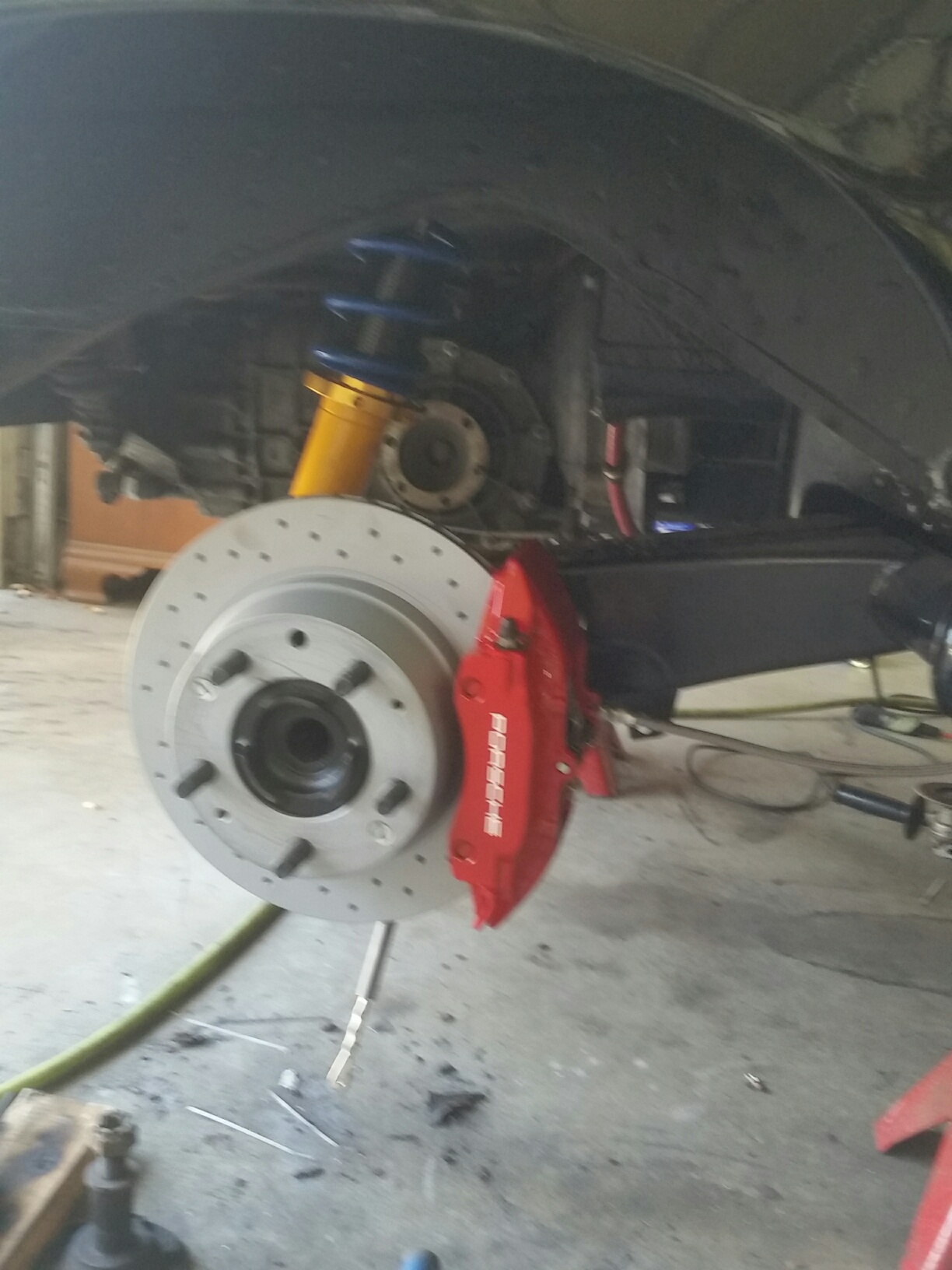

LeftCoastErik   The past few days have been eventful. Got the fue...   Jun 18 2015, 12:27 PM
