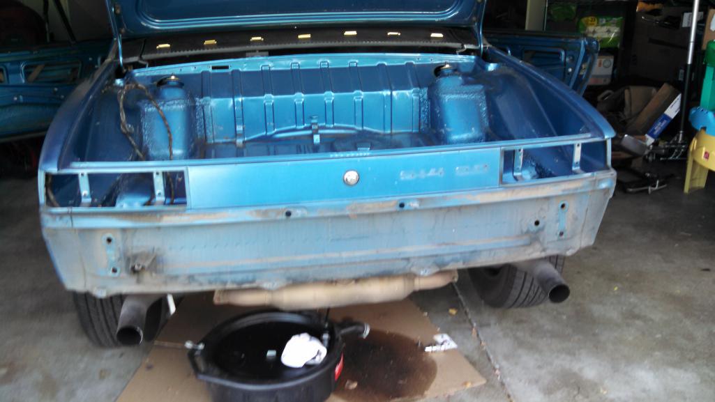

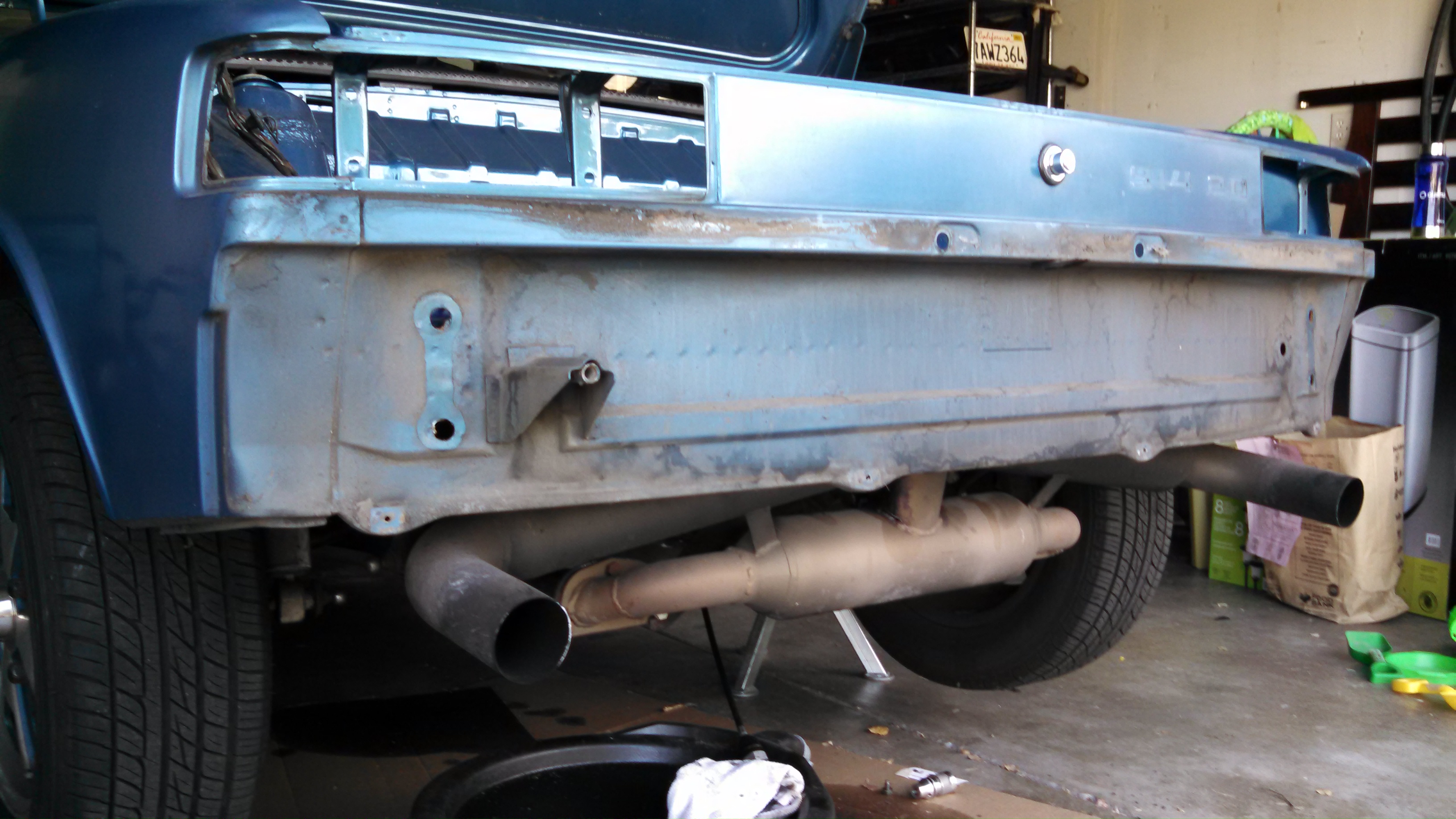

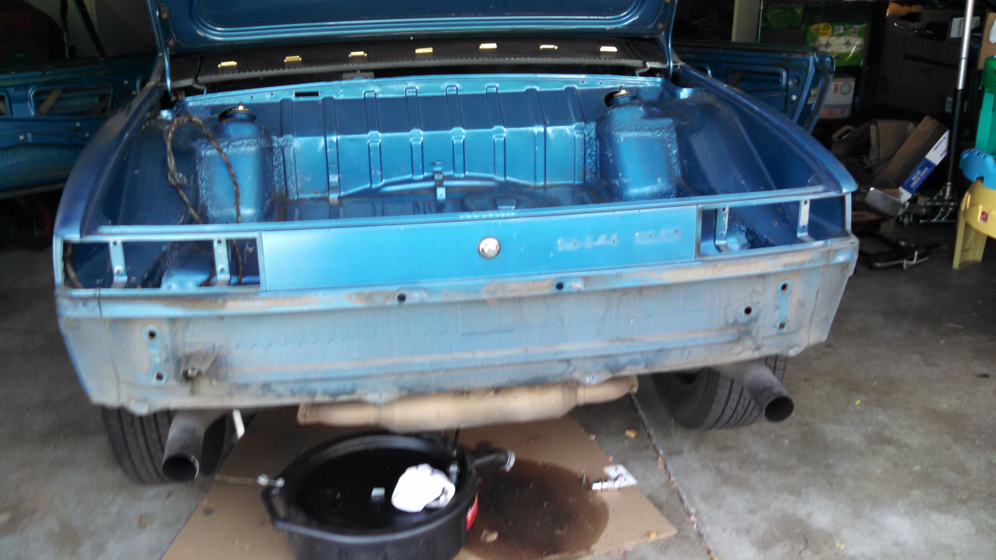

So today, I got started tearing down my 1974 2.0L. Started at the rear and got through almost all the interior except dash and center console area. Overall, the car looks good from a rust perspective, but I KNOW that there is rust in the hell hole and the area under the hell hole (where the original fuel pump mount location was) is pretty much gone as I can stick my hand in there. I'll get pics of that after I drop the motor some upcoming weekend.
So what's my build gonna be? I'm fairly well locked in on what I want to do. I have considered /6's (and even come close to acquiring a 3.0L), but I think in the end I am going to go with a built up 2270 motor. One of the main reasons I am going that route is that I want to be able to use 1st gear. Sound strange? Sure, even though 1st is not much of anything even on a stock 2.0L, I just love the dogleg shifting from 1st to 2nd. From reading others posts here, if I go a /6 I pretty much end up with starting in 2nd all the time.
So here's the build (with some decision points still):
Note: This is a very high level list
Staying with Narrow Body, removing the warts and antenna hole
2270 /4 with some form of FI provided by megasquirt, external oil cooler, maybe ITB's.
901 side-shift with anything that can be done to improve gearing and longevity
5-lug upgrade (suspension components and the whole bits) with Fuchs.
Interior will be mostly stock, but looking to go the Getty Dash route.
Sticking with original Alaska Blue Metallic (L96B)
Here's my progress today:
Rear bumper off:

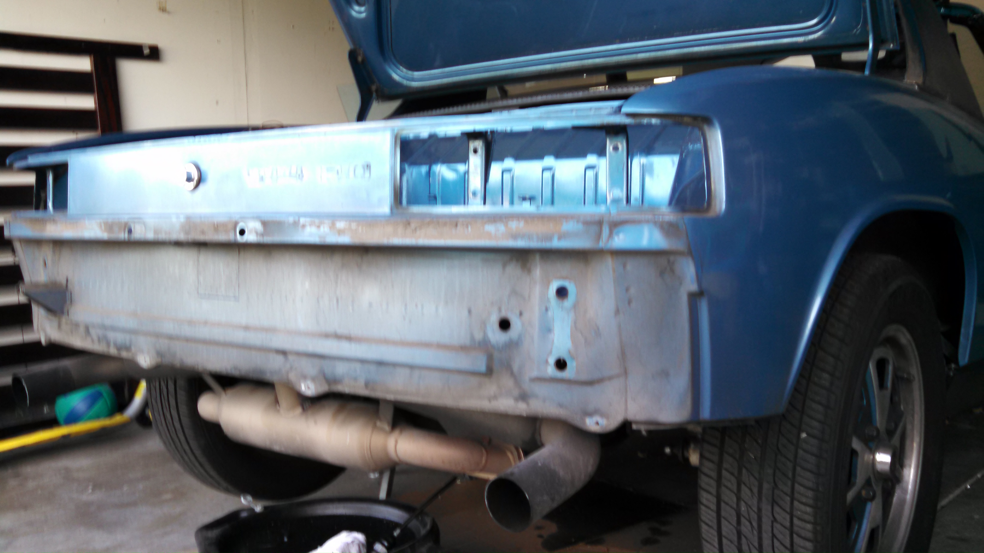

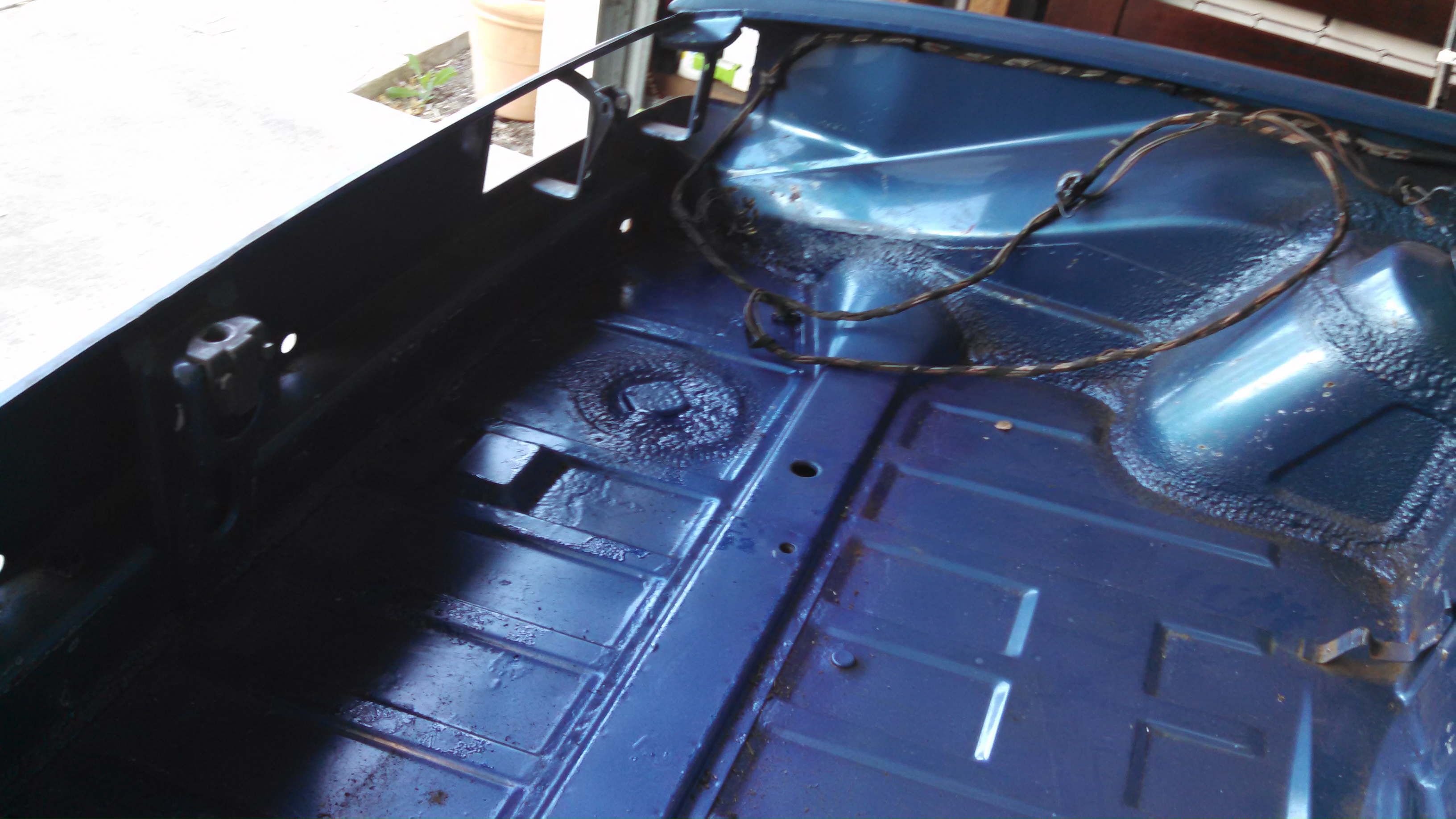

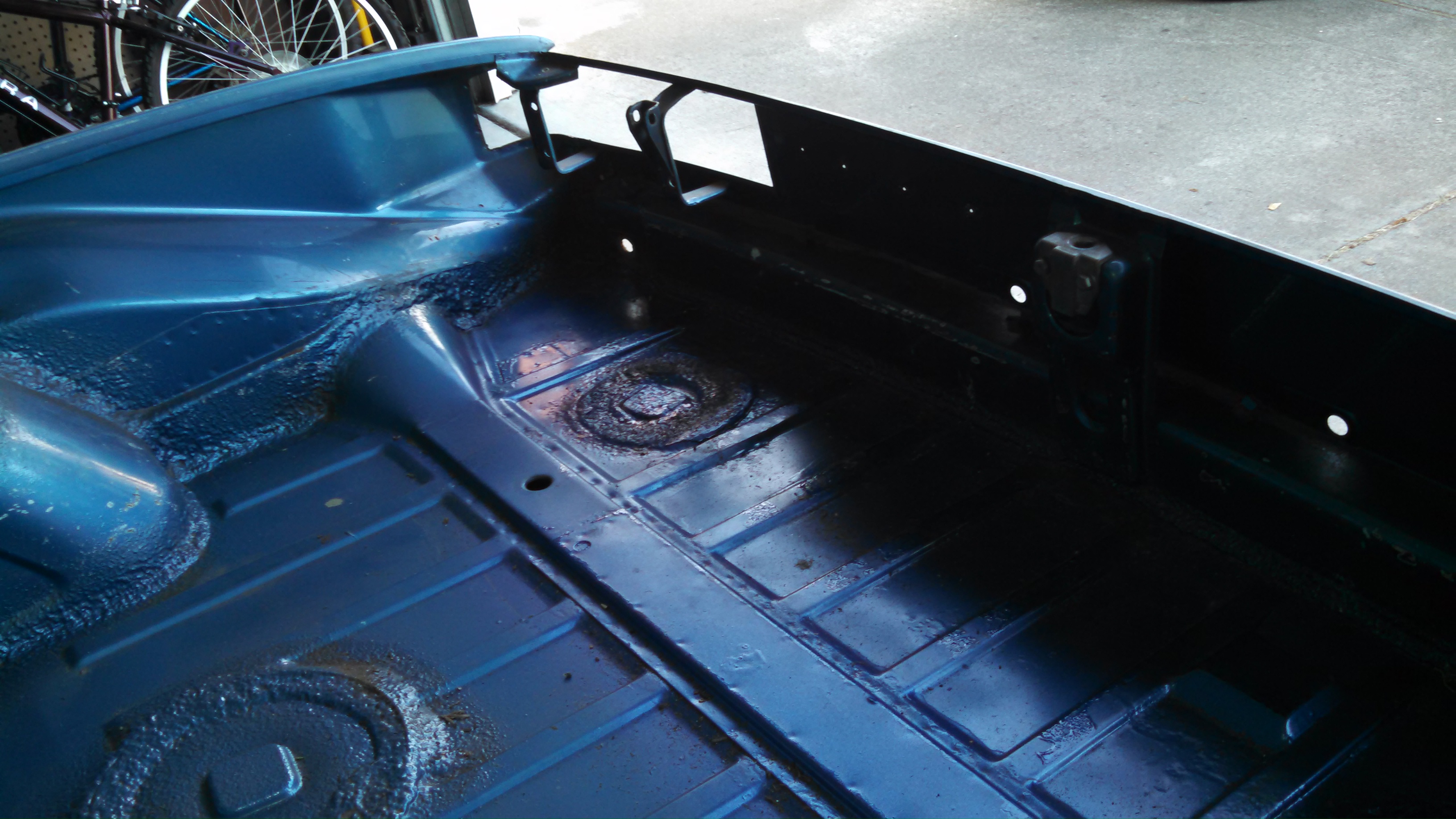

Trunk shots:

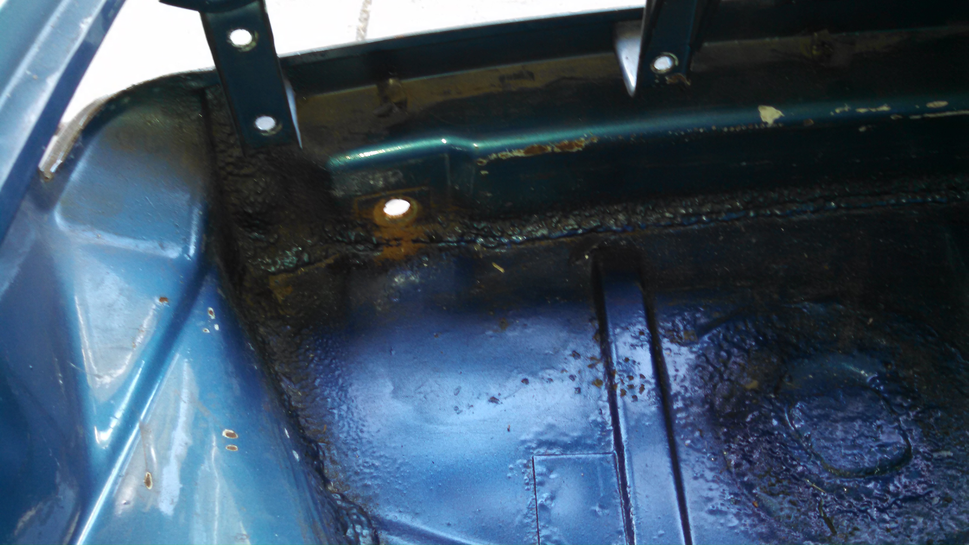

Trunk corners:

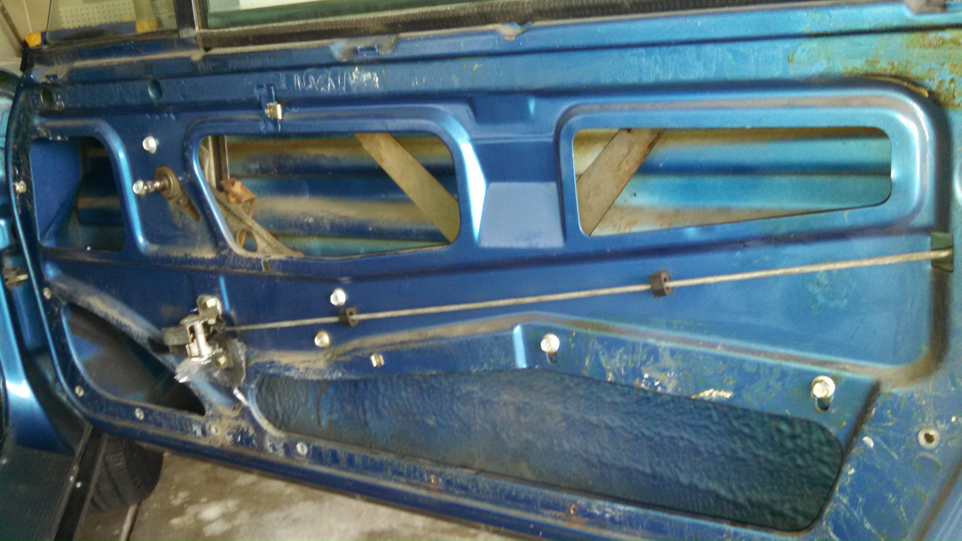

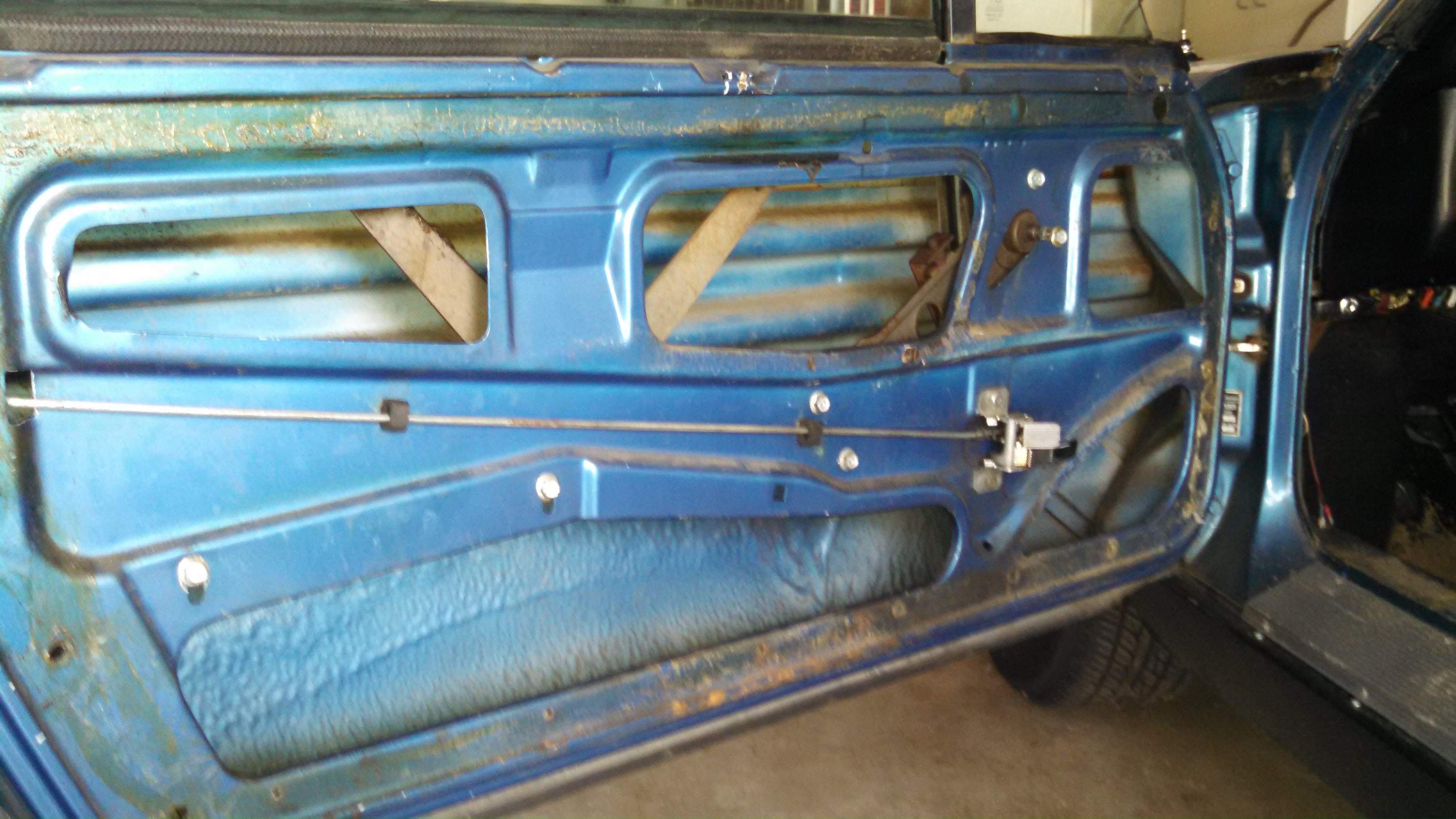

Passenger Door:
boxsterfan
post Jun 6 2015, 10:12 PM
914's are kewl
Posts: 1,776
Joined: 6-June 03
From: San Ramon, CA
Member No.: 791

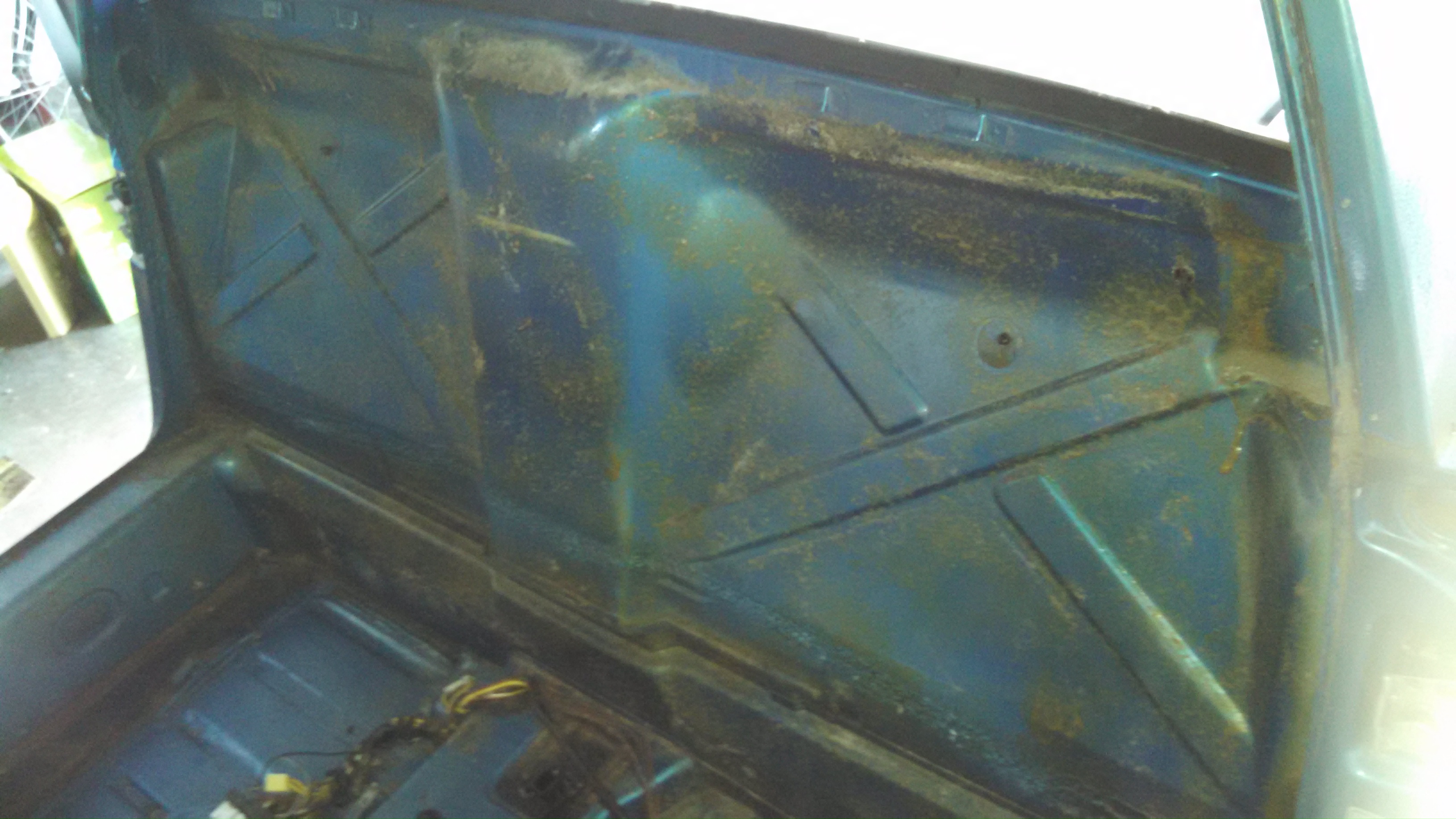

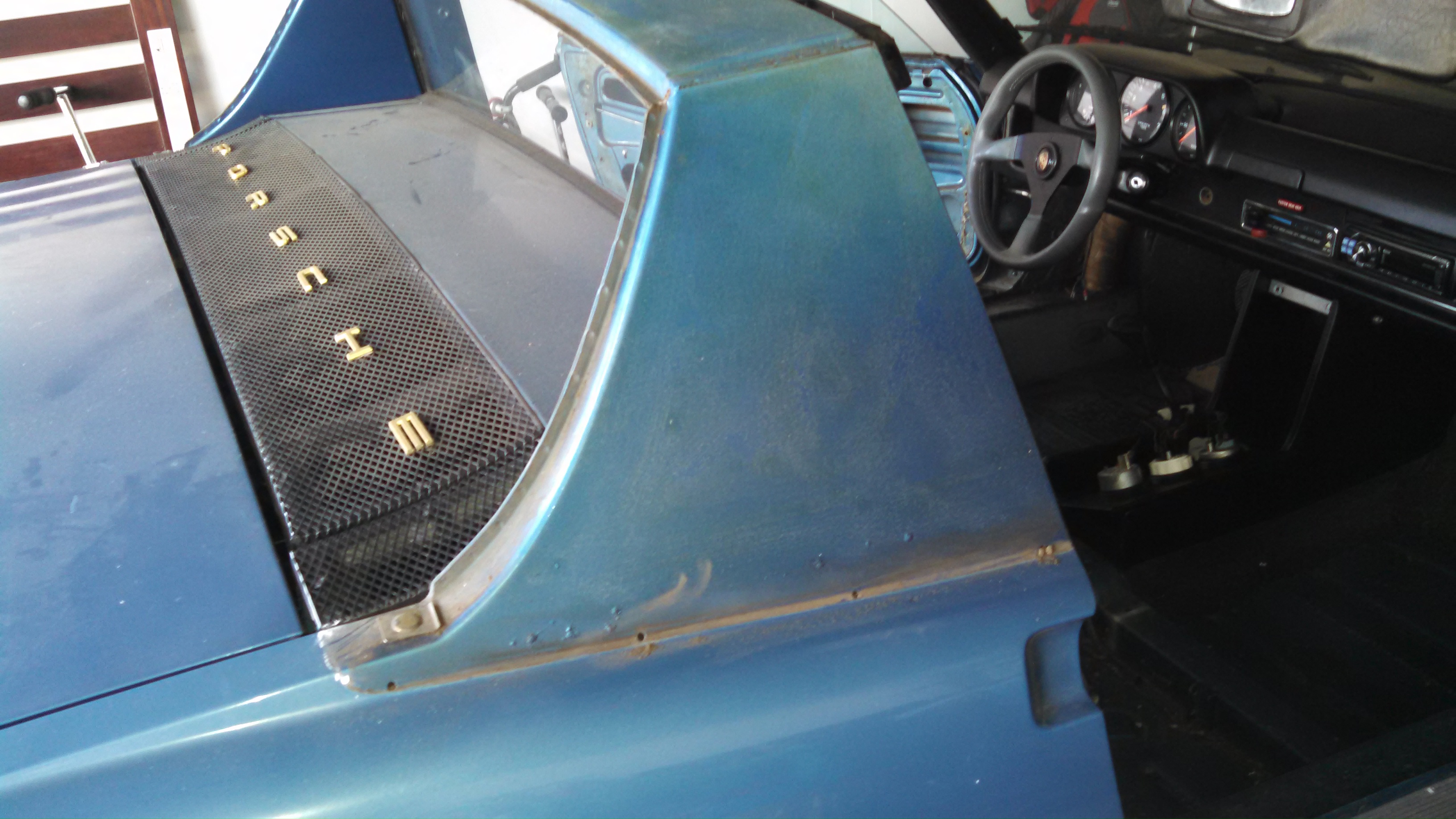

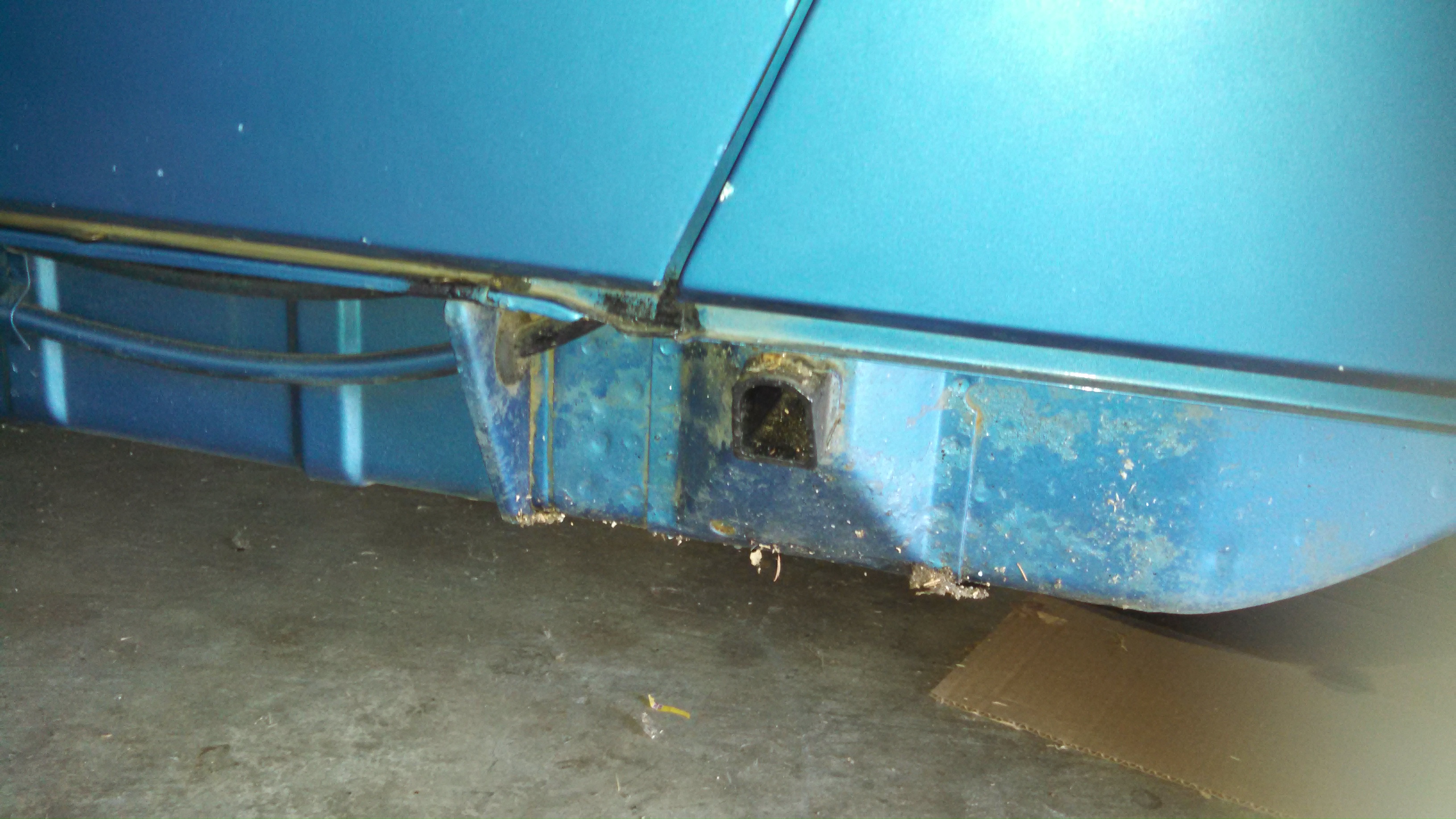

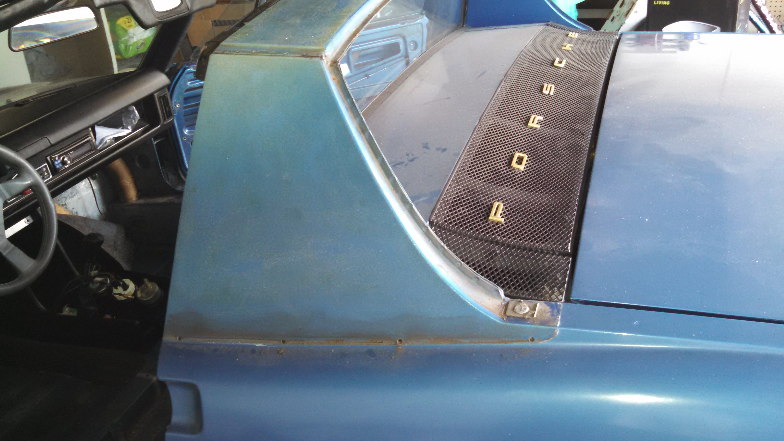

Sail Panels:
boxsterfan
post Jun 6 2015, 10:14 PM
914's are kewl
Posts: 1,776
Joined: 6-June 03
From: San Ramon, CA
Member No.: 791

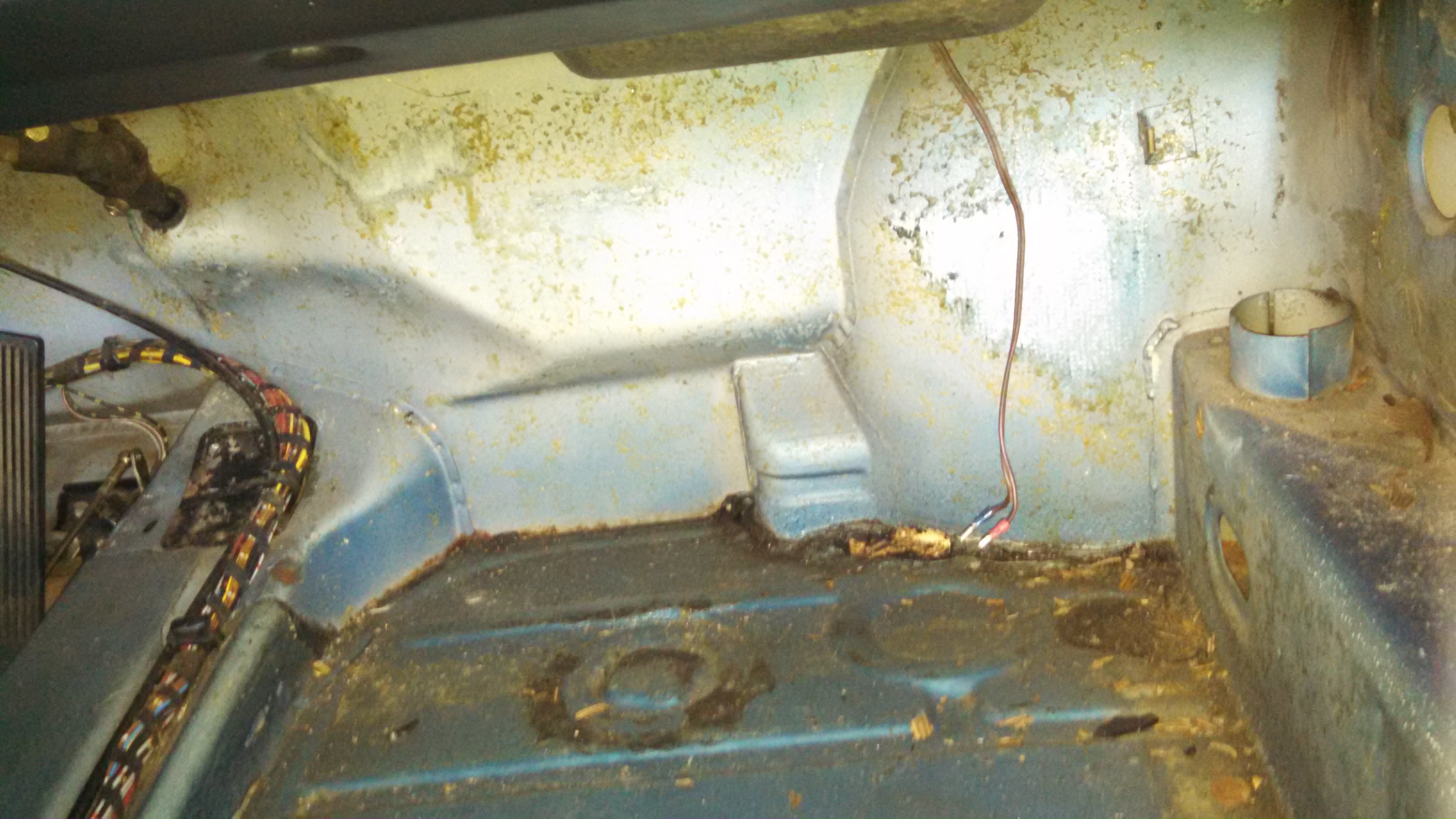

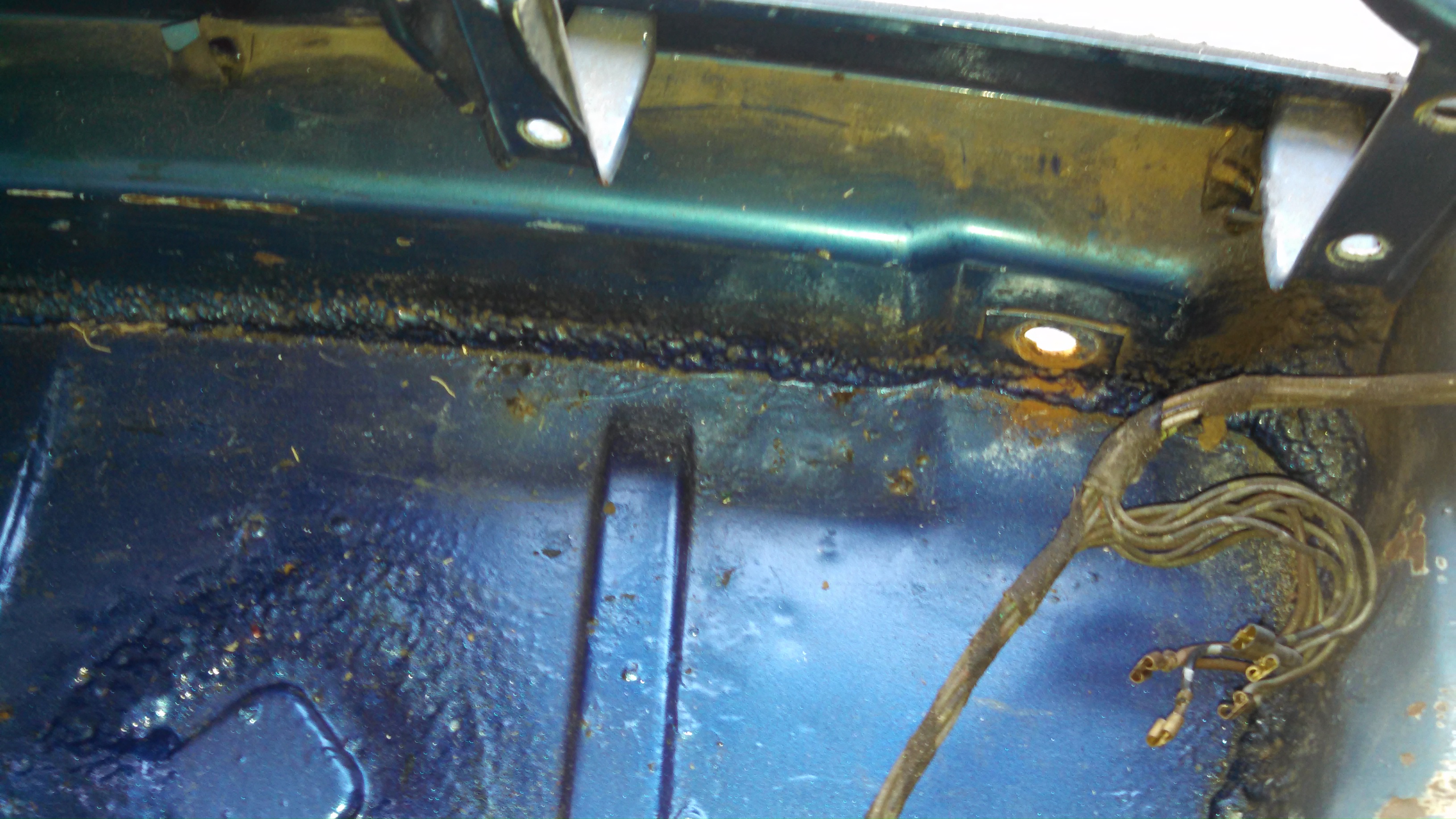

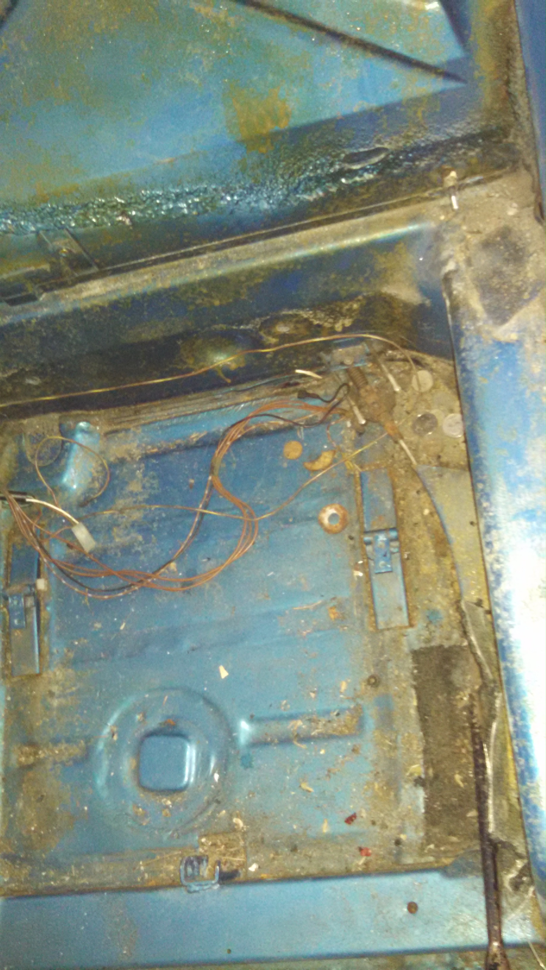

Interior Floor pans and Firewall:
boxsterfan
post Jun 6 2015, 10:15 PM
914's are kewl
Posts: 1,776
Joined: 6-June 03
From: San Ramon, CA
Member No.: 791

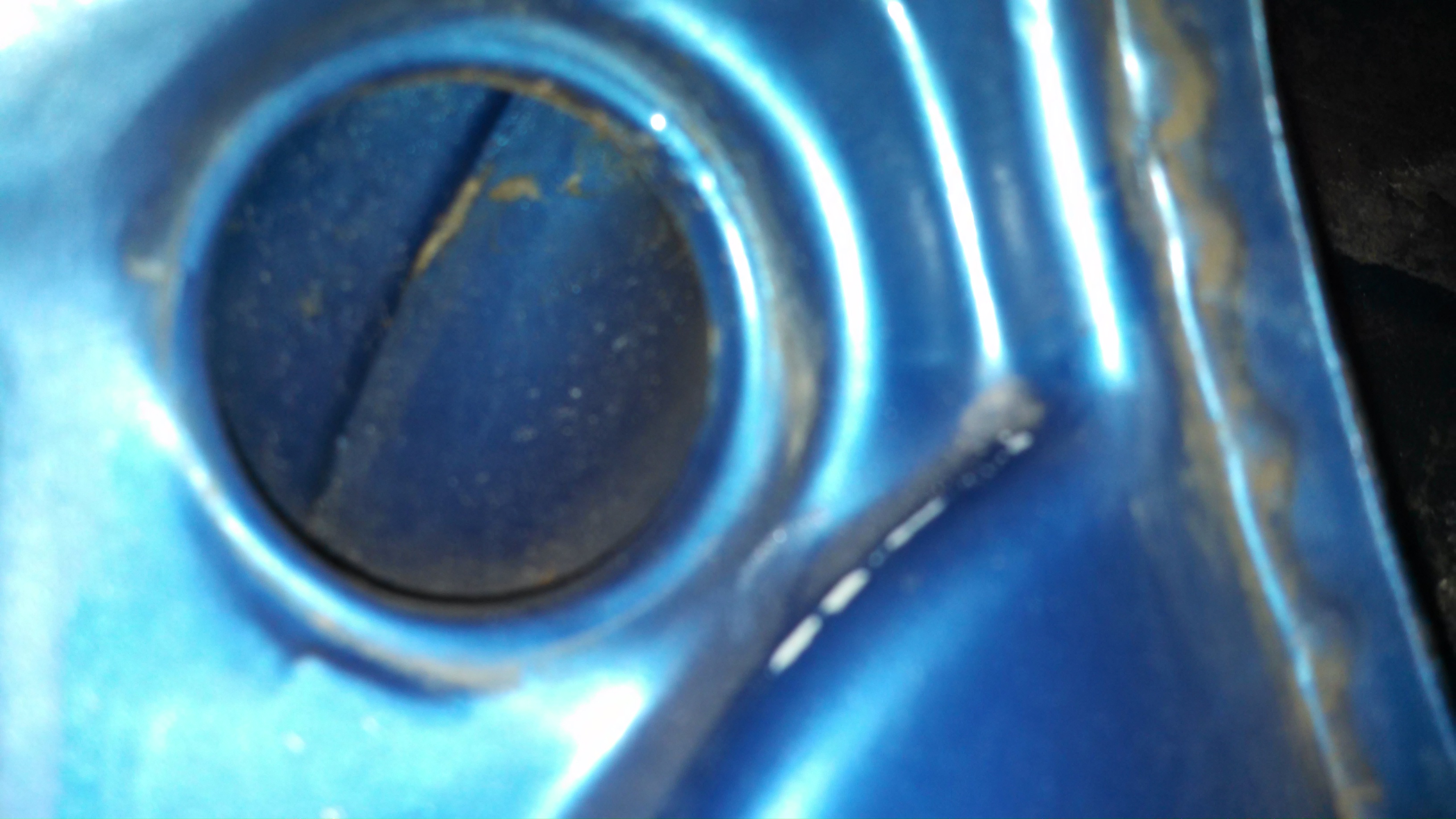

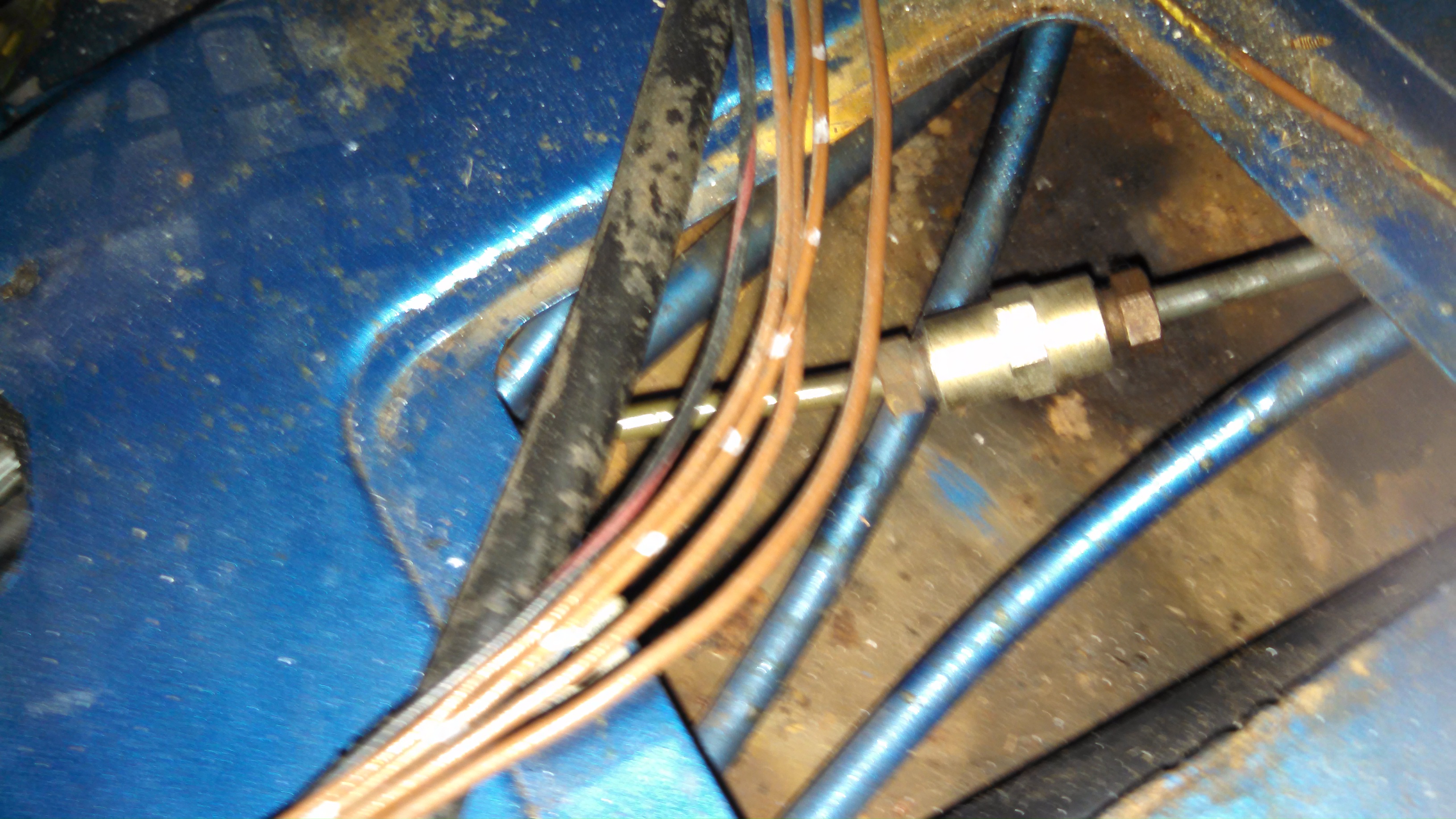

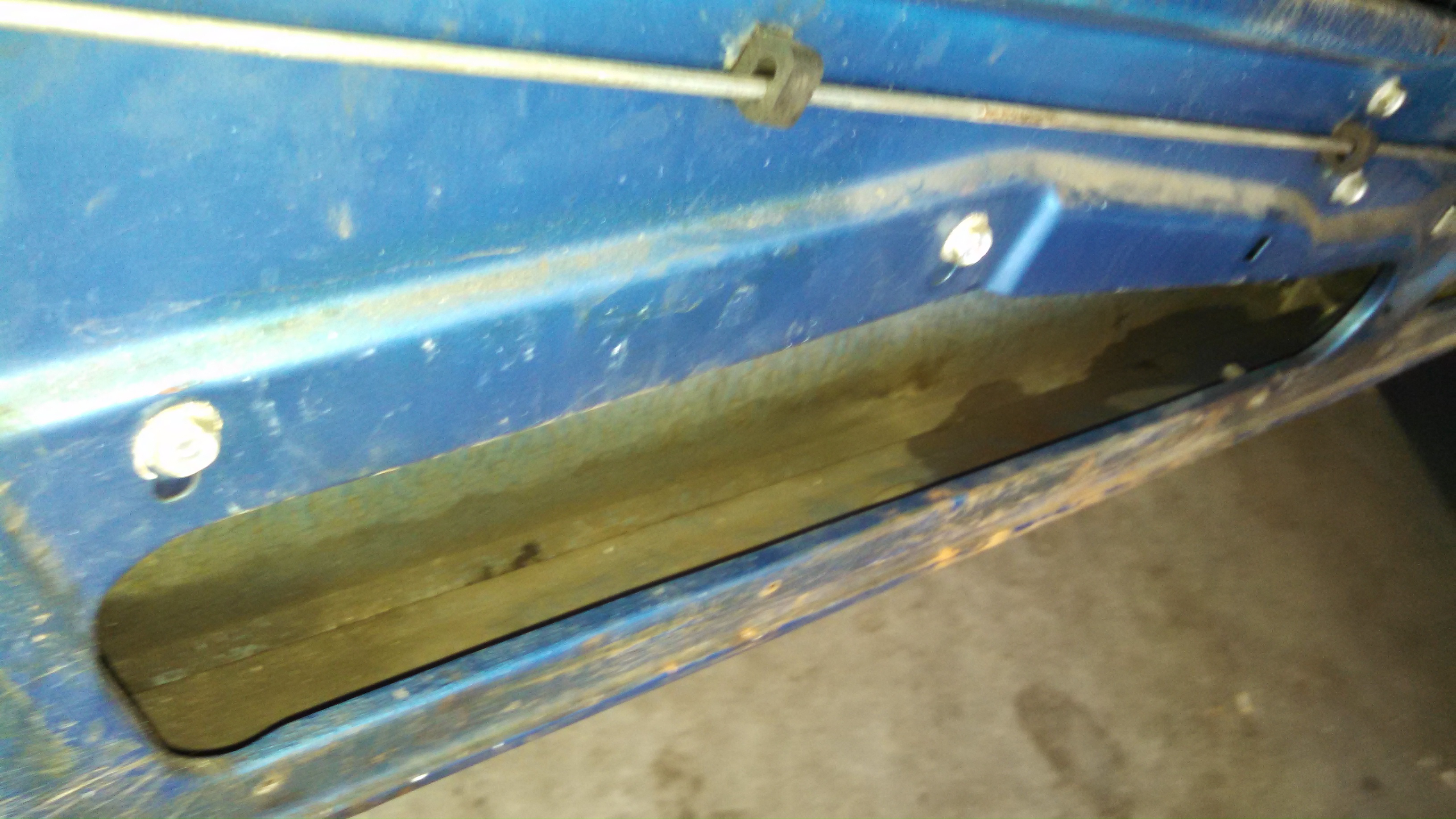

Sail Panel drains:
boxsterfan
post Jun 6 2015, 10:18 PM
914's are kewl
Posts: 1,776
Joined: 6-June 03
From: San Ramon, CA
Member No.: 791

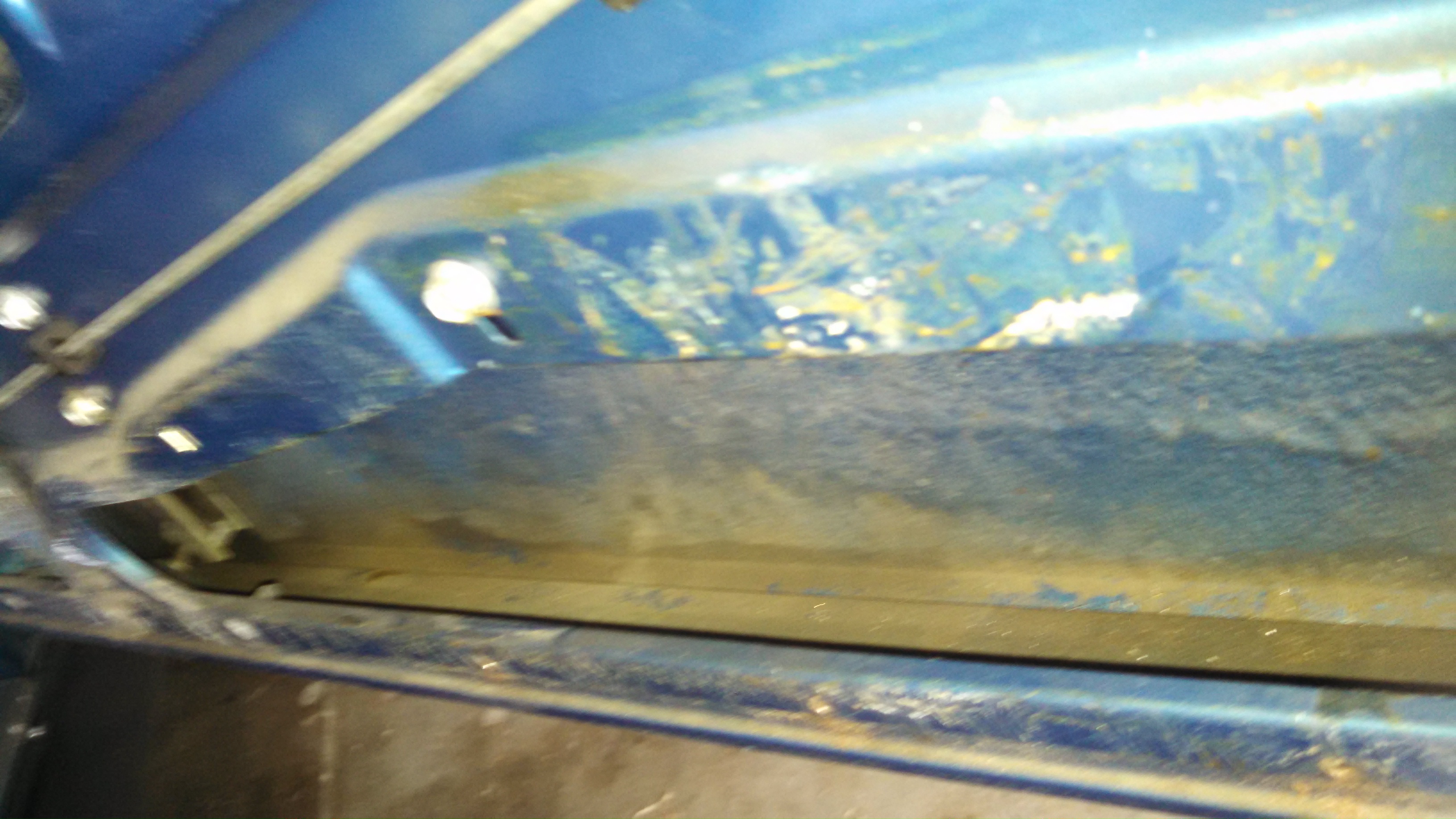

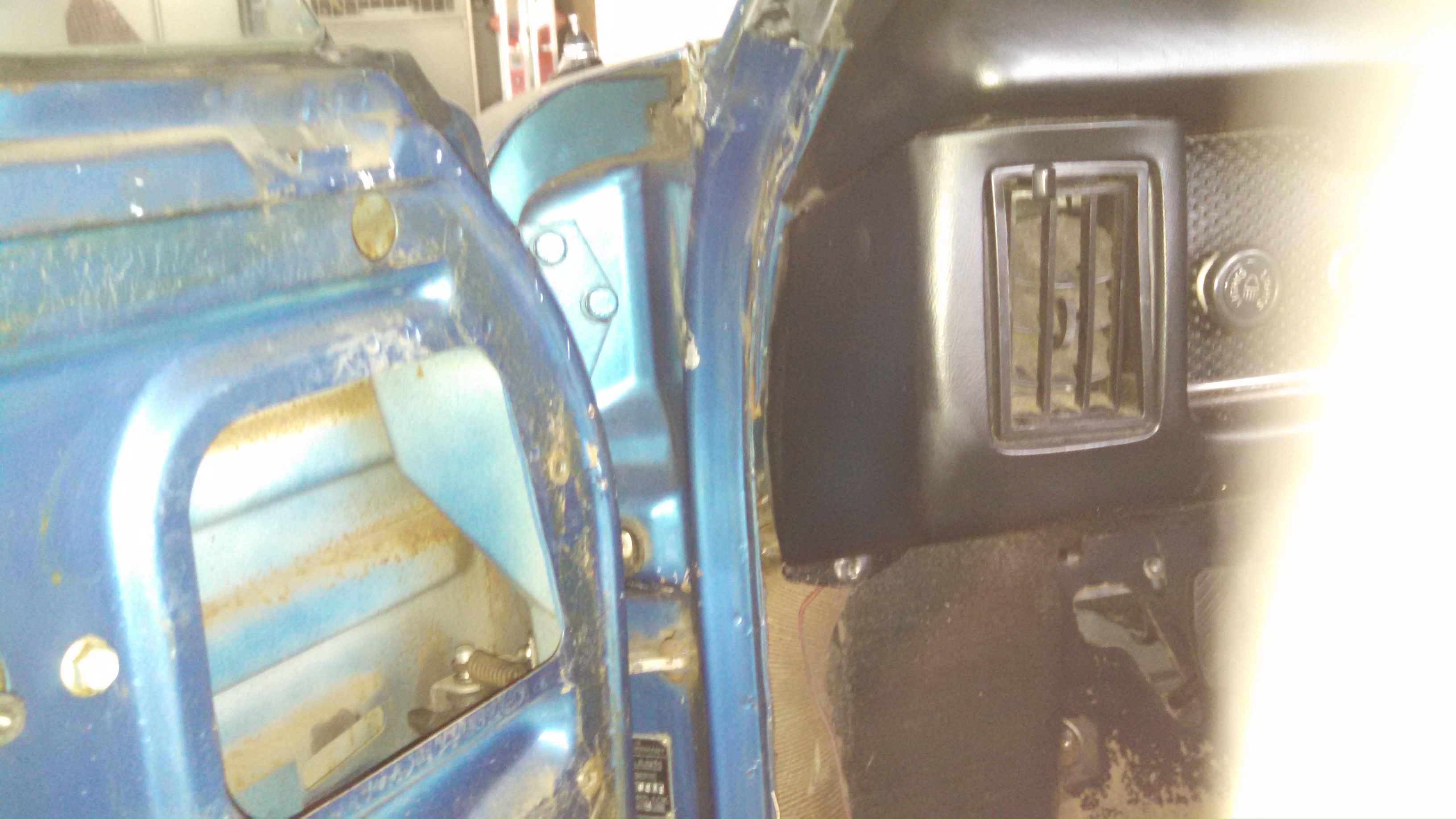

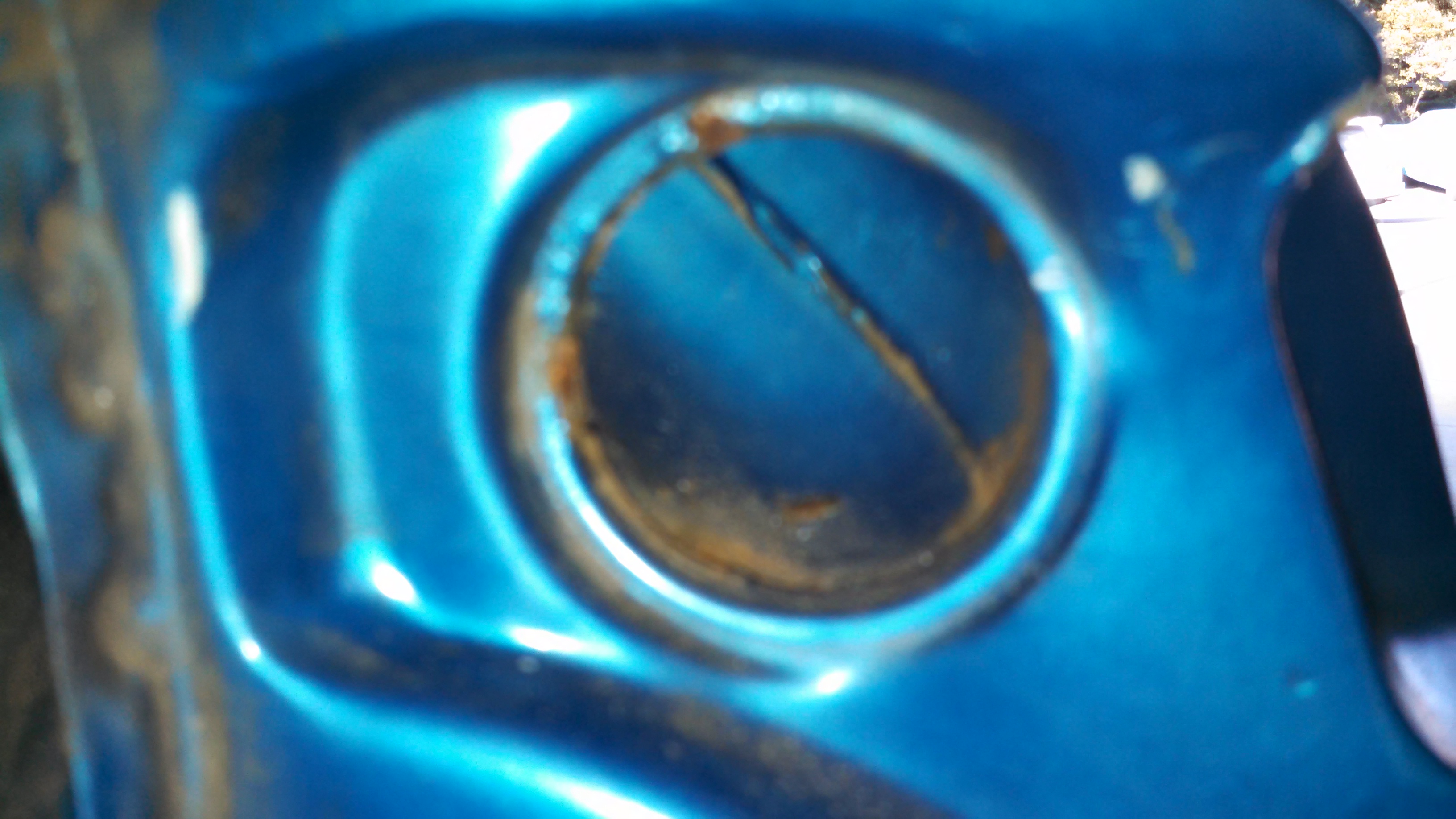

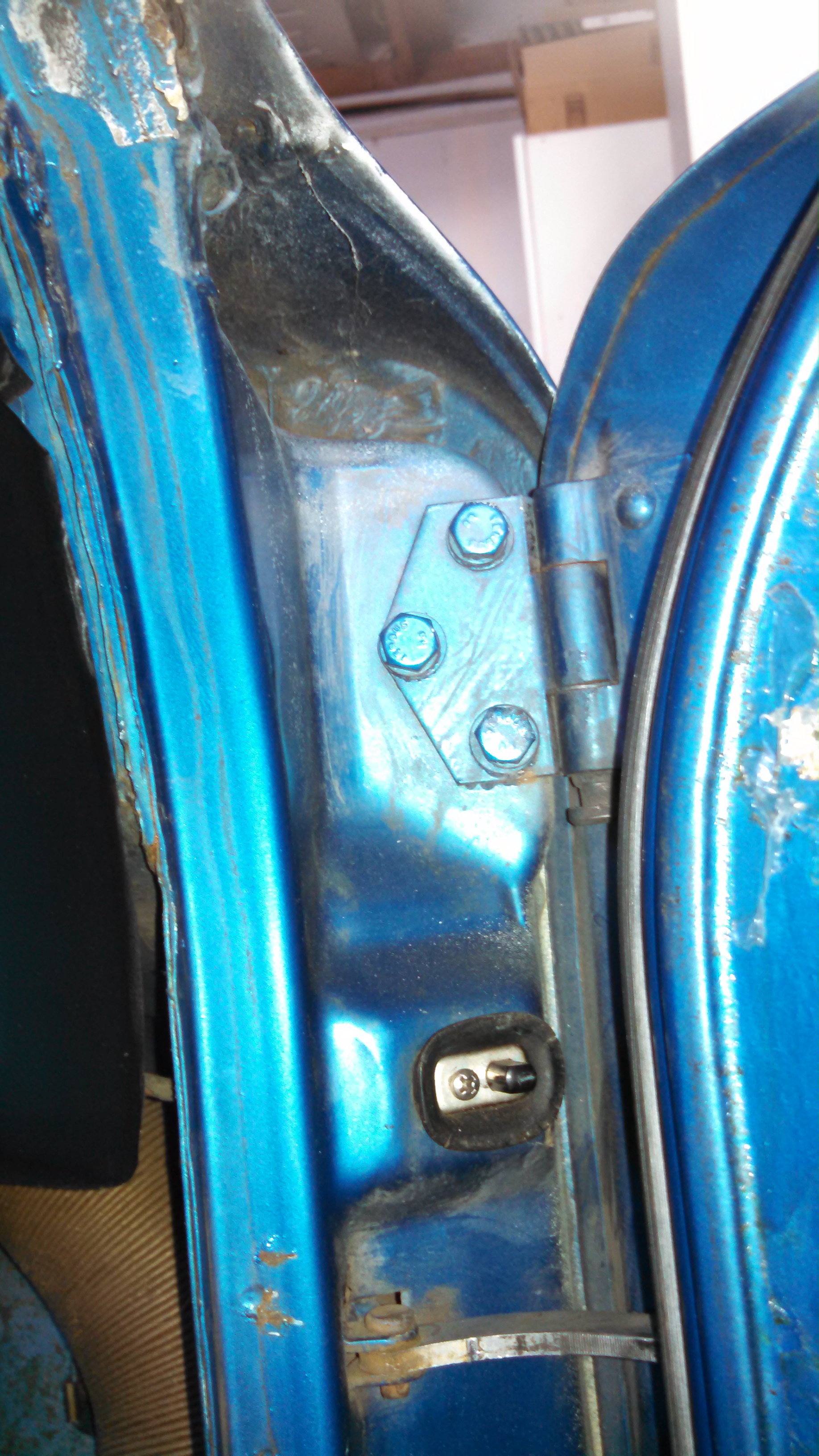

Door Jams:
JeffBowlsby
post Jun 6 2015, 10:38 PM
Posts: 9,378
Joined: 7-January 03
From: San Ramon CA
Member No.: 104

Thanks Jeff. I'm going to strip her down as far as I can get her and then send her out for body work. Same for the motor. There are some things that are just beyond my skill, and of course, my available time to actually work on the car. As far as i am concerned though, everything is coming off of the car.
Besides the continuing deconstruction of the car, I want to get a good look inside those longs with a camera (scope). I had the rockers off a little over a year ago, and there was some mild surface rust (very, very mild). Most worried about the passenger long of course given the hell hole and the completely rusted out panel below the hell hole where the fuel pump was originally mounted. I suspect some rust has worked it's way down inside there given the mild surface rust at the jackpoint. Pics of my longs from January 2014 are here: http://www.914world.com/bbs2/index.php?sho...=227937&hl=

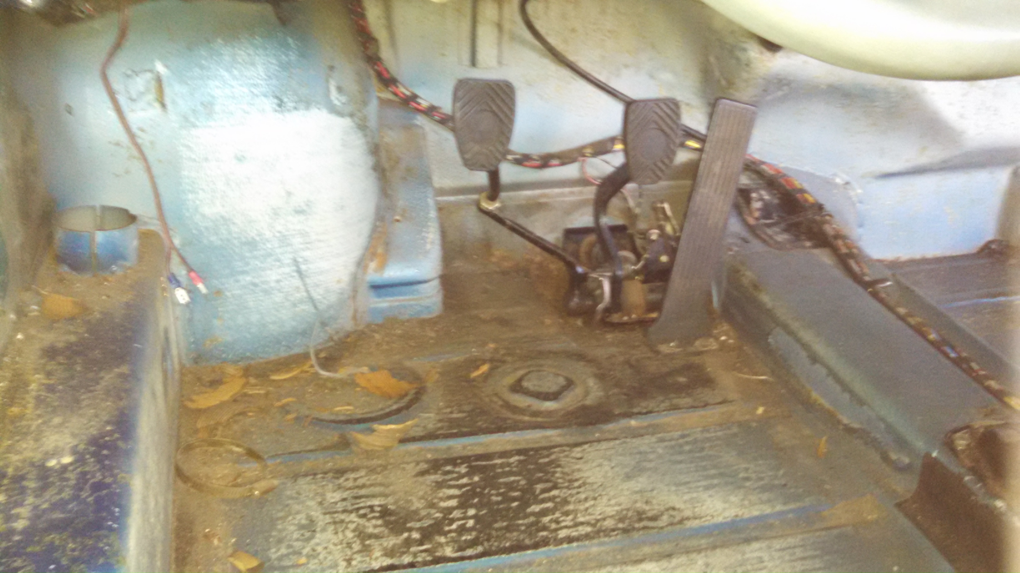

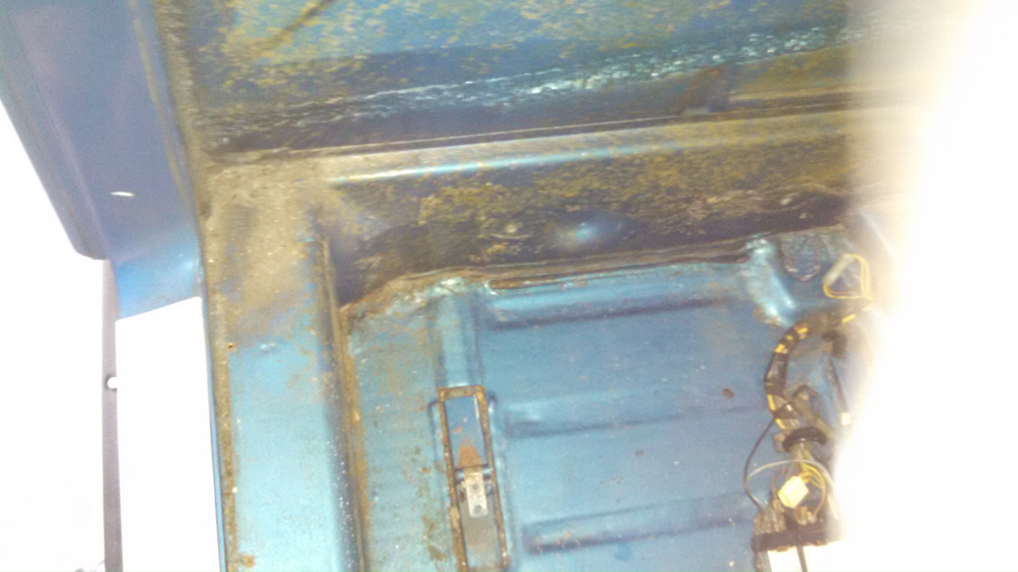

Day 2 of progress. Front of the floor pans looks good and took some shots of the rockers again which look good. However, the front hood channels and the front have some rust.
The car definitely had/has some water leakage issues up front, but looking at the hood channels, it's not a surprise.
Interior front floor pans:
boxsterfan
post Jun 7 2015, 07:58 PM
914's are kewl
Posts: 1,776
Joined: 6-June 03
From: San Ramon, CA
Member No.: 791

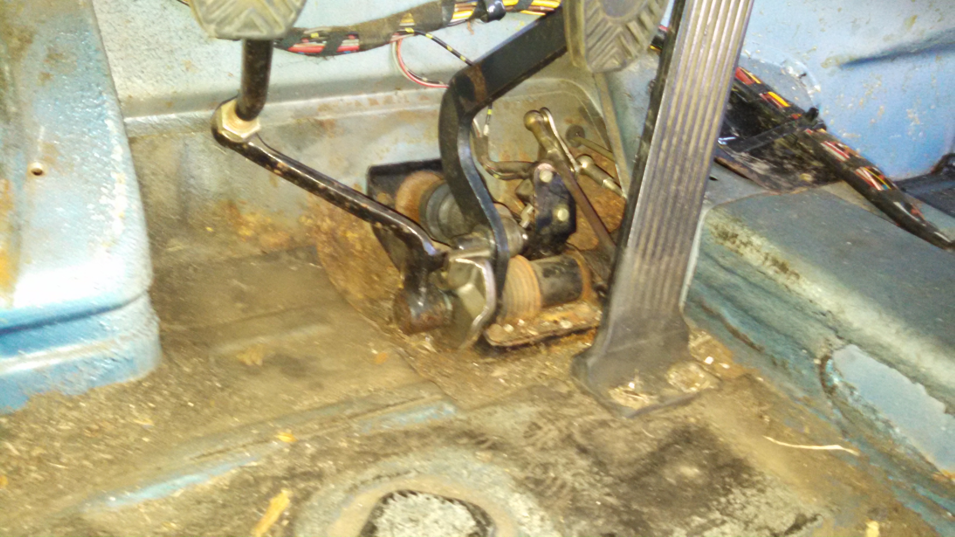

Pedal cluster close-up and shot inside the tunnel at the rear:
Note: Inside the center tunnel looks just dirty as I took my finger and swiped away some dirt in the middle of the pic.

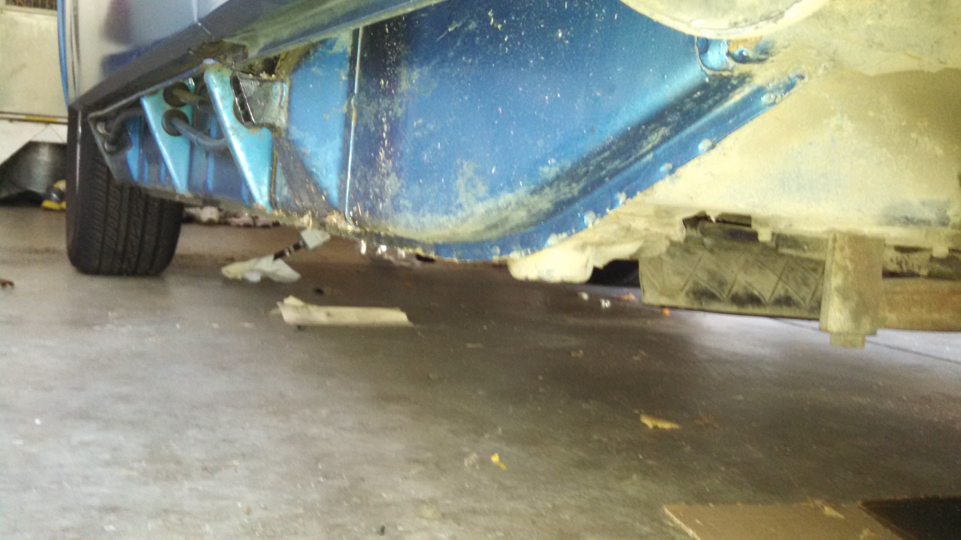

Driver's rocker:
