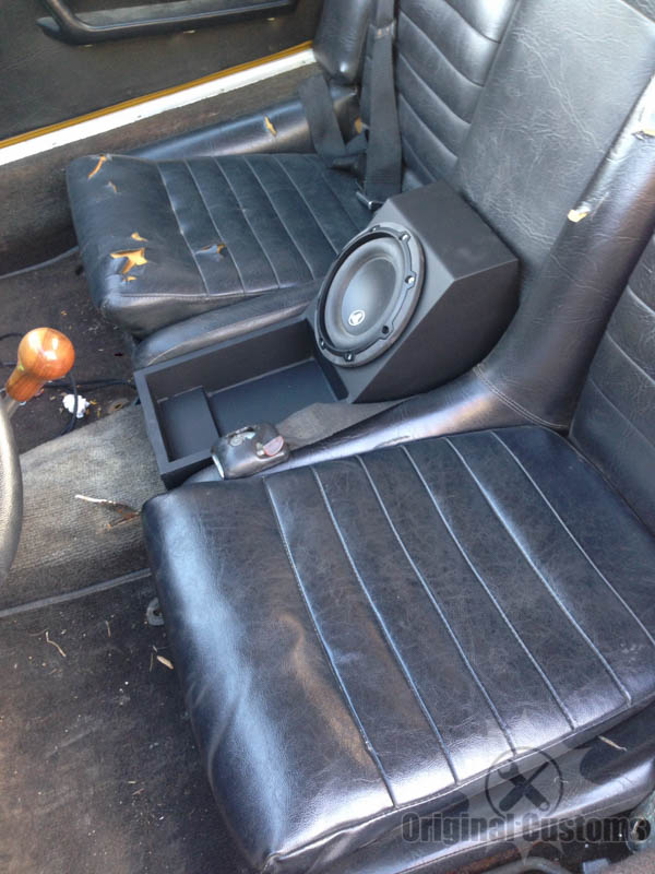

6.5" Sub between the seats. Just enough room and just a little bass to fill out the sound.

When someone has an opportunity I would like to see a picture of a foot rest subwoofer setup. Anyone willing to share? Thanks in advance.

http://www.914world.com/bbs2/index.php?sho...mp;hl=subwoofer post 15
