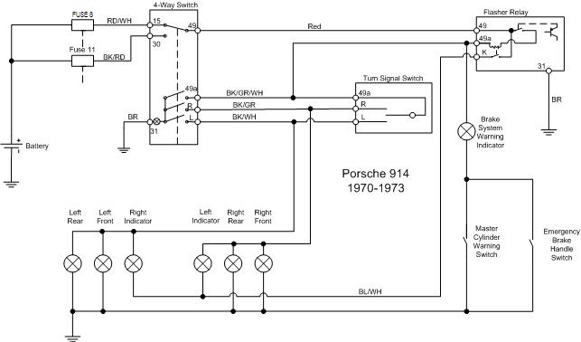

Second, the indicator relay. I was under the impression that it was located at the back of the fuse box, under the dash. But I couldn't find it there. So I turned on the ignition and used the column stalk to trace the sound of the relay... There it was, way up behind the dash, close to the back of the gauges. I couldn't reach it from the 'footwell position'. So, I'm wondering: would it be easier to remove the gauge cluster from the dash?
Funny thing is, when I pull the hazard switch, the light inside the switch blinks and 'clicks', however, there's nothing to see on the dash: no green lights. I was under the impression that both (hazard and indicator) are linked! Or has that to do with the fact that my car is a Euro Spec car?

The hazard switch can cause all sorts of turn signal light issues. All the turn signal wires pass through the hazard switch, on or off. A poor, corroded connection inside the hazard can keep turn signals from working. I'm ordering a new VW unit for a 72 bug and seeing how that works.
Also, replacing all your dash bulbs will really brighten things up. As will cleaning the grounds for the gauges and the ground lug under the dash. Remove the fuse panel to access the ground and to get the flasher unit. The fuse panel drops with just two screws and then you can reach up and grab the 'black box' that's sitting loose behind the switches.

You say the turnsignal dash indicators do not light for the 4-way flashers. Do the indicators work for L and R turnsignals?
If they are not working either both bulbs are burned out or the K terminal on your flasher is no longer functioning. The K terminal senses the current in the turnsignal bulbs; If the lamp current is low (brake warning light on), the dash indicators will not flash. If the lamp current is high (L/R turnsignals on), the dash indicators will flash.
The K terminal has a tendency not to function correctly after 40 years. You can remedy this by disconnecting the common wire from the K terminal to the dash indicators and connecting the common connection of the dash indicators directly to ground. Ground is found on one of the terminals of the tach.

This is an interesting discussion on turn signals and hazards (4-ways). I do not (and have not ... knock on wood) have any electrical problems with my '72. That being said, when I turn on the hazards, the knob flashes, the emergency brake light flashes and the outer turn signals flash. I've only had the car for 5 years but that is "normal" to me.
