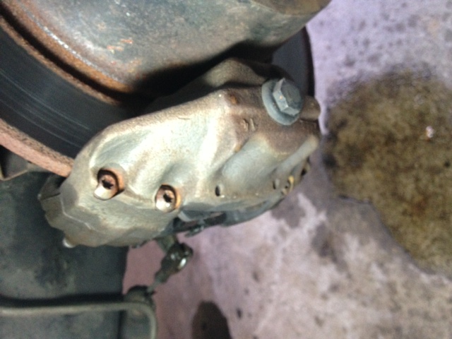

2. My biggest issue with the car is the rear calipers are dragging. I was told the parking brake was stuck when I got the car but it appears that pistons are stuck dragging against the rear rotors. The cables for the parking brake are moving the levers but you cannot get the car to budge in neutral with the parking brake on or off. I plan on getting rebuilds from PMB but after hearing that a lot of 914's are rolling around with inoperable rear brakes, I'm wondering if i can back the pistons off with the adjusters and be able to drive the car in the meantime?

my symptom is at least one of the rear calipers is not releasing off the rotor. maybe it is a parking brake issue but i had someone pull the lever and it appeared that the cables are moving the parking brake actuators. i haven't had all that much time to look into it. i'm hoping to dig deeper this weekend

so i put the car up on jackstands and dug into the rear brakes a bit today. cracking the bleeders did nothing. tried tapping on the actuators to see if if i could if the parking brake was stuck and would pop loose. no dice. it appears i'm looking at buying rebuilds from PMB. one thing i did notice seven though my car is a 74 it has the earlier calipers with the ribe bolts and only one bleeder. is there any reason to switch to the later style other than not having to deal with the ribe bolts?
