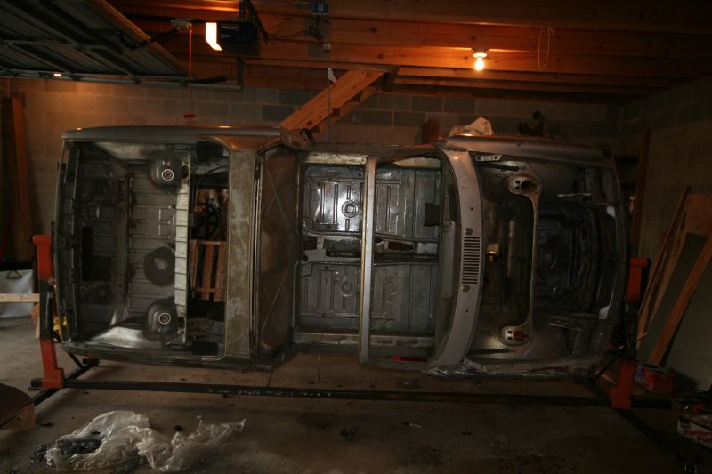

I really like the one for "Bringing out your Dead" but can't quite figure out the points it's mounted.
After bracing the doors, can I use the front jack points, a long support along the floors, the outer suspension console, and the trans mount area?

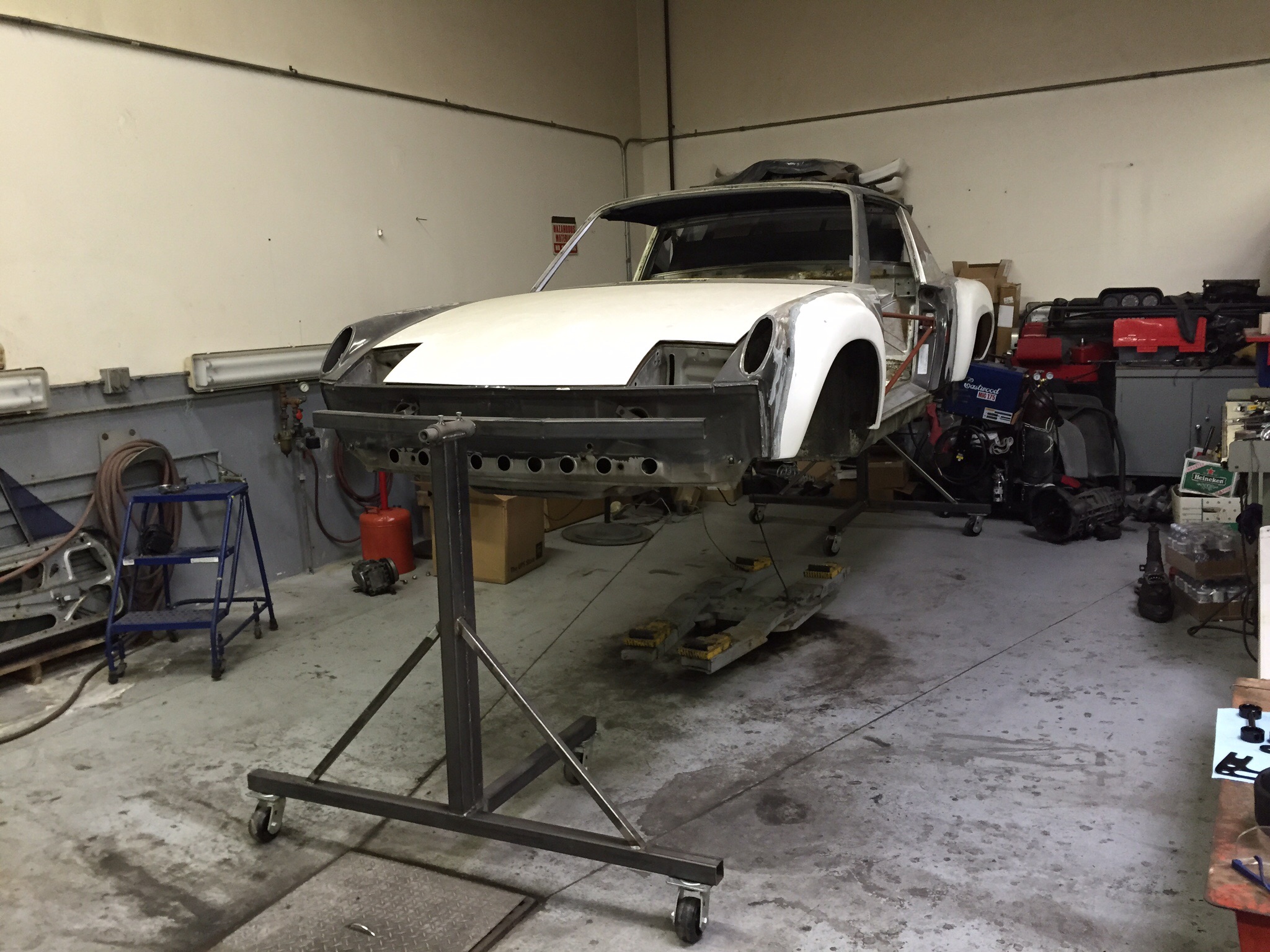

The 1.5 feet extra in front and back (if I understand correctly) should work, barely. You can build the rotisserie so it mounts closer to the car. I made this with no prior welding experience. I bought "the welders handbook" and my wife got me a 220v mig welder from Eastwood one Christmas. I went to a metal supply with the parts list from:
http://www.blueskymotorsports.com/index.ph...18&Itemid=6
I had to make a few adjustments based on material availability, but after about $300 in steel and an afternoons work cutting and welding I have this:
You're going to have to learn/practice welding anyway, thick material is the place to start. I have a 2nd 914 tub to work on now, I was thinking of building a dolly so I have one of each.
One thing to think about is how you're going to get it up in the rotisserie. I have a lift, so I have no need for attachments to raise or lower the car. I work on my cars alone so everything I do must be accomplished with one set of hands, a pain something's, but it is my retreat/my alone time.

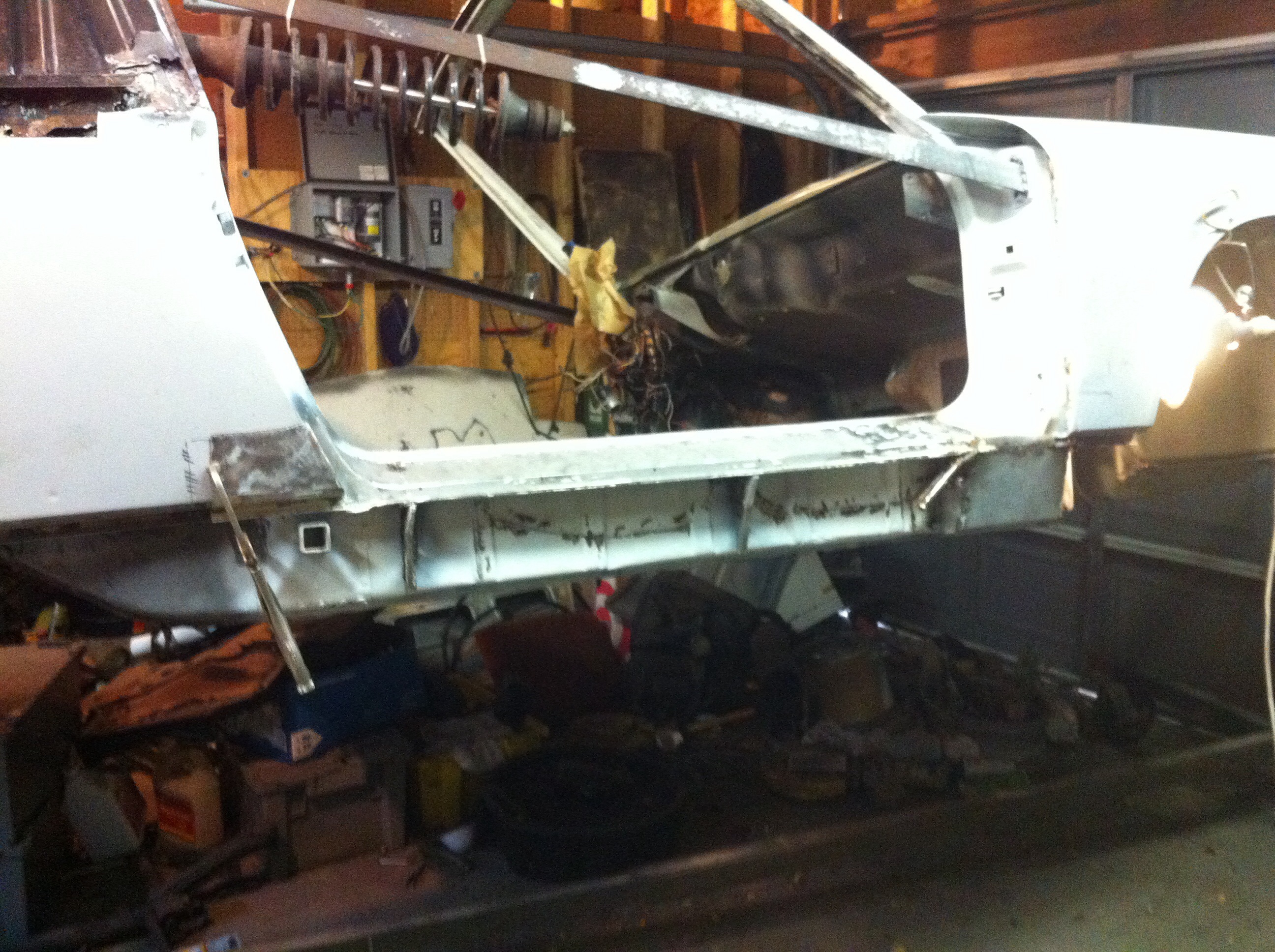

Either way, door jamb braces are THE NUMBER ONE PRIORITY!
Hinge hole to door latch, minimum. Better is both hinge mounts to latch mount and upper seat belt mount, with cross bracing.. Build a turnbuckle in for readjustment and that is even better...
My rotiserie was made of 2" thin and thick wall tubing for easy brake down and transporting.. Other was 1" square tubing and 1/4" plate. other parts by TSC/harbor freight. 6' come along was the only challenge, eithe mcmaster Carr or grainger
I can send/post more details

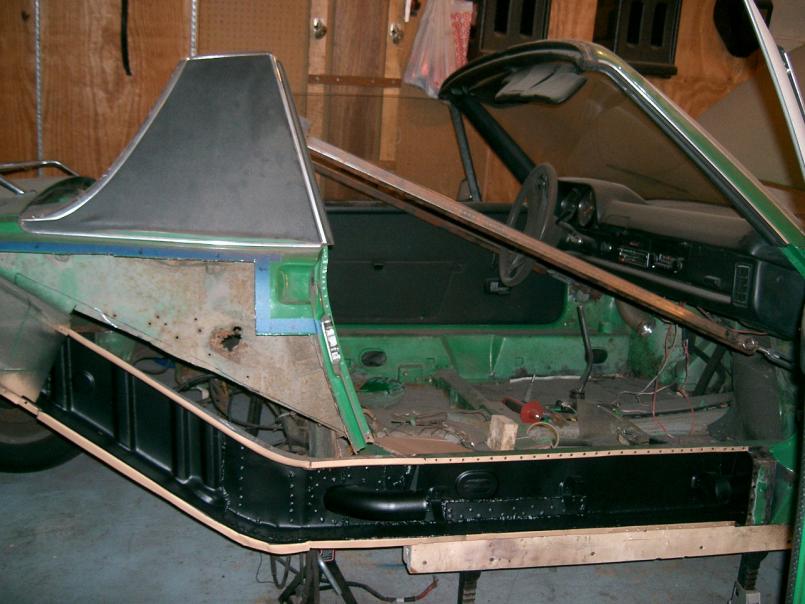

Bracing photo. Strut and pressure plate used for counter ballance to help from spinning too easily

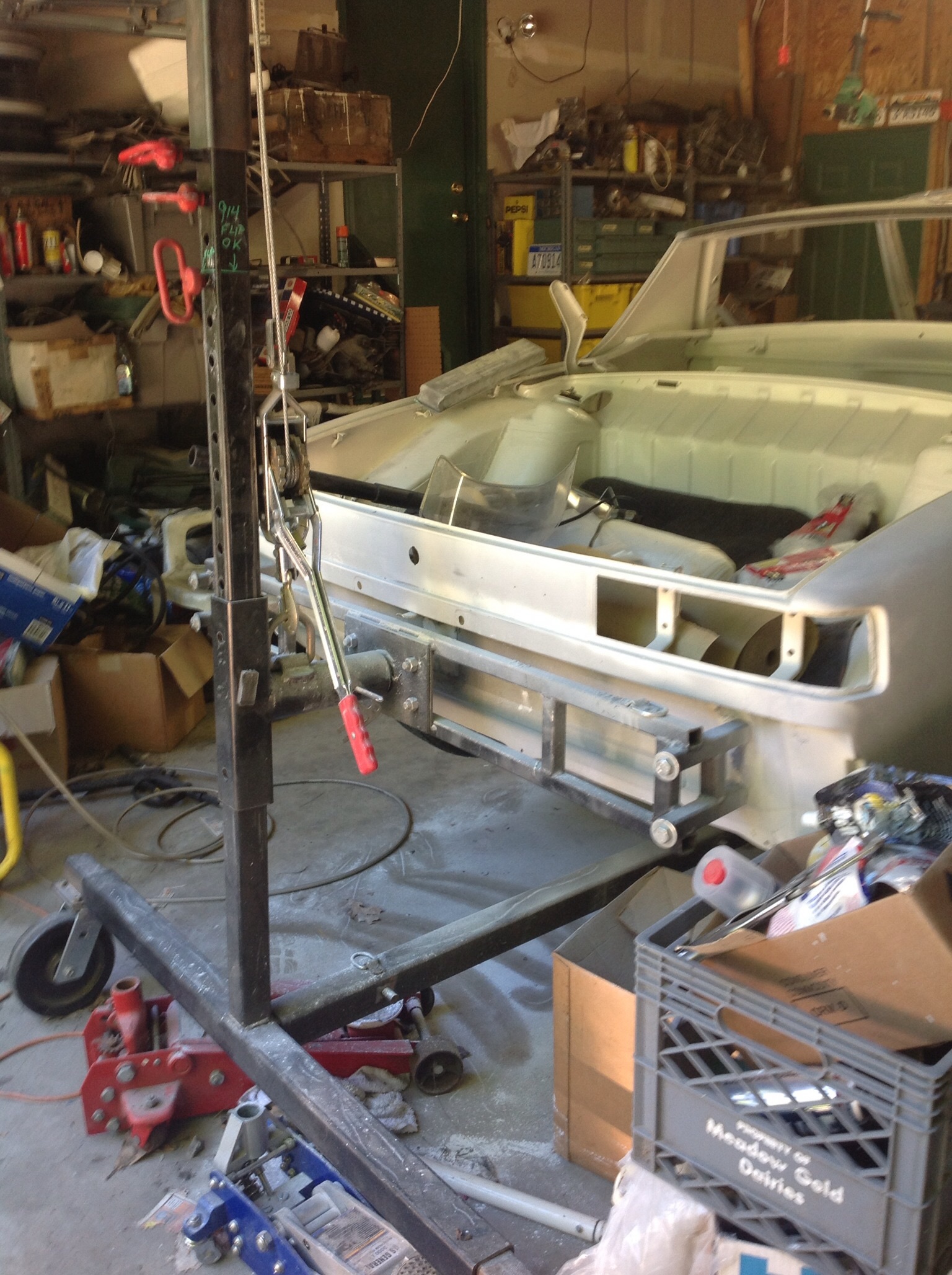

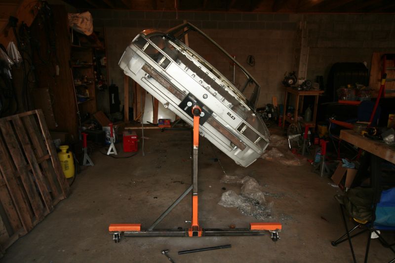

Build a rotisserie.
You will remove the bumpers and attach the rotisserie arms to the bumper mounting points. If your car is a 75/76 this is super easy. You just mount it directly to the bumper shocks.
(IMG:http://www.914world.com/bbs2/uploads_offsite/farm1.staticflickr.com-1435-1435836906.1.jpg)
Mine did not stick out much further then the bumpers and would fit in your garages.
(IMG:http://www.914world.com/bbs2/uploads_offsite/farm1.staticflickr.com-1435-1435836907.2.jpg)
My car is a 76, so I just bolted it directly to the bumper shocks. Pretty easy.
Mine was also built using 2 harbor freight engine stands. They were cheaper then I could buy the steel. I just cut them up and welded more to make it work.
I tried to talk myself out of making the rotisserie, but after I had the car up, I frankly could not see how anyone restored a car without one.

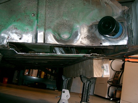

I had space constraints too. After installing body braces, I cut lengths of 2 X 4 and screwed them together with drywall screws. One side at a time, I held the car up with boards & jackstands to make repairs. It wasn't fun or efficient...but it did work.

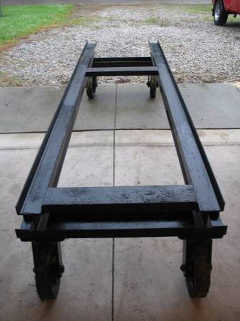

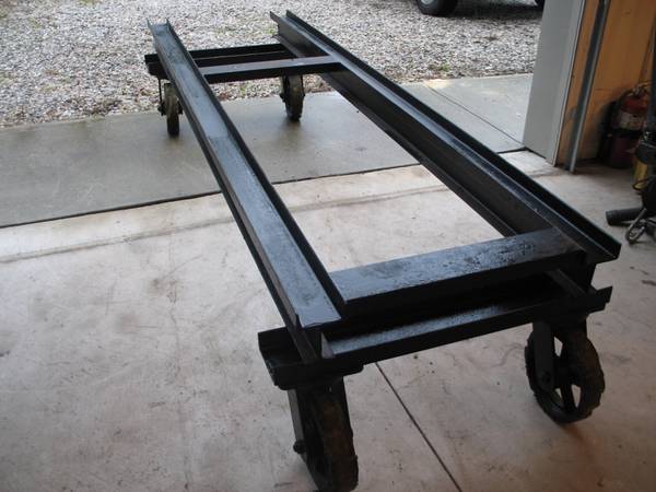

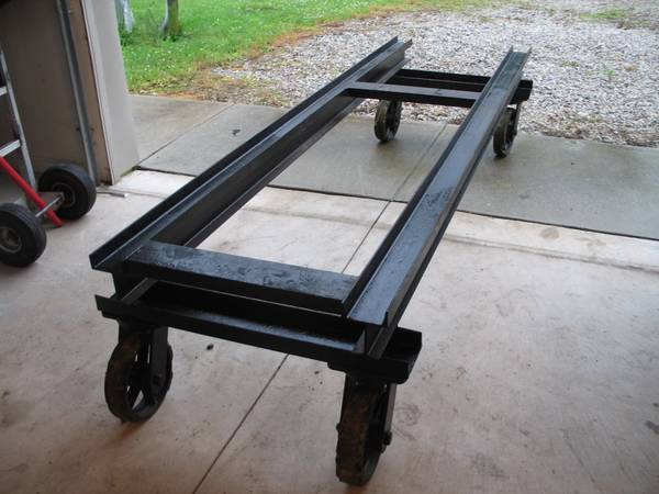

If anybody is in the Columbus area I found this on Craigslist.
Chassis Cart
Somebody please buy it so that I can't!
Cheers.
