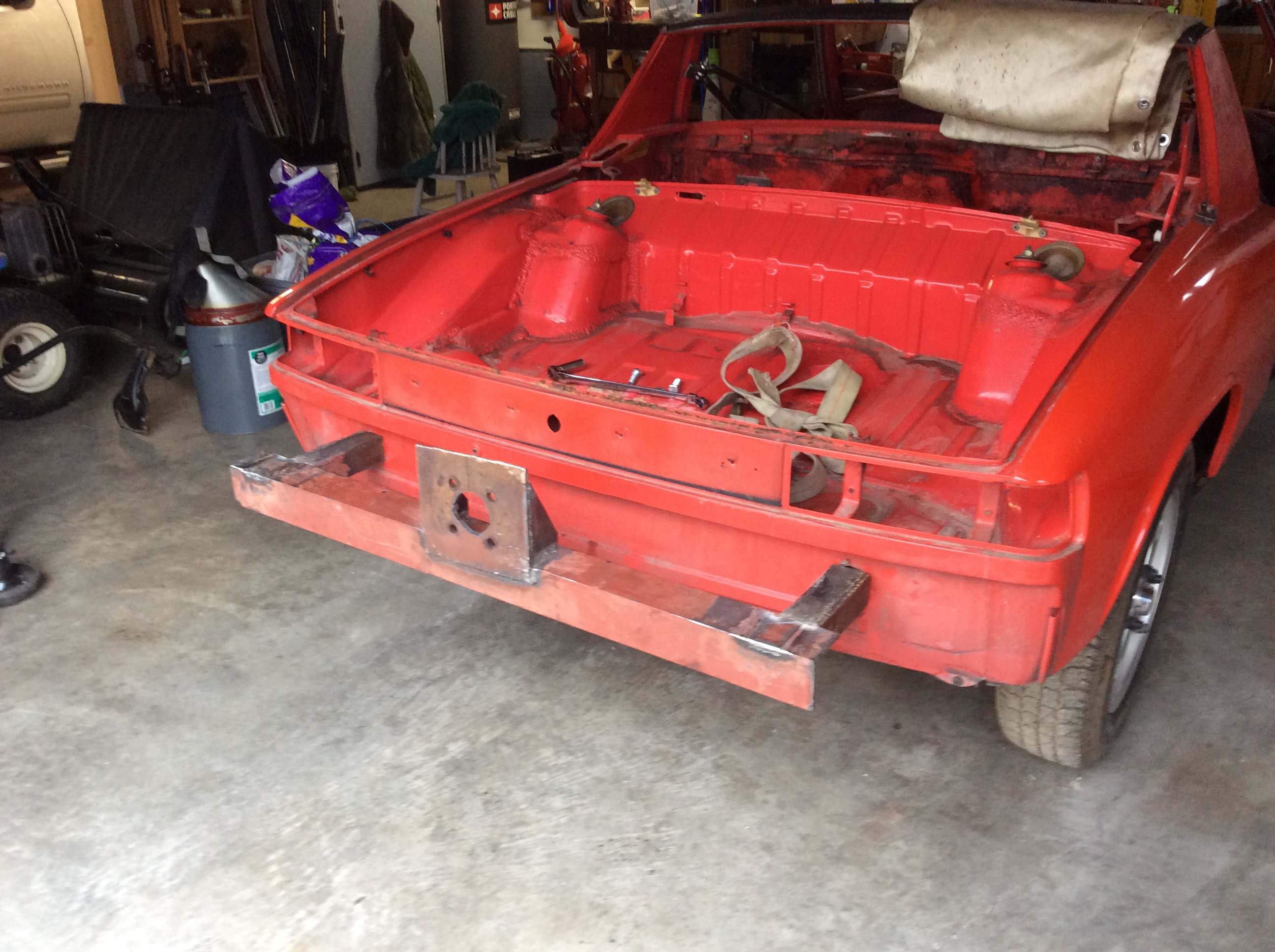

The young lad needs to build a rotisserie I like the Restoration Design 911 one, but how would you tie into the 914?
The engine stands at ends type takes up to much room.
On bracing, wouldn't you want to leave the door shells in to check gaps?
I don't think his car has front sway bar mounts so what would be a good alternative?
Although hopefully not near as involved as the one in the pic below, this is one of the repairs needed. So where would you tie into the rear?

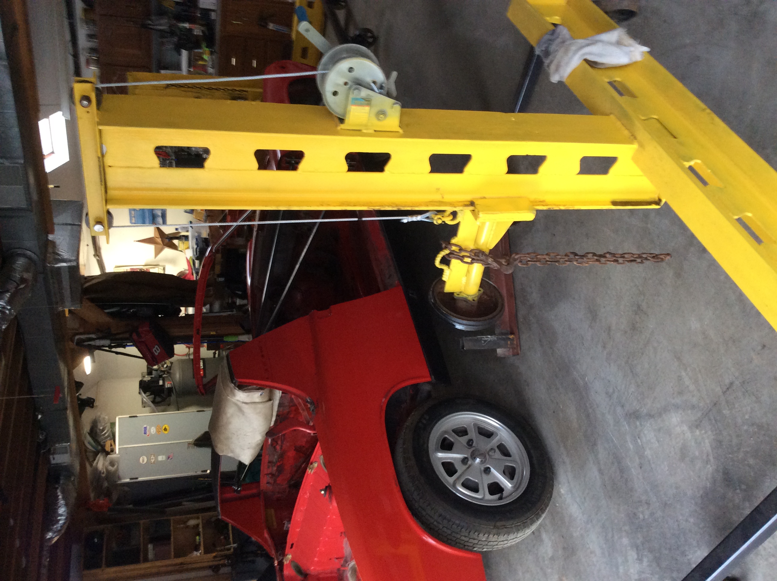

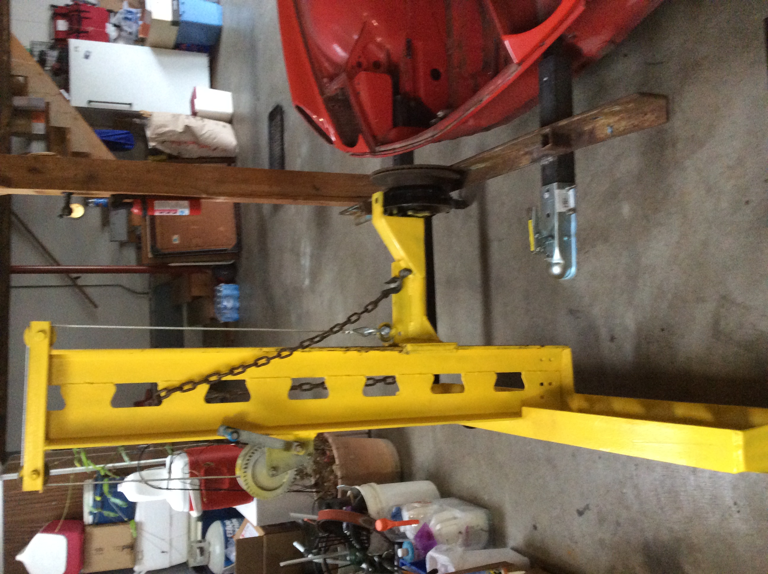

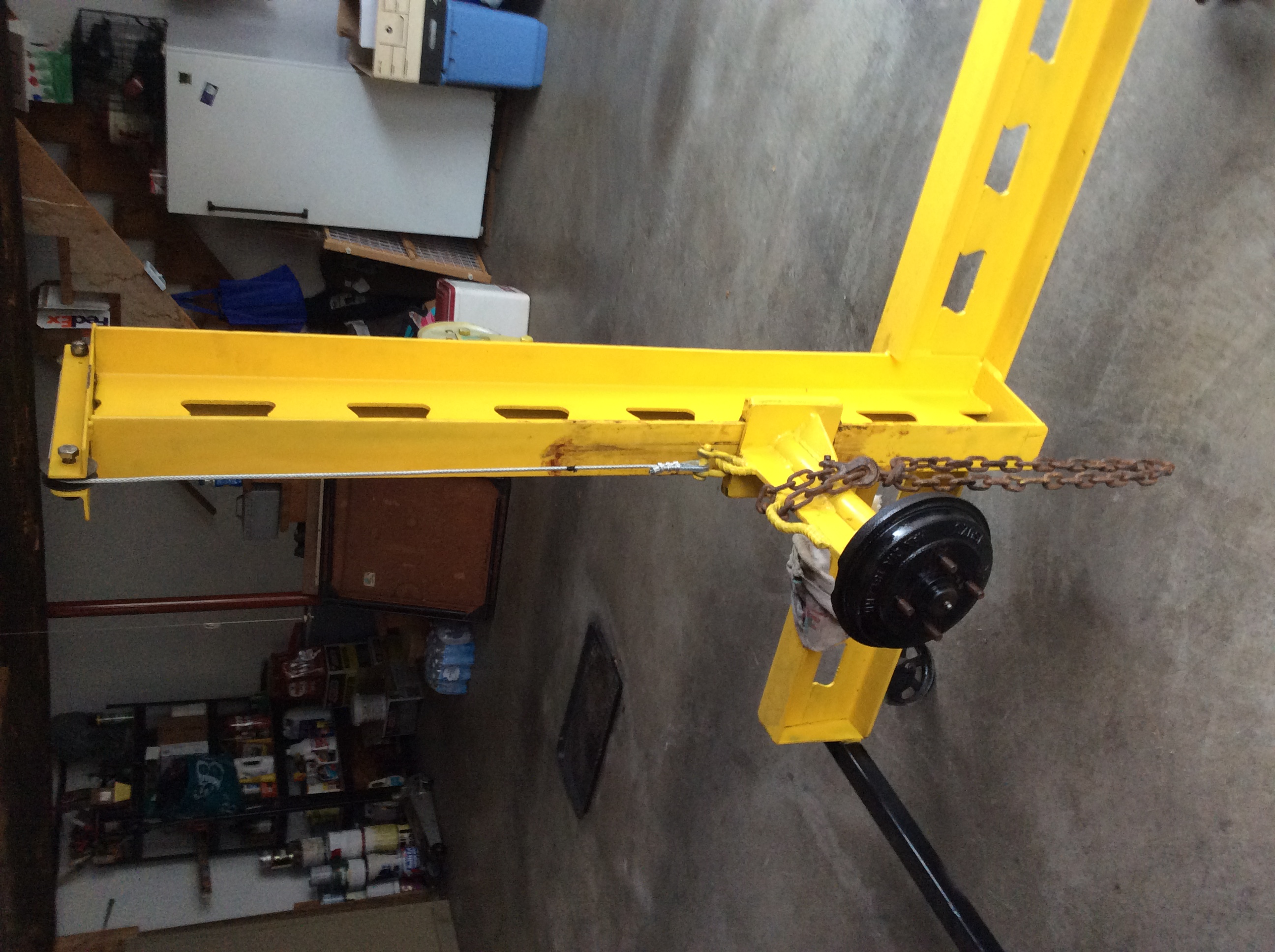

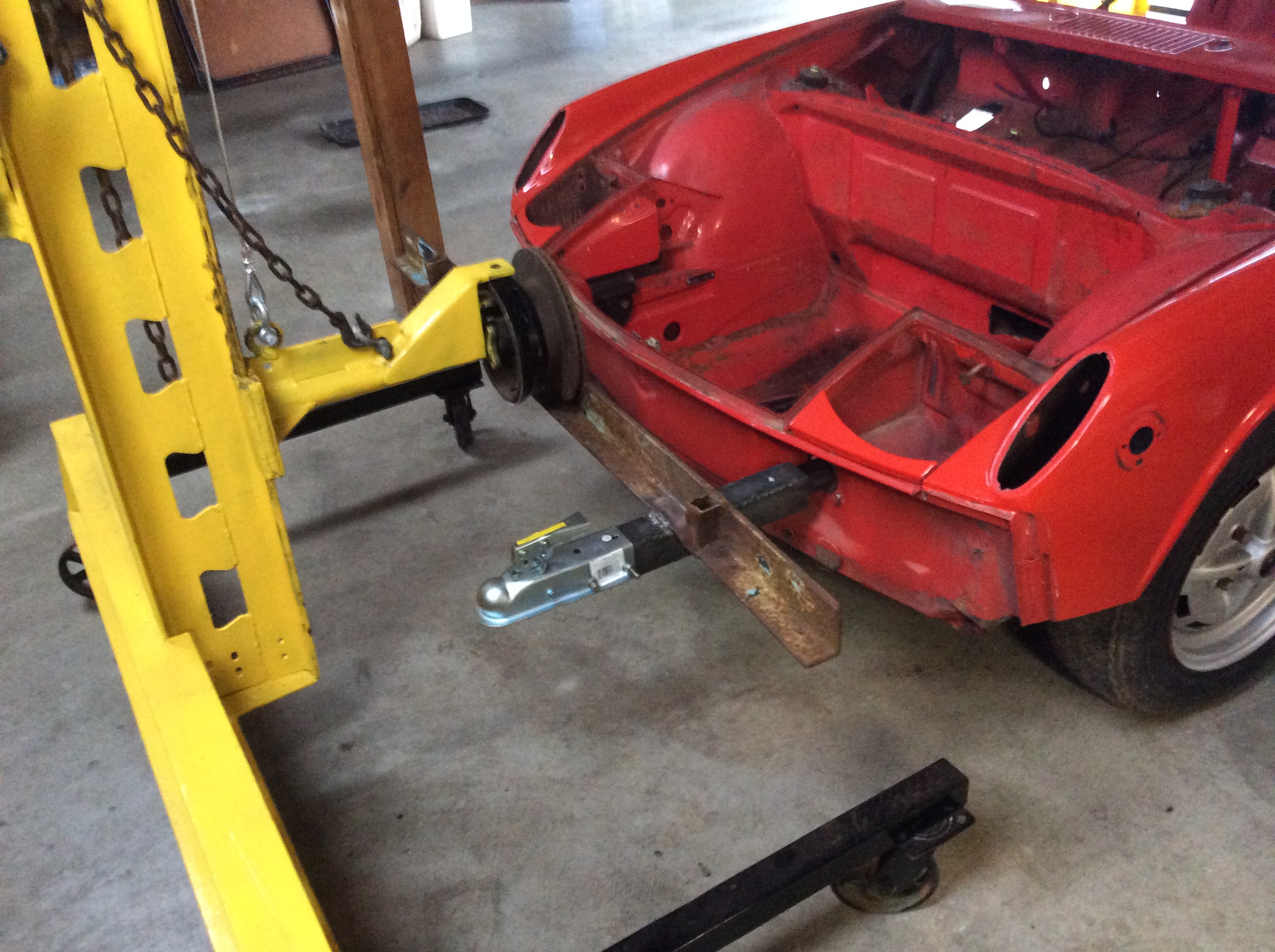

Lots of different designs for rotisseries on here. Heres some pics of one I rescued from my buddies scrap pile. He built it to float his 39 Cadillac LaSalle. Not sure but it could probably float a school bus. I’m just about ready to take my tub airborne. Just have to finish welding the bracket for the back bumperAttached Image Attached ImageAttached Image

A couple more pics Attached Image Attached Image

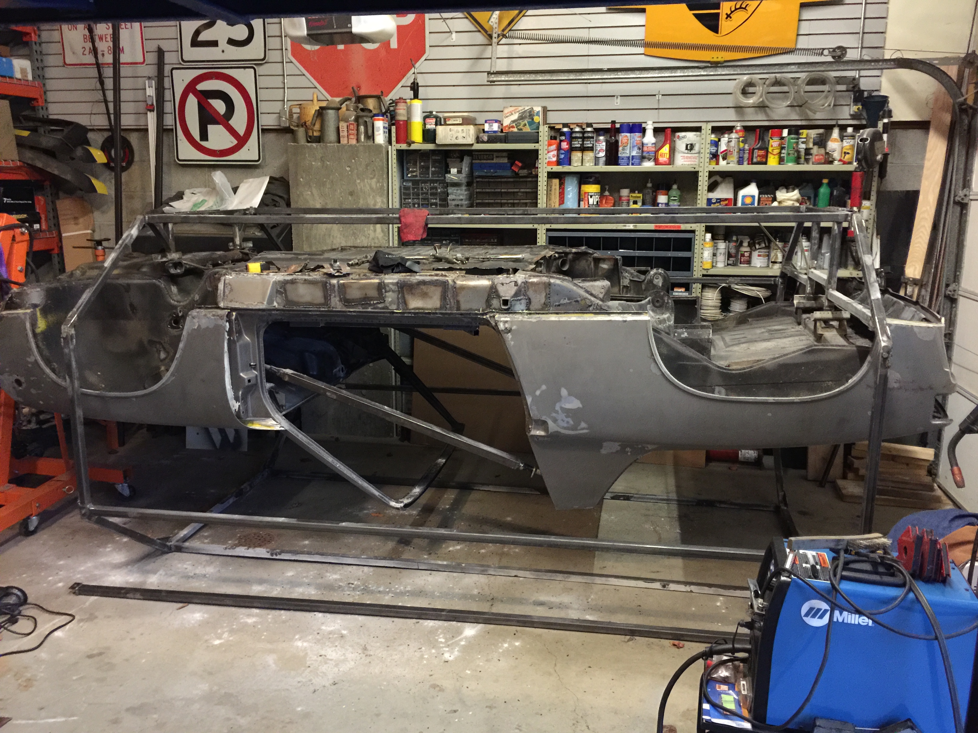

Not to poopoo RD's rotisserie idea but it looks like IMHO, it could use addition bracing to keep the chassis from twisting as it's rotated around. Especially so if the floor it's sitting on is uneven or it's construction is out of wack. Any thoughts on that?

I've accessed all the structural elements you reference on this dolly. Jeff Hail has this right. Strong, stable, level surface to work from. All dimensions are posted on his thread.
I've hard mounted at transmission mounts and the front crossmember.
In my case I'm replacing the inner wheelhouse without cutting the rear quarter panel for access. Because of this, I am not mounting to the rear suspension outer console but it is a key suspension point that needs to be properly located.
I'm very happy with this - it was well worth the time to build.

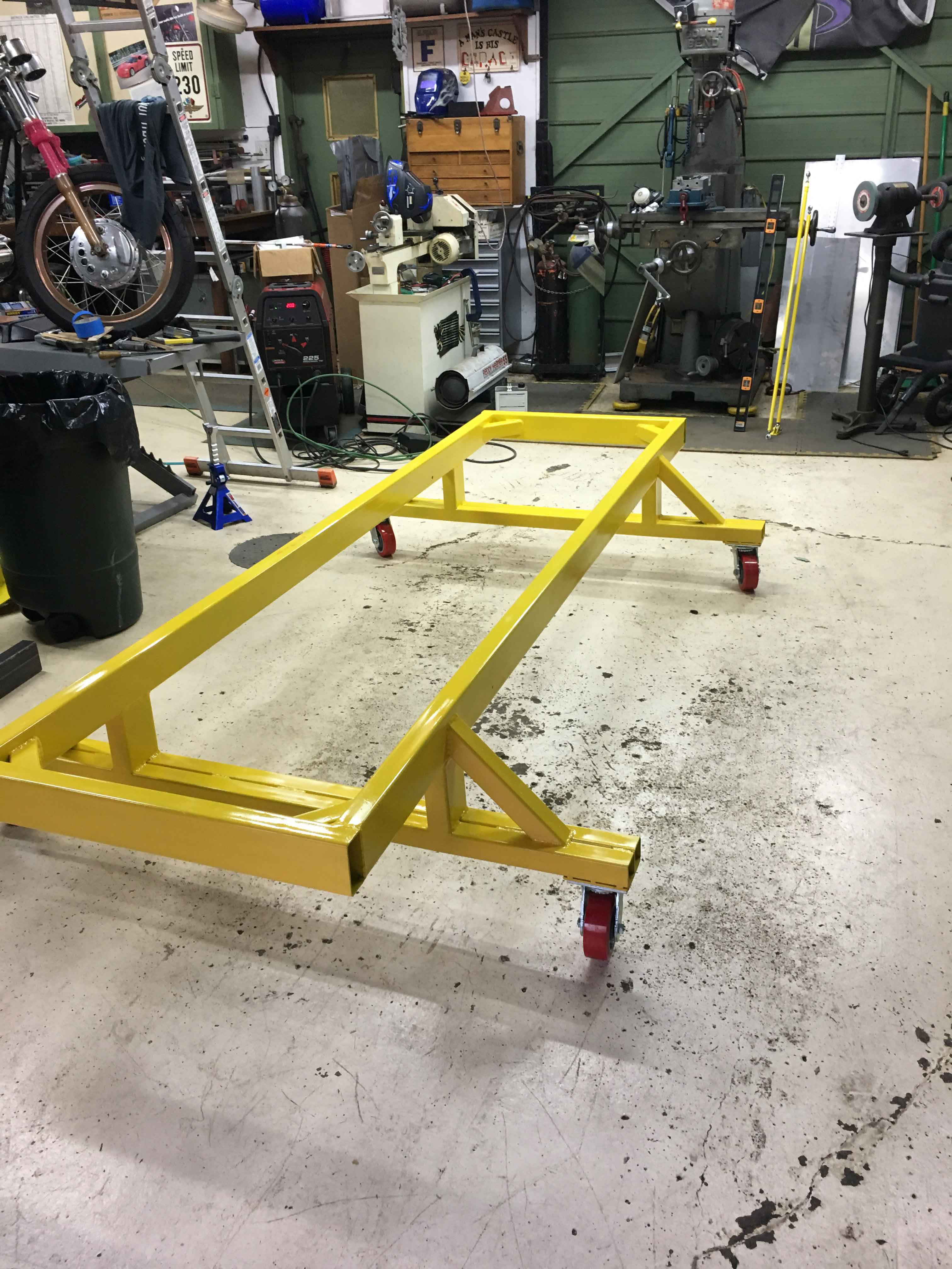

I am about to build a similar chassis dolly but will be integrating it into my mid rise scissor lift.
My question - which material is straighter/stronger, square tube or C channel??
I think the C channel may be a bit more versatile as the heavier wall and flanges might provide more options to weld/ clamp to ?

QUOTE(gereed75 @ Apr 26 2019, 09:26 AM) *
Square tube given same wall thickness.

QUOTE(billium01 @ Apr 25 2019, 10:03 PM) *
I agree. The RD rotisserie is great for a car that is structurally sound and has the doors braced, but it seems too flexible for fixing the longs where you have to cut out too many parts that keep the car rigid.
