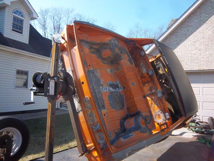

Build a dolly, as high as you want. Mine I even use on my scissor lift. Best, MarkAttached Image

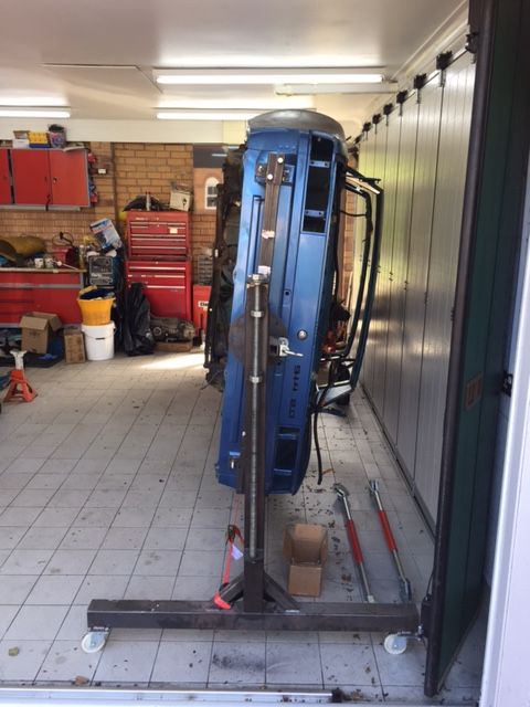

I saw this one on Pinterest, and it really inspired me.
It seems so simple, the way it solves the issue of raising and lowering the car, like it was built by druids. (IMG:style_emoticons/default/biggrin.gif)
I've always wanted to build in the ability to raise the car off the ground with suspension and wheels on, and to raise it up high enough to flip it and clear the windshield frame.

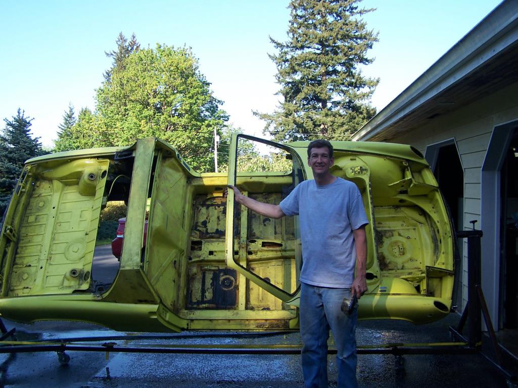

My Longs were in good shape, but if I knew better I would have braced the doors
Look how skinny I was! Lost 21 lbs since the heart attack, but I don't think I'll ever
be that small again

Interesting, only issue I see is that is all thread, it would take forever to raise and lower it. Your thread pitch will determine the speed. Also technically it is the wrong thread design for the job. jacks use a square cut gear for lifting and lowering. pitched thread is good for clamping. But hey it will work.
The one I built uses a welded nut on the end of the winch handles. You can stick a socket on the end of a drill, and it will be at the top, in a minute.
nathanxnathan
post Mar 3 2020, 06:32 PM
Post #56
Posts: 294
Joined: 16-February 18
From: Laguna Beach, CA
Member No.: 21,899
QUOTE(914forme @ Mar 3 2020, 04:24 PM) *
Yeah acme thread would be better for sure
