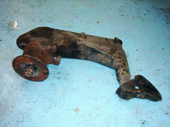

Just thought someone might know the answer to my questions.
Problem is my Control arms appear to be really, really stiff in their
movement (after the struts were removed) With nothing restricting
their movement I found it very diffficult to move them up or down
to simulate the normal suspension travel !
The bushings appear to be just the factory "rubber' ones and nothing
seems to pivot very well. Is this normal ? Should I be concerned ?
Any comments are appreciated. Thanks
Allan

bondo   Mine were like that. I think it's normal, or n...   Feb 24 2005, 10:51 PM
skline   Are they new? I know when I put my new rubber ones...   Feb 24 2005, 10:53 PM
Eric_Shea   The main thing to do at this point (while they...   Feb 25 2005, 09:26 AM
davep   Basically, the shaft and arm are both bonded to th...   Feb 25 2005, 10:47 AM
ajracer   Thanks Guys ! The rubbers appear to be in gre...   Feb 25 2005, 12:05 PM
davep   No, don't use penetrating fluid, that could ma...   Feb 25 2005, 12:13 PM
Joe Ricard   Some would say that if you are going to add more p...   Feb 25 2005, 12:21 PM
turbo914v8   Hey Allan buy my tub and you will get all that and...   Feb 25 2005, 12:25 PM
ArtechnikA   <...   Feb 25 2005, 01:00 PM
