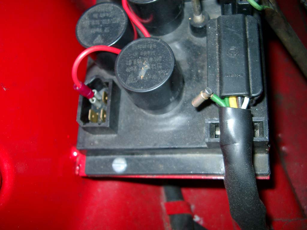

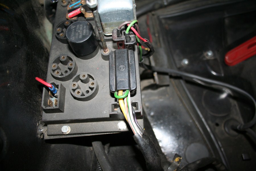

Back by popular demand, Sir Andy's "HOW TO" series presents:
HOW TO: Run the fuel pump for carb conversions
There are numerous tech. articles out there that cover this issue.
When you switch from the stock FI to carburetors, you have to install a low pressure carb fuel-pump.
But, since the FI fuel pump is controlled by the FI brain, removing the brain means the wires to the fuel pump won't give you 12V ...
There are a lot of "band-aid" solutions out there, some people remove the pump relay and add a jumper there, others even run the pump off the coil!
While all those solutions work (more or less) they all lack one thing, you're now running the pump without a relay! (and in case of the coil, without fuse as well)
The best (and also easiest!) solution is to trick the relayboard into believing that the FI-Brain is still connected ...
And it's as simple as connecting one wire from the 4-prong FI connector to ground.
You keep the stock fuel pump relay and fuse and you use the stock wires to power the new fuel pump.
Below you'll see 2 pictures showing how to attach the wire. on the pump side, simple make 2 more extension wires with "male" connectors on one end and plug them into the stock (roundish) plug for the stock fuel pump.
No need to hack into the original harness!!!
This install is clean and simple! (and cheap!)
In the pics below the thick red wired replaces the FI-Brain ...
(IMG:style_emoticons/default/smash.gif) Andy

Do you have more pics? Other angles? Can a person with a wire, and two crimpy ends do this in less than a minute?
Who took that picture?

Thanks, I am riunning mine off the coil.
Whats up with the green wire pulled out of the harness in photo #2 ?

QUOTE(redshift @ Feb 25 2005, 04:51 PM)
yes ...
yes ...
me, myself and i ...
the engine harness is from my old 1.8L which had the green wire for the heater blower in the engine harness. my car now has a '74 (?) main harness and the wires (green/brown) for the heater blower are spliced off the the main harness instead.
i didn't want to cut the hard plastic protection of my engine harness to remove the wire but i had to take it out of the connector as the layout of the prongs changed between '70 and '74 ...
wouldn't a good German use a brown wire?
yes, but i didn't have any handy besides the red one. some day, i'll change it to brown.
not on top of my list right now ...
(IMG:style_emoticons/default/rolleyes.gif) Andy

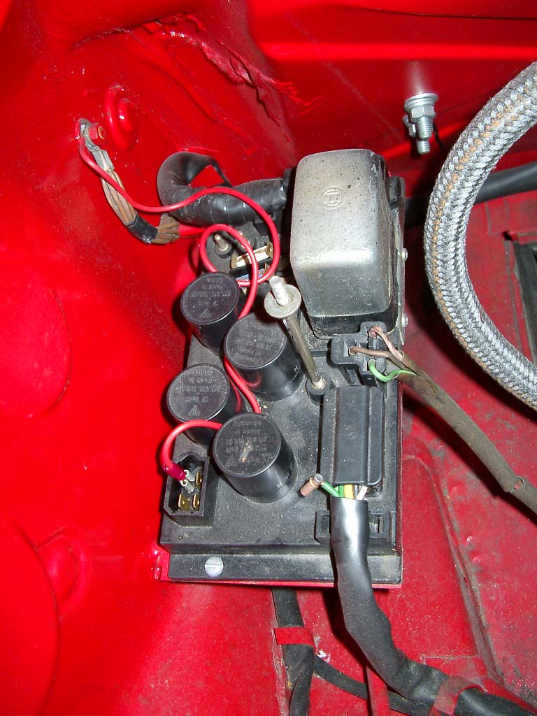

heres a minor twist to this system, on a 1.8 the fuel pump relay is in the relay pack, so no relay there. what i did is to put a realy in the fuel relay spot as a spare, and i had a short wire from the screw that hold the realy board in place with a connector on it, when ever the fuel pump was needed or the relay pack was acting funny i just pluged it in.
now on the suby harness i an using the suby fuel pump relay to ground the stock fuel pump relay out through that pin , that way the suby brain still sees the suby relay in its wiring and it does its job

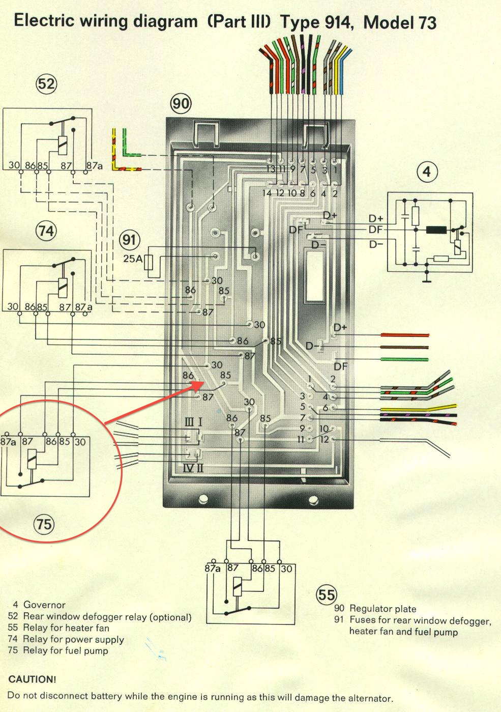

I did this conversion and it didn't work.Where is the relay so I can see if it's still good.Had to go back to running it off the coil.
McMark
post Nov 3 2011, 11:09 AM
914 Freak!
Posts: 20,180
Joined: 13-March 03
From: Grand Rapids, MI
Member No.: 419
Third position...

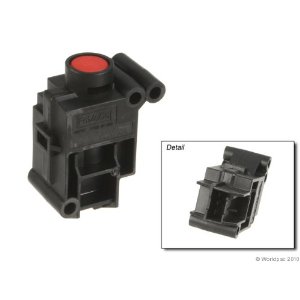

Another "twist" to this approach . . . .
Because the pump will run as long as the key is in the "on" position, I wired a fuel pump inertial switch (from a Ford (IMG:style_emoticons/default/dry.gif) ) into the wire running from the 4-prong FI connector to ground (the "red" wire in Andy's pictures). That way if the car is in an accident, the ground is "interrupted" and the fuel pump stops (NOTE: this is a little different from Ford's approach, which puts the switch on the hot side of the pump instead of the ground).
Here's a picture of the switch:
The switch costs 25-30 new at your FLAPS; I got a couple of used ones at the local pick-n-pull for a couple of bucks each.
These switches have been known to go bad once in a while, but mine has been good for a couple of years.
Here's a link to a site that provides some good info on the switch:
http://www.therangerstation.com/tech_libra...rtiaSwitch.html
Instructions for installing the Smart Racing Products (SRP) version of the switch are here:
http://www.smartracingproducts.com/pdfdocs...fuelshutoff.pdf
My switch is currently mounted near the ground post just forward of the relay board cover. I'm thinking of putting it in the + side like Ford did--and as recommended in the SRP instructions. Then I should be able to mount the switch somewhere in the passenger footwell.
Hope this helps!

Now everyone knows to trip the switch to disable your car. (IMG:style_emoticons/default/happy11.gif)
I did that back in 89 while Christmas shopping at the mall. I was driving an old Dodge Aspen, and was waiting for a parking space. The person in the space backed out toward me, and a "Female Dog" in a Lincoln Town car cut right in front of the car backing out and quickly pulled into the space. She jumped from the car and took off into the mall. So I just pulled up and bumped her car with the old Dodge.
Later I came out to put some packages in the trunk of the Dodge, just to hear her grinding away on the starter till the battery died. I went back in the mall and when I came out again, the wrecker was pulling the Town Car out of the parking space.
I so wanted to tell her what happened after the car was on the flatbed on it's way to the shop, but I didn't get the chance.

Just got two of those inertia fuel cut off switches from Summit Racing- supposed for a Ford and look a little different than the ones in this thread. This was discussed on a thread a couple weeks ago I haven't been able to relocate on the search function.
They came with no instructions but I put the switch in the front trunk near the pump next to the spare tire on my '73. I luckily mounted it vertically (as instructed in the switch on this thread) and "assume" that is correct. I have sent a question to customer service at Summit to confirm.
Need to install it on my '71 but will wait to confirm that this model is also supposed to be mounted vertically.
Will be some piece of mind, though I must admit I've been driving the '71 with carbs without the switch for over 15 years! Luckily no issues but I don't drive it a lot...

I tried this on my '74 with carbs which had been running the fuel pump off the coil. No luck, checked the black/red wire at pin 13 for continuity to the original fuel pump plug and that was good , double checked that my ground on the 4 tab connector was good, but still nothing. I traced the black/red wire from pin 12 which used to go to the aux. air regulator in the FI harness but was now cut off near the distributor, and had continuity all the way back to the fuel pump plug. Get everything but volts when I turn on the key. Fuel pump turns on with key when I plug it into the other tab on the 4 tab connector. Any ideas what I am missing here? Or what else I can try? Any guidance would be greatly appreciated. (IMG:style_emoticons/default/idea.gif)
post Apr 5 2018, 02:05 PM
Resident German
Posts: 42,488
Joined: 21-January 03
From: Oakland, Kalifornia
Member No.: 179
QUOTE(Jonathan Livesay @ Apr 5 2018, 12:24 PM) *
Are all the relays in place and working properly?
