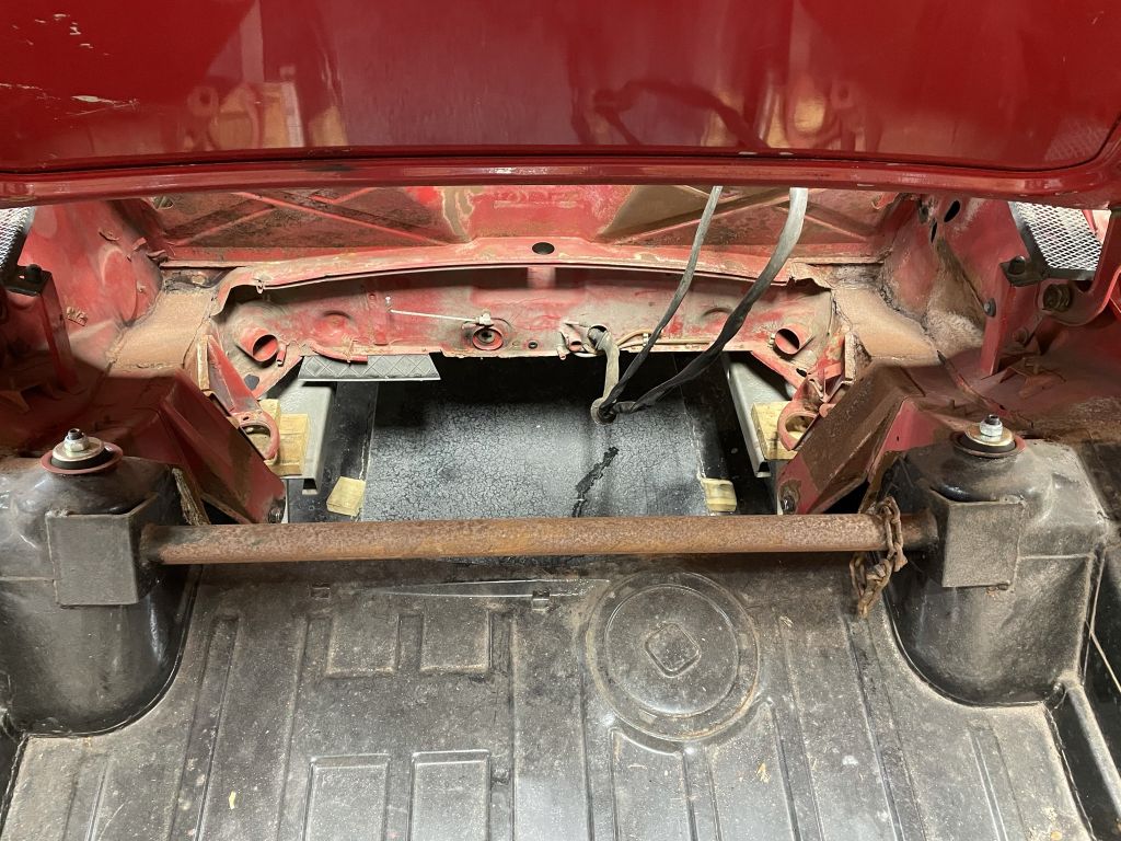

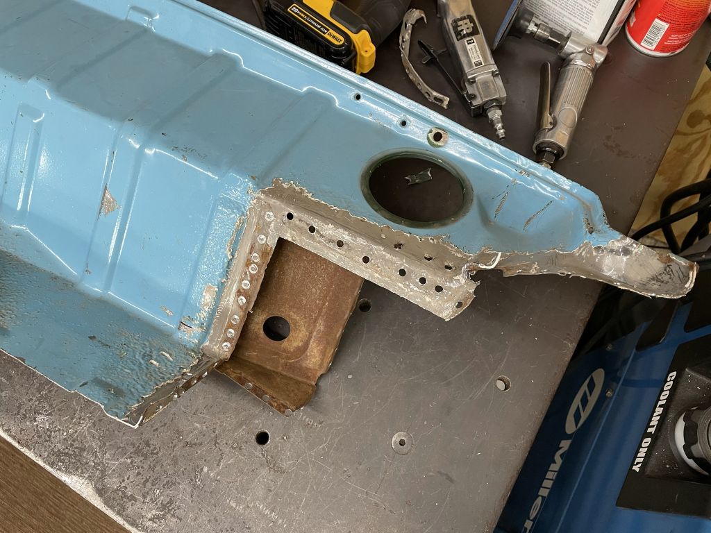

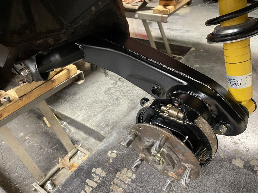

The trunk replacment is pretty much free of extra sections. Still lots of grinding to clean up the weld areas and will need to trim the floor to size once in place.
This is what it will be replacing.

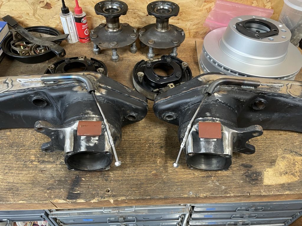

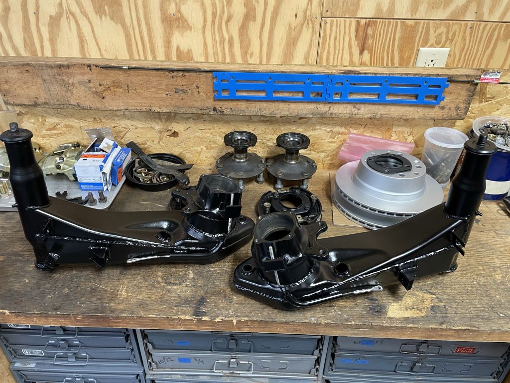

I needed a couple of nice days to work on the trailing arms so that I cold grind/paint outside. Last weekend was an amazing couple of days of Ohio spring.

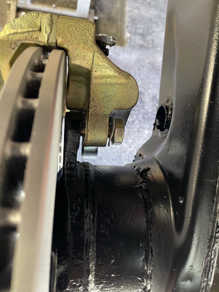

Do have a bit of a snag with the calipers. The spacers on the outside of the bearing took care of the long hub issue but the calipers do not fit. Looks like there should be a spacer between the caliper and the mounting bracket.
Am I missing something obvious?

I don't think you've missed anything. My set up is almost identical to yours; I ended up needing a small spacer between caliper and mount to center the caliper too. I have Carrera rear calipers / rotor / drums.
If I recall, when I was putting together mine (and memory is dim here, but): the front of the mounting lugs rides very close to the back of the rotor. It did not rub/interfere, but looked super close. Some restrained adjustment (grinder) was deemed necessary. Might want to assess that clearance on yours.
Nice job on the welding BTW,

backing plate bracket, not present= washer

Nice catch.

I hate what the prior owner did to that trunk. Thank you Scott.

QUOTE(sixnotfour @ Mar 12 2021, 11:30 AM) *
The 911 backing plate is wafer thin at this point, so does not account for all of the gap even when fitted. I can check, but think 3mm or so is needed to center it from the 914 mounts (I ditched the dust shield too)... did I try the 914 dust shield? Don't recall...
- Tony

Txt sent I have spacer material for the rear calipers.

Pretty welds are the easy part...although there is a reason that I didn't take a macro shot of these welds. I didn't quite get pretty colors due to some crud suck in the small corrosion pits in the trailing arms.

Thanks for the confirmation that spacers are required. I moved porsti onto the 4 post lift this weekend so that I can drive the C10 and was able to confirm that I used spacers on the PorSti rear calipers too.

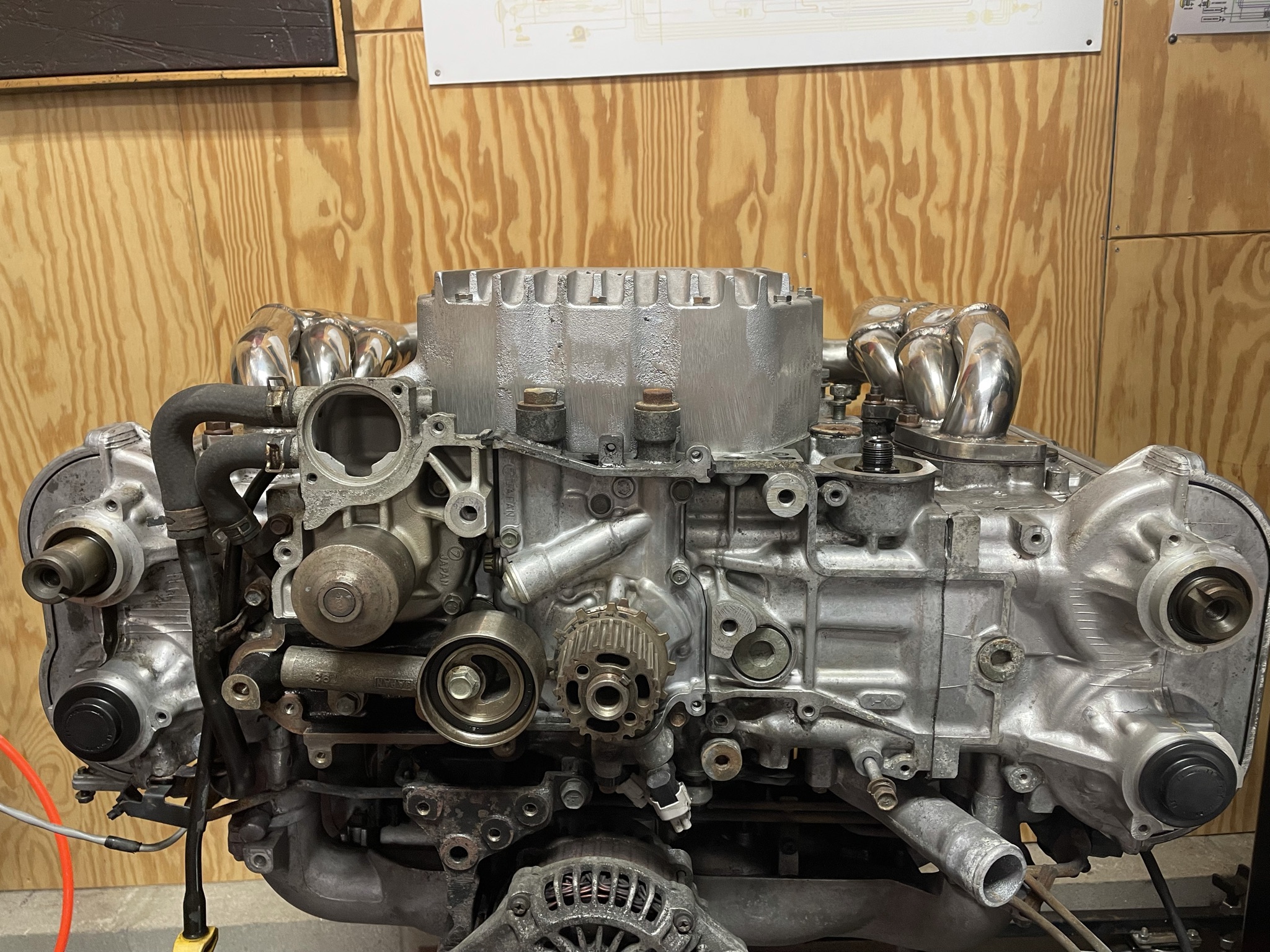

About time for an update....'eh.
Had a spell of very little time in the shop. Then when I did get back it was pre power tour time and Mark was nice enough to let me work on Porsti a bit. That turned out to be a debacle, I'll update that build thread later. Been plugging away on Marks car lately but nothing super photogenic. Cleaning up the engine quite a bit more and deleting things that are not needed between plotting how to install the rear trunk section. I think that because I have so much time into the new section and getting another will be basically impossible I am having a hard time committing to cutting it down to fit the hole. Lot of time wasted measuring things over and over again...I guess if it goes well it won't be wasted but feels very unproductive.

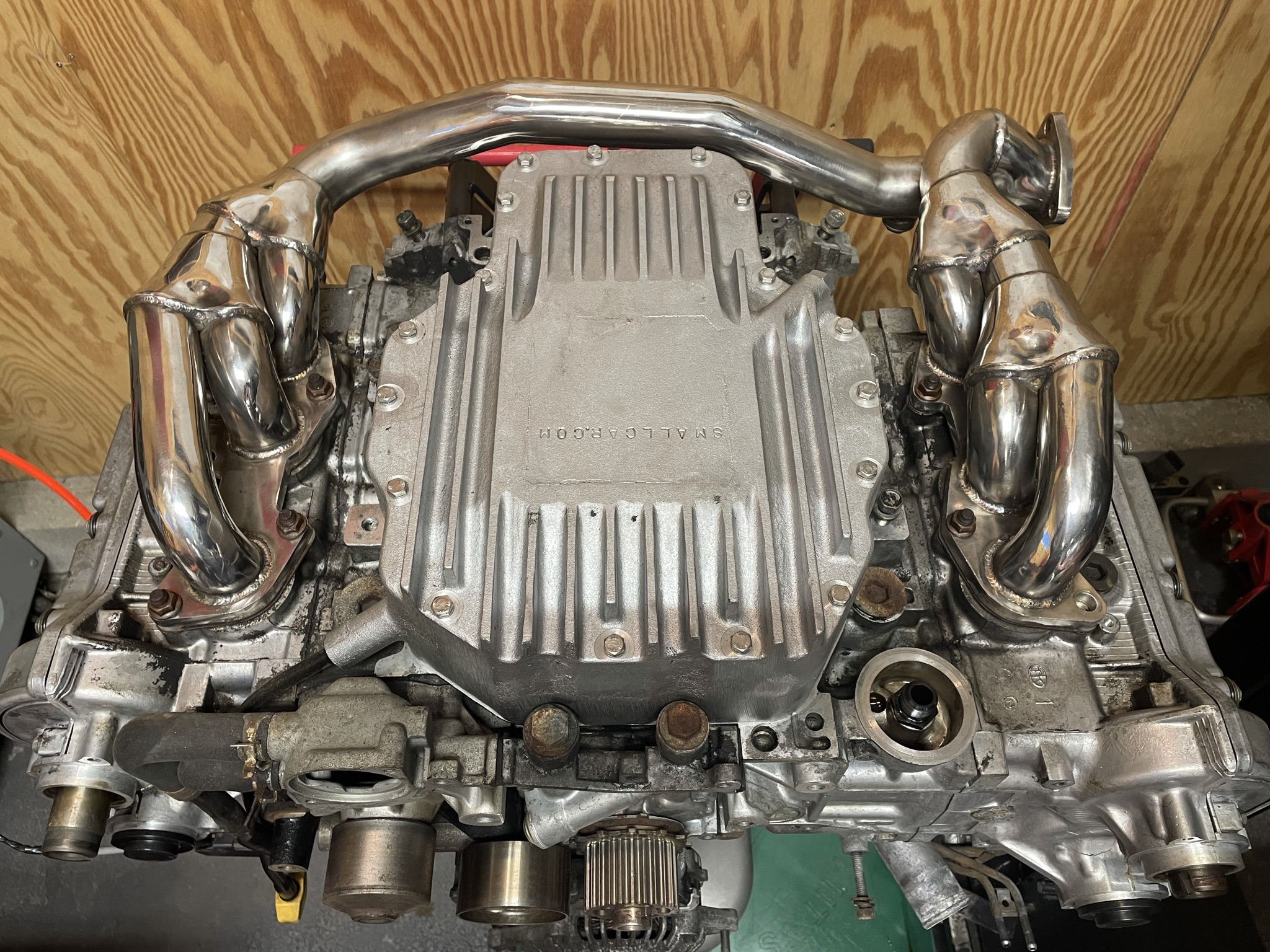

One cool thing that is worth sharing is the header from Small car. With the shorter oil pan the stock exhaust manifolds were way too low.

That was a great suggestion to get the small car headers. Thanks

QUOTE(Amenson @ Feb 14 2021, 03:43 PM) *
Probably about time to update the thread.
Managed to find a rear trunk section in a local junk yard.
Brought along my neighbor gearhead in training along with to help with the extraction.
It is amazing how many layers come together in this part of the car.
Sort of kinda have it down to just what I need. Just another 30 spot welds to cut. Being very cautious to make sure that I don't cut out anything that is needed.
Also working on the suspension. Pulled the rear hubs to replace the bearings and install the 911 park brake.
Installed the front sway bar.
Assembling the park brake and calipers.
Shiny!
Couldn't resist test fitting the new oil pan.
That's the oil pan on the EZ30D?

The thread title says it all. But you're new to Subaru so...........SVX used a 3.3L 6 called the EG33. Very desirably engine but getting more rare as are the parts for them.

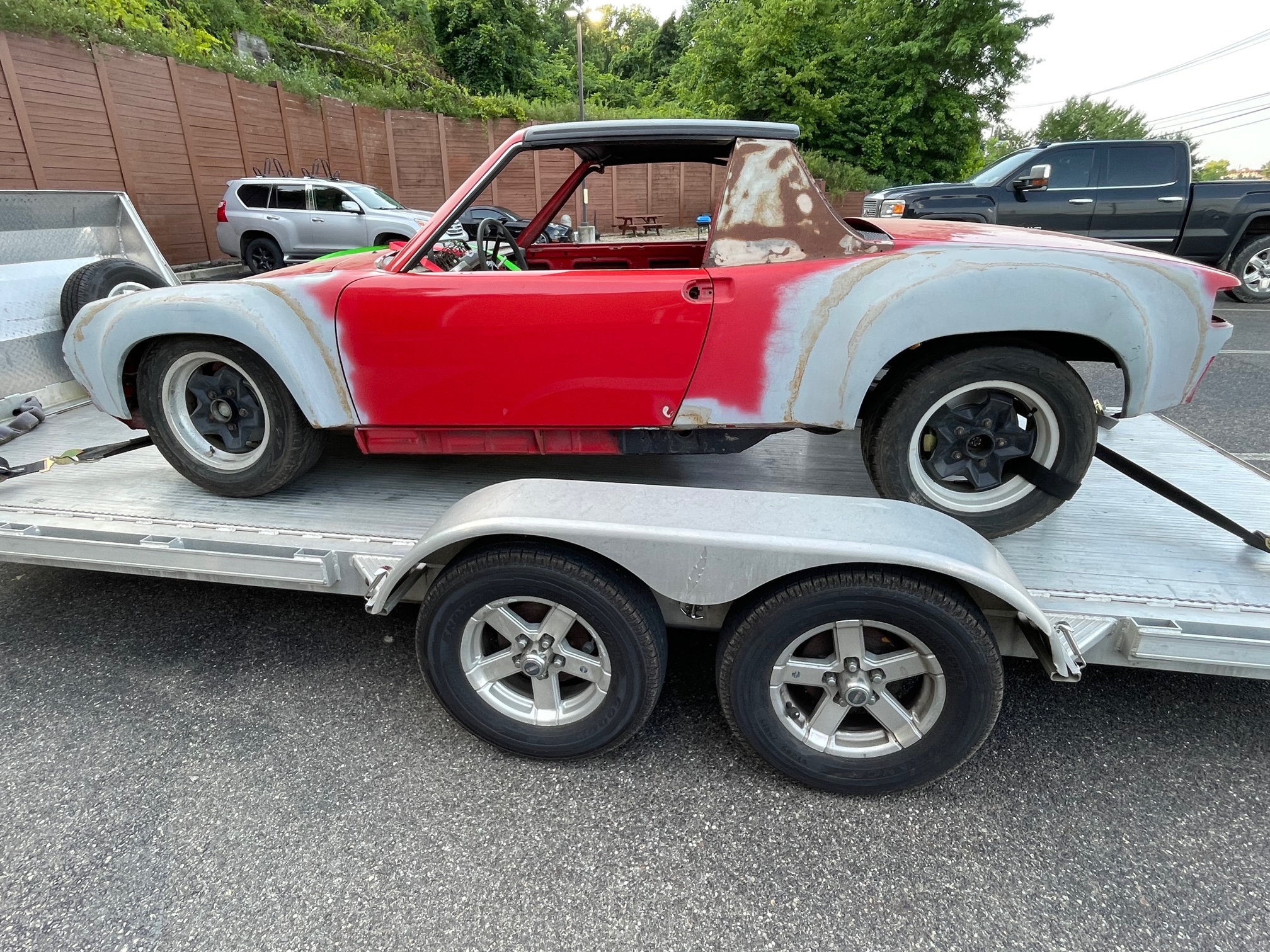

I plan to put the car up for sale this week.
I just brought the chassis, engine, trans and all the parts back from Scott’s house. I’ll catalog what is there, take pics and then post a price.
