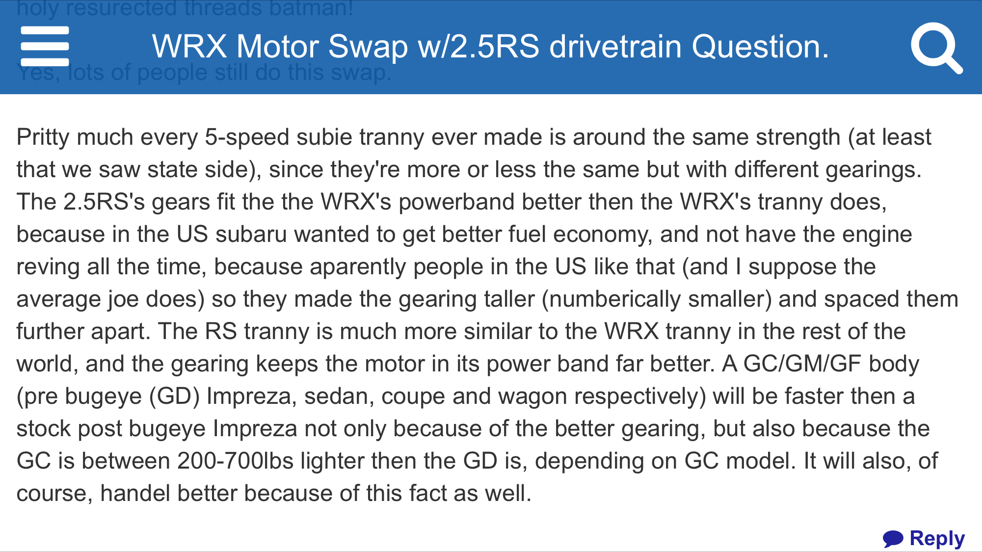

So I need a trans. Can anyone help me find the right trans for sale. Not just type but an actual trans for sale so I can just purchase and drive home. I'm around Newark, DE 19711 so anything within about a 2 hour drive would be great. Needs to be a 5mt that will hold up to the 6 cylinder eg33. Thanks!
*I would really like it complete with clutch, flywheel, trans stubs, ect.
Go back and read Chris' or my build thread. Pretty sure all the clutch/tranny info you'll need is there. The TY75 MT5 comes with 4:11's or 3:9's. The 3:9's will give you better hi way gearing.
I don't want to find the right trans, I want you guys to find it for me so I can buy it. Really.

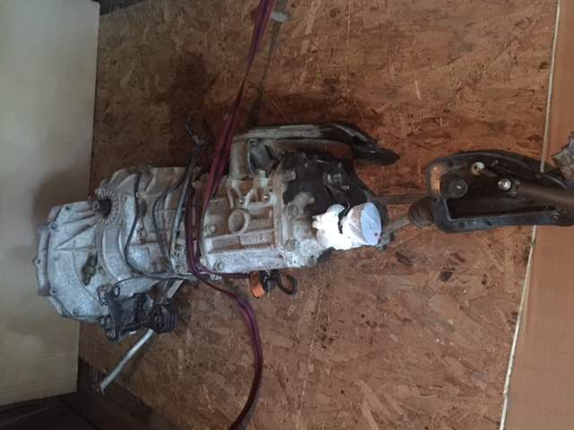

Zach found me a trans. Picked it up last night. Thank you Vatican Rabbit.

I'm using the transaxle out of a U.S. 1998 Forester into which I've fitted an OBX helical gear limited slip differential. Haven't had it up to highway speeds, so I can't provide opinions. In fact, I haven't yet had it past second gear...
Good luck with your project!

I have had a fwd subaru trans in my now svx powered 914 for about 9 years. It uses a push type clutch but the stock clutch is strong enough for n/a applications. And it does not need to be converted from awd.

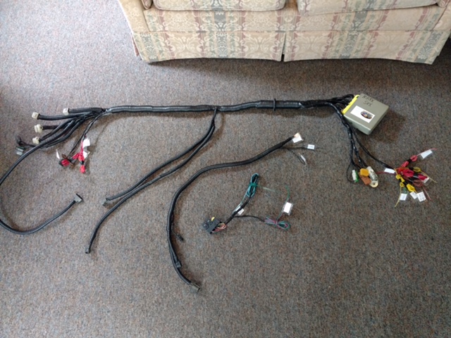

Here's the harness all done and ready to ship. Jeff labels all the wires and makes it as plug and play as possible. He asked me where and which direction each wire should go and set up the controller for the radiator fans. He told me I'm welcome to call with questions when I get around to putting it all together.
