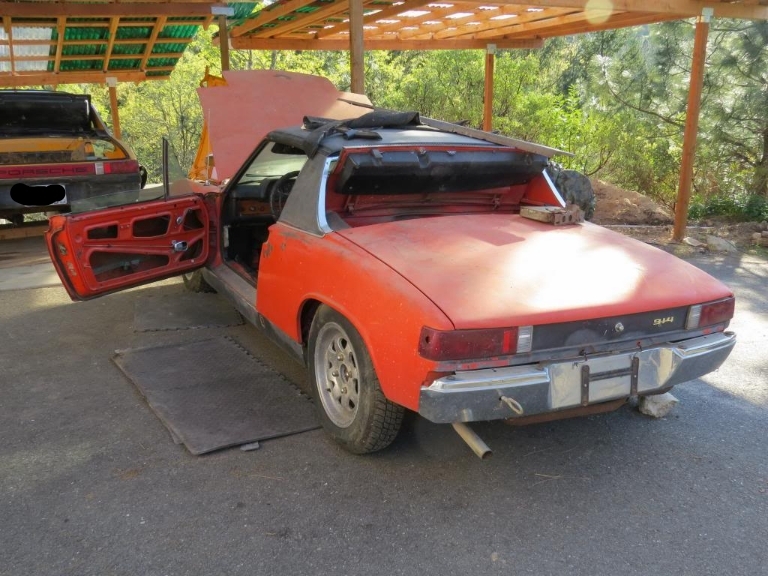

This is the plan-
We are starting with a 1971 tangerine 914 with light to moderate rust, nothing too serious.
The original engine was a 1.7. Like so many other 914's it ran but has been sitting for a long time.
The engine seems too far gone to try to rebuild it= lots of rust and corrosion.
Powerplant: 2003 Subaru Impreza TS 2.5 SOHC, Natuaral- No Turbo, Why? Plenty of Power for me and no turbo lag. See Engine Choices thread.
Transmission: Subaru 5MT 2003 Impreza TS
ECU from: 2003 Subaru Impreza TS
Electronics: Wiring Harness simplified by Small Car Performance
Axles: 944 axles and CV's with Subaru inside CV- 4 lug for now.
914 suspension.
No fender flares
Voltage Blue Metallic: (Honda color), Painted Sail Panels.
Before Pictures

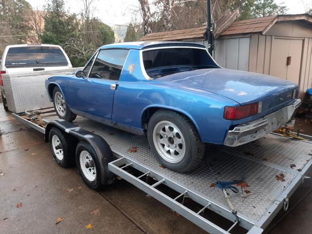

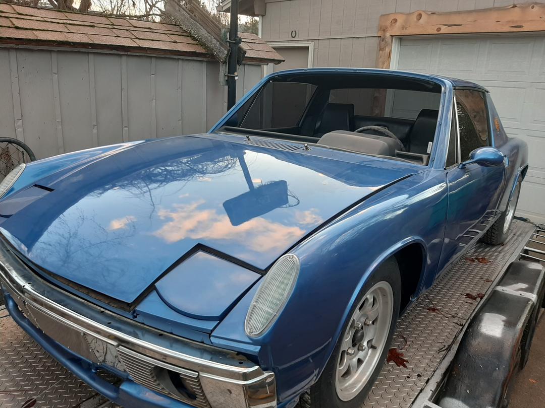

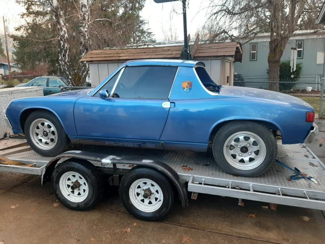

Current Look:
