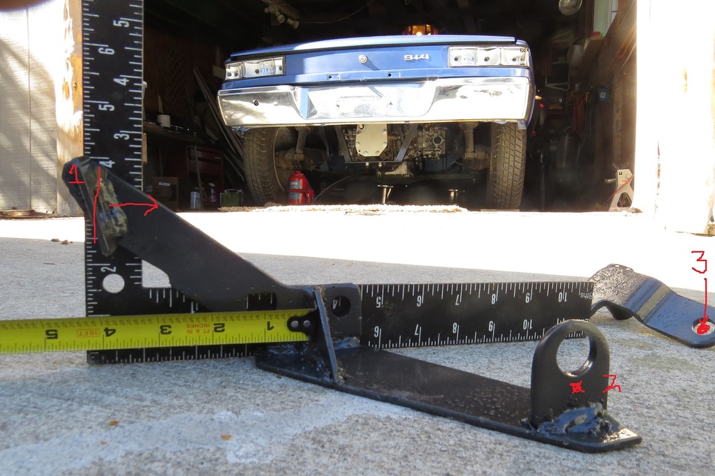

R_u_dd   Engine Mount The inspiration for the engine mount...   Sep 26 2015, 11:41 AM

Mike Bellis   I'm worried about your engine mount. My rotary...   Sep 27 2015, 07:36 PM
R_u_dd   I'm worried about your engine mount. My rotar...   Sep 27 2015, 08:16 PM
Mike Bellis   [quote name='Mike Bellis' post='2244152' date='Se...   Sep 27 2015, 08:33 PM
