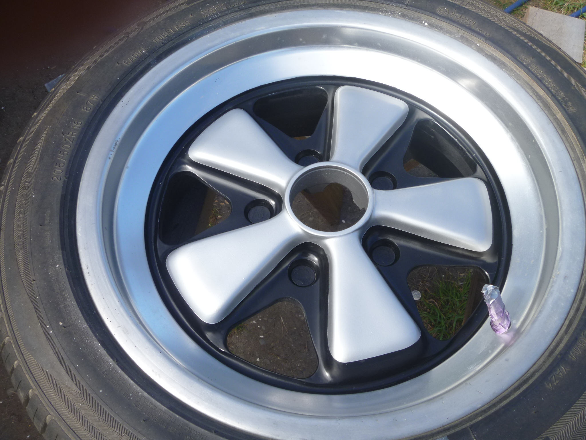

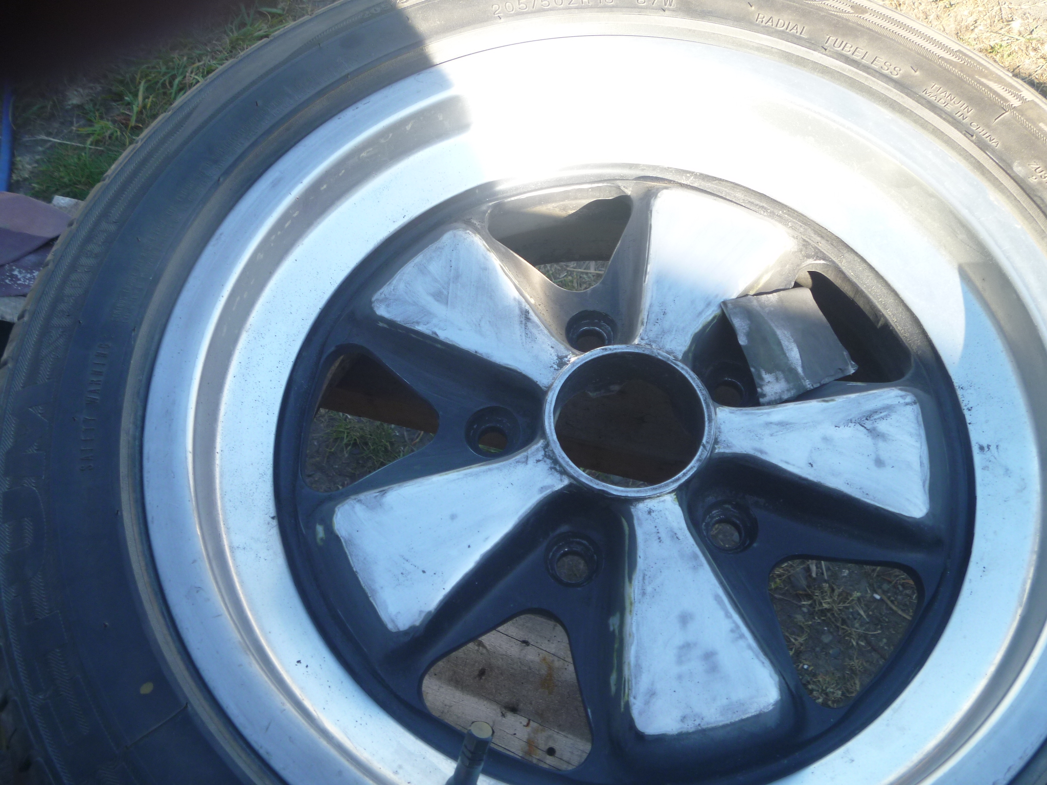

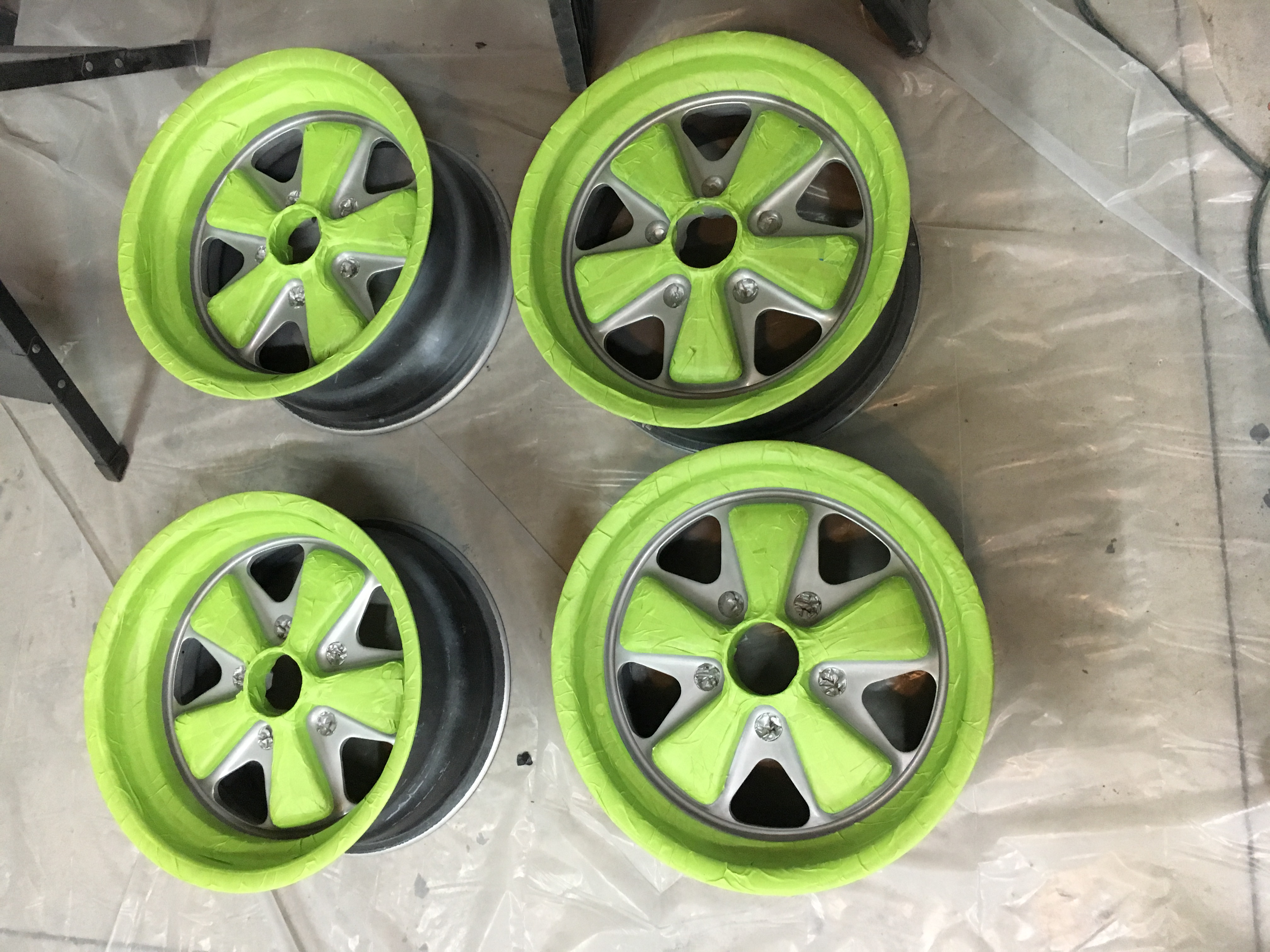

Genuine Fuchs 15x7/8” soda blasted, painted silver and masked for highlight

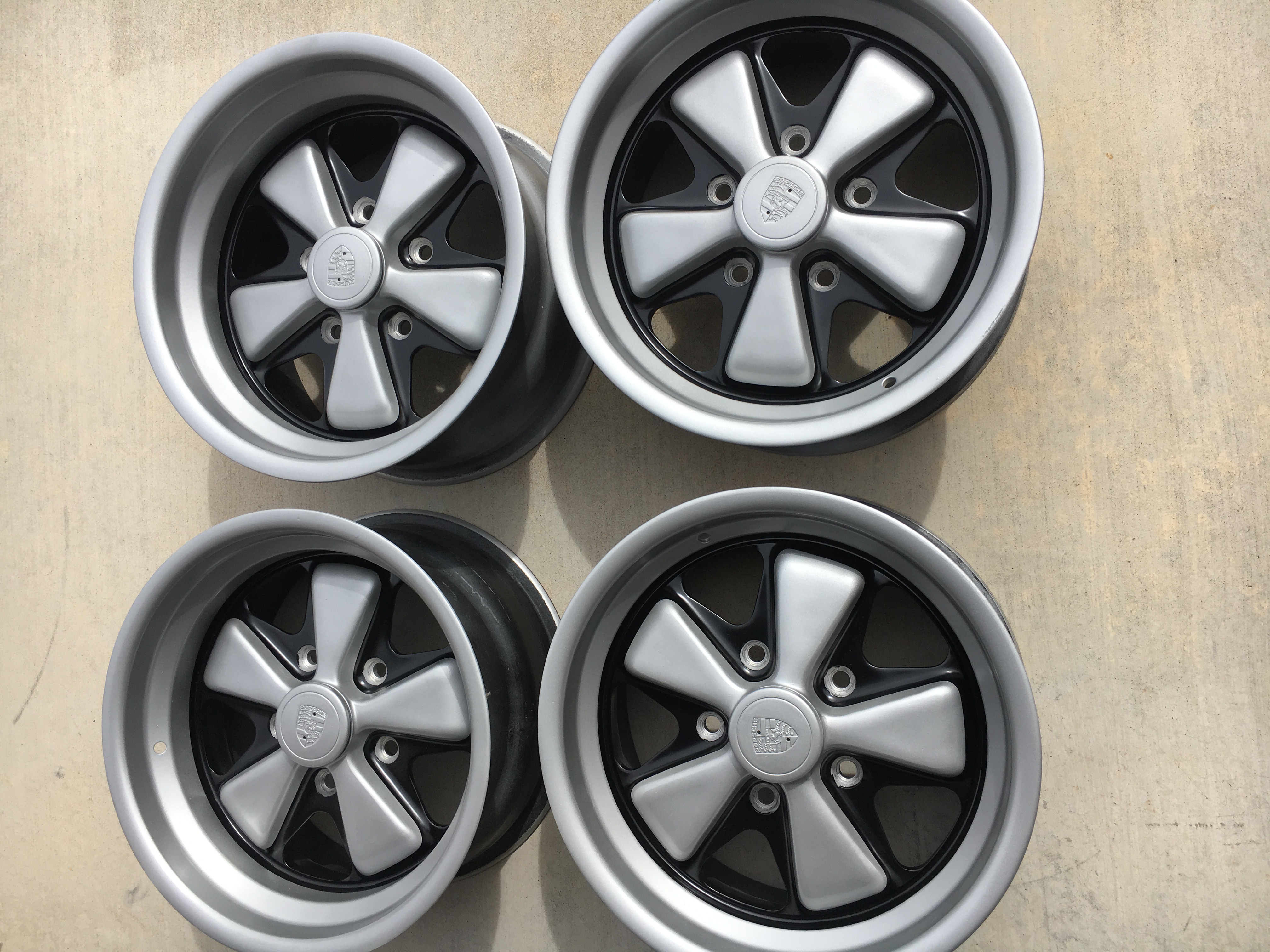

Refinished

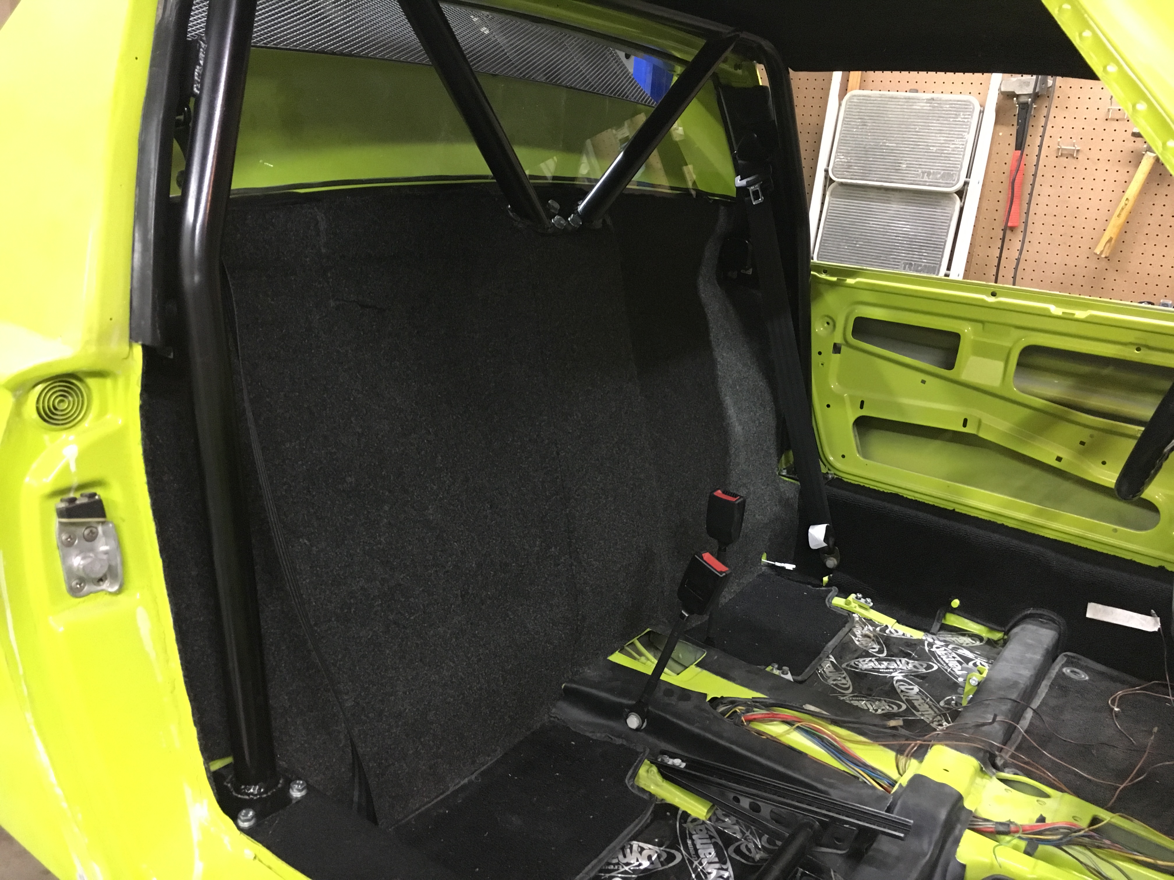

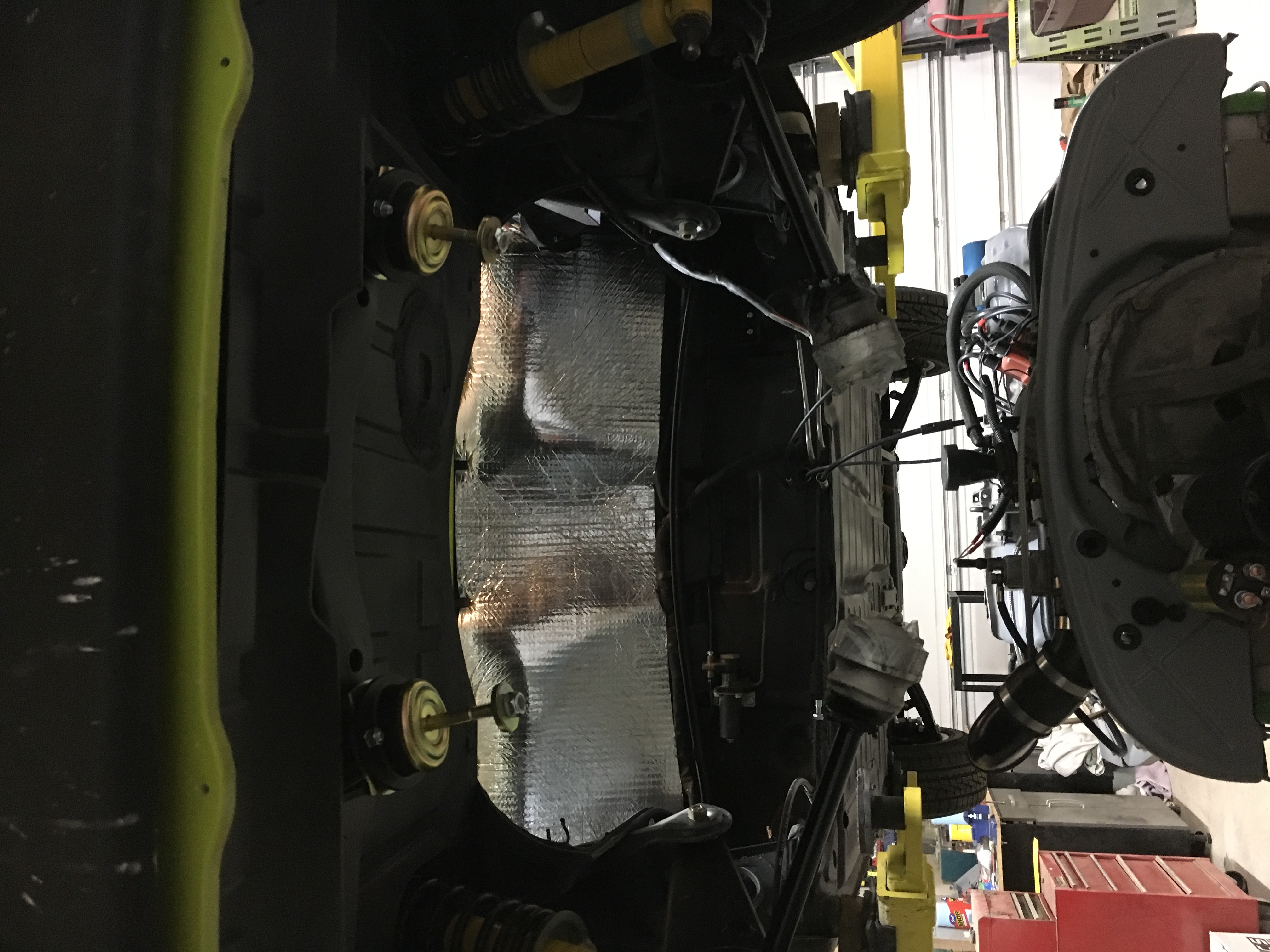

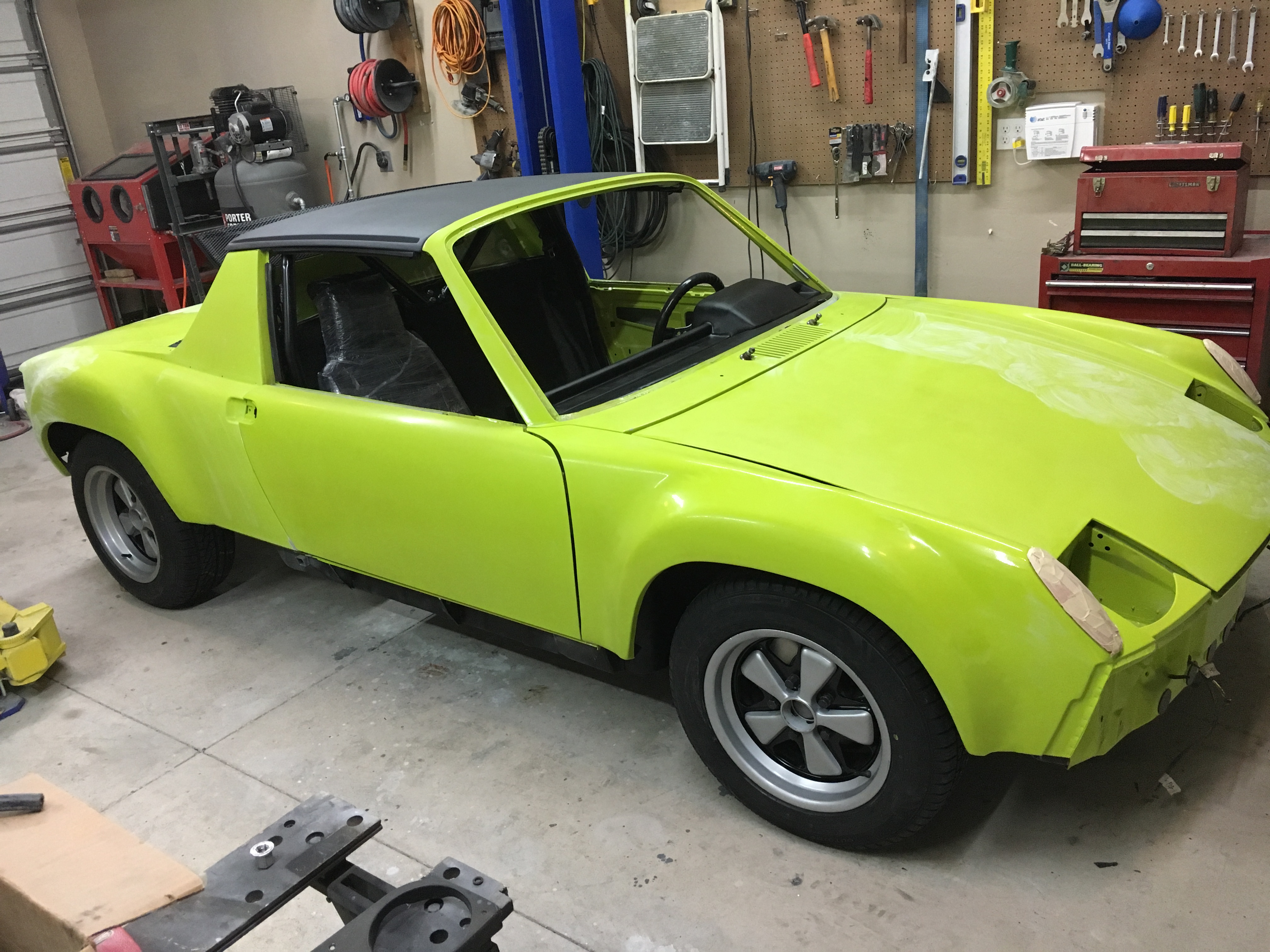

Rear glass installed with butyl tape. Perlon carpet glued to the firewall. Roll bar installed.
Dynamat on the floorboard and 914Rubber.com carpet kit partially installed

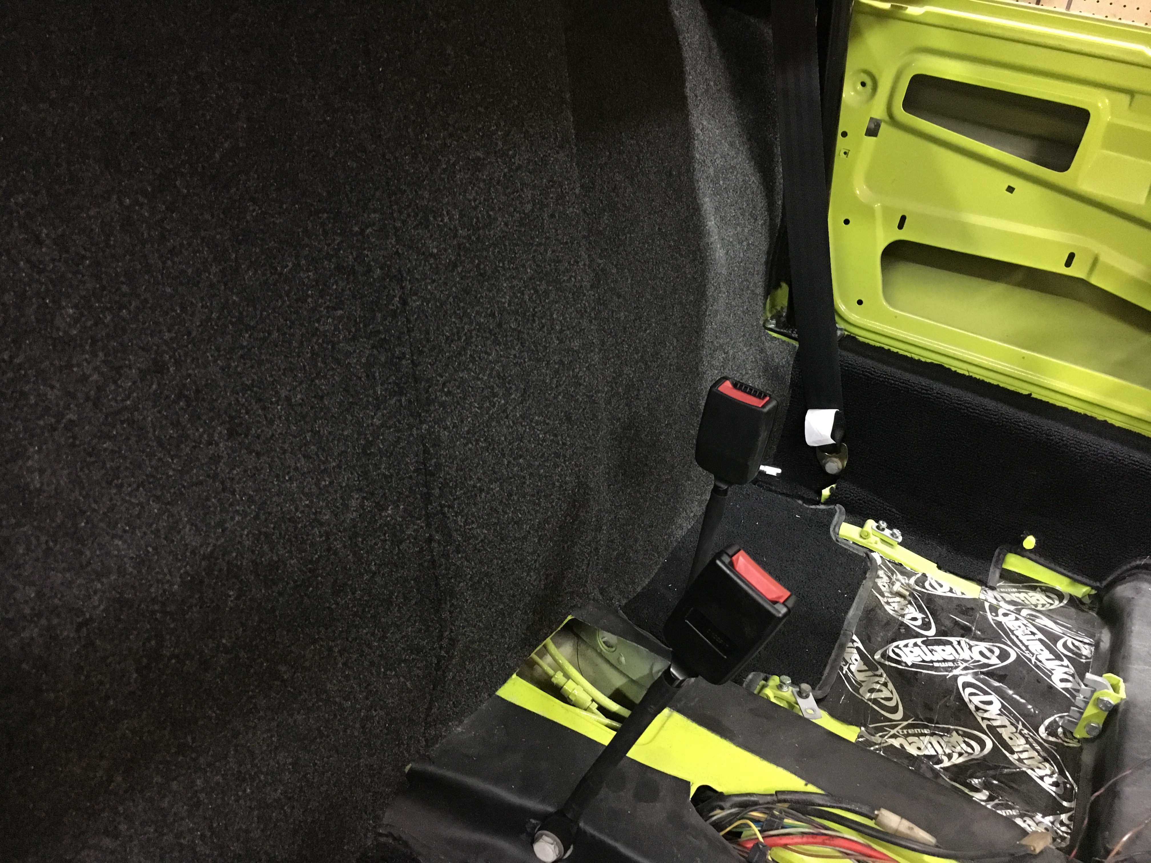

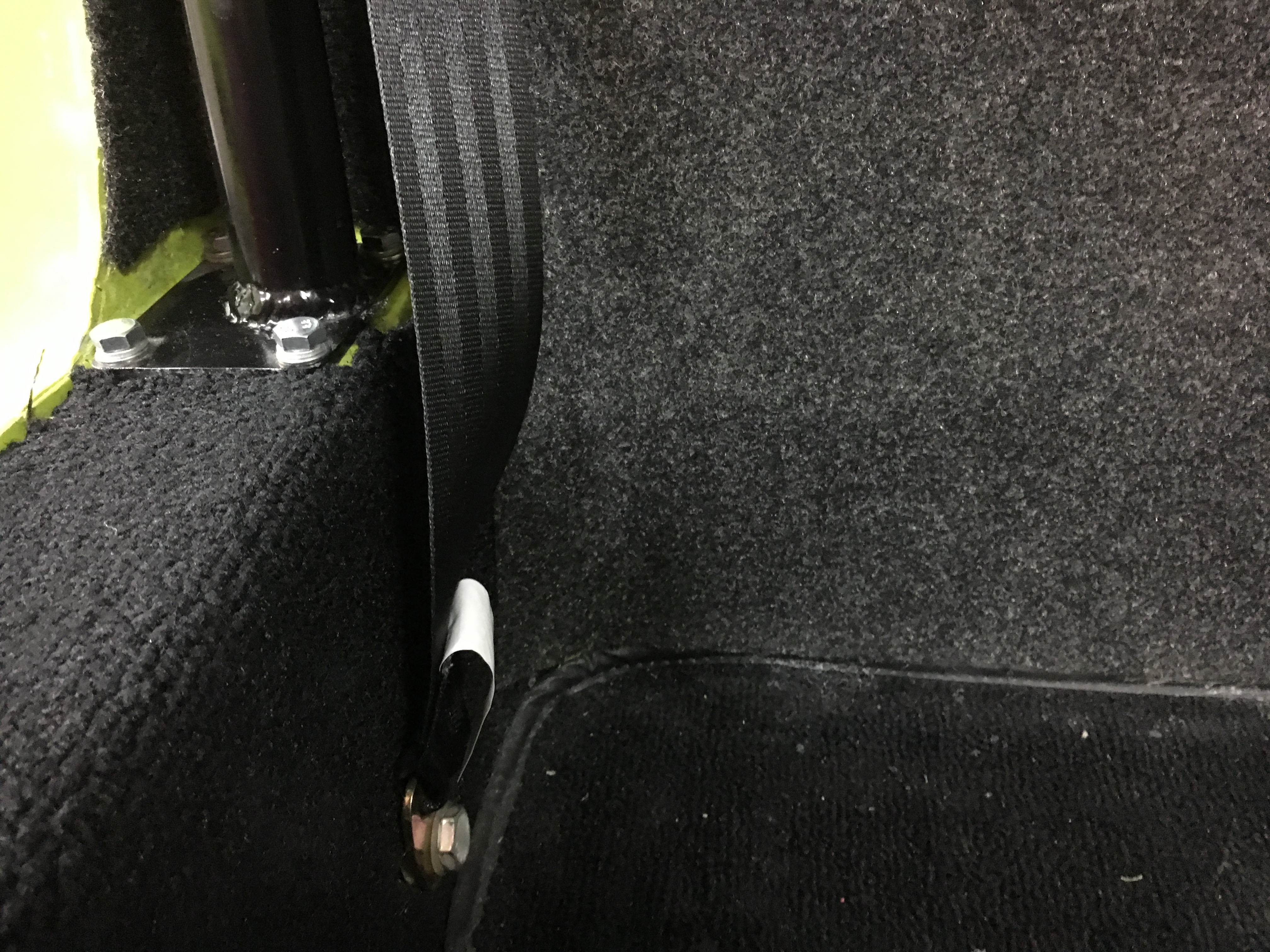

New Seatbelts from seatbeltplanet.com

Rollbar easily removes. It’s just bolt-in

QUOTE(jmitro @ Mar 10 2018, 06:56 AM) *
Refinished
I think that's what I am going to do with mine to save money.. I can always have anodized later.. I think your end results look great..

Thanks. I used vht silver and black wheel paint over epoxy primer after soda blasting. Baked for 20 minutes at 200 degrees. Finish is decent. Not sure about long term durability. Finally got tires mounted and standing on its own feet for the first time. (IMG:style_emoticons/default/beer3.gif)

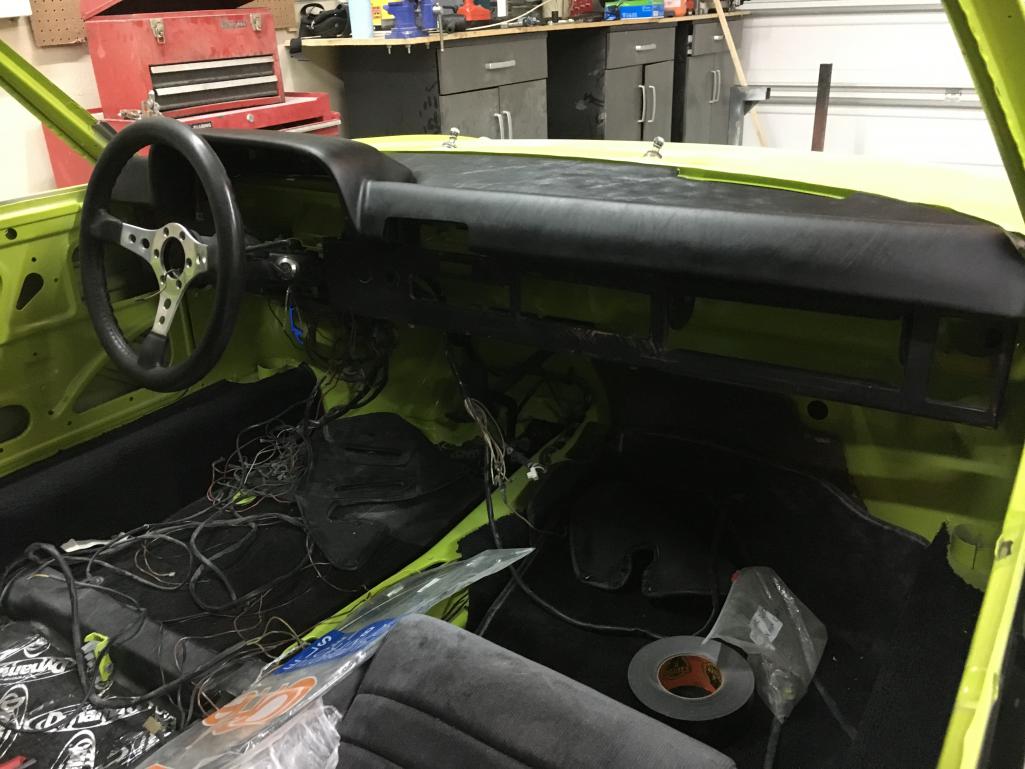

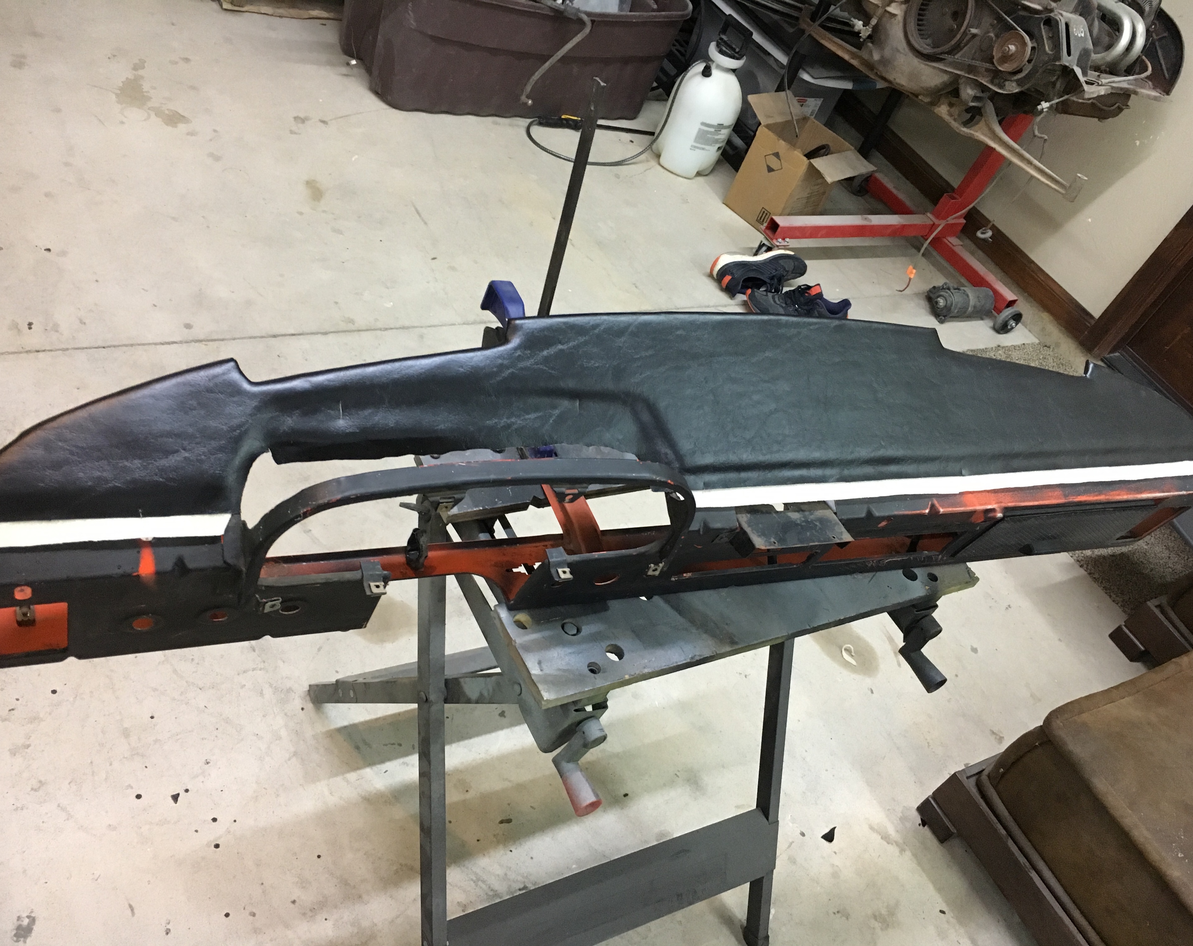

914rubber dash repair pad and dash top
jmitro
post Mar 15 2018, 06:01 PM
Post #113
Posts: 713
Joined: 23-July 15
From: Oklahoma
Member No.: 18,986

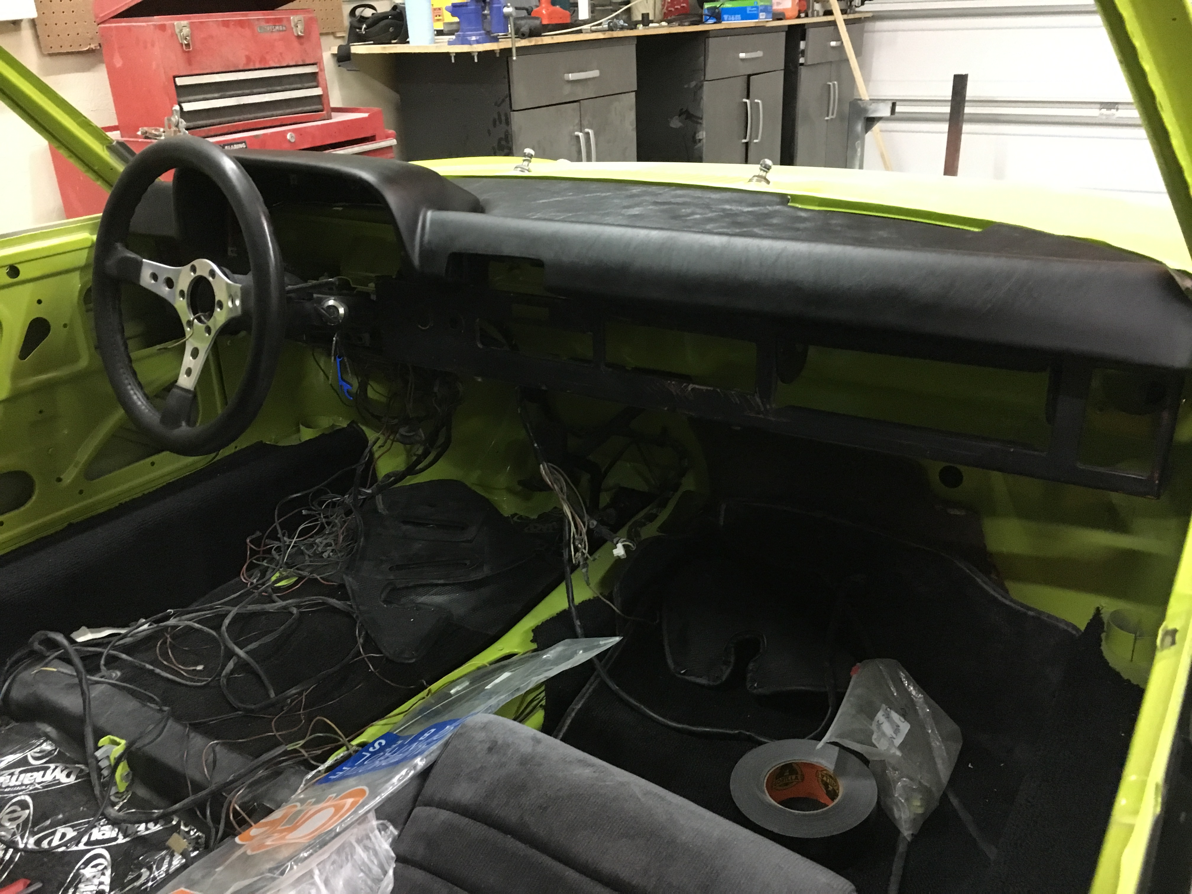

Installed

QUOTE(mb911 @ Mar 12 2018, 01:26 AM) *
Refinished
I used VHT high temp wheel silver and Plasticote black,happy as ,at the end of the day happy to recoat if needed.
The VHT wheel silver has a nice frosted look which is close enough for me.
Masking is a PITA but you peel off the tape and go wow (IMG:style_emoticons/default/w00t.gif) .

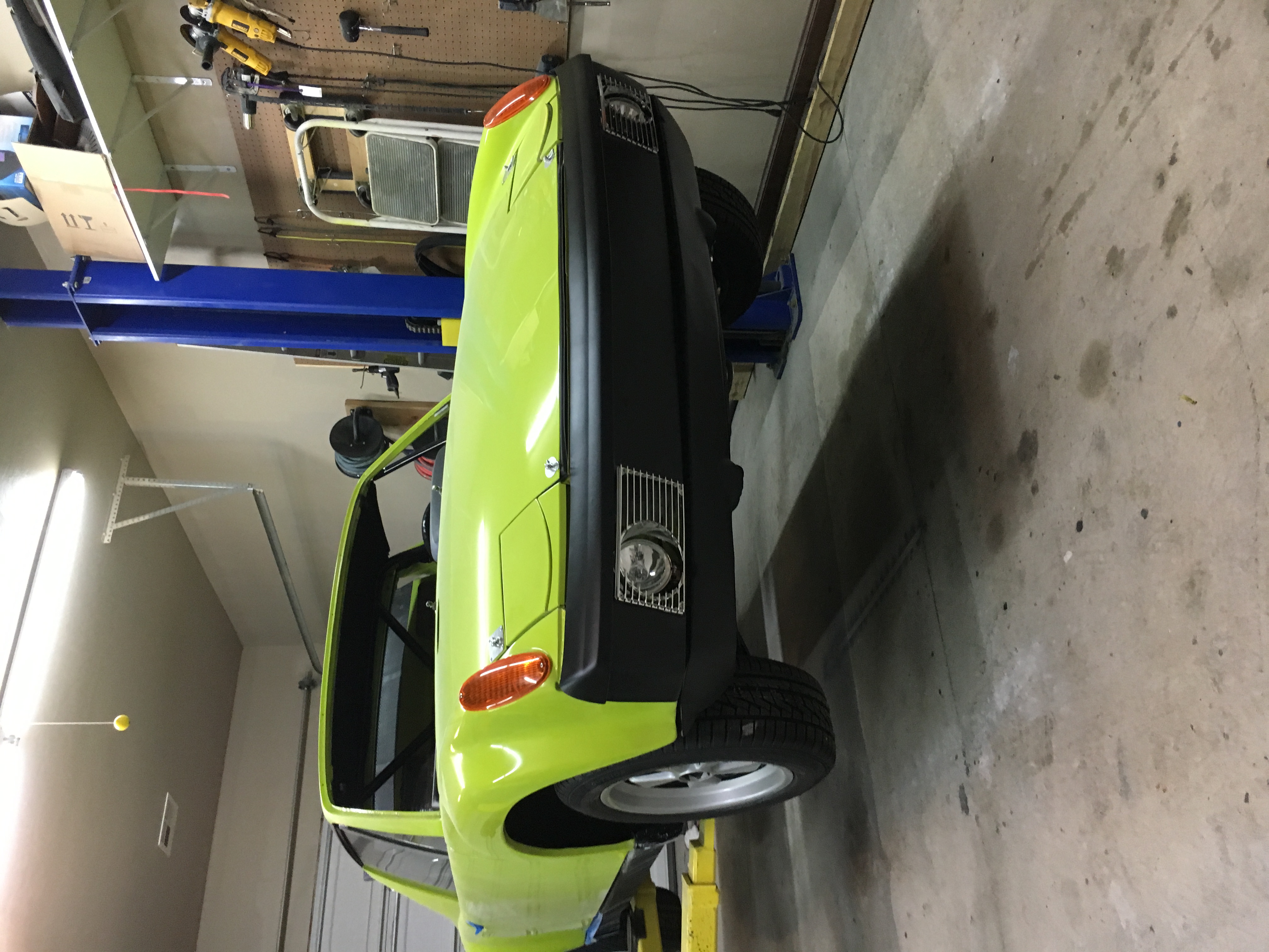

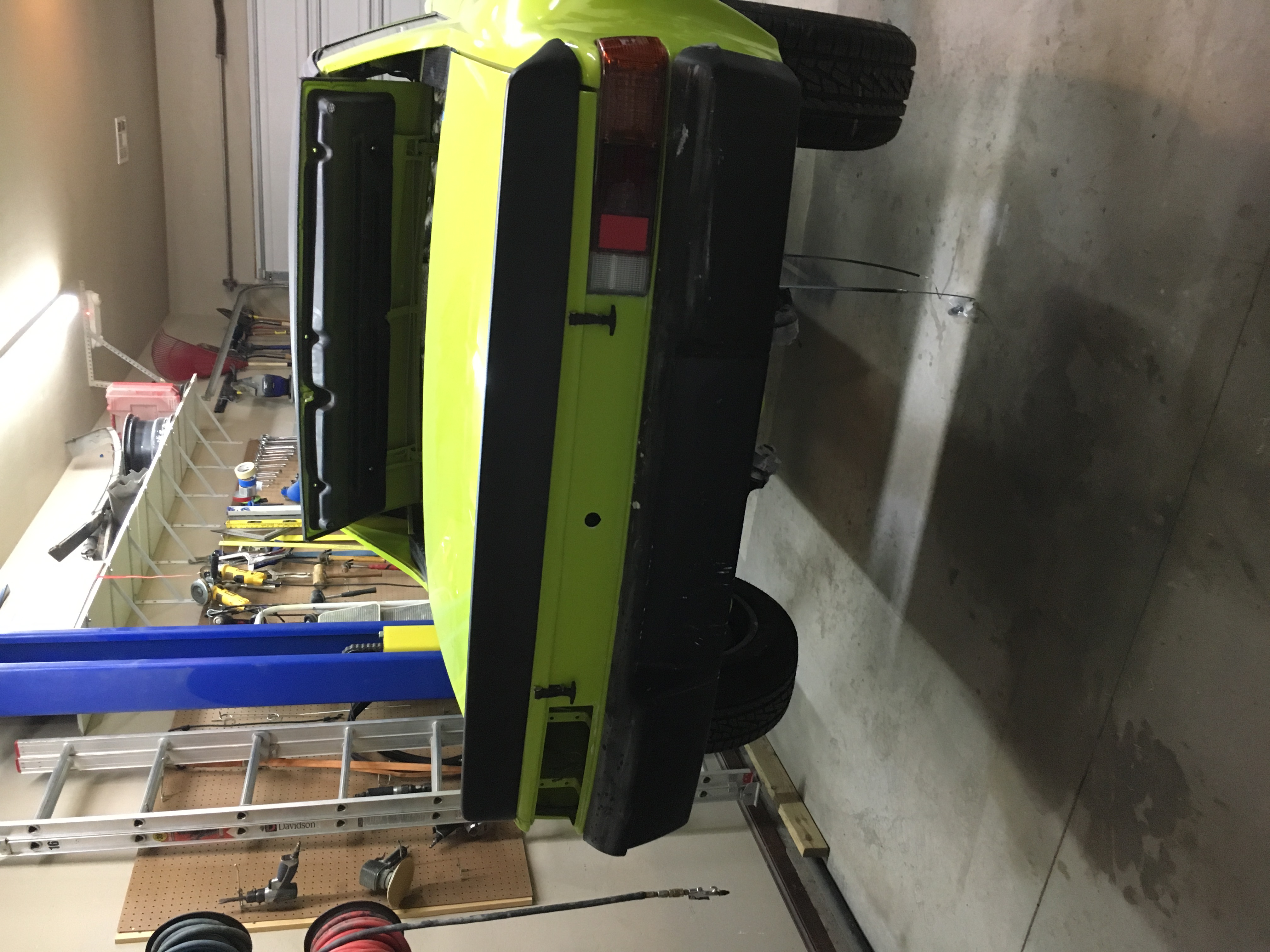

Update:
Wiring installed. Most of wet sanding done. Fiberglass bumpers and rocker panels and rear spoiler painted and installed. Driving lights installed. It’s beginning to look like a 914.

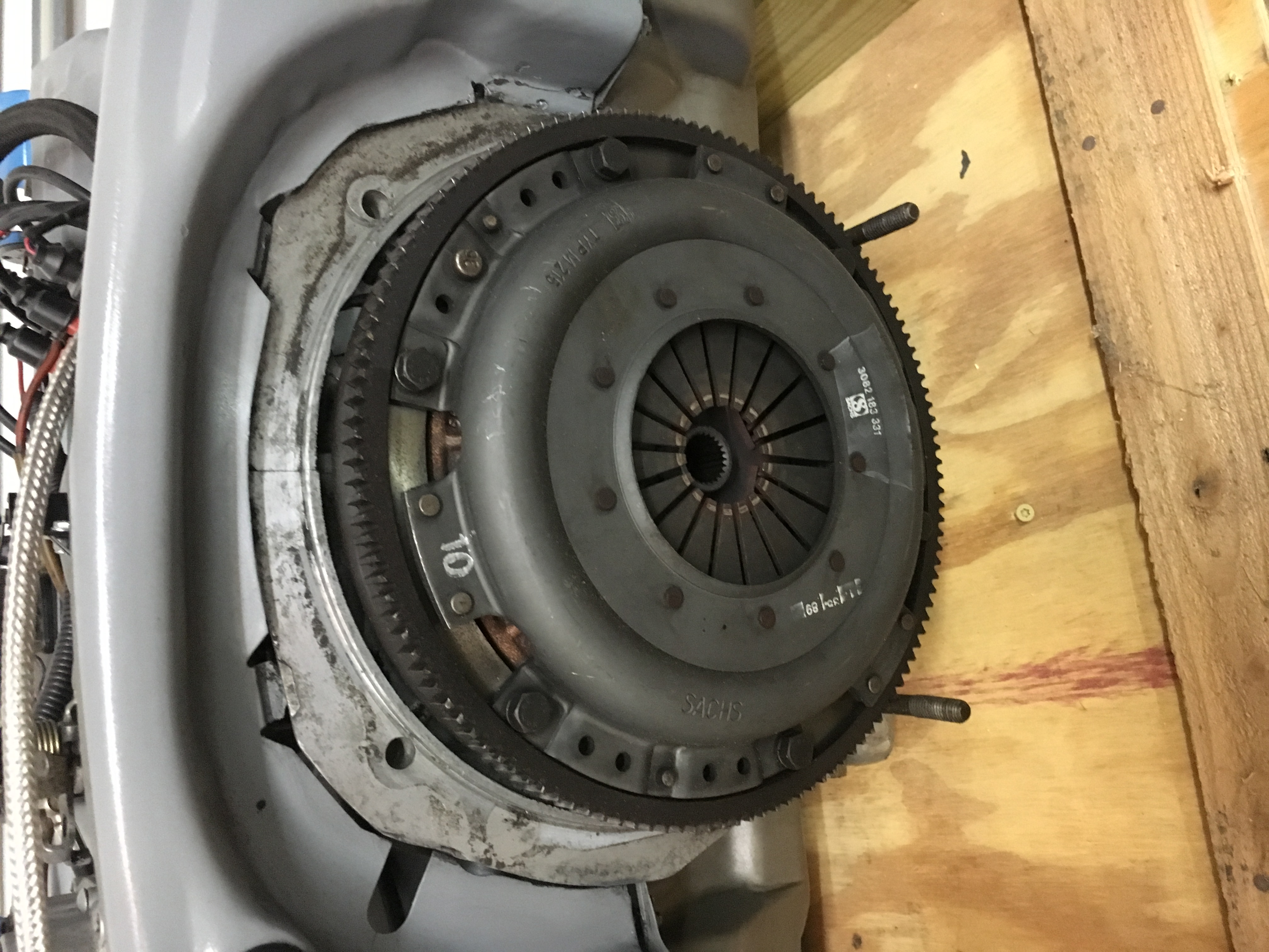

Finally uncrated the 2056 type IV I bought from Dion two years ago. He did a great job crating the engine, documenting the build, and gave me a great deal with the included CIS conversion, stainless heat exchangers, extra oil cooler, and dual outlet muffler. I had my 901 gearbox completely rebuilt by my local Indy Porsche shop to the tune of $3500.
Repurposed my rotisserie into an engine stand and bolted gearbox to engine with a new throw out bearing.

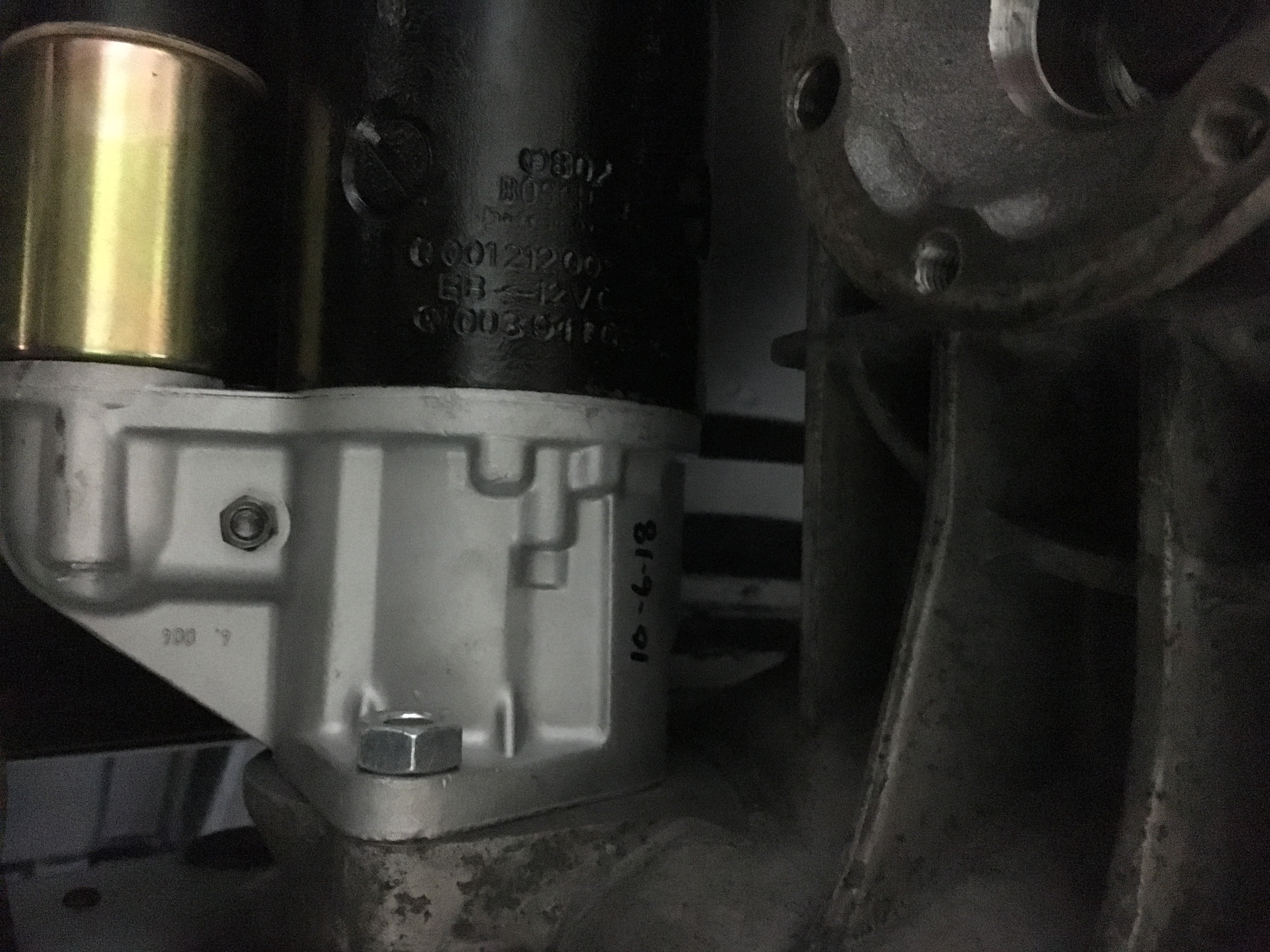

From here things are moving quickly. I had my Bosch starter rebuilt. Installed the battery.

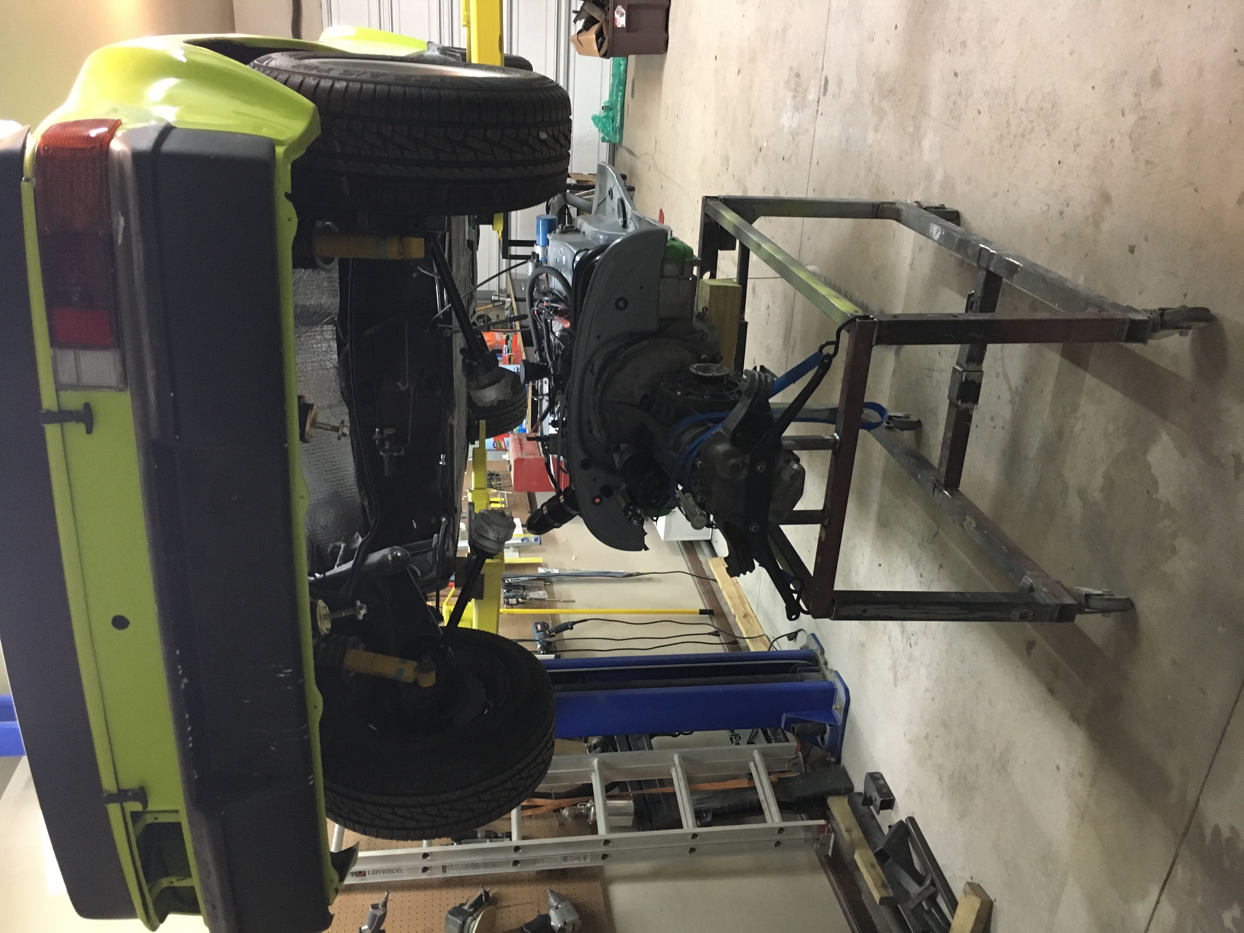

Put the car on the lift, raised it up and prepared to drop it down onto engine and gearbox
