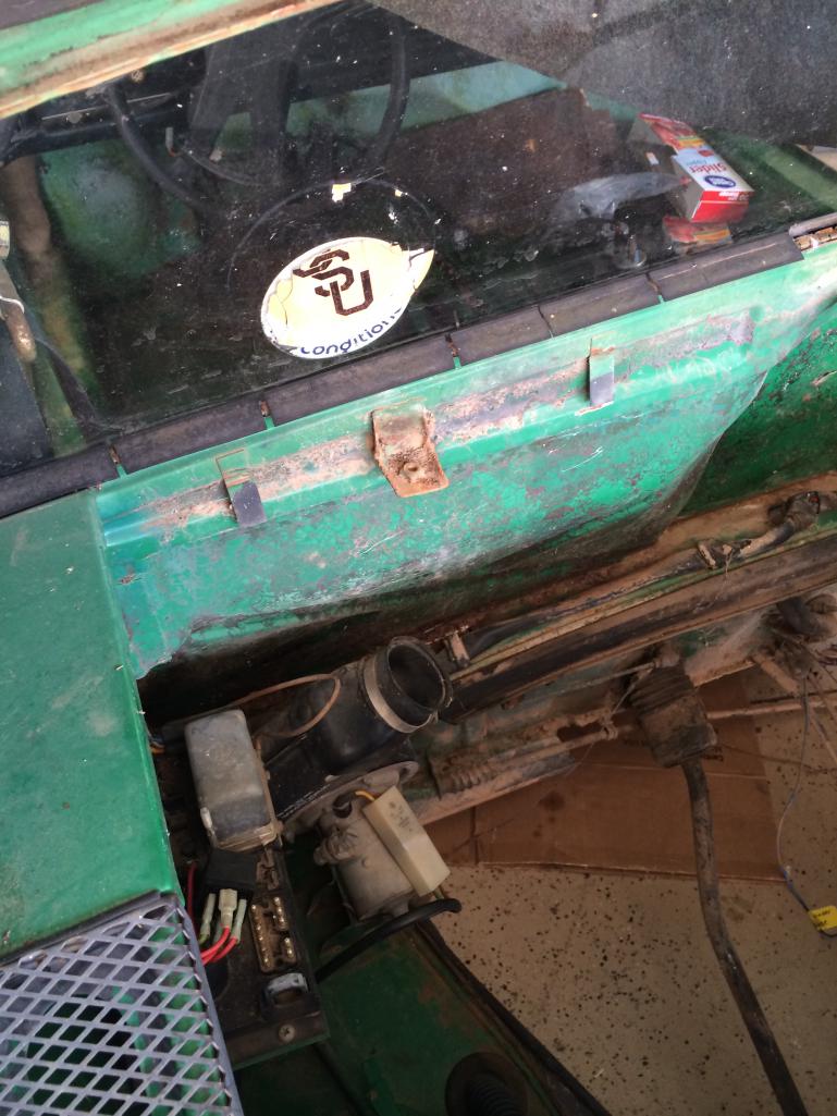

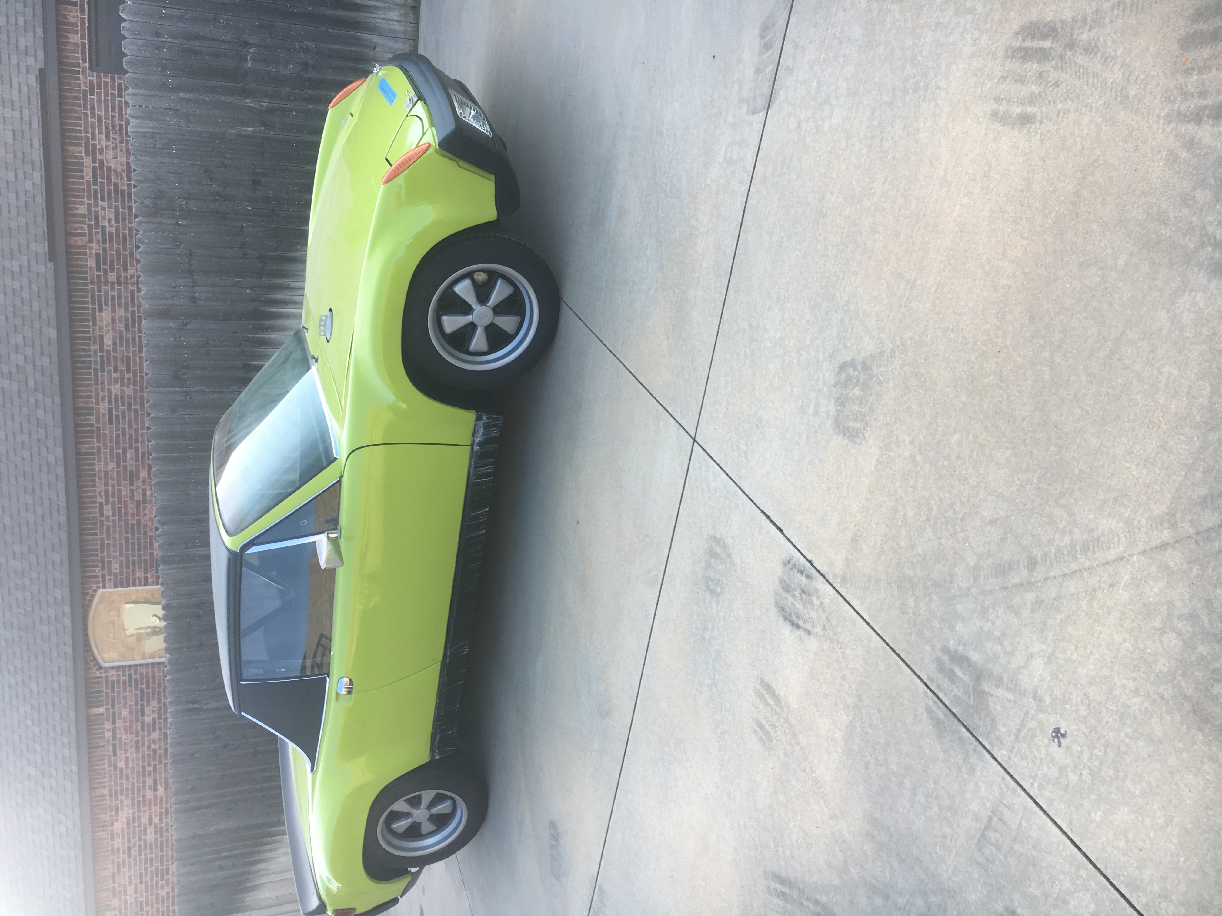

Hey guys, what's up?

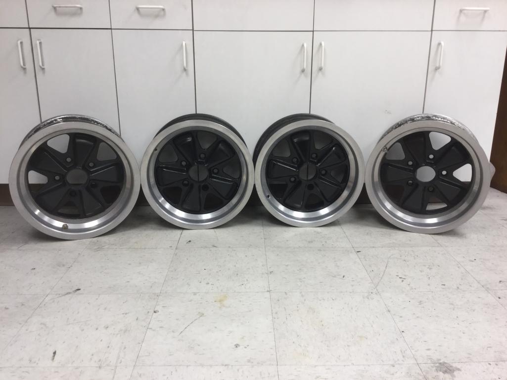

Newbie checking in; been tinkering with & racing cars for 20 years; lots of BMWs and Porsches (944, 996, 912, 911SC). My newest project is this 74 914 1.8; picked it up for $1500US. Looks like it has factory air conditioning and option wheels.
From my initial look it appears complete and almost rust free; it hasn't been registered for almost 20 years, so probably hasn't run for that long either. Cool thing is the car still has the ORIGINAL purchase invoice from Forest Lane Porsche in Dallas, Texas.
EFI has been replaced by some sort of carb setup. This will be my first experience with a carb engine. Any suggestions on how to get the motor going? I need to make sure it turns by hand first.
Anyhow, this board looks like a wealth of knowledge and I will be reading often. (IMG:style_emoticons/default/beerchug.gif)

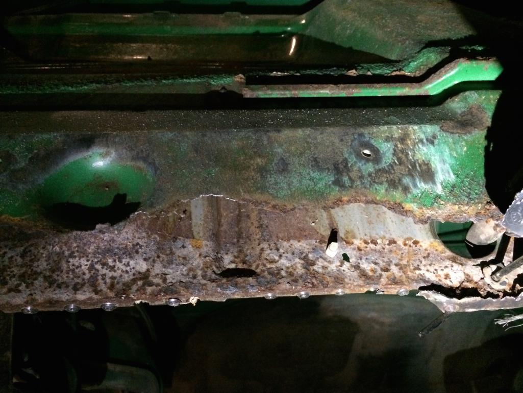

jmitro   Well the car has become a full restoration of sort...   Sep 17 2015, 10:37 AM

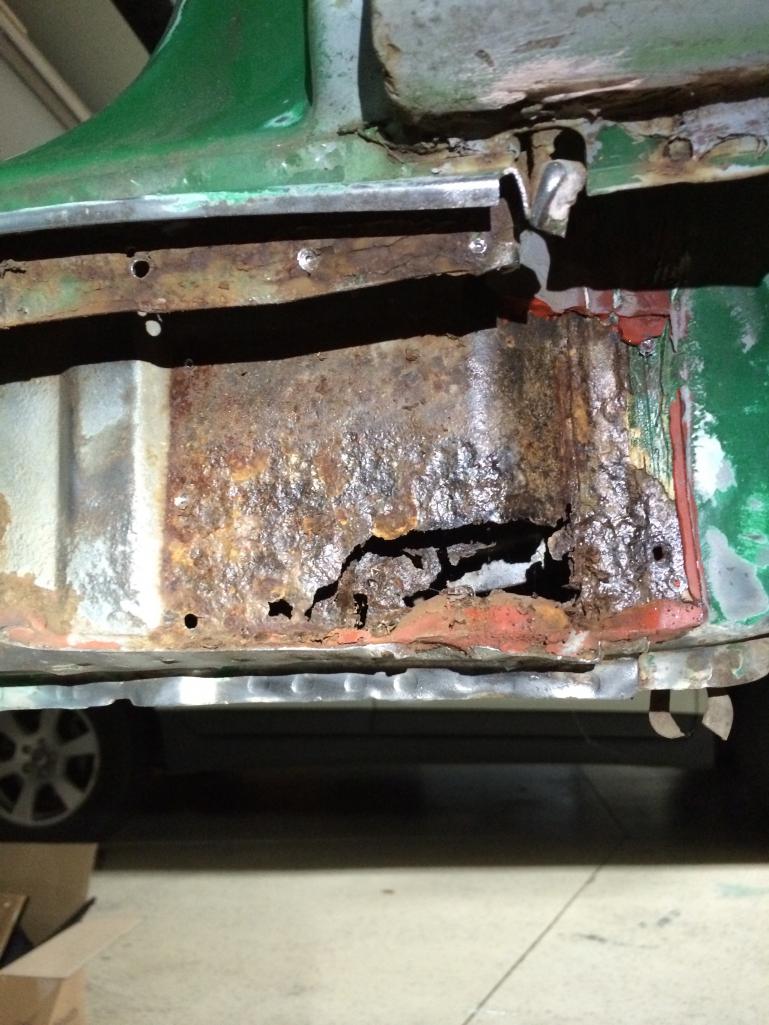

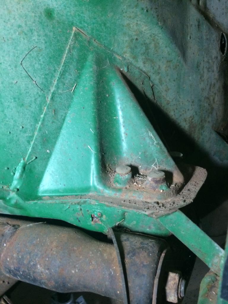

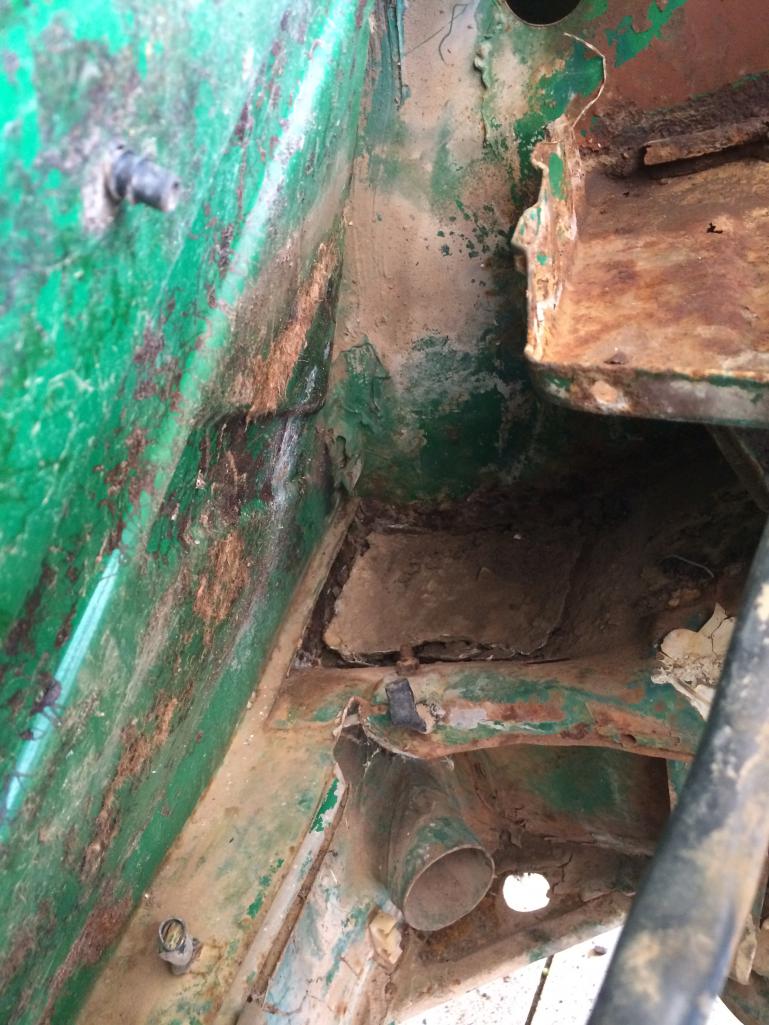

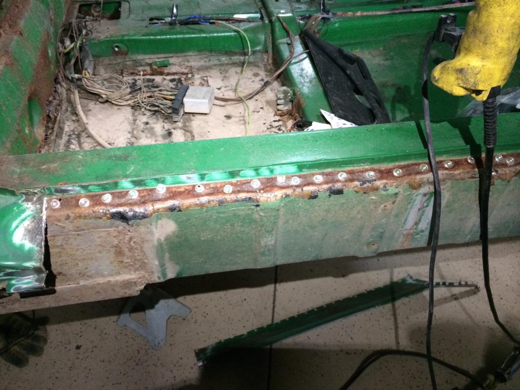

jmitro   Floor pans looking pretty crusty, especially passe...   Sep 17 2015, 10:40 AM

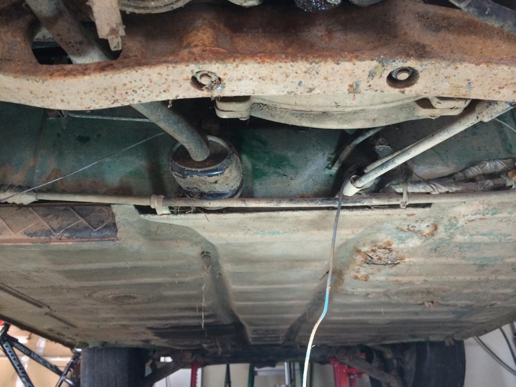

jmitro   Pretty dirty everywhere, indicating a long period ...   Sep 17 2015, 10:53 AM
jmitro   More dirt, rust and neglect.   Sep 17 2015, 10:57 AM

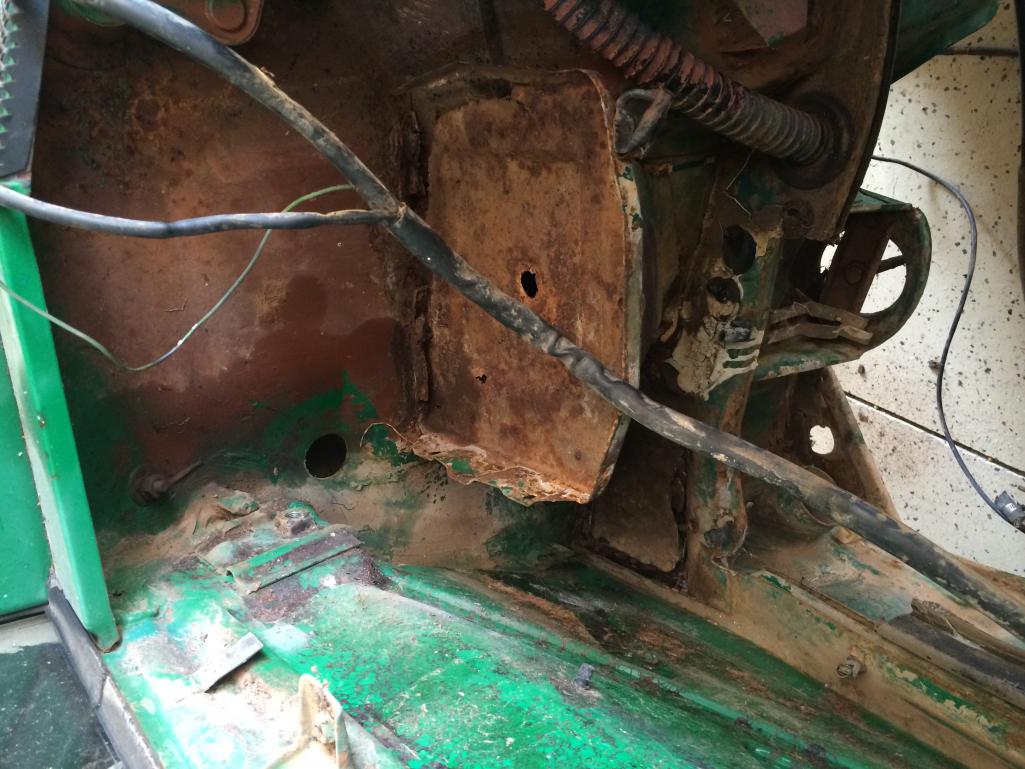

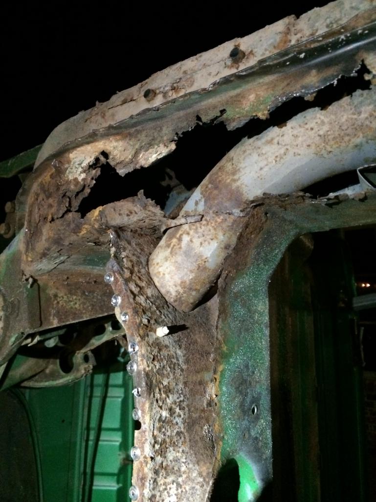

jmitro   Hell hole will need some thorough inspection and p...   Sep 17 2015, 11:17 AM

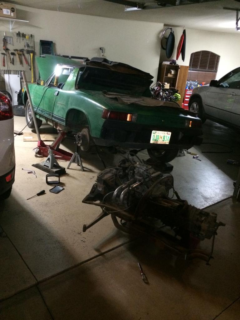

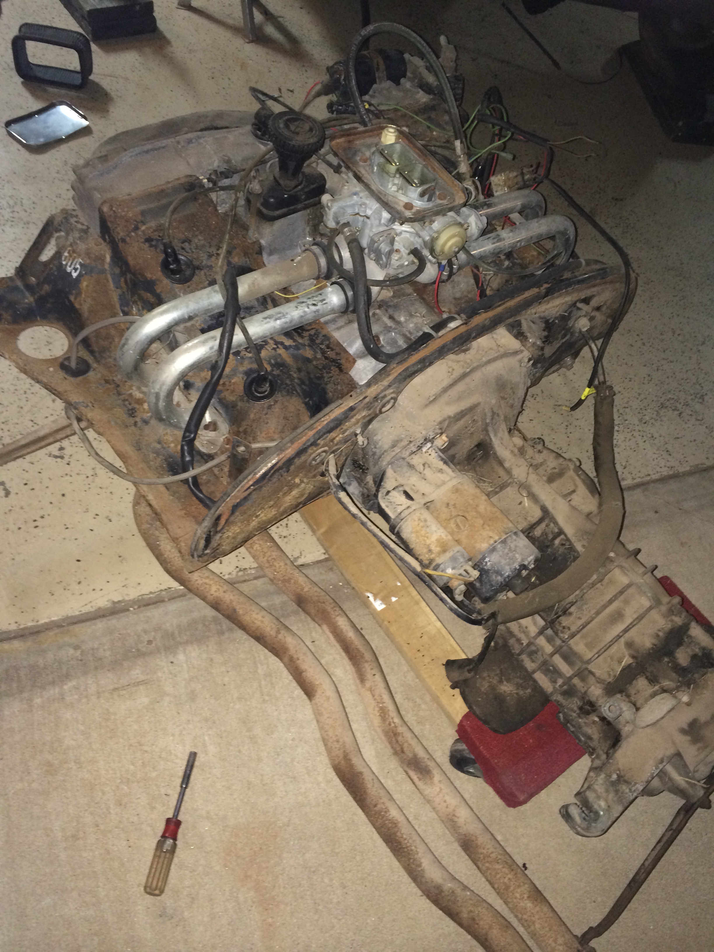

jmitro   pulled the engine and transmission   Sep 17 2015, 11:20 AM

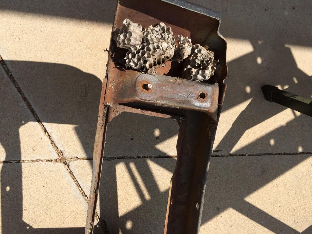

jmitro   found a dead rat and lots of hornets nests; I won...   Sep 17 2015, 11:37 AM

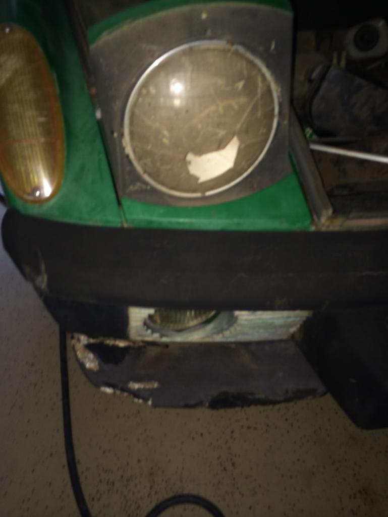

jmitro   Broken headlight lens and Lots of really crusty ru...   Sep 17 2015, 11:39 AM

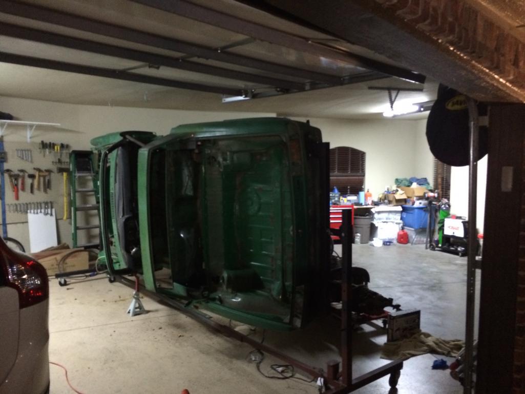

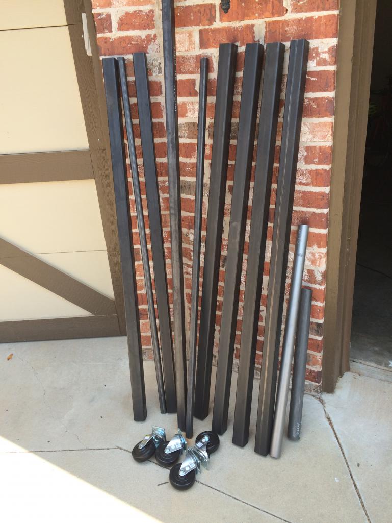

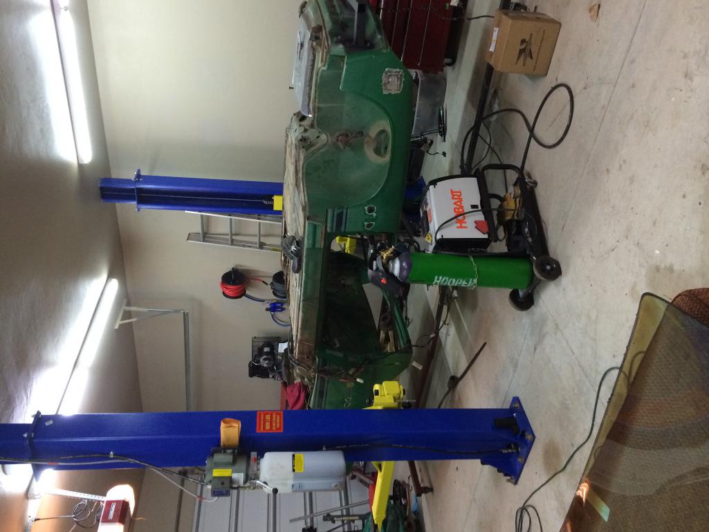

jmitro   Spent the last 4 weeks fabricating my own rotisser...   Sep 17 2015, 11:41 AM

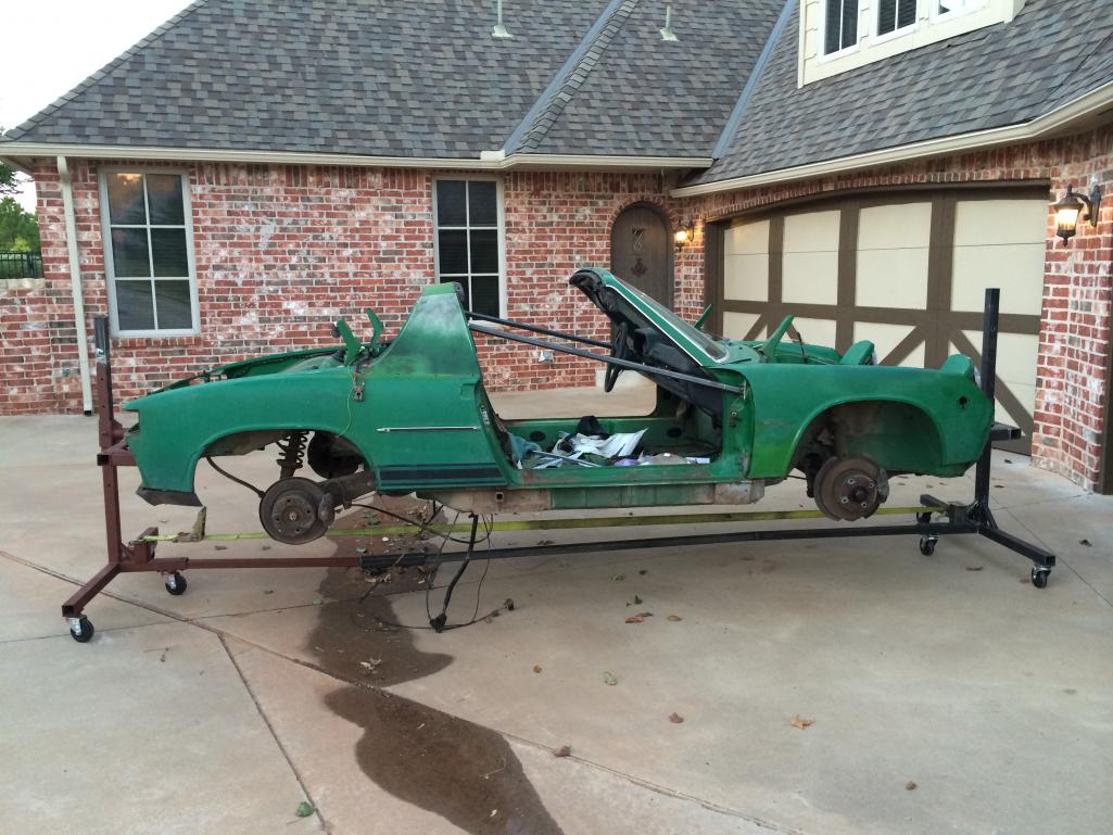

jmitro   Rotisserie finally completed and the car can be ro...   Oct 9 2015, 10:00 PM

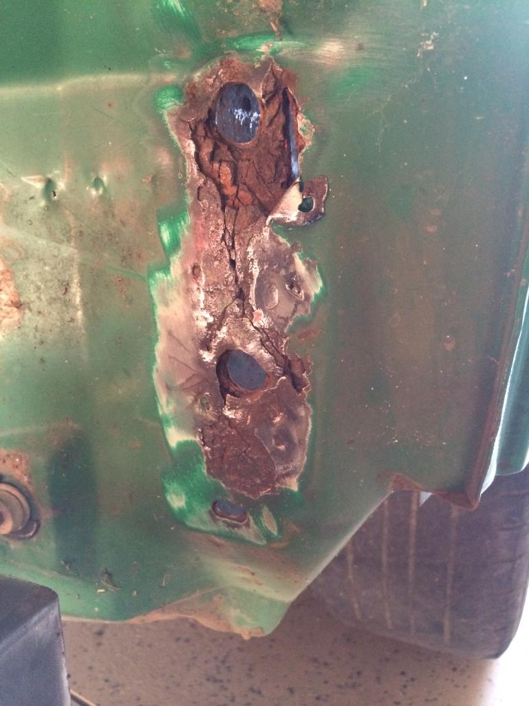

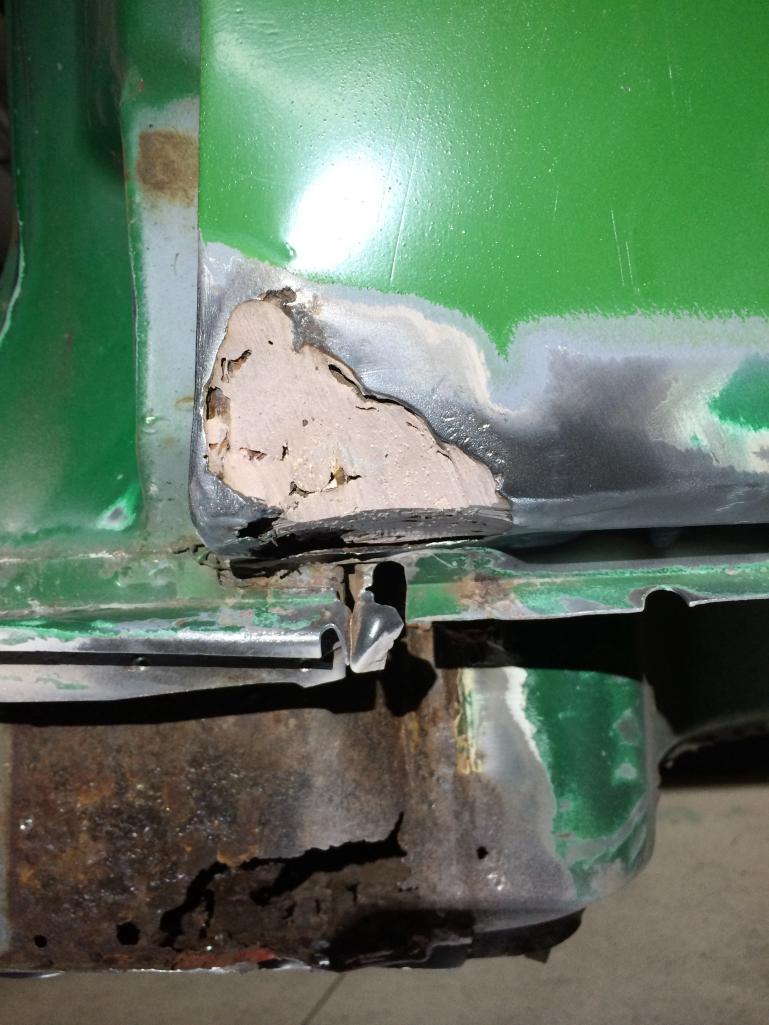

jmitro   Passenger front fender had a rust hole at the bott...   Oct 9 2015, 10:06 PM

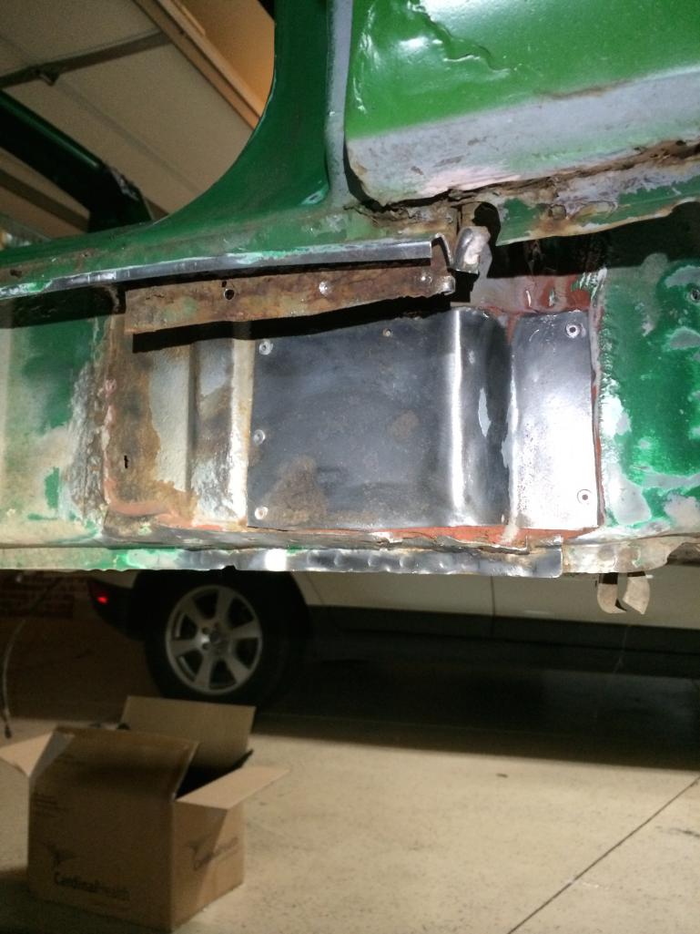

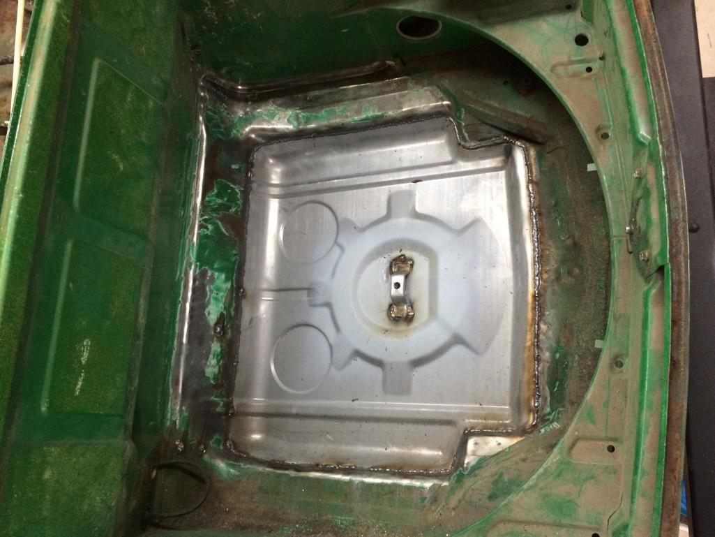

jmitro   New front trunk floorpan welded in place   May 18 2016, 12:46 PM
jmitro   Started repairing the rusted out right front Apill...   May 18 2016, 12:50 PM

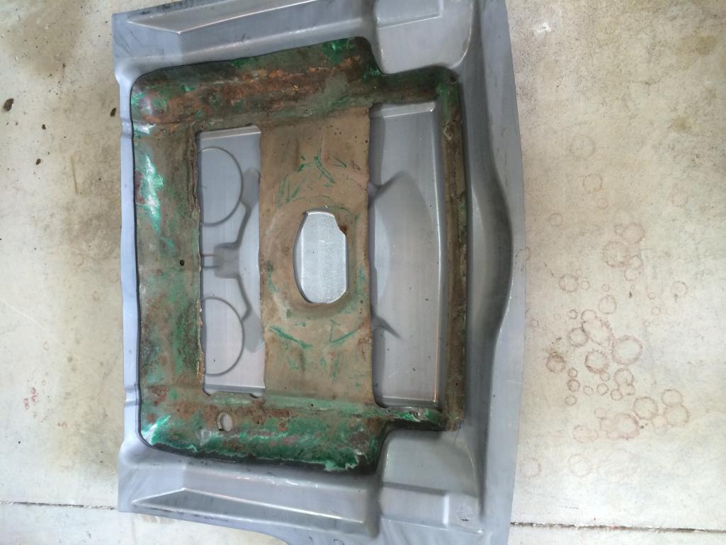

jmitro   started working on the rear trunk floorpan:   May 18 2016, 12:52 PM

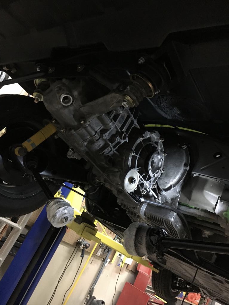

jmitro   Seems like slow progress, but a lot of work has ha...   Jan 22 2018, 11:33 PM
jmitro   19mm MC with grommets and rebuilt 914 rear caliper   Jan 22 2018, 11:35 PM
jmitro   19mm DIY raised spindle 911 struts with Bilstein i...   Jan 22 2018, 11:39 PM

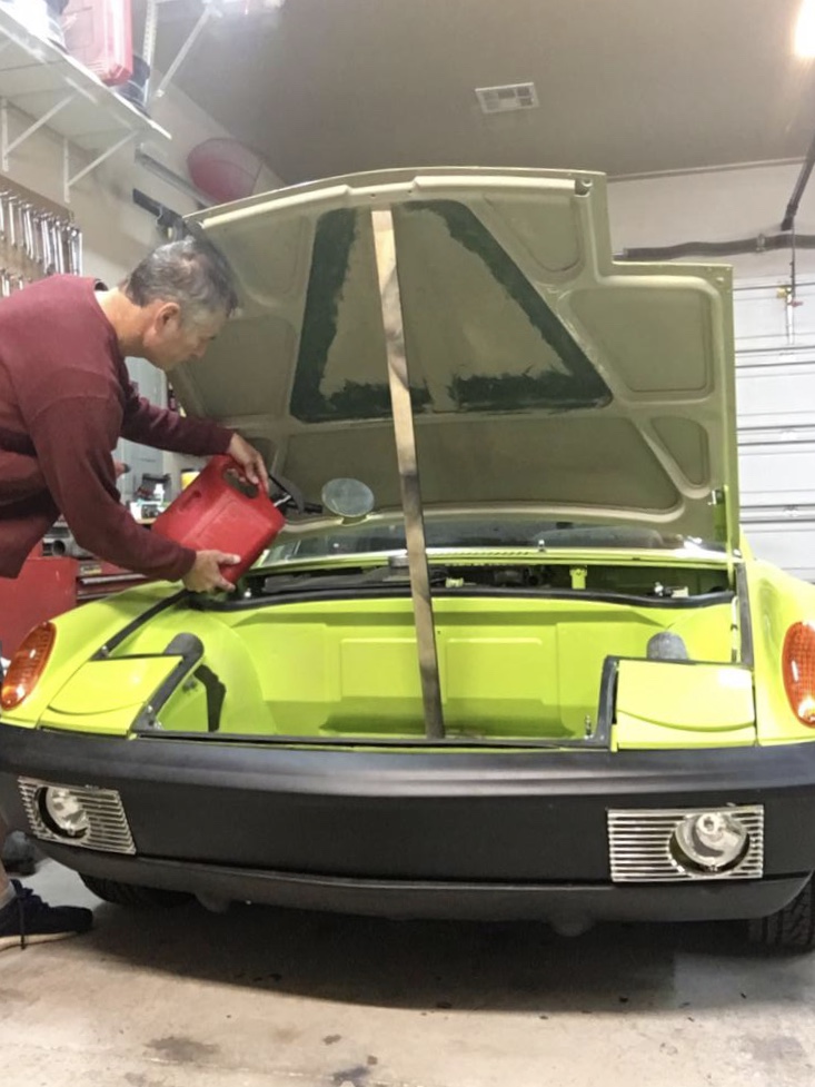

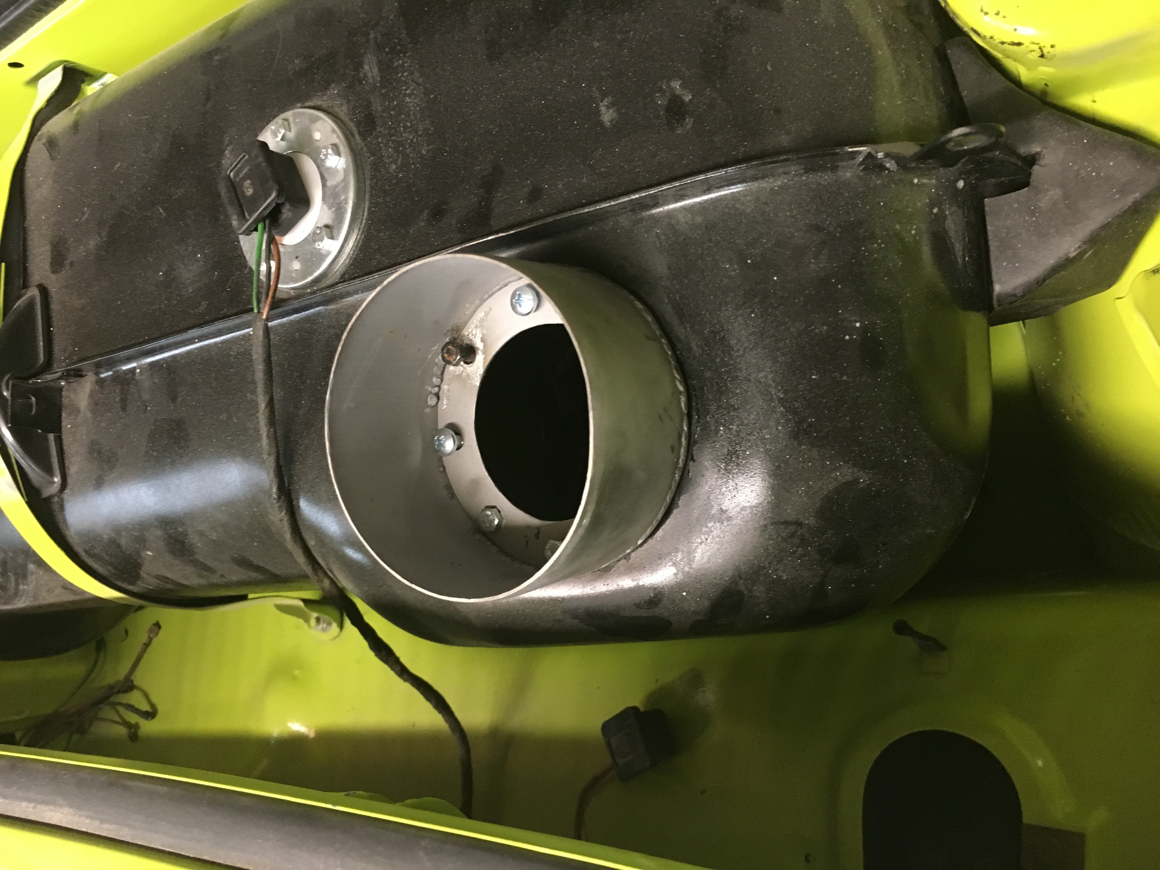

jmitro   I also managed to get the fuel tank installed with...   Jan 22 2018, 11:42 PM
jmitro   new LED front turn signals, rear turn signals, and...   Jan 22 2018, 11:44 PM
jmitro   LED tails   Jan 22 2018, 11:45 PM
pete000   Looking great !   Jan 22 2018, 11:46 PM
jmitro   914 rubber lenses and seals   Jan 22 2018, 11:47 PM
jmitro   The fun part is putting all the new parts back on...   Jan 22 2018, 11:58 PM

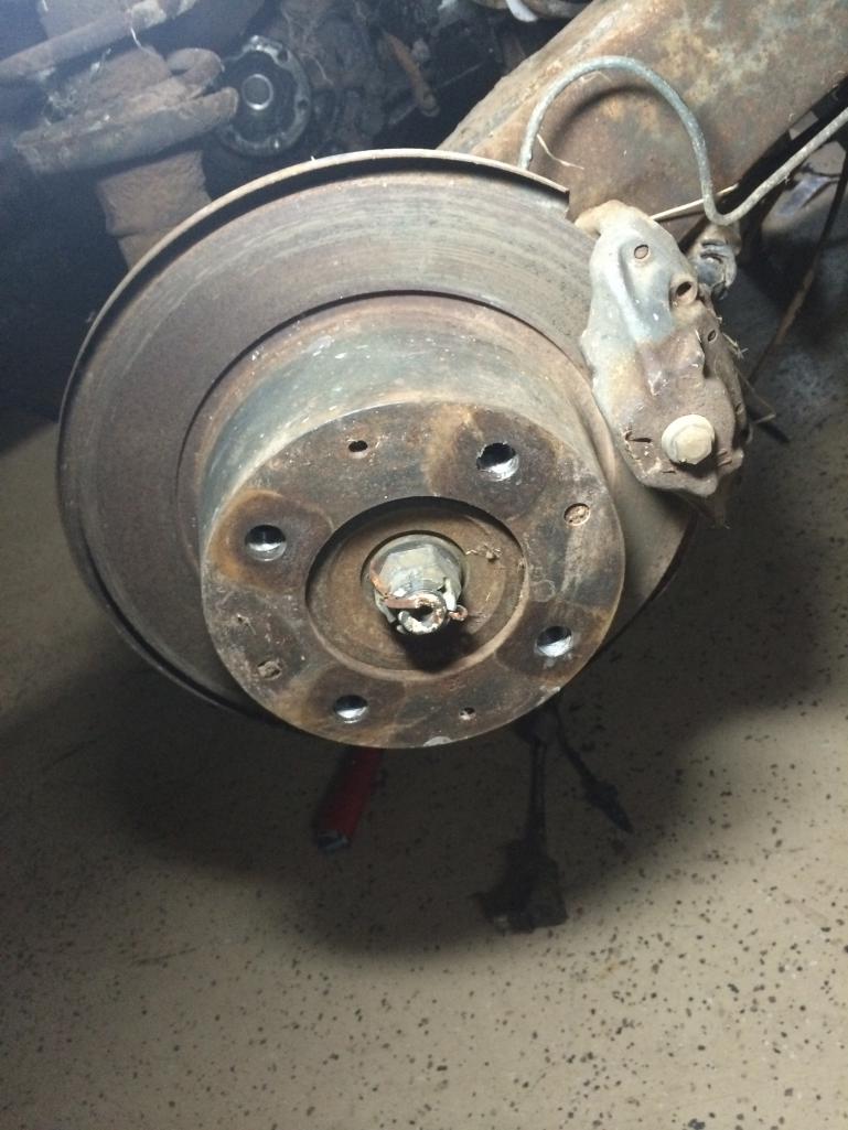

jmitro   Rear brakes   Jan 22 2018, 11:59 PM
