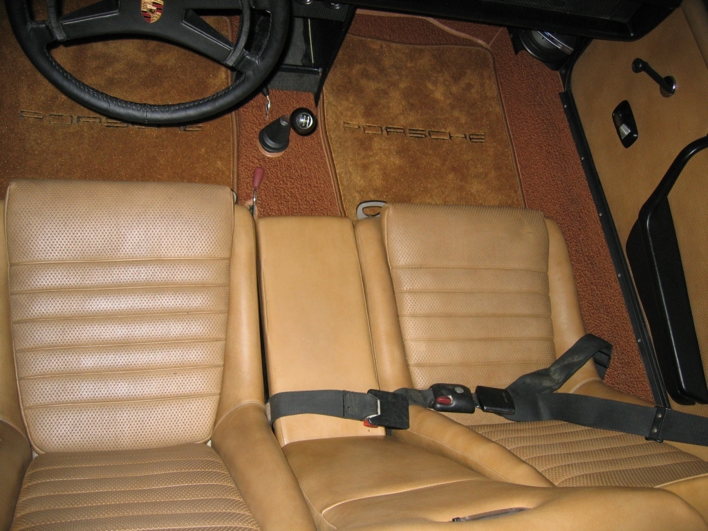

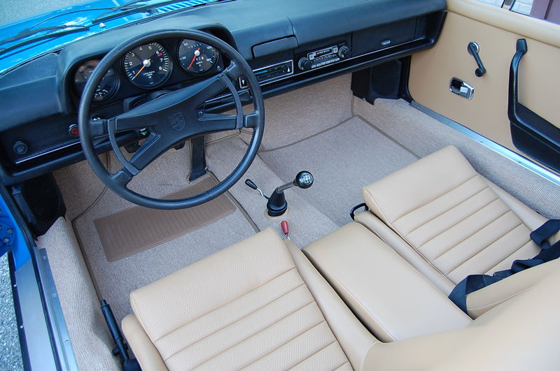

Somebody somewhere makes a tan carpet kit ...
(IMG:http://www.914world.com/bbs2/uploads_offsite/germancarsforsaleblog.com-12234-1439221537.1.jpg)
One of the problems I see is the name of the color. I've seen it called Tan, Beige, Light Brown, Oatmeal, and now Cinnamon.
Seems like you'd have to get a sample swatch before ordering to make sure the color you expect is the color you get.

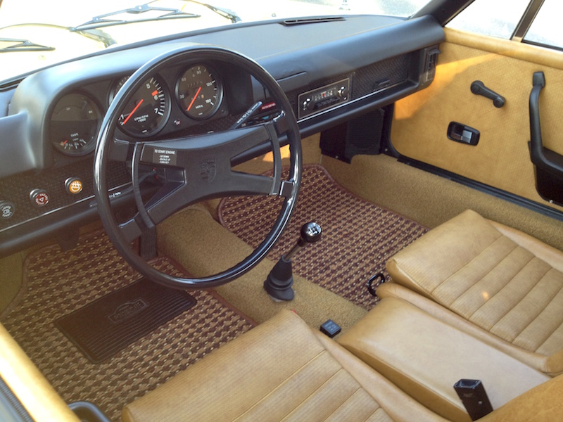

Also, and I may be wrong about this, but it seems like the square weave cars of '75-'76 had interiors with more of a golden brown color, like this one:
... not to be confused with the Brown or Dark Brown interior
(IMG:http://www.914world.com/bbs2/uploads/post-1695-1260228617.jpg)

QUOTE(dlkawashima @ Aug 10 2015, 11:45 AM) *
Wow, that 1st pic you posted is really what I'd call tan or beige. The middle pic looks a lot like my 74 & my COA calls that cinnamon. One thing I've noticed is that cinnamon showed up in 73 & you can tell those apart from the later cinnamons because the door armrests are partially covered in cinnamon. I'd say the last one is definitely brown. Getting back to the 1st pic, that looks like a six interior so I'd have to add that it's an early color. I'm not sure but I think the cinnamon & brown are later colors.

Ok folks, having been thru this name & color & materials sources morass for my own 73 914's resto, the facts are:
That in the day Porsche called the interior color "Beige" in both 72 & 74 (& I assume 73) according to the factory sales documents which can be found on Jeff Bowlsby's website. PCNA's current COA staff seem to put whatever they want on the COA's - including trying to erroneously call my #31 interior "Black" (which is actuially #11 in Porsche code) - instead of the correct "Beige" So they really don't know & eventually corrected my COA on the 3rd try! IIRC "Cinnamon" wasn't used until a slightly more swirly brown in beige/tan from the 75-76 MYs, but I never researched that myself - so check Jeff's website.
These area all NLA now, so what Rick said above is correct - you have to redo the whole interior to get a good match - either with a kit by yourself if you're skilled enough, or someplace like Autos International (AI) or World Upholstery (WU) in SoCal, or get the materials & a local shop (see below).
Next - they had 2 loop carpet colors in the tan range (not counting the brown in the 3rd pic of Dave's) - one was an all tan/beige loop as shown in Dave K's lighter one in the 1st of the pix above which they called "Tan", & the other was a flecked or oatmeal-ish tan/beige + brown blend which they called "Dark Tan" in the 2nd pic & what I have in mine, & both of which are NLA except a few bits at Auto Atlanta & maybe a few others.
Now for materials - AI & WU have a decent match for the Beige smooth leatherette vinyl & used to have it in the needed basketweave - but no longer carry the basketweave needed for the seat inserts & door panels.
So fo a perfect match on both I had to go with Lakewell.com in Europe for those & got the material which I'll have AI do my interior with at the appropriate time in my resto. Mark W./Mikey914/914Rubber didn't have any vinyl at that time last year when I finally sourced mine from Lakewell, so I cannot speak to the match.
So I'd suggest that you ask for samples from Lakewell, 914Rubber, AI & WU & any other suppliers suggested of both the smooth & basketweave (not brickweave used in 75-76) & pick the best price & match for those with both types.
Lakewell also had a dead on match for the "Dark Tan" - if that's what you have - but they lost that supply/supplier last I checked, & I'm still checking back occasionally to see if they found it again. AI & WU etc. here in the USA still sell something they call "Cinnamon" etc., but the brown flecks are way too reddish to match the 914 original look.
