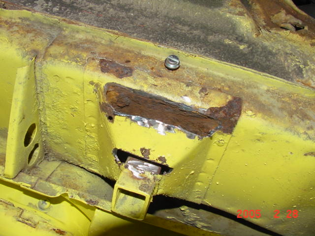

is it toast? (IMG:http://www.914world.com/bbs2/html/emoticons/sawzall-smiley.gif)

skline
post Mar 1 2005, 06:31 PM
Born to Drive
Posts: 7,910
Joined: 26-December 02
From: Costa Mesa, CA
Member No.: 17
Easily fixable, if you cant do it, bring it on up and I can do it for you. Just bring me some metal.

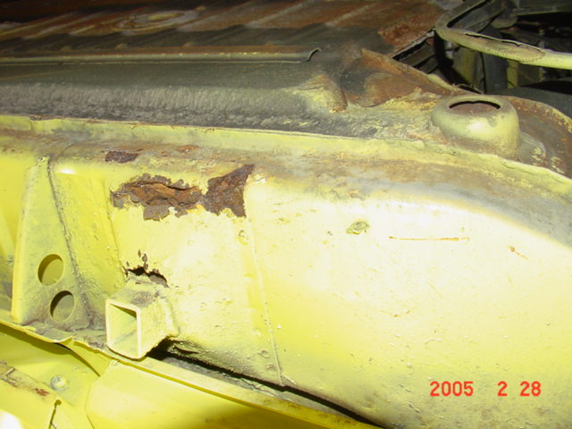

sean_v8_914
post Mar 1 2005, 06:32 PM
Chingon 601
Posts: 4,011
Joined: 1-February 05
From: San Diego
Member No.: 3,541
another view. when I poke at teh long, it is solid
r_towle
Custom Member
Posts: 24,705
Joined: 9-January 03
From: Taxachusetts
Member No.: 124
For a guy from Cali.....yes, sell the tub to me.
For a guy from newengland....it just needs a small amount of mig wire....
Seriously, take off the jack plate and get a new one, weld it back together...done.
Rich
scotty b
post Mar 1 2005, 06:34 PM
rust free you say ?
Posts: 16,375
Joined: 7-January 05
From: richmond, Va.
Member No.: 3,419
NO!
A= buy a new piece and put it in
B=cut it off and replace rotten metal with new piece and forget about jack post
C=waste time repairing rusted post
Most likely there will be rot on the long behind the post so you should go ahead and remove it
Joe Bob
post Mar 1 2005, 06:36 PM
Posts: 17,427
Joined: 24-December 02
From: Boulder CO
Member No.: 5
Get rid of it.....grind it smooth, paint it....fill the hole in the rockers and fuggetaboutit...
sean_v8_914
Chingon 601
Posts: 4,011
From: San Diego
Member No.: 3,541
teh car is for sale. I just dont want to screw anyone
Joe Bob
post Mar 1 2005, 06:39 PM
Posts: 17,427
From: Boulder CO
Member No.: 5
No one uses the stock jack....you REALLY should lift it from the donut under the car....
When I re do a car...that's the first thing that goes....
Trekkor
post Mar 1 2005, 06:52 PM
I do things...
Posts: 7,809
Joined: 2-December 03
From: Napa, Ca
Member No.: 1,413
It's true I don't use the stock jack.
However, I *always* use the jack point with a floor jack lift plate. Lifts the whole side of the car at once. Fast.
KT
Joe Bob
post Mar 1 2005, 06:57 PM
Posts: 17,427
From: Boulder CO
Member No.: 5
And when it lets go? You get a scar from the rocker halfway up the door....stoopid place for the jack point.
It's his car he can do anything he wants...."I" just think it looks cleaner with it removed and safer when it's not there to be used...
post Mar 1 2005, 07:01 PM
Resident German
Posts: 42,257
Joined: 21-January 03
From: Oakland, Kalifornia
Member No.: 179
QUOTE (trekkor @ Mar 1 2005, 04:52 PM)
(IMG:http://www.914world.com/bbs2/html/emoticons/agree.gif) me too, no problem with the stock jack-post location. it's plenty strong if it's not rusted ...
(IMG:http://www.914world.com/bbs2/html/emoticons/wink.gif) Andy
xsboost90
Posts: 1,393
Joined: 2-August 04
From: cincinnati
Member No.: 2,432
POR 15 it and forgetaboutit!
Gint
post Mar 1 2005, 07:18 PM
Mike Ginter
Posts: 16,098
From: Denver CO.
Member No.: 20
Fix it. That's an easy repair. I'd even do that myself (now). I use the stock jack points with a receiver and floor jack.

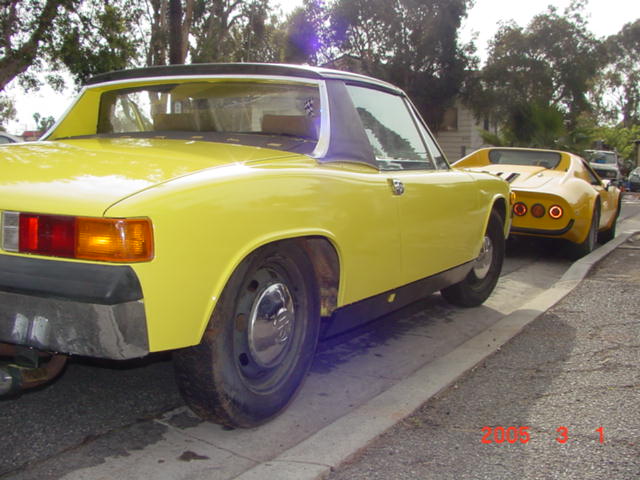

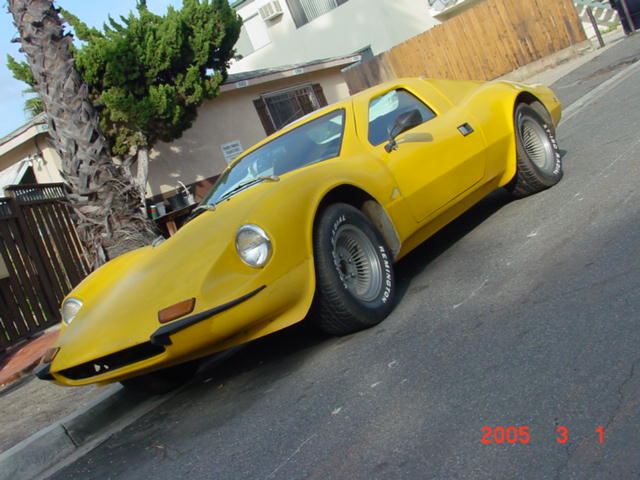

What's the car parked in front of the teener?!? (IMG:http://www.914world.com/bbs2/html/emoticons/huh.gif)
sean_v8_914
post Mar 1 2005, 11:51 PM
Chingon 601
Posts: 4,011
From: San Diego
Member No.: 3,541
Kelmark GT. Dino 246 replica
