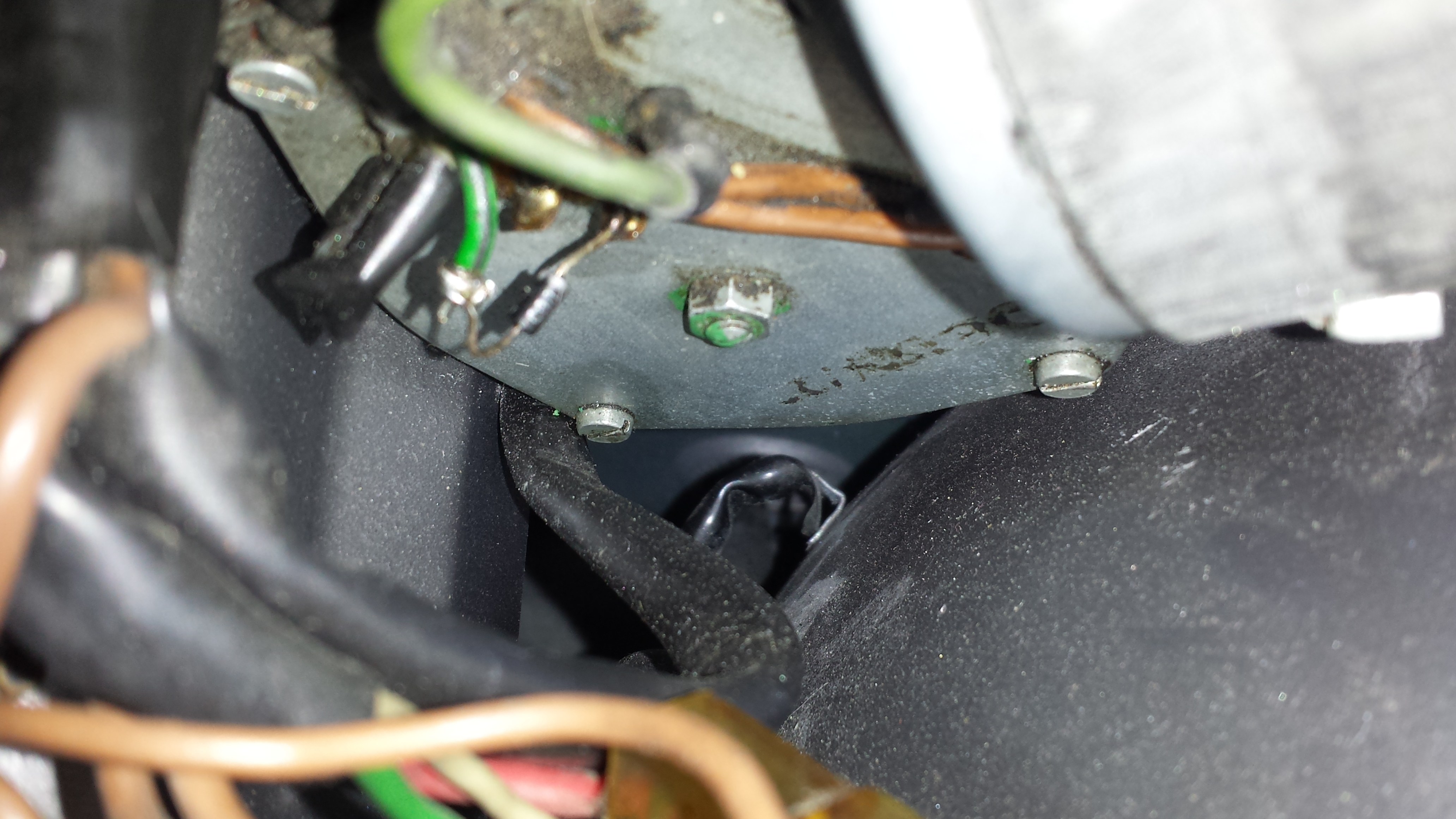

The driver side headlight on my '75 914 won't go down when the switch is turned off. I tried probing around and found I can get it to go down by lightly pushing on the black sleeving that covers the green wire. I thought, ok, must be a broken wire, or a broken solder joint. I cut away the sleeving and I see what looks to be a capacitor (?).
I the accompanying photo, if I push on the capacitor lead adjacent to the motor terminal, I get nothing. If I push on the capacitor lead at the green wire, I get nothing. However, if I push on the capacitor lead close to its (black) body at the one o'clock side, the light goes down. I get nothing pushing on the seven o'clock side. Damaged capacitor perhaps?
I have a set of motors from a '72 or '73 (don't know if they work), but will I find the same capacitor under their sleeving? Would I be better off buying a new capacitor from the electronics supply? Does anyone know the value of the capacitor?

I've removed many headlight assemblies. Never seen one before.

That looks like a diode, but it's tough to tell from the blurry pics. Is the body a black cylinder with a silver ring around one end? If so, it's a diode. What letters and numbers are on the body of it? With the exception of resistors, which have color coded rings, most electrical components have a code printed on them that will tell you what they are if you are familiar with the codes.

Agreed, not a capacitor. Just out of curiosity have you checked the opposite side headlight motor green wire for a similar diode?
AFAIK, the diode just has a simple task of not letting the current flow back in the opposite direction. That being said, why not just try matching up a diode of like tolerance (if you can find a code on it) or match a similar 12v, rated at 30amp value diode for replacement. I'll check my 914 factory manual schematic and see what I can find.

That's as good a photo as I could take, as the diode is kind of a ways down in a hole. Yeah, wish I could read the numbers.

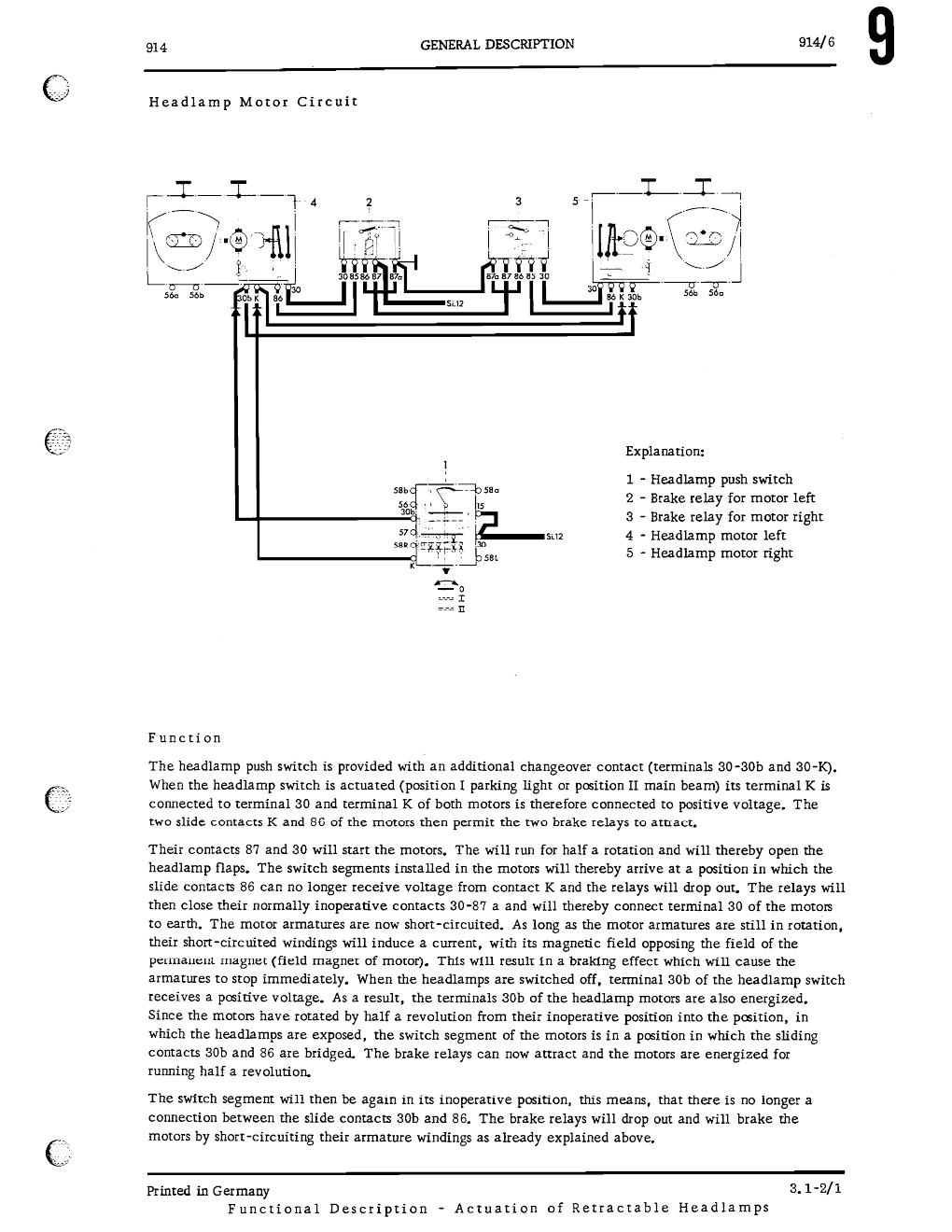

Thanks for the manual page. I see two capacitors on each motor at 30b and K, but I wonder what are their values?
Andys

I see 4 diodes (IMG:style_emoticons/default/confused24.gif)

QUOTE(andys @ Sep 7 2015, 04:19 PM) *
Mike,
Andys
You see two diodes on each motor.
This is a diode symbol:

QUOTE(914Wiggy @ Aug 19 2018, 12:27 PM) *
QUOTE(jim_hoyland @ Sep 11 2017, 01:43 PM) *
Old thread, but I have the exact same problem; anyone been in this situation
I am now! Anyone have an idea as to what it might be?
There are several possibilities; if it’ a loose connection at the diode you may be able to see it. I used a fine pick to probe around and found it. The diodes have a black sleeve over them and may appear “folded”. Probe the green wire and see whether it’s loose; I initially pushed it and made contact with the diode. The light suddenly closed. ! Scary....
