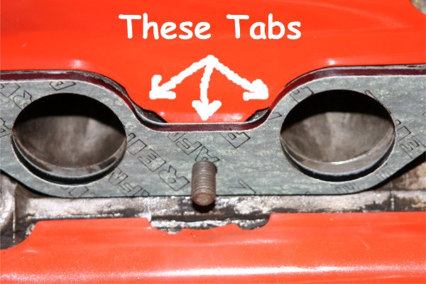

After re-installing the cooling tin (after painting) I put the phenloic intake gasket on the head to see how the fit was going to be. The tin has 3 tabs that extend under the gasket. Is the gasket supposed to go onto the head first then the tin? When I took the intakes off, the gaskets came with them. I figure the gasket should go over the tin but wouldn't that be cause for a vacuum leak??? Here's the tabs on the tin I'm speaking of.

either trim the tin or the gasket, i personally would shave the gasket not that pretty tin (IMG:http://www.914world.com/bbs2/html/emoticons/wub.gif)

Thanks Scott on both answers! (IMG:http://www.914world.com/bbs2/html/emoticons/beer.gif) The tin is under the gasket about an 1/8". As for the tin, I spent two hours cleaning & painting it. Next time I do that it'll be outta the car! (IMG:http://www.914world.com/bbs2/html/emoticons/rolleyes.gif)

I thought the same thing when I was test fitting mine, but under the tabs on the tin there is a space on the head that the tab get pushed into when the gasket is in place.

I don't recall the left and right arrowed spots on the engine tin interfering with the gasket on my car. The middle arrow would, if there were not a recess in the cylinder head for the tin to slide into.

I found the left arrow'd tab did not interfere but the right one sure did. I cliped it and it fits fine.
