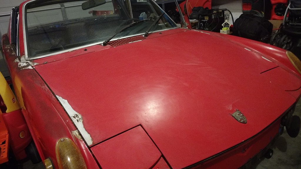

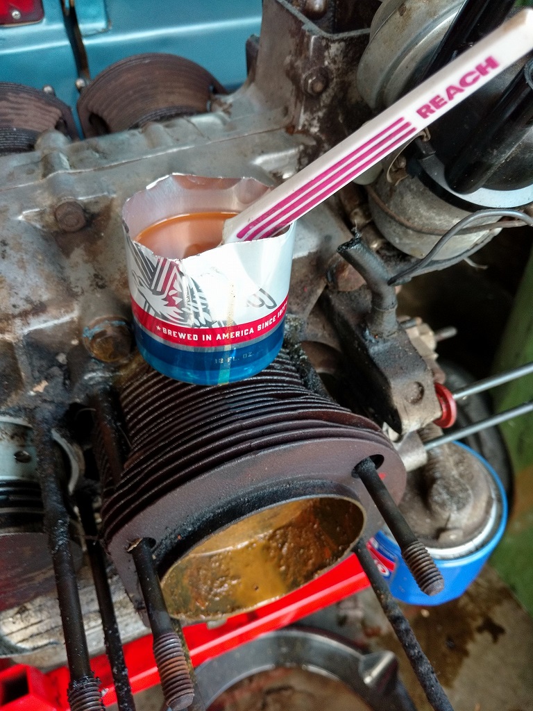

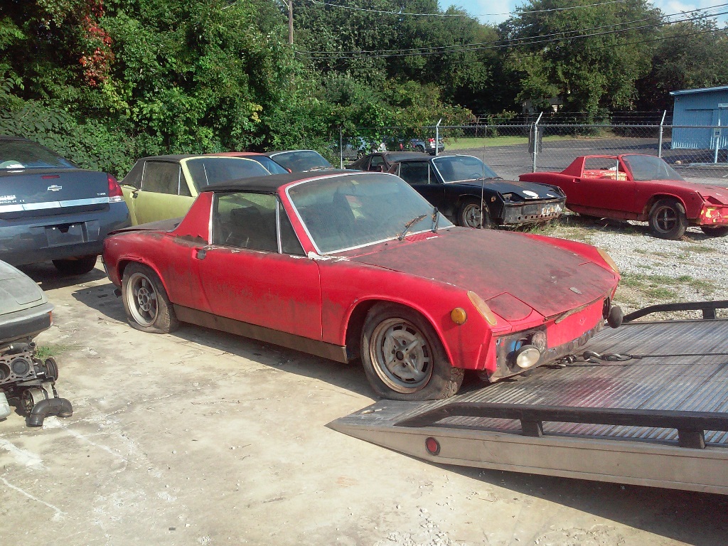

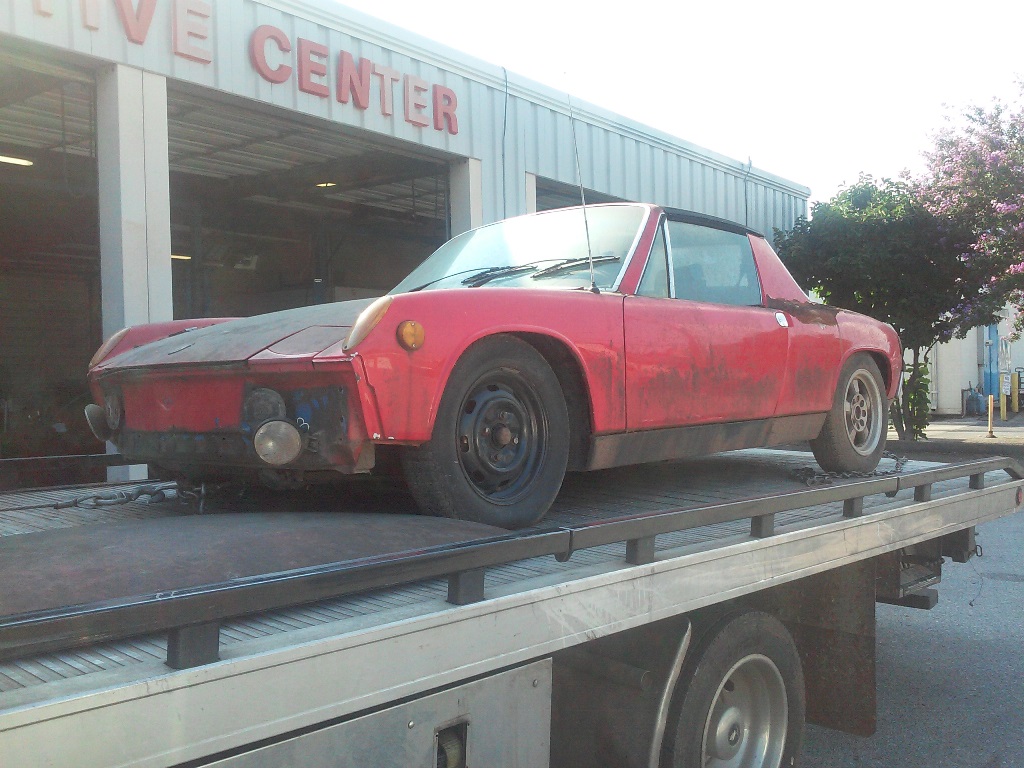

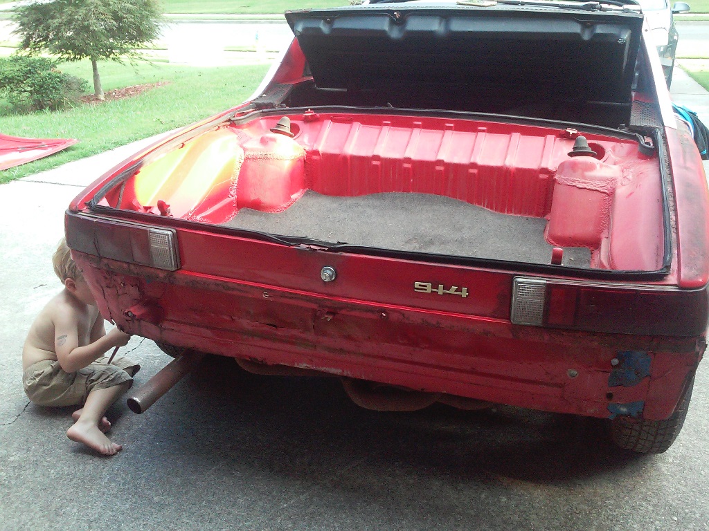

Finally got another 914. Will update as this progresses.
Trailered home
Stopped on the way home to get notarized bill of sale; required for tag

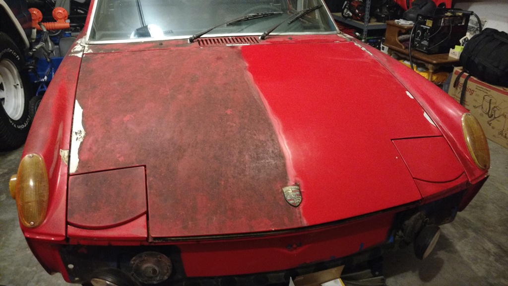

Checking out chipping paint

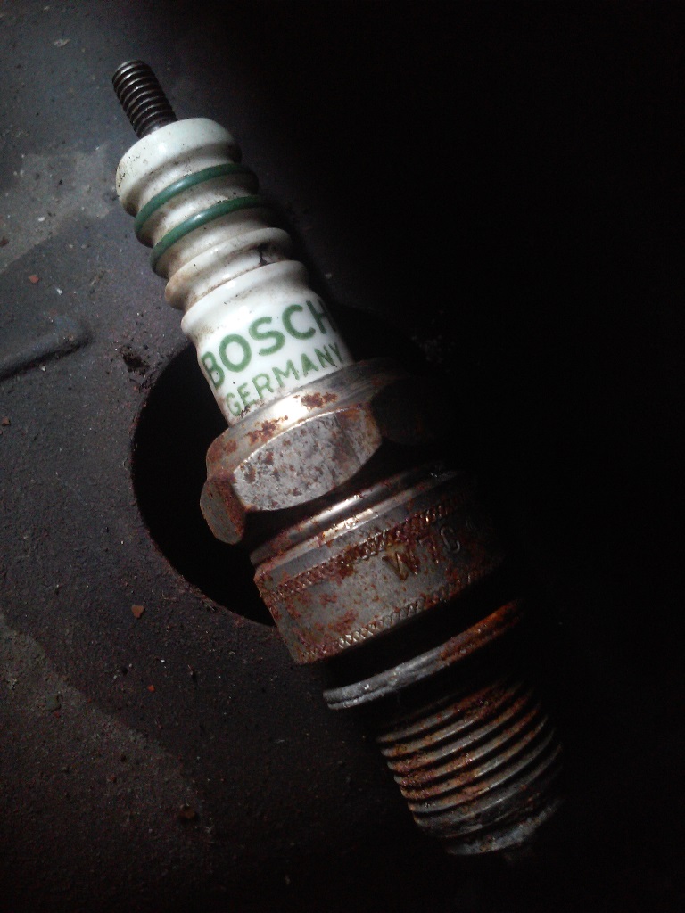

Removed 4 Autolite plugs; found a 5th stray in the engine tin - all the way from Germany
Removed valances, bumpers, rockers, and rear lid.

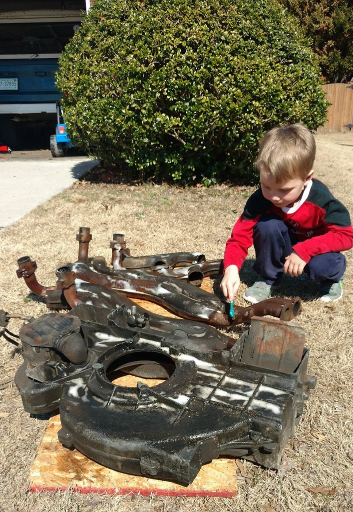

Got help cleaning up

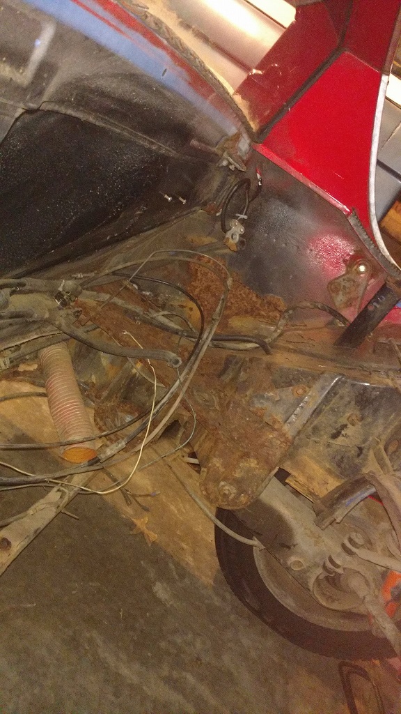

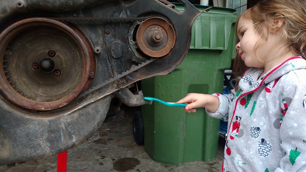

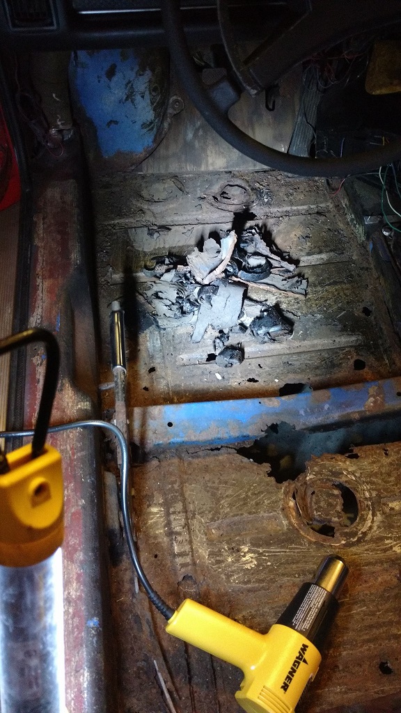

Slowly removing years of gunk
post Feb 7 2017, 01:18 PM
914-6 GT in waiting
Posts: 21,013
Joined: 19-September 09
Member No.: 10,825
Looks like there were at least 4 other 914's in the yard. Someone needs to save them.
JoeDees
post Feb 7 2017, 02:09 PM
Posts: 515
Joined: 10-November 14
From: Northern Kentucky
Member No.: 18,106
Was that one in Oklahoma? I think I looked at it a couple years ago.

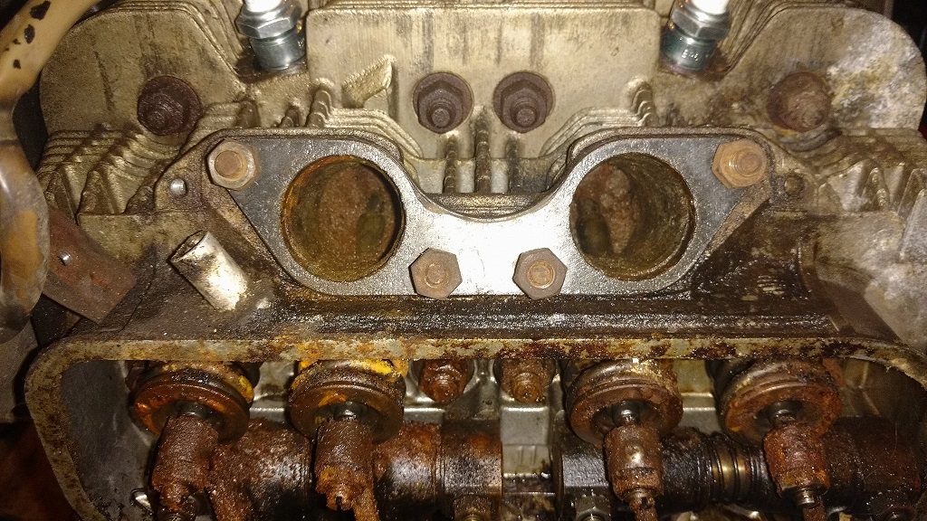

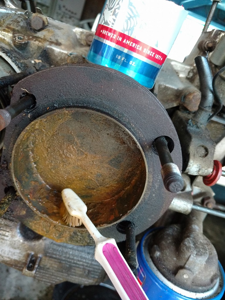

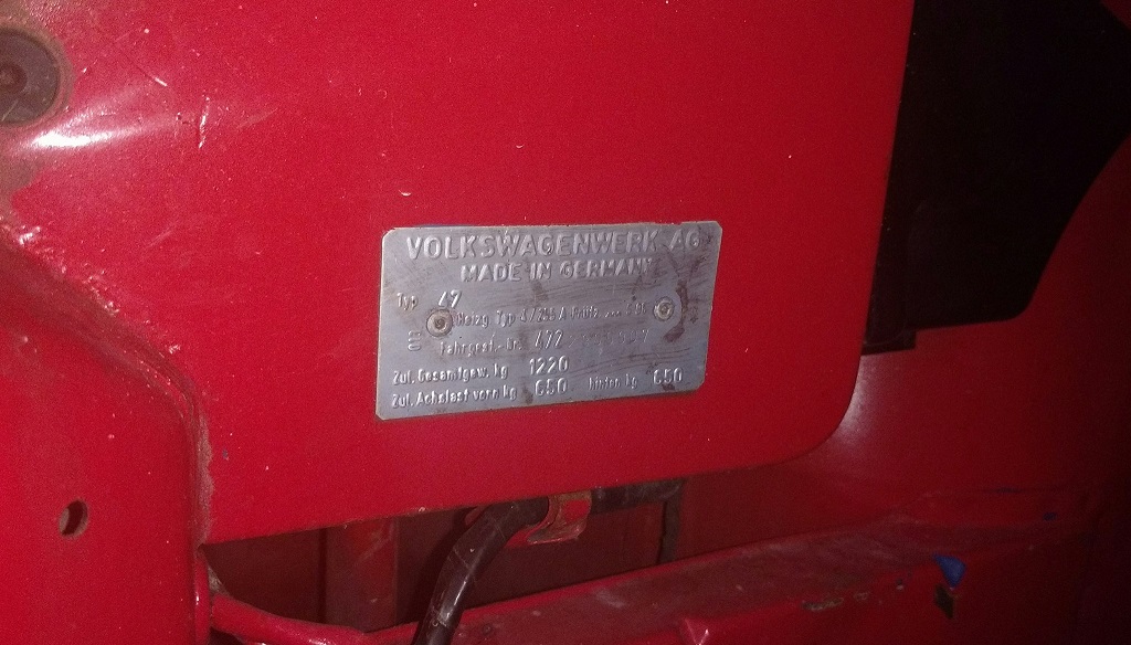

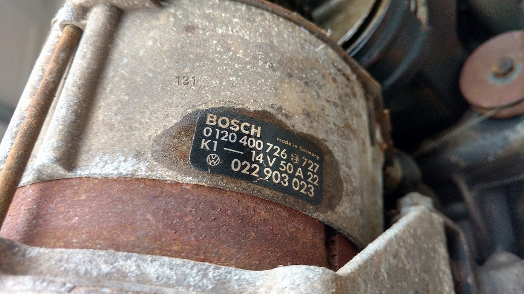

Lots of recent photos. Some I'm posting here just so I don't lose them later on.

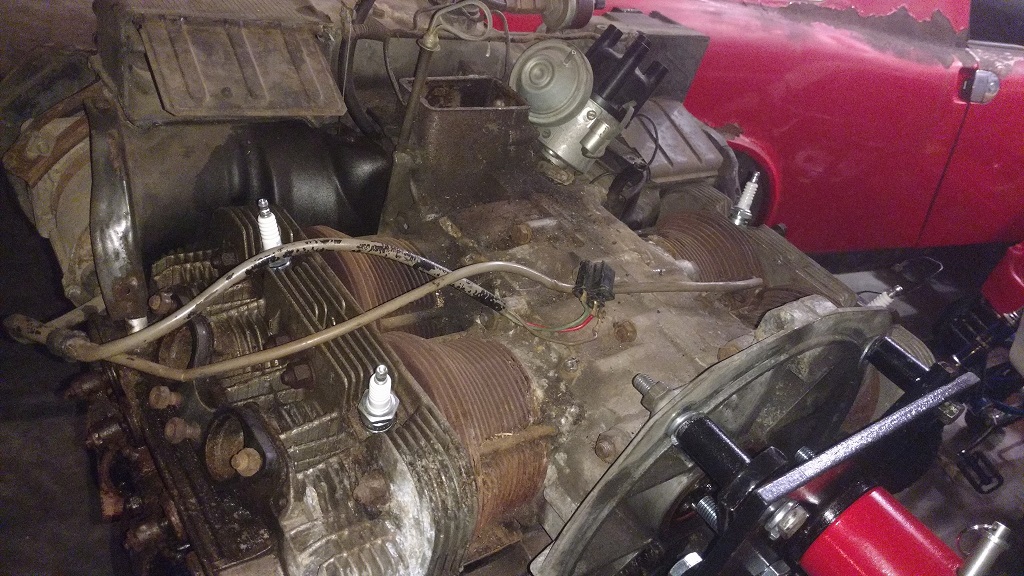

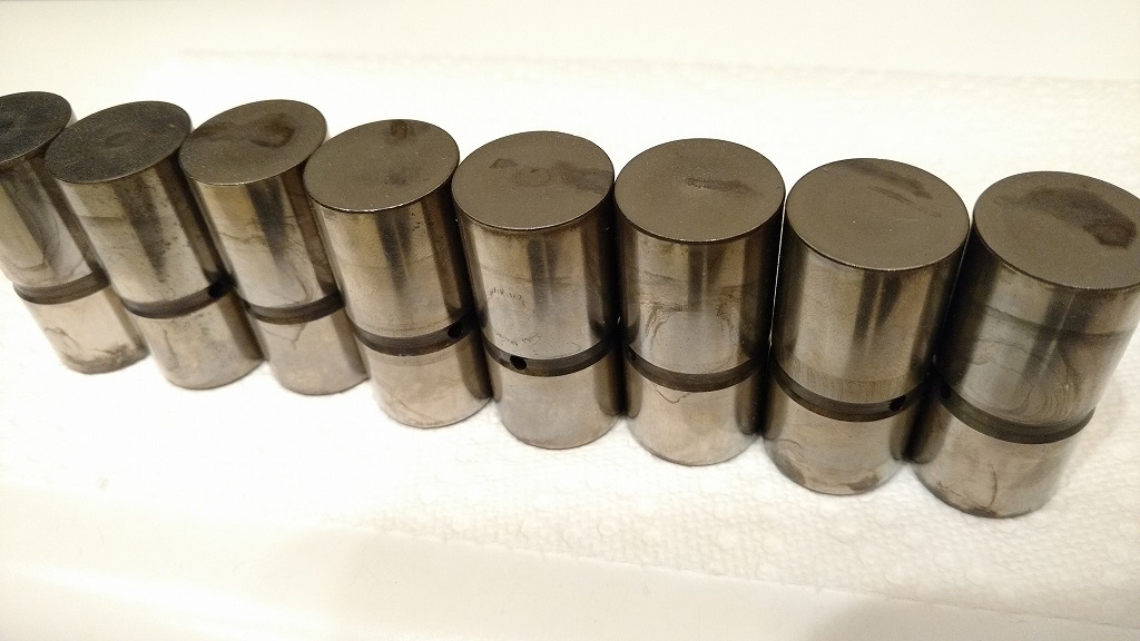

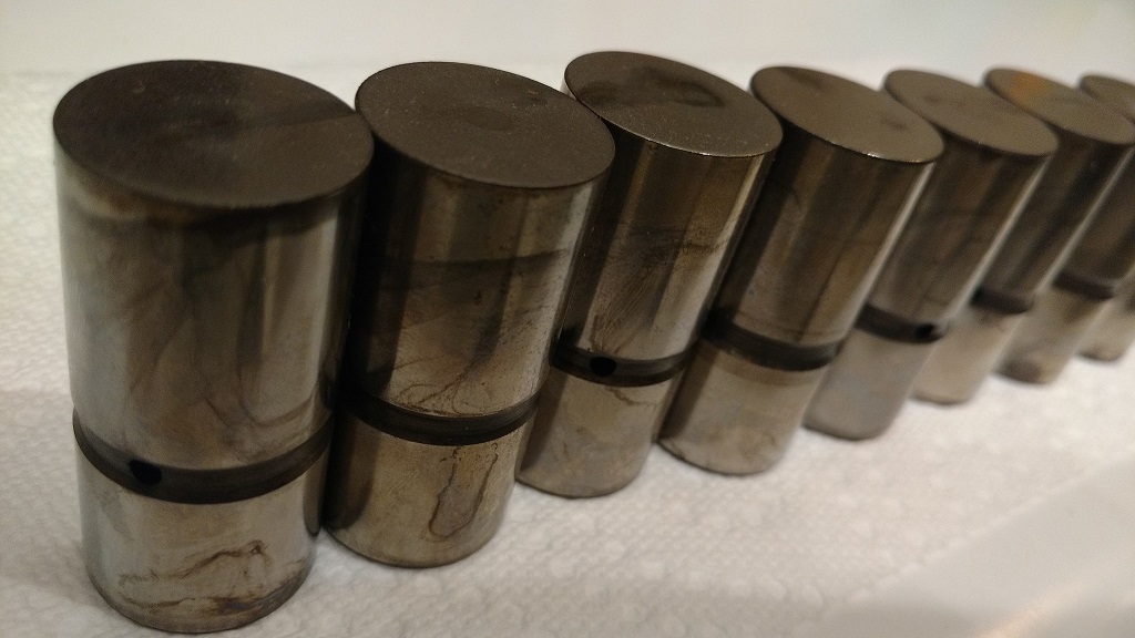

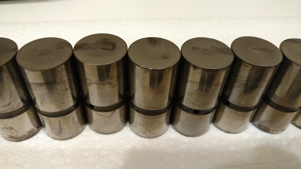

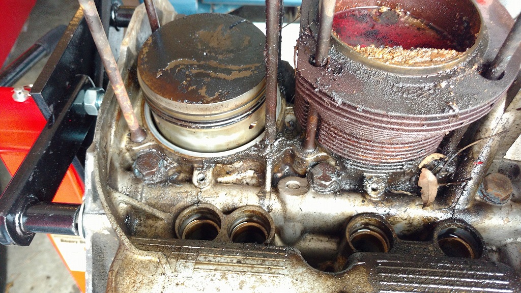

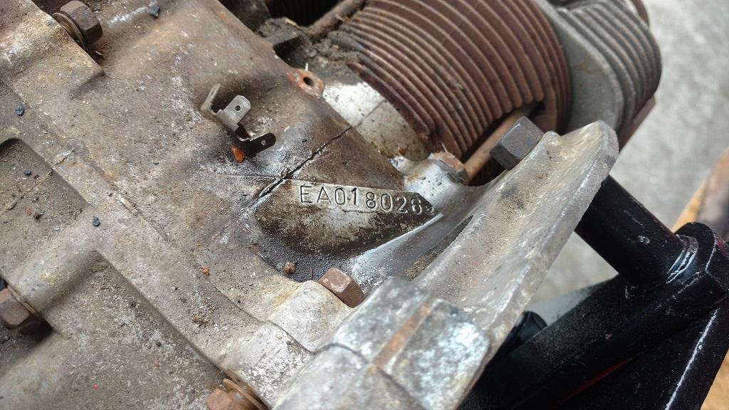

My first time getting this far into an engine. Trying to figure out what needs replacing. Any initial thoughts on the condition of these lifters? Still useable if I rebuild the 1.7?
Dave_Darling
post Mar 1 2017, 11:54 PM
914 Idiot
Posts: 15,367
Joined: 9-January 03
Member No.: 121
Hold them nose-to-nose. There should be a slight crown to them, so they should only touch in the middle. If they're flat against each other, they're wiped.
At a guess, they look pretty wiped...
--DD
schreiber
post Mar 7 2017, 10:50 PM
Posts: 137
Joined: 26-June 07
From: Huntsville, AL
Member No.: 7,843
QUOTE(Dave_Darling @ Mar 1 2017, 11:54 PM) *
--DD
They're wiped. They're done. Thanks for the expertise.

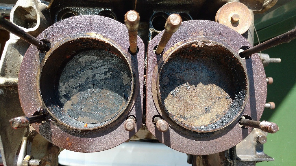

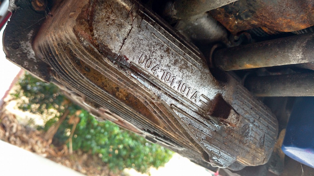

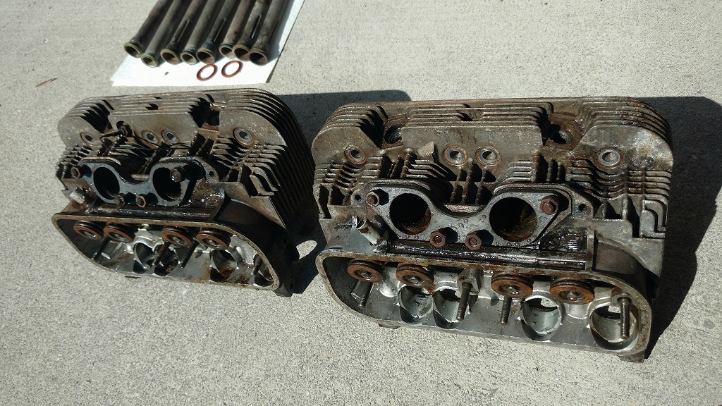

porschetub
post Mar 8 2017, 01:21 PM
Posts: 5,204
Joined: 25-July 15
From: New Zealand
Member No.: 18,995
Those barrels look like 96mm "slip in" type ,really thin @ the top (IMG:style_emoticons/default/dry.gif) .
Plan on getting your heads bored out if you stay with 96mm piston kit ,its a good upgrade from stock anyway.

QUOTE(Dave_Darling @ Mar 1 2017, 09:54 PM) *
--DD
How much crown? I was out in the shop moving stuff around and decided to look at some I had. Out of the 3 sets not a single one had any crown.
