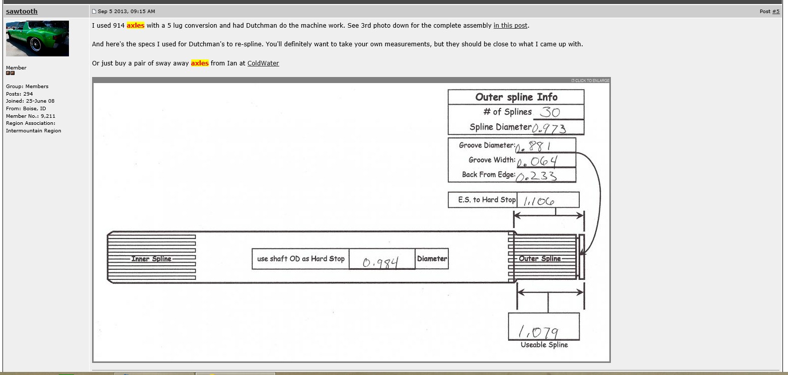

Your getting way ahead of yourself. You'll need to measure those once your drive train is in. These cars vary dimensionally. Don't be surprised if there is a 2-10mm difference between sides. You will want these cut as long as possible. They should just barely squeeze in to place with very little room to spare. BTW, when do you plan to start working on the conversion?

OD of splined end of stock 914 axle is 1.066.
what i am confused about in sawtooth's machining drawing is that the end with all the measurements looks like the 914 end that should have remained untouched i thought. is the CV ID of a suby larger or smaller than the CV ID of a 914 stock cv. i assume smaller otherwise how else could a stock 914 axles be machined to accept a suby cv ????

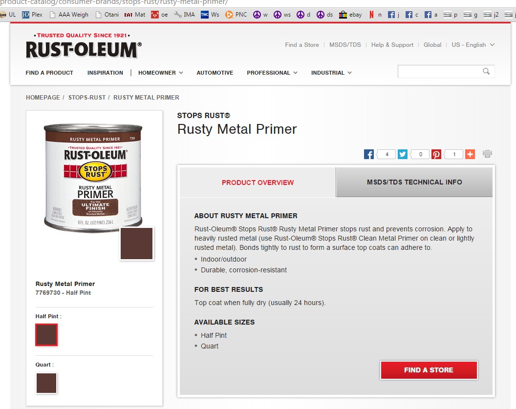

how could i best protect these pin holed longs without welding new metal in ??
i'm thinking phospho, then rise, a primer, then a skin of bondo, then rustoleum.
or maybe just rustoleum primer, skim of bondo, then a coat of rustoleum paint.

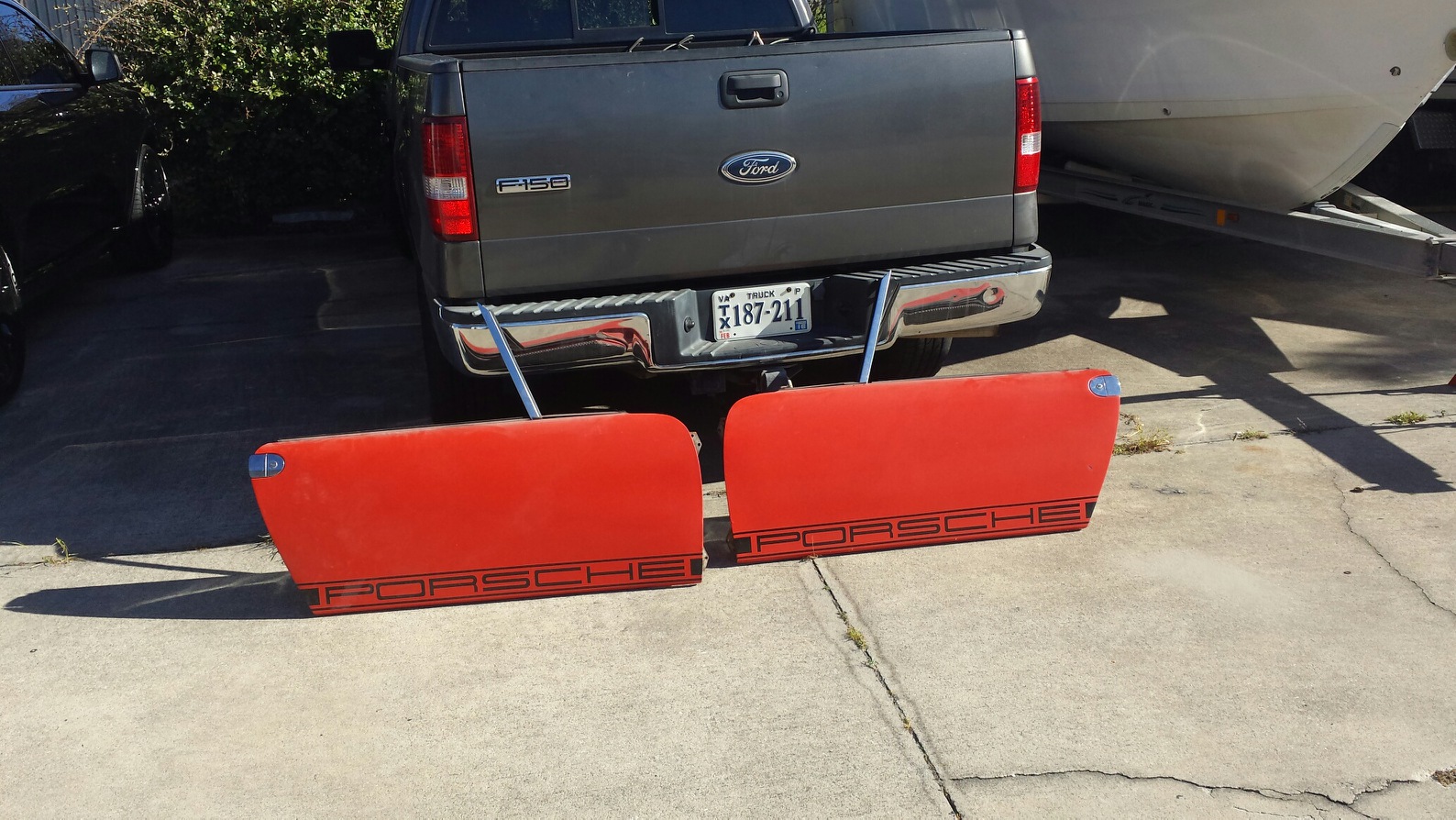

my buddy - rat rod charlie - is on his way to daytona for bike week with his harley and his trailer. while he is down there, he is going to visit series9 for me and pick up a pair of late model ARIZONA doors from ablesnead whose car is at joe's shop (IMG:style_emoticons/default/biggrin.gif)
Read right past this the first time but yes, you are correct. Plenty of meat.

got me some doors coming via series9's shop.

QUOTE(jimkelly @ Oct 12 2015, 10:07 AM) *
What happens when you stab it with a screwdriver? If it goes through I would replace it...Mine looked like that and I patched it.. You have a fairly easy job there. Sure it'll set you back maybe 2 weeks but its the right thing to do... If you dont have a welder you can rent them fairly cheap.
