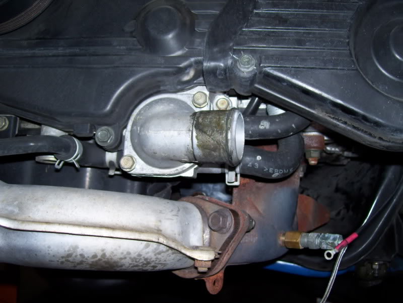

thanks guys for chiming in, very appreciated (IMG:style_emoticons/default/smile.gif)

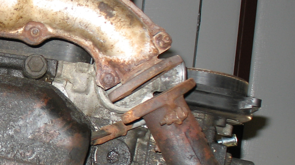

yes, seems i will have to change to a turbo water pump. still this will be a hose pretty dang close to a exhaust manifold.

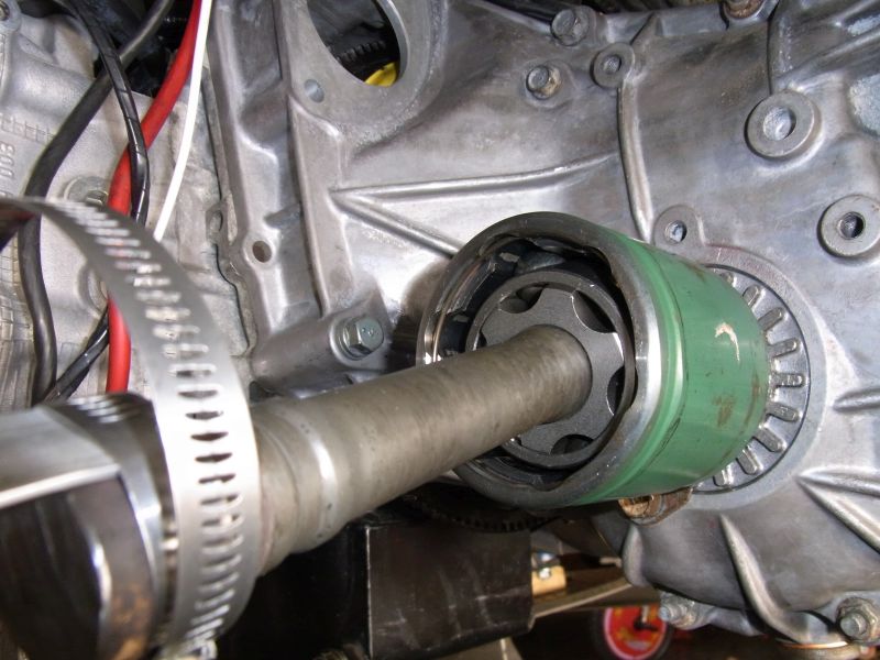

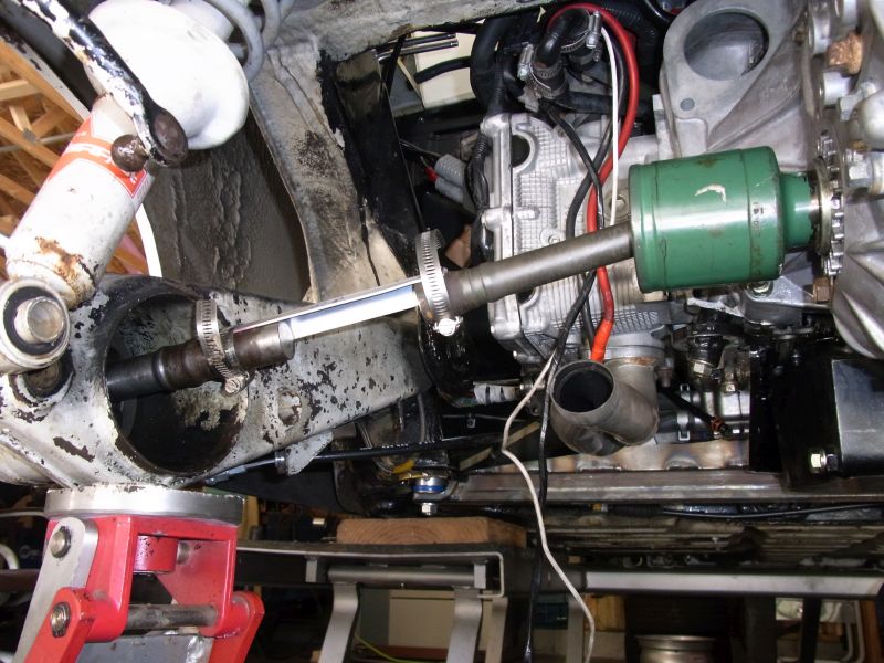

i'll size up my axle like this member did.
and use dutchman.
914 cv wheel end and suby cv trans end.
nice a dry too, no grease (IMG:style_emoticons/default/biggrin.gif)

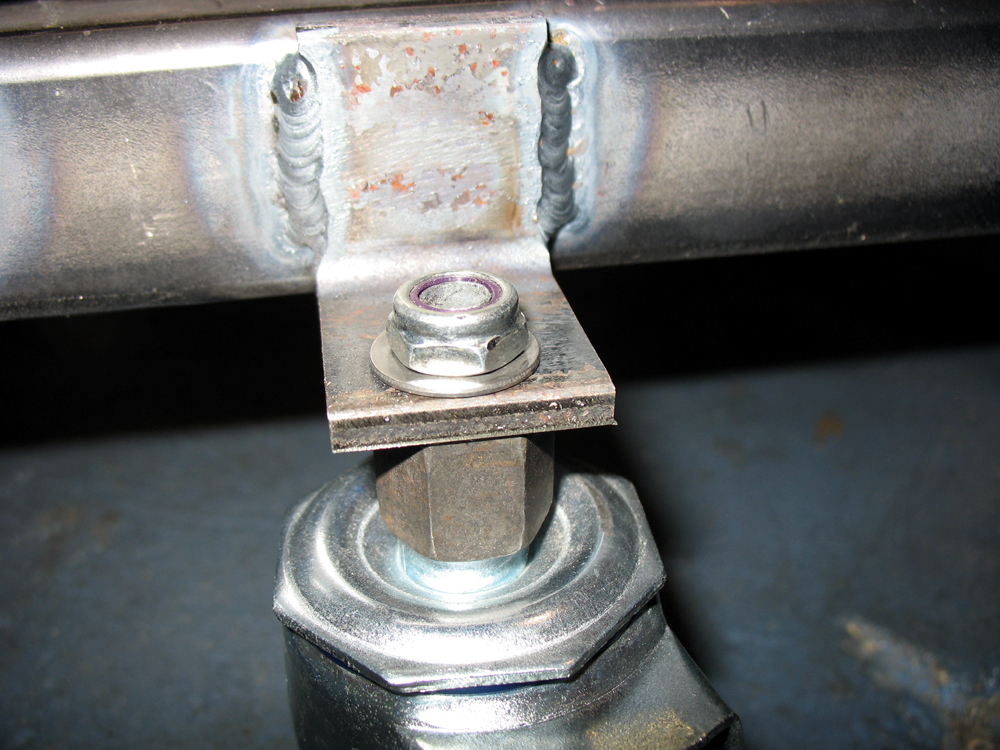

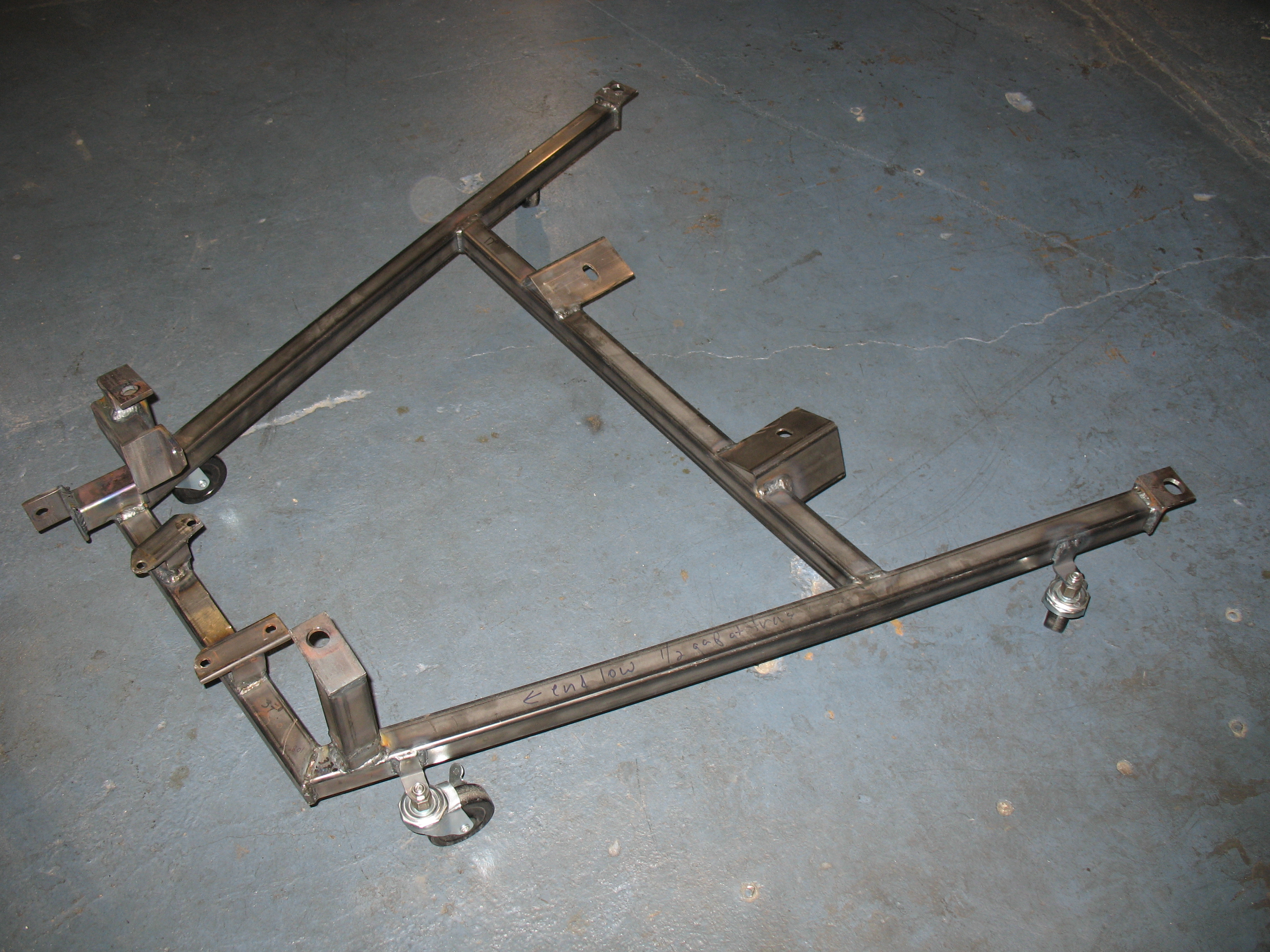

what the hell, i added wheels, not sure my oil pan won't touch the ground (IMG:style_emoticons/default/popcorn[1].gif)
i don't know about you guys, but when i pull an engine, i drop the car down low with wheels off, undo engine/trans mounts, a let eng/trans rest on furniture dolly, THEN, i lift car up crazy high, so i can roll assy out from under car.
i know some lift engine into lifted car.

QUOTE(jimkelly @ Jul 27 2017, 02:56 PM) *
Better put some gussets on those wheel brackets... Those wheels are going to fold up pretty easy.

QUOTE(jimkelly @ Jul 27 2017, 08:16 AM) *
That looks like it would be easy to either build a custom housing or rotate possibly 90deg on either one to move it away from the exhaust. I say 3/16" plate, template, drill holes and cut out shape, then weld in some tubing in your desired direction. Plane the metal flat when your done and powdercoat and add gasket. (IMG:style_emoticons/default/smile.gif)

gussets, fuck, shit. should have used 1/4 thickness vs 1/8.
though i don't see a way around using a turbo pump and i don't mind as long at it is simply a bolt on swap.

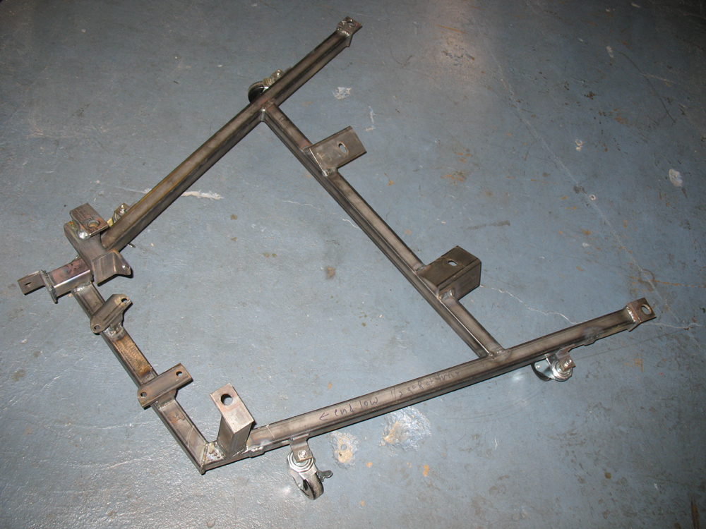

alright. i redid redonedid the wheel mounts and used 1/4 angle (IMG:style_emoticons/default/welder.gif)
short welds mostly bottom to top, but i prefer welding right to left, horizontally, sitting comfortably, with hand supported (IMG:style_emoticons/default/smile.gif)

I didn't use the stock header. I used an aftermarket header. You did track down the manufacturer and post a picture of the header in my thread. It was post 386. It was HDG Performance.
I am not sure if it is less expensive and easier to change the water pump or buy a new header?

i decided against an aftermarket header in favor of a subaru oem turbo header. for compactness and $9.99 on ebay + $25 shipping.
but now i need to change water pump to turbo style also.
this at least will force me to replace old water pump (IMG:style_emoticons/default/smile.gif)

QUOTE(Andyrew @ Jul 27 2017, 03:16 PM) *
I see 6 other places that I would add gusset's. How much does that thing weigh, Jim?
jimkelly
post Aug 2 2017, 08:00 AM
Post #251
Delaware USA
Posts: 4,969
Joined: 5-August 04
From: Delaware, USA
Member No.: 2,460
31 LBS. what u thinkin 76-914?
and here is a pic that shows the turbo water pump with my header better. amazing clearance with turbo water pump. maybe 1.5"

You might already be planning on it, but I would spend a little time with an angle grinder to take down the sharp points just to protect yourself. It sucks getting cut on a sharp edge when you're working on something else entirely.

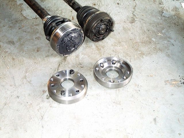

Yes, I have the adapters for a 901/914 transaxle output flange to a 100mm (86mm x 8mm six bolt threaded pattern) CV joint. $100 each. Thanks for asking.

So 400 for a set of 4. Or 200 for a pair if you do it like I did. Not that bad.

see andyrew's post #498 and his whole awesome thread (IMG:style_emoticons/default/smile.gif)
http://www.914world.com/bbs2/index.php?sho...4780&st=400
