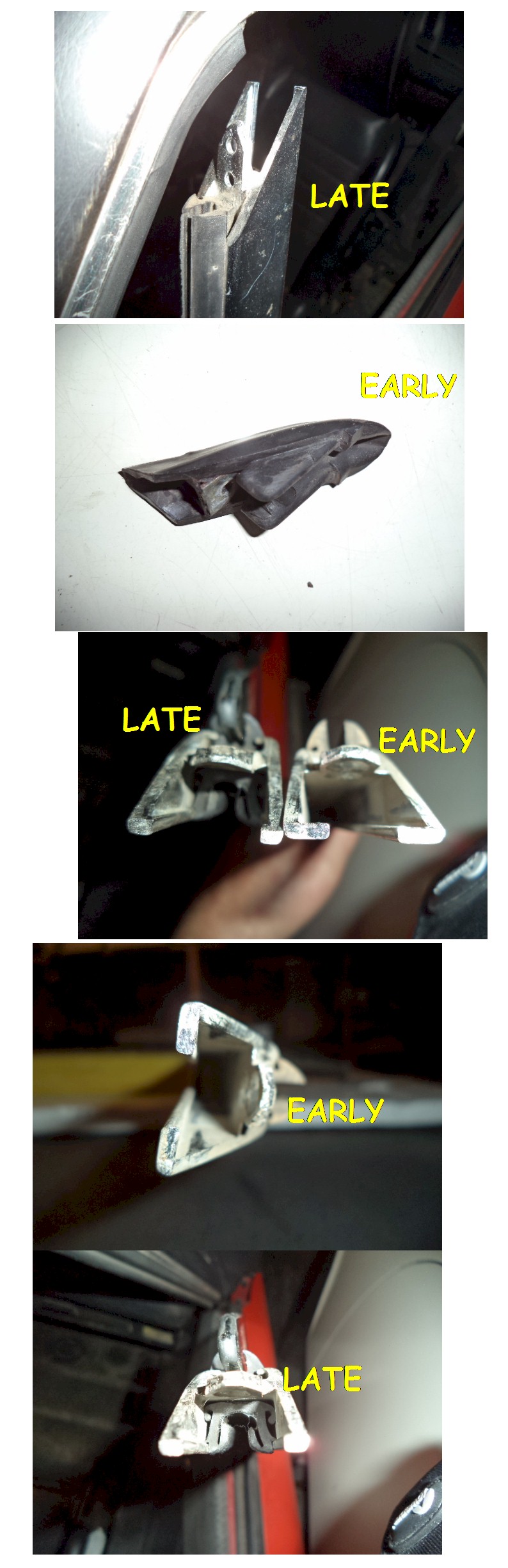

white doors are back on my 1975 and red doors are now on my 1972. having an issue with the caps for the triangle windows though.

got the caps on, seems all years are the same.
