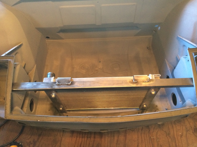

I ordered a Scirocco style radiator for my Subaru 2.5 NA conversion. It measures approximately 20" X 11" X 1.5" and is a double pass. The stock radiator measures 13.38 X 27 X 5/8". The scirocco radiator has more surface area if I consider that it is a double pass and twice as thick ie 440 square inches versus 361 square inches. Am I safe to assume that the scirocco (though smaller and thicker) will have the same or better cooling power as stock?
(IMG:http://www.914world.com/bbs2/uploads_offsite/i1301.photobucket.com-17072-1443382875.1.jpg)
Details here: Radiator portion of thread.

I think It will work fine as long as it is properly ducted and sealed.
I'm running a Celica GTS rad on my conversion. It fits the trunk space better and is about the same height. Check out the last few pages of my build thread for pics.

Is your Celica radiator a single pass radiator? I am hoping the thickness of this radiator makes up for the surface area and that the effective cooling area is actually greater.

I'll add what I put in your build post.
Your rad is good for 400HP with a kludged fan, and 600 if you use their fan. I believe the difference is that they don't want the liability for a bad design.

Celica rad is single pass but works really well. Yours should work well with the Subie engine as well. I used mine as it was less work and a cleaner install on the shroud.

I've got the same radiator as Mike mounted a bit further to the front if your looking for another install. (signature)
I think your radiator would be just fine, I initially thought it was to small then I saw it was double pass and fairly thick. Put a high dollar fan on it and shroud it really well and I doubt you will see any issues.
