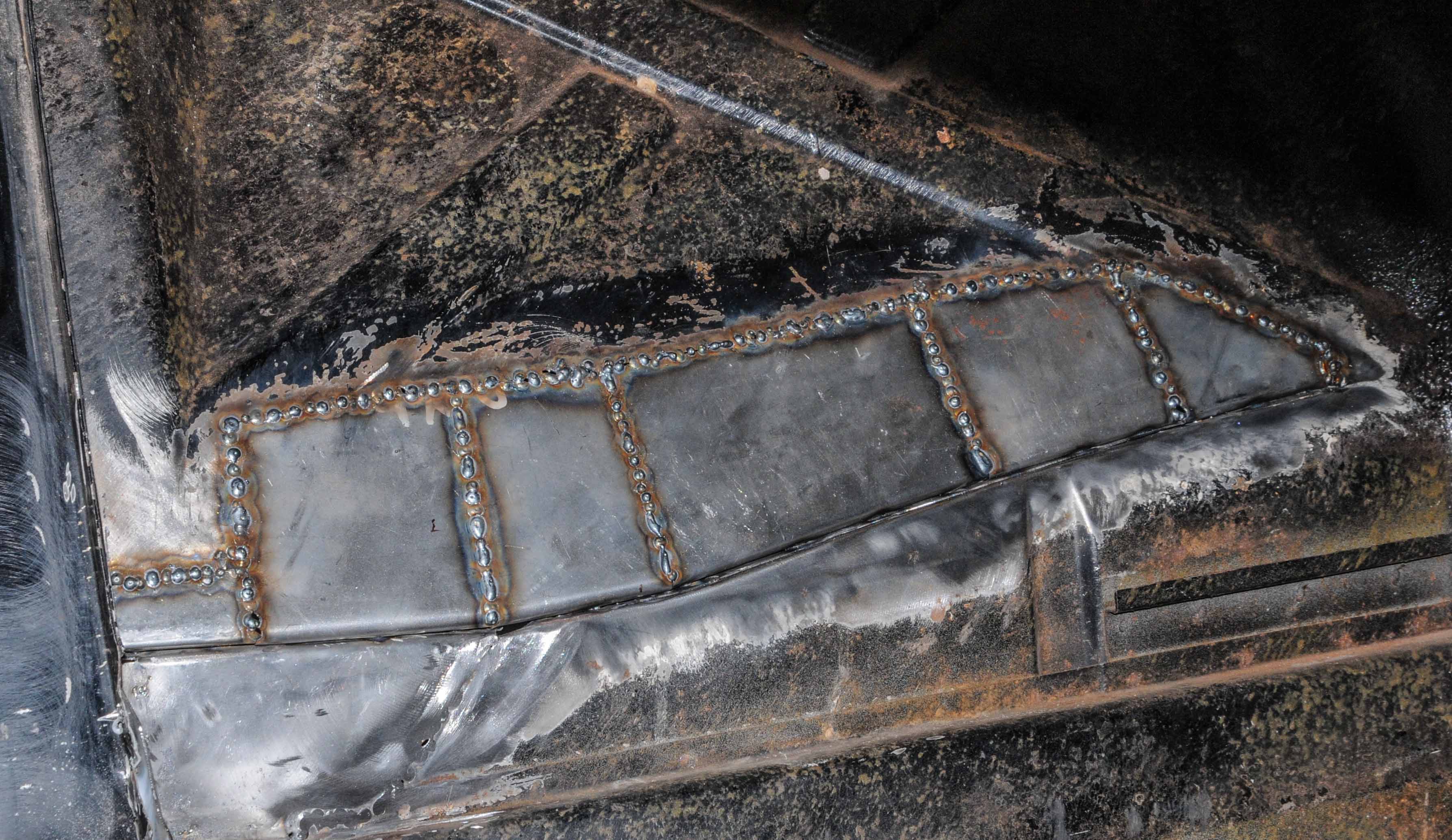

DirtyCossack   This weekend was spent on one major job, a job I t...   May 8 2016, 08:41 PM

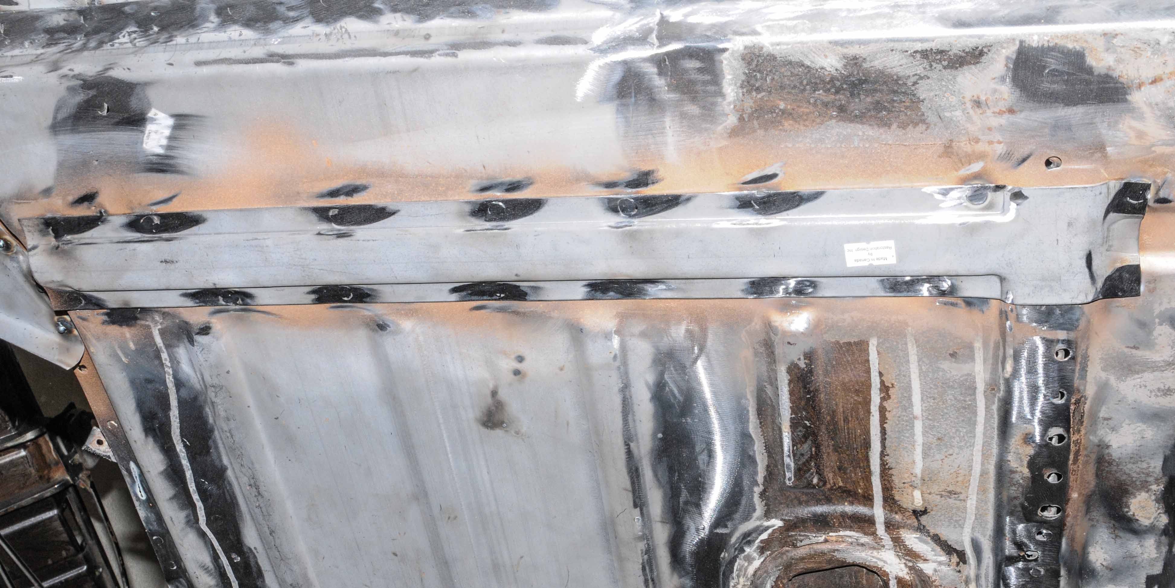

DirtyCossack   What you see is 6 hours of work. This was probably...   May 22 2016, 08:52 PM
DirtyCossack   You can also see in the pics (not really this one)...   May 22 2016, 08:57 PM
Garland   Nice work, attention to detail will pay off.   May 22 2016, 09:05 PM
