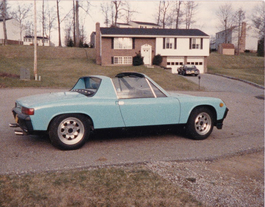

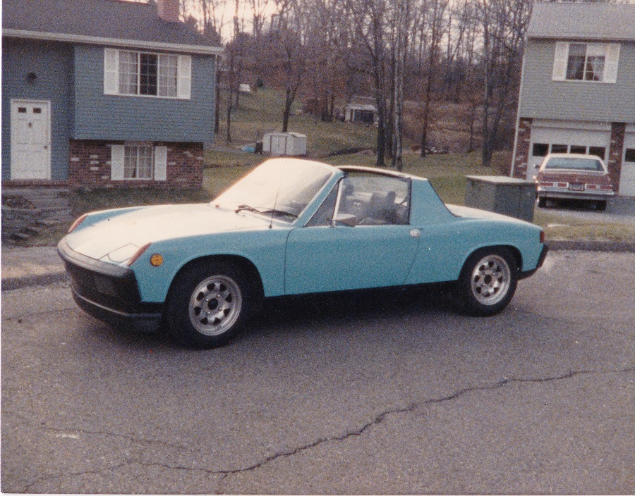

Here are the earliest pictures I could find.

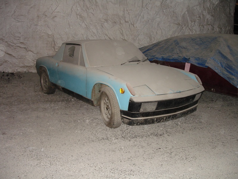

And the day I was taking it to the mines
It wasn't supposed to be here this long..

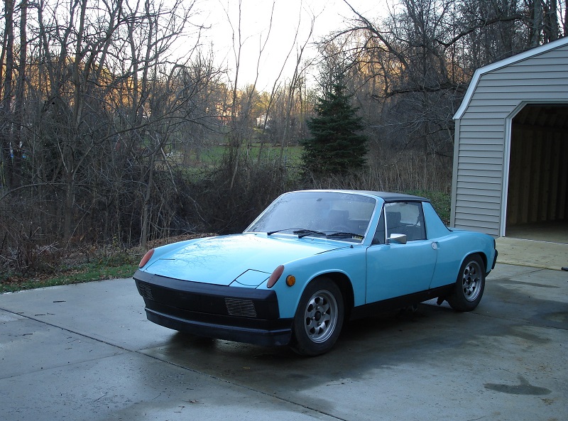

Fast forward to 2010 -- Coming home. First daylight in 20+ years...
I brought it home to a new 14 X20 SHED I had built just to work on the car. complete with 220V, phone and cable.
After its first bath it doesn't look too bad. But in spite of being buried over 1 mile inside a mountain AND being in a temperature and humidity controlled storage the rust worms were still at work. albeit a little slower.
