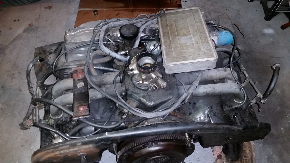

FRIDAY: out with the old...
SATURDAY: in with the new...
SUNDAY: need to attach exhaust system and hook up fuel lines, accelerator cable, and a few other minor things then time to fire it up! (IMG:style_emoticons/default/aktion035.gif)

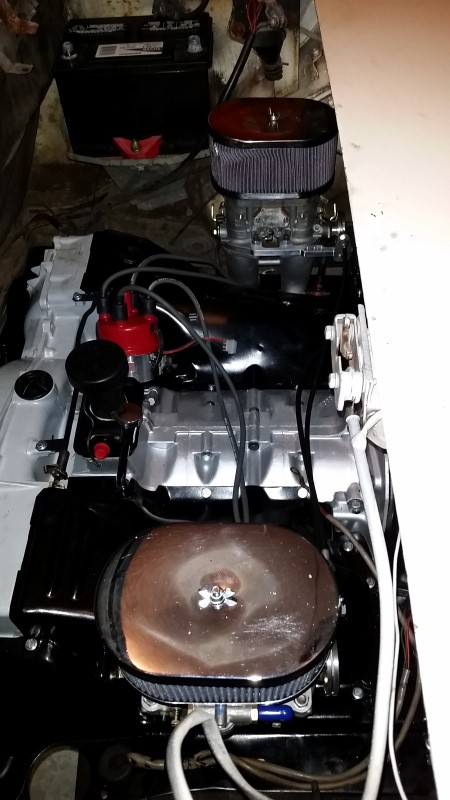

After a week of working all day and then wrenching on the 914, the Raby 2056 is installed and running (IMG:style_emoticons/default/cheer.gif)
Tuesday evening I had the proprietary accelerator cable connected, fuel lines hooked up, and ignition harness in place. Everything was back together and it was time to start her up. Crank, crank, crank. Can smell fuel but no spark whatsoever. Conversation with Jake leads to a couple tests and conclusion that the unilite module popped or I have a bad coil. I didn't have a multimeter with me so couldn't do any tests.
Returned Wednesday after work to test the coil plus brought a spare coil just in case. Both showed 3.5 ohm so they are good. Tested the unilite module and... it's blown. That was a super short night. Back at home, found a replacement on Amazon and ordered it.
The replacement module arrived Friday but since it was "family night" I did not work on the 914.
Today I installed the new module after I double checked the wiring to be sure all was connected correctly. Didn't want to blow another module (IMG:style_emoticons/default/blink.gif)
Rolled the car out of the garage and turned the key. It roared to life. And roared. And roared. Idling at 3000+ RPM, I figured I had the accelerator cable too tight. A text to Jake verified my suspicions. I readjusted the cable and tried again. The engine roared to life and idled at just under 1000 RPM (IMG:style_emoticons/default/smile.gif)
My bro-in-law and I then took it for a drive. Seemed rough at times but I later found a faulty connection to the fuel pump. With that taken care of, this engine is sm-o-o-o-o-oth (IMG:style_emoticons/default/wub.gif)

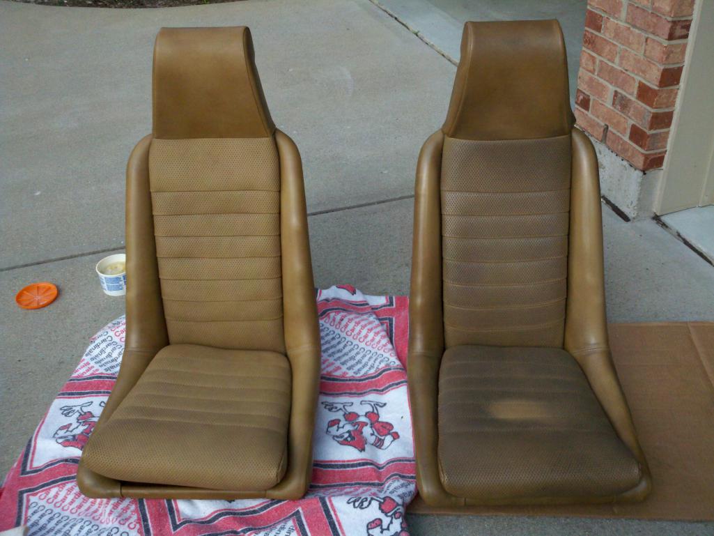

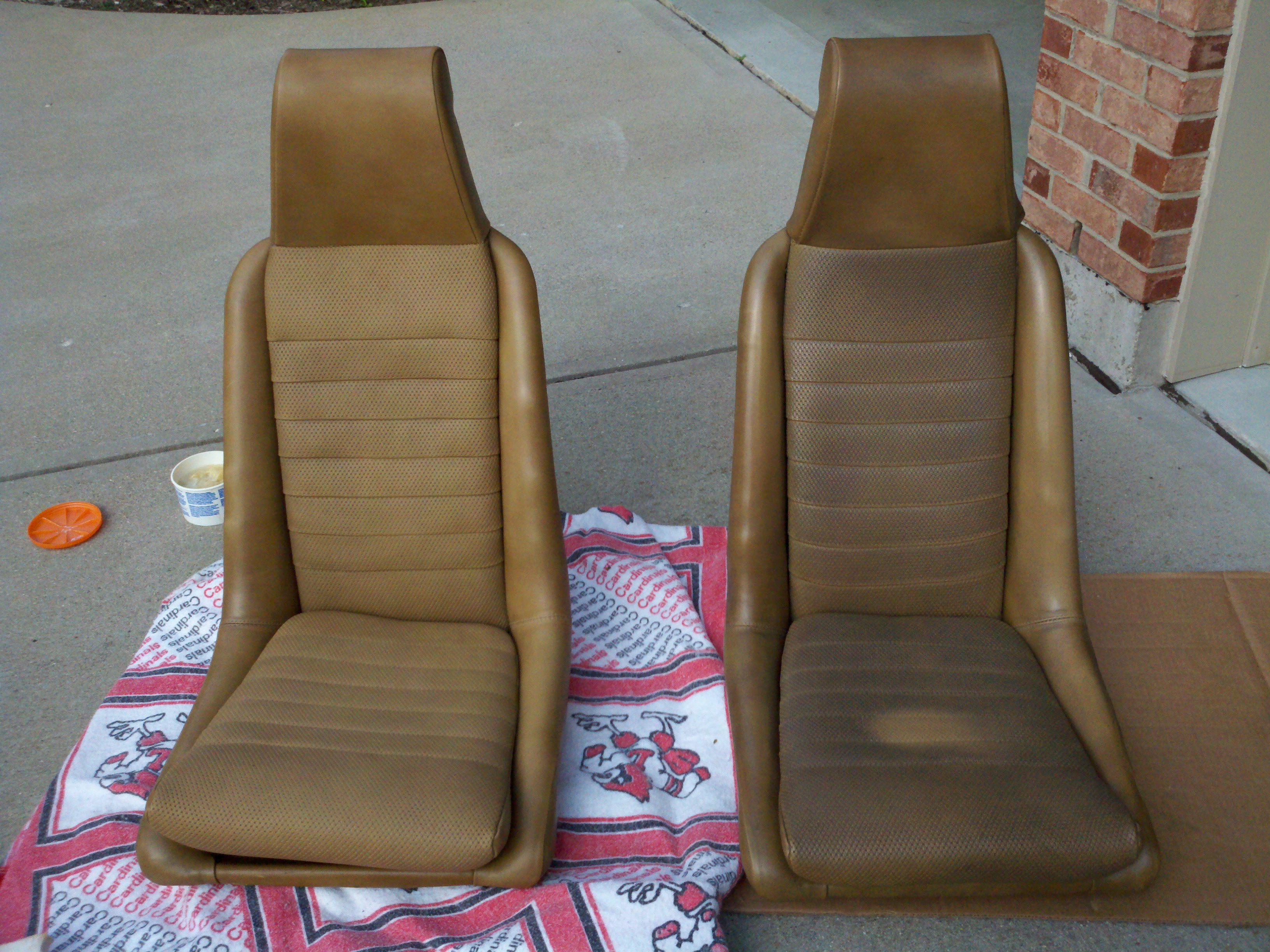

Is this Cinnamon? If so, I have a complete, very close to perfect interior for you, only two states away. The seats were pretty disgusting when I got it, but as you can see from the one on the left, they cleaned up pretty nicely.

Looks like it. If the coloring is slightly mottled, then, yes (IMG:style_emoticons/default/smile.gif)
Definitely interested in them.
