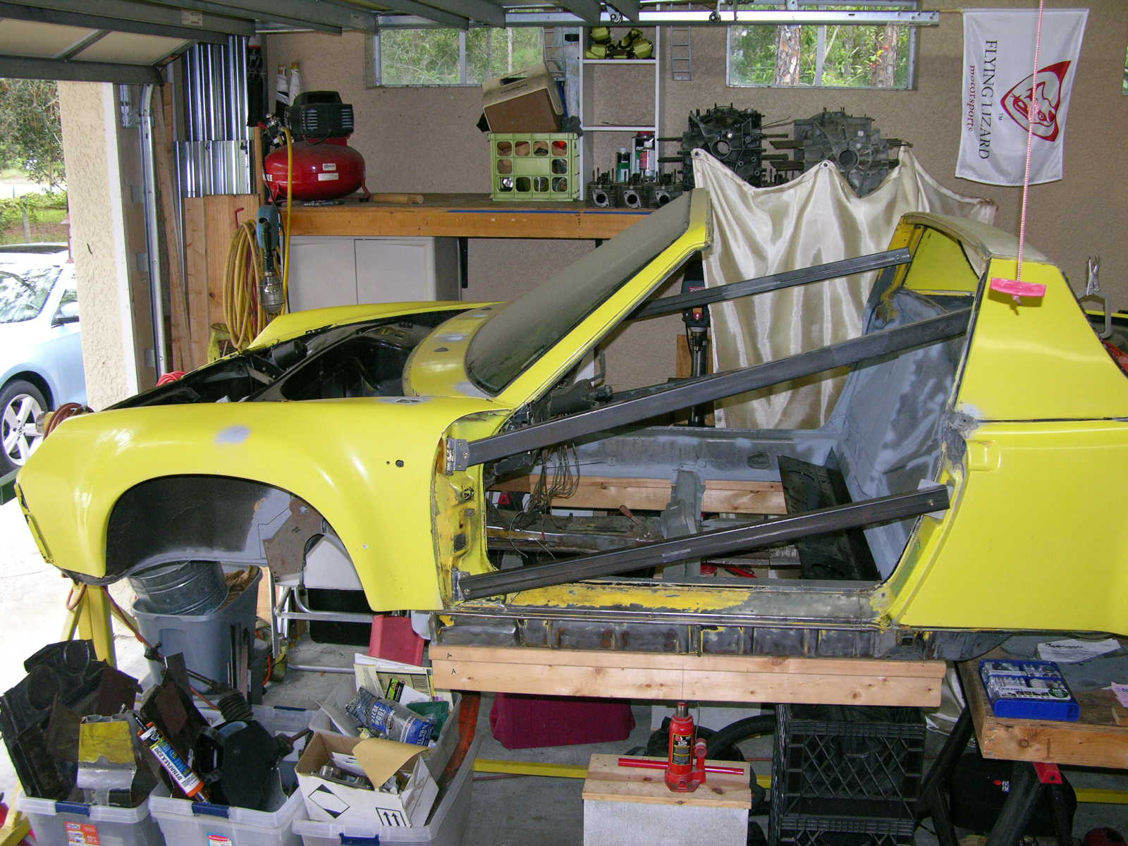

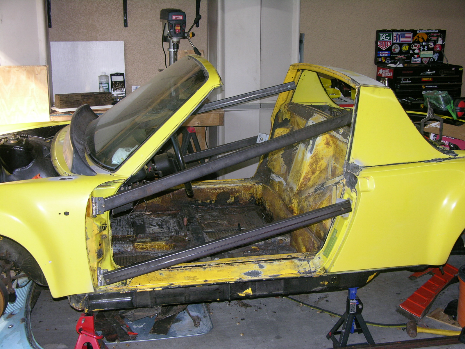

Here we go,

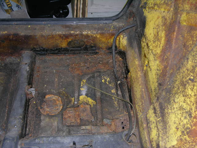

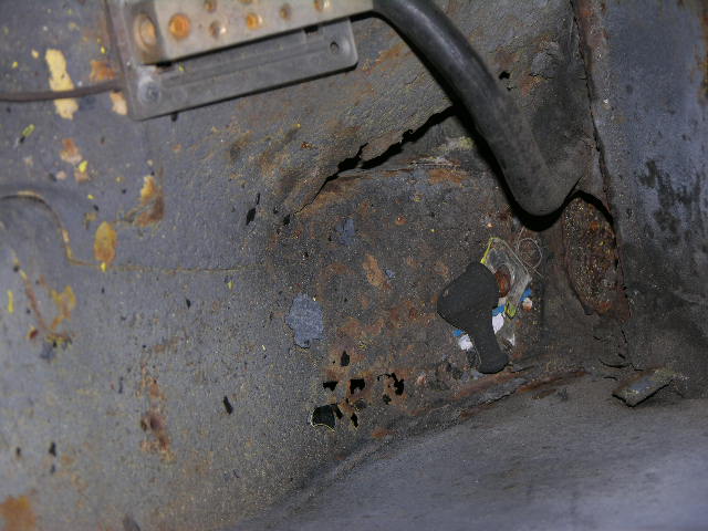

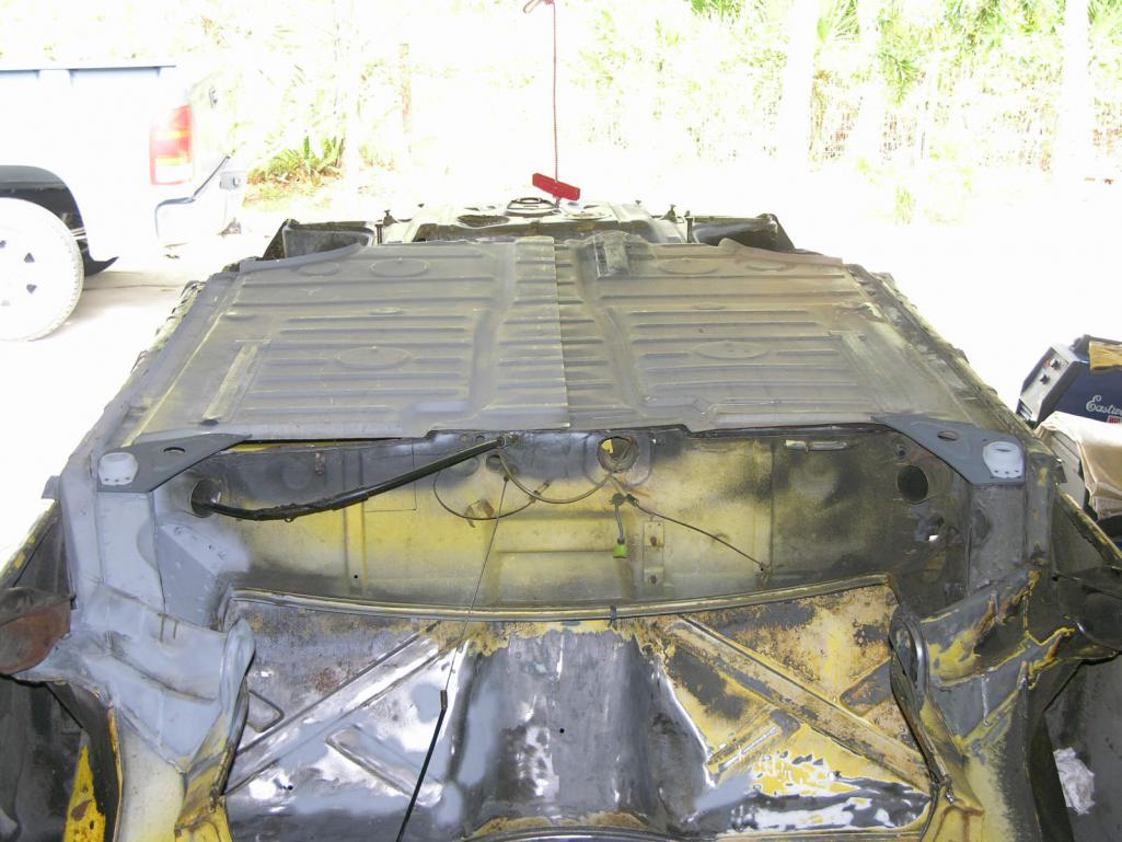

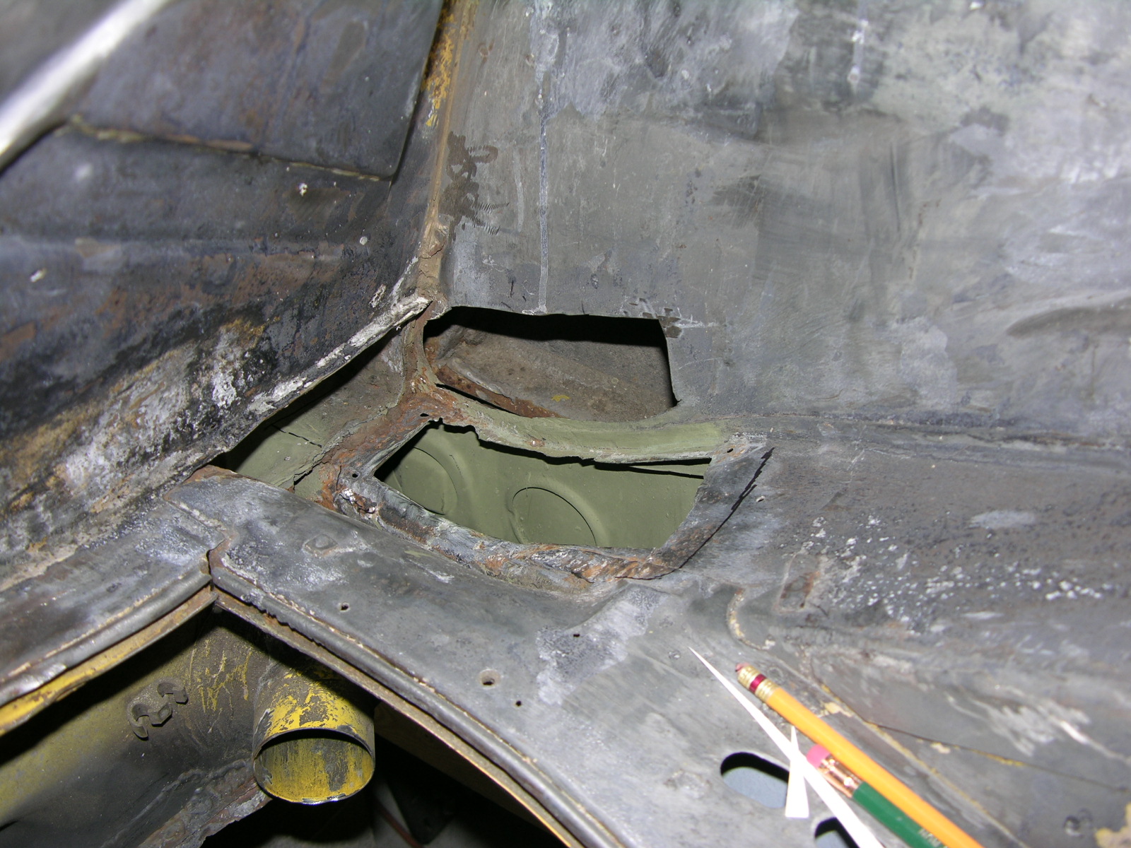

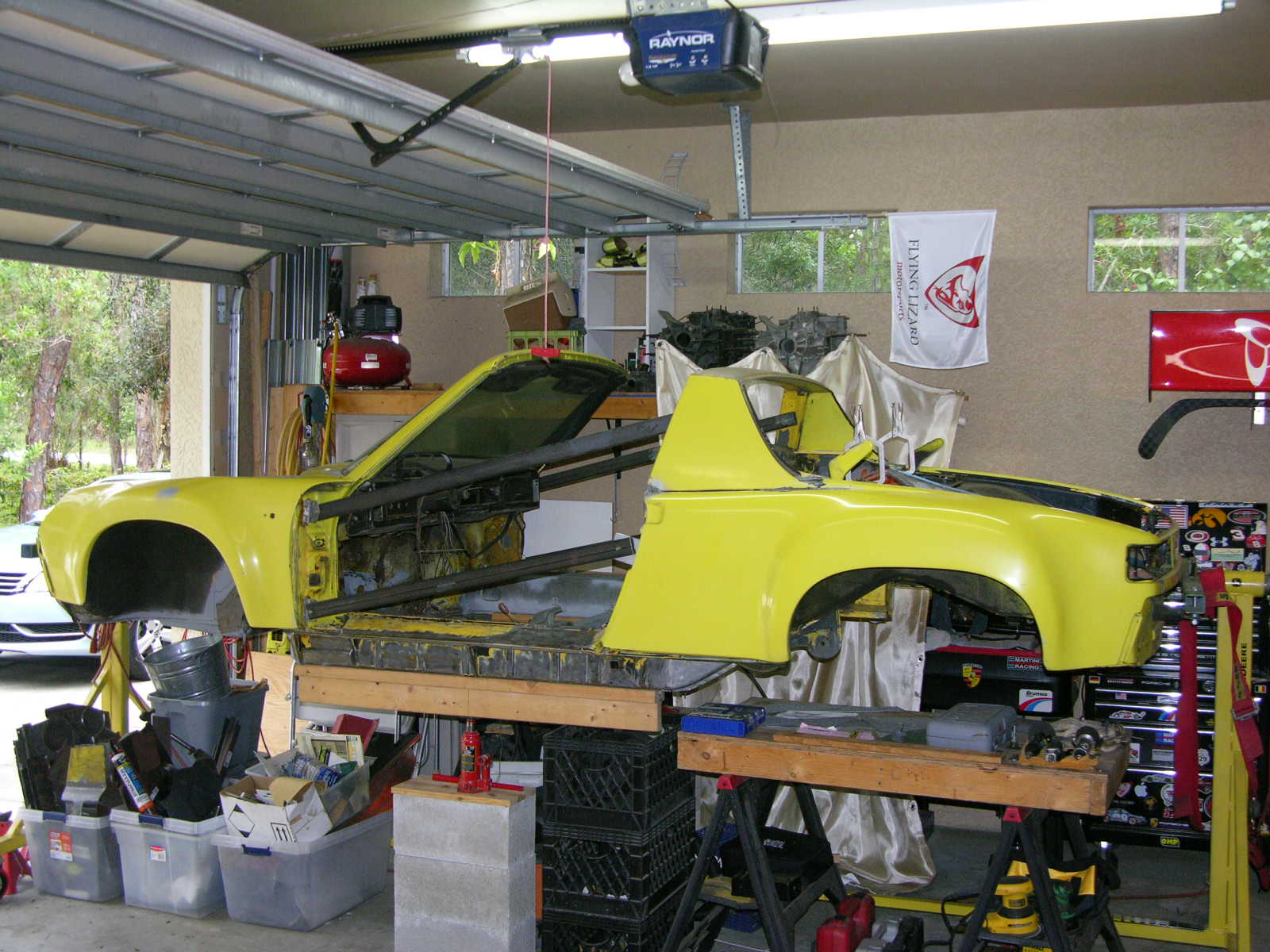

I bought this chassis several years ago and have been cutting out sections with rust. This roller was a 1976 with Fiberglas Flares, I like them. There is much work to be done.
My 5 Major Project Points are:
1) Repair & Replace all rusted areas and weld in;
* - New Floor Pans.
*- Repairs to the Hell Hole area.
*- Engman Kit.
*- Weltmeister Chassis Stiffening Kit.
*- McMark's Roll Bar.
2) Install Patrick Six Engine Mount, Install Engine, Have Transmission Rebuilt, Install
Patrick Oil Tank and all Lines necessary, Install Oil Cooler, Rewire complete car.
Replace and treat inside of Gas Tank, install new CF/ Fuel Lines.
3) Replace Doors, Windshield, Install Spartan Street/DE Interior, Sparco Vintage
Seats, New Console, MoMo Wheel.
4) Prep car for Paint, all panels prepped, Hood, Trunk, Doors, Targa Top.
5) Replace & Upgrade all Suspension, Brakes, Bushings, Wheels & Tires.

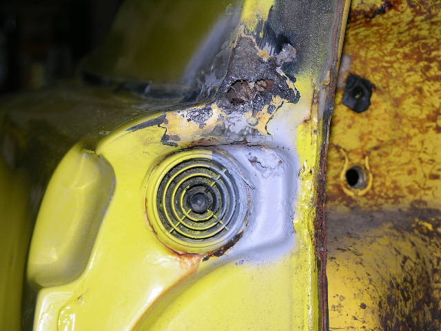

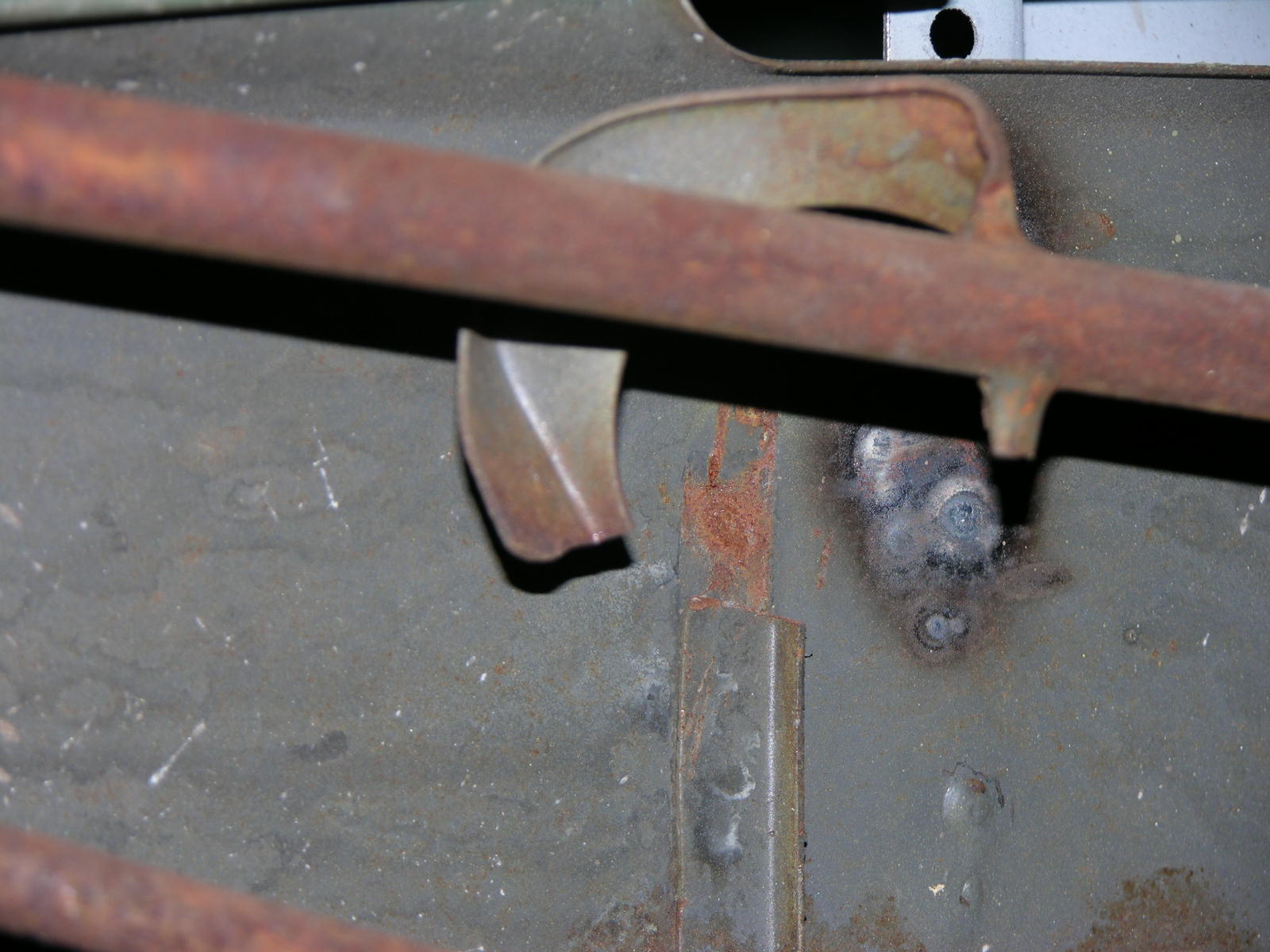

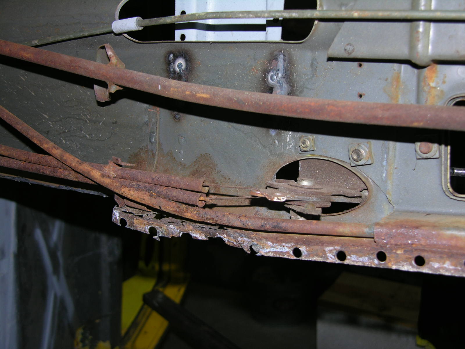

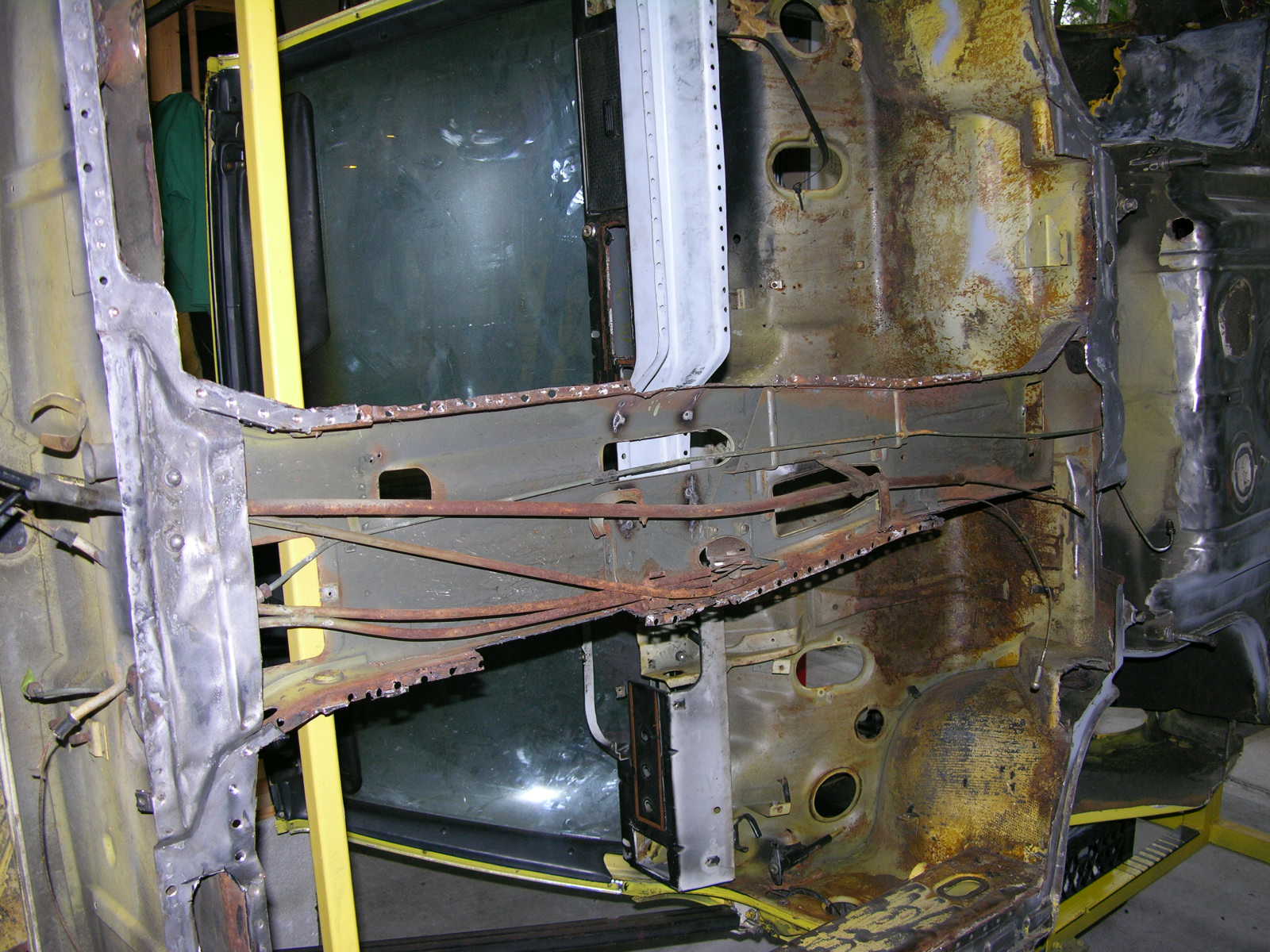

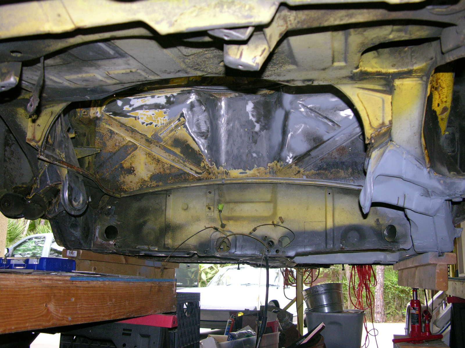

More Pictures

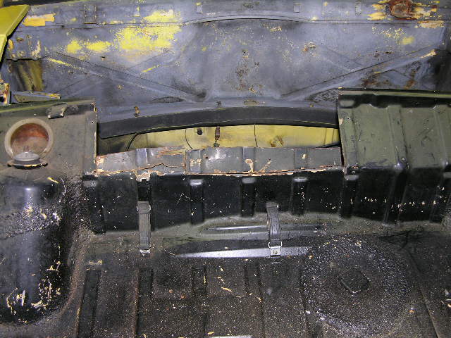

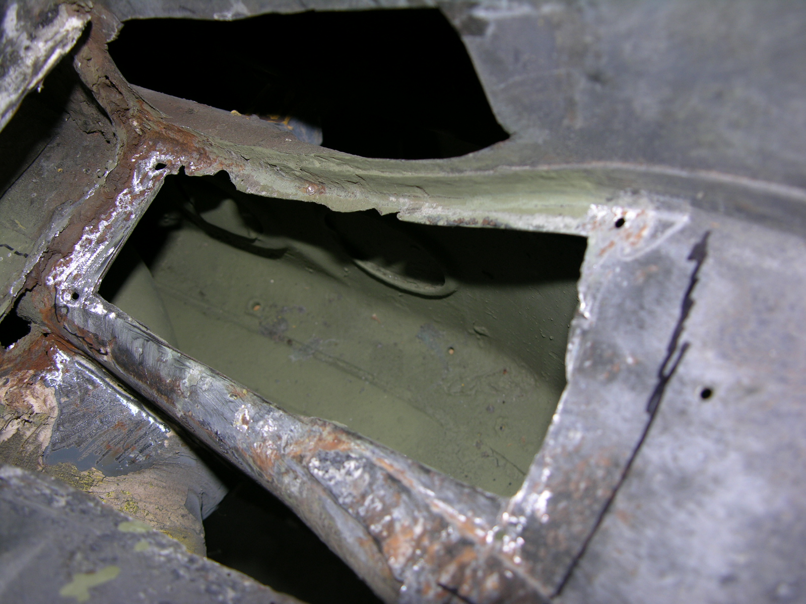

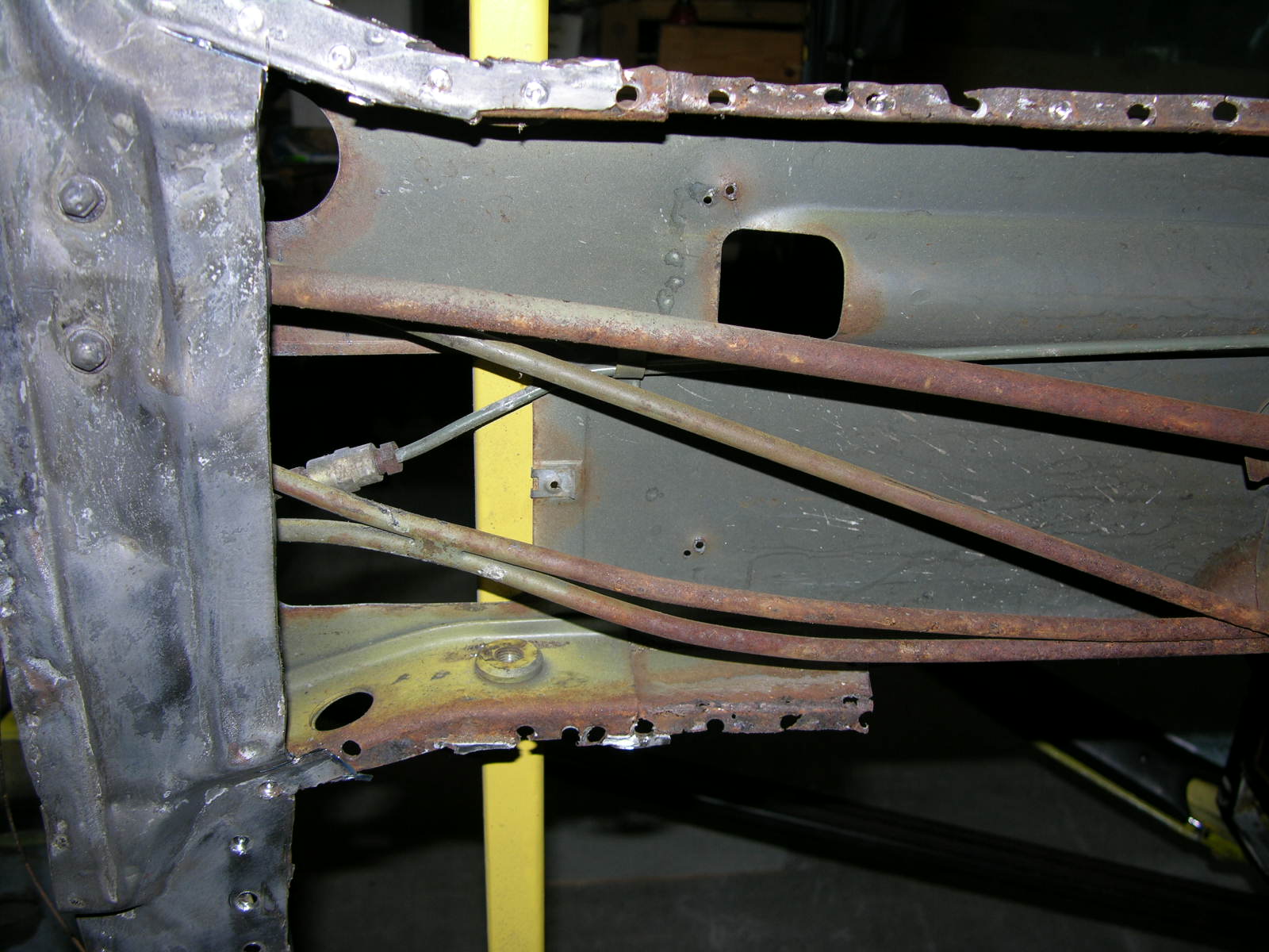

More Pictures
Now the real work must begin! (IMG:style_emoticons/default/flag.gif) (IMG:style_emoticons/default/idea.gif) (IMG:style_emoticons/default/sawzall-smiley.gif) (IMG:style_emoticons/default/welder.gif)

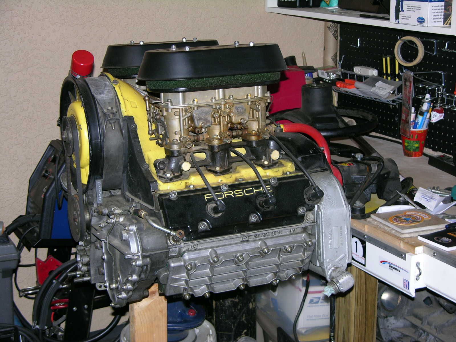

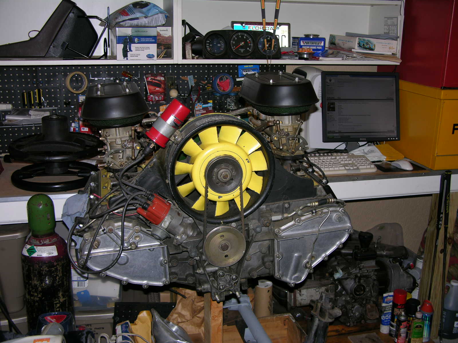

Love that motor ! Very envious as mine is still in Arizona !! Hope you aren't putting a John Deere influence on it (IMG:style_emoticons/default/biggrin.gif)

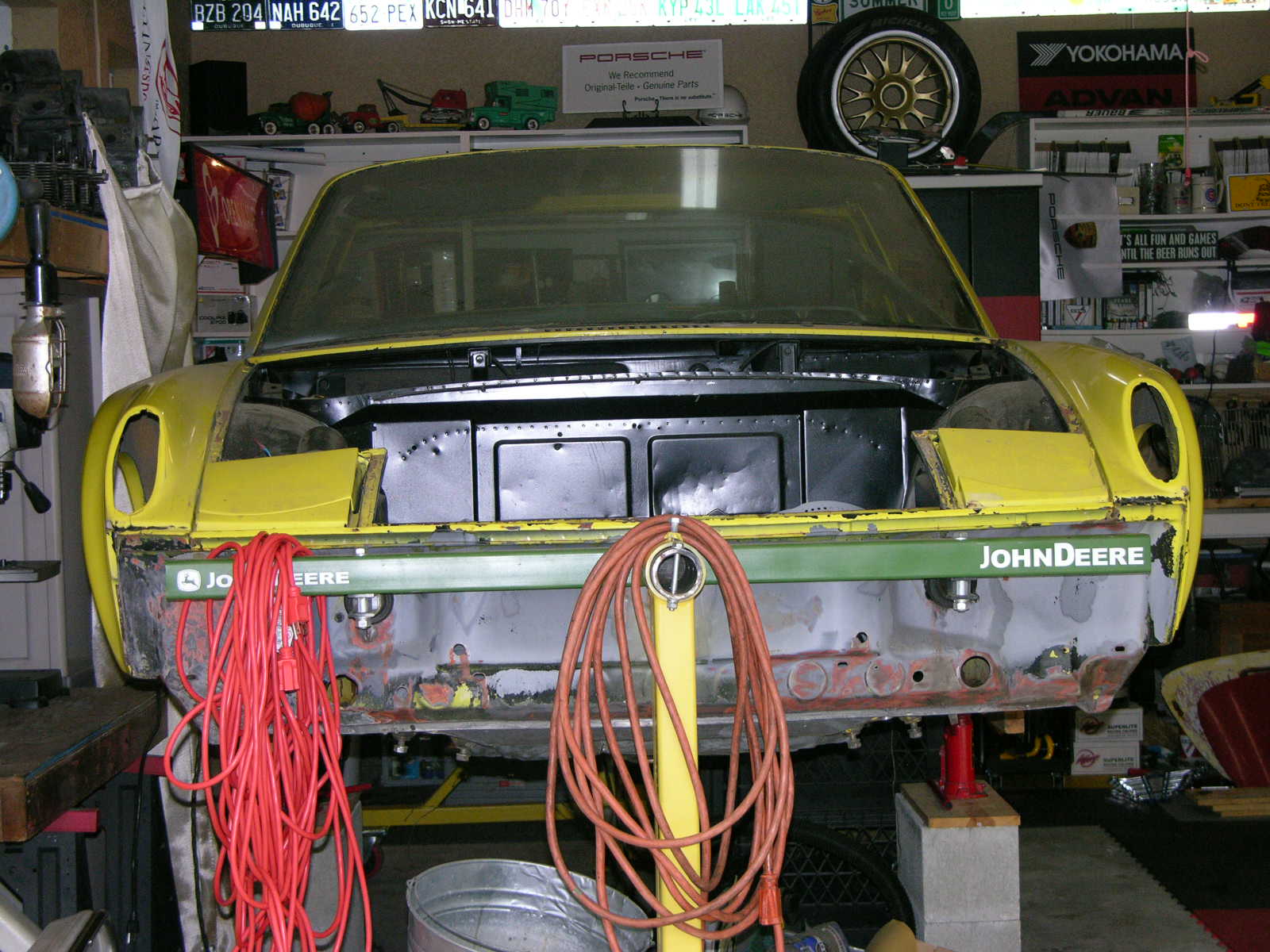

Nutter965,
No John Deere influence other than my Dad worked for Deere & Co. for 38 years.
He winters down here and I stickered it up for him, unfortunately his area was Industrial (Yellow Equipment) which is branded as DEERE, he made that clear to me as I have AG (Green) stickers on....oops?
Thats alright the Rotis is solid. Paint scheme will NOT be Yellow or Green.
Thanks for checking it out!
Vysoc (IMG:style_emoticons/default/flag.gif)

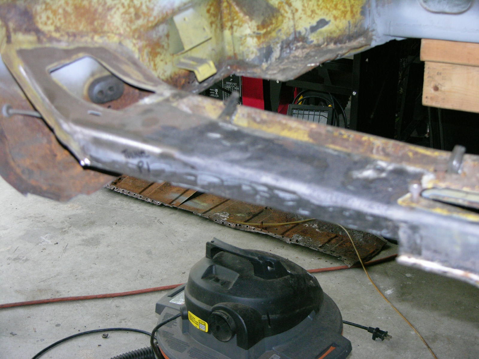

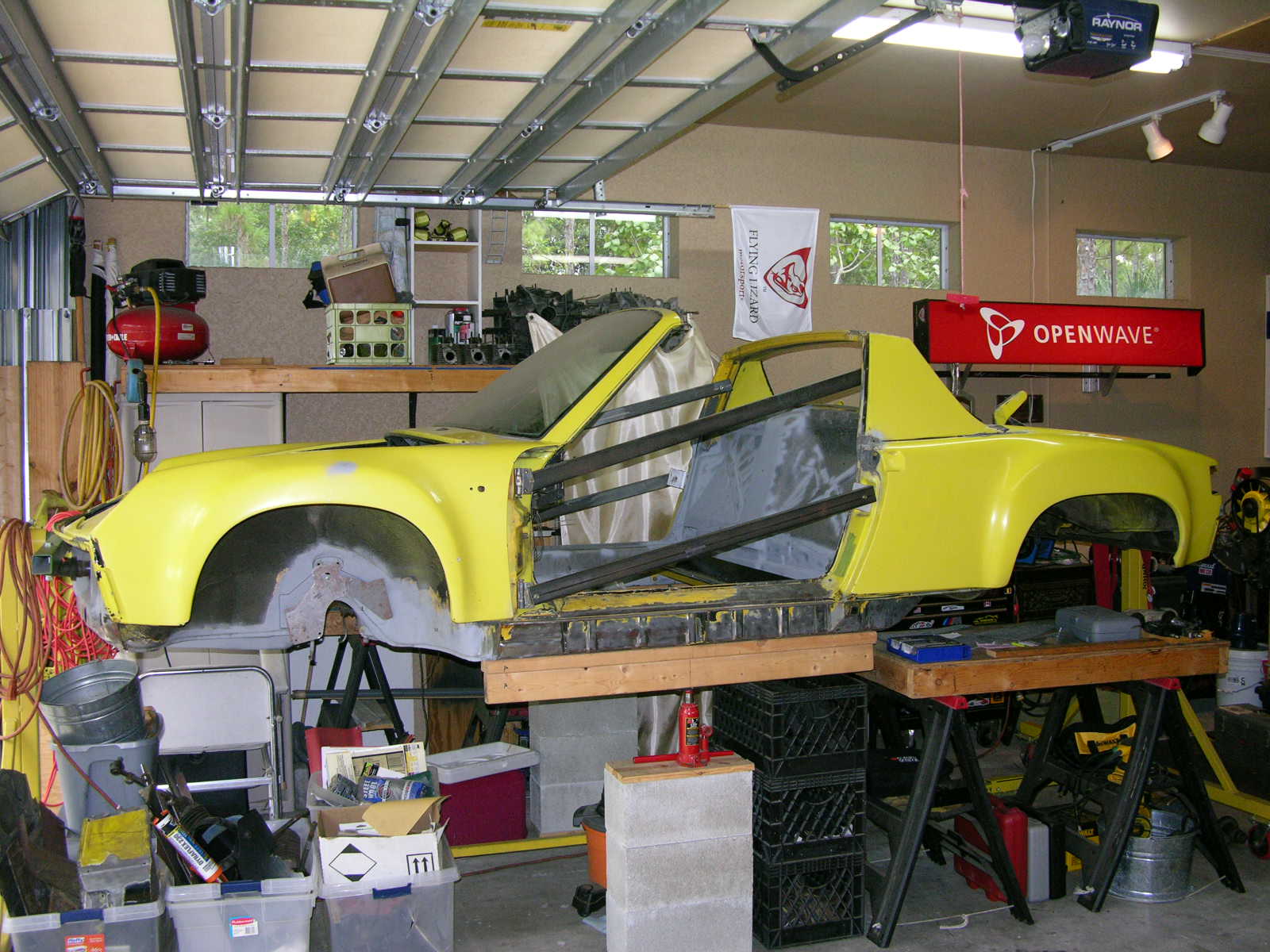

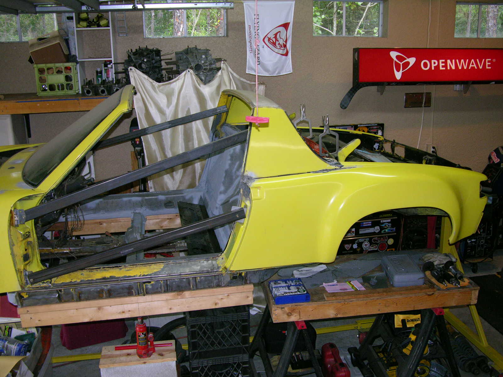

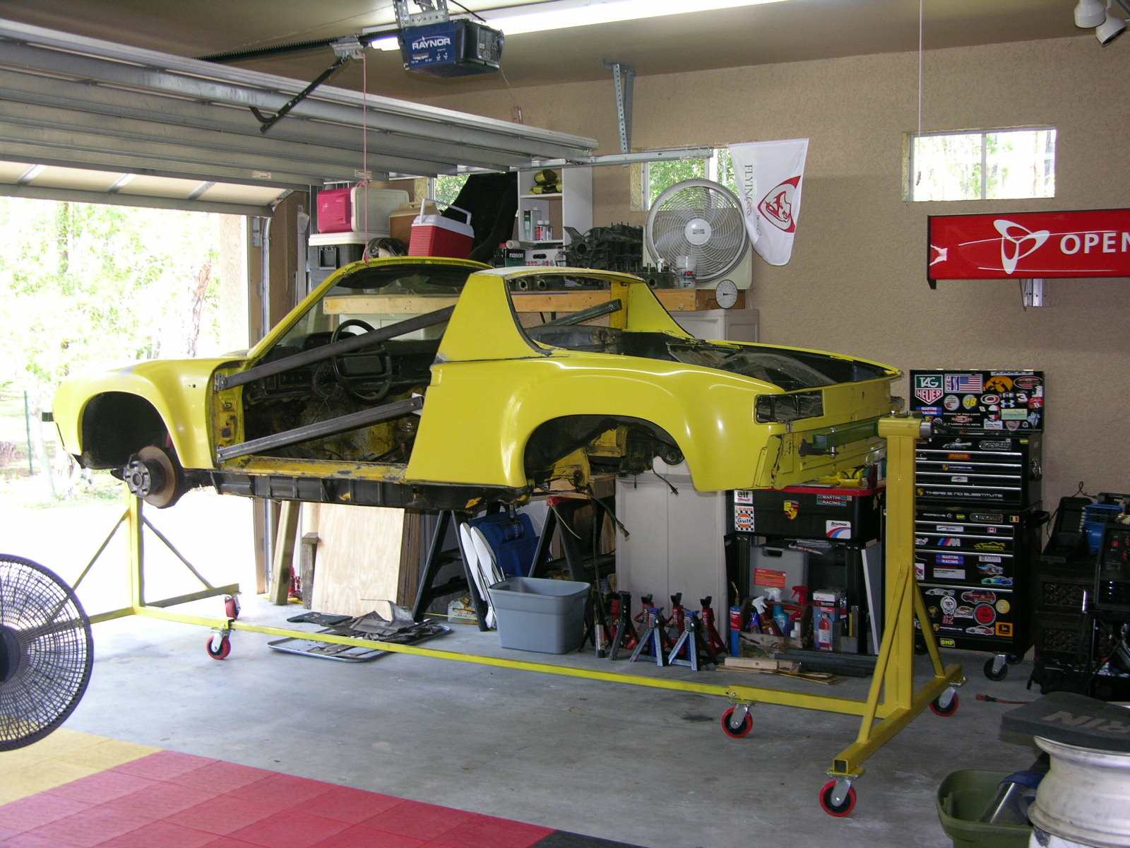

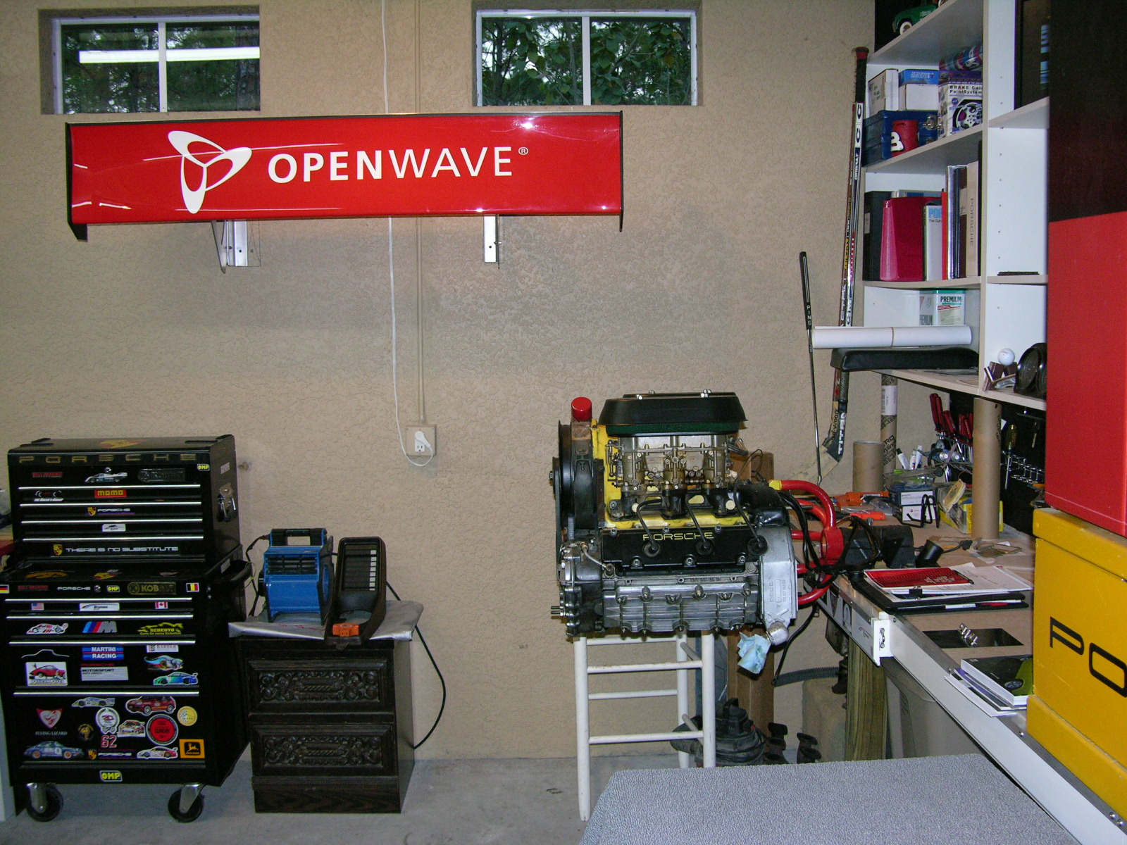

OK,
Day off today, my season is just starting (Golf in Florida) as the temps have finally dropped, hell it got down to 68 degrees the other morning almost a cold front which means the garage only gets up to 90.
October for me has been a reorganization month in the garage to get my White 75 placed in another garage so that I can spread things out and have some working room.
That said and done, I now have my garage in a position to work, just cut out the Driver's side Cross Brace that was heavily rusted and have fitted up the Restoration Design replacement piece. I also fitted up the drivers side floorboards, I have more trimming to do to the old floor pan to get things in a position where I can use Clecos to fit them properly.
I was also able to pick up a Miller TIG Welder and I need to get up to speed on it, I do not have a 220V feed in my garage so I have moved my Hurricane Generator in place to power that thing from outside the garage. I have several areas on the car that I believe will benefit from TIG rather than MIG as the heat from MIG causes alot of Blow through and warping.
So today will be a day to learn my new/old used machine and trim the rest of the old floor pan out, I may even get something welded today. Photo's of updates forth coming.
Slowly moving forward!
Vysoc (IMG:style_emoticons/default/flag.gif) (IMG:style_emoticons/default/welder.gif)

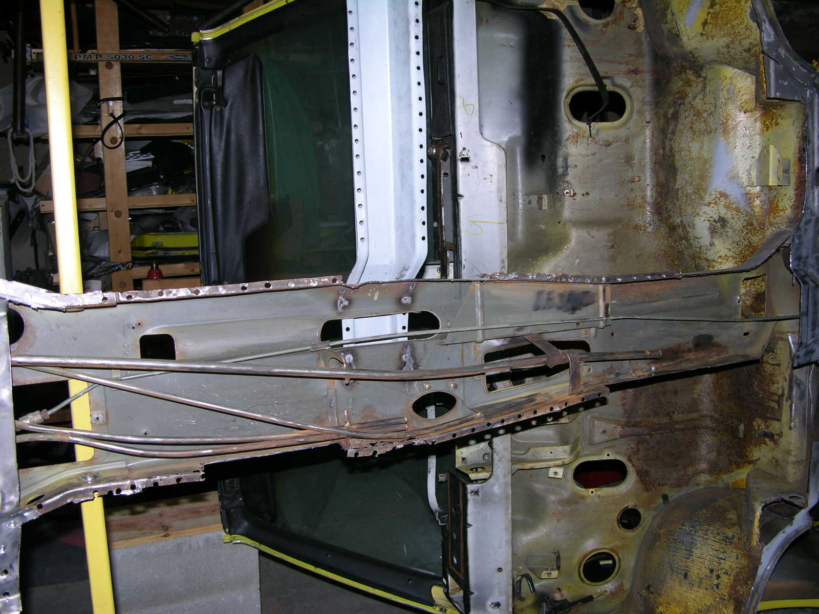

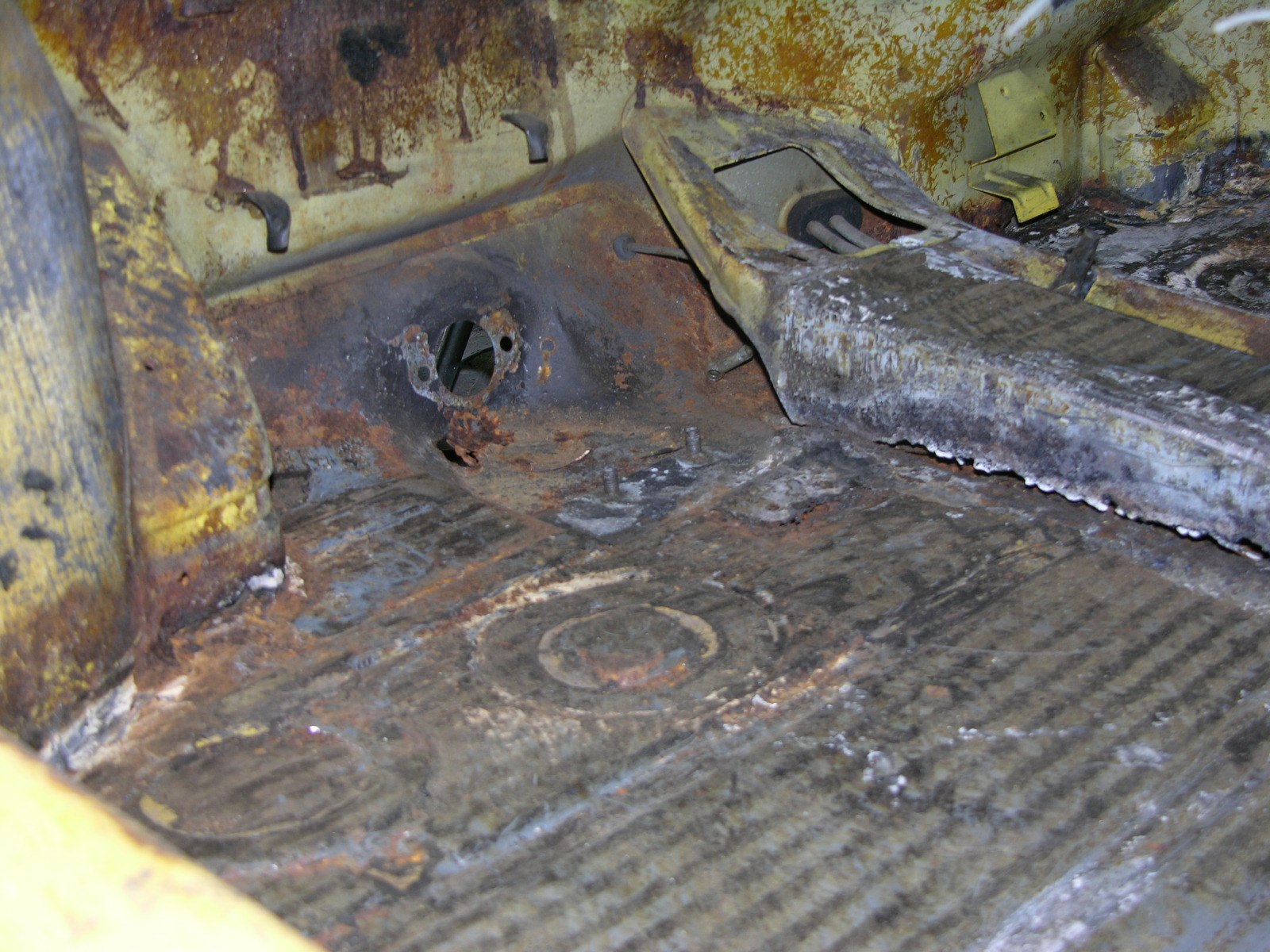

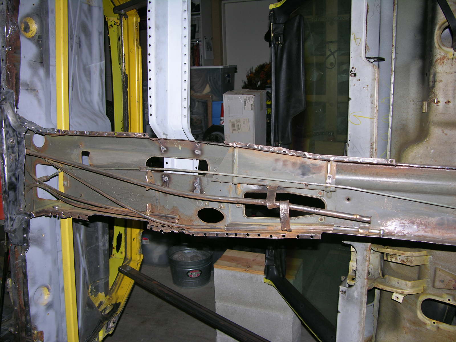

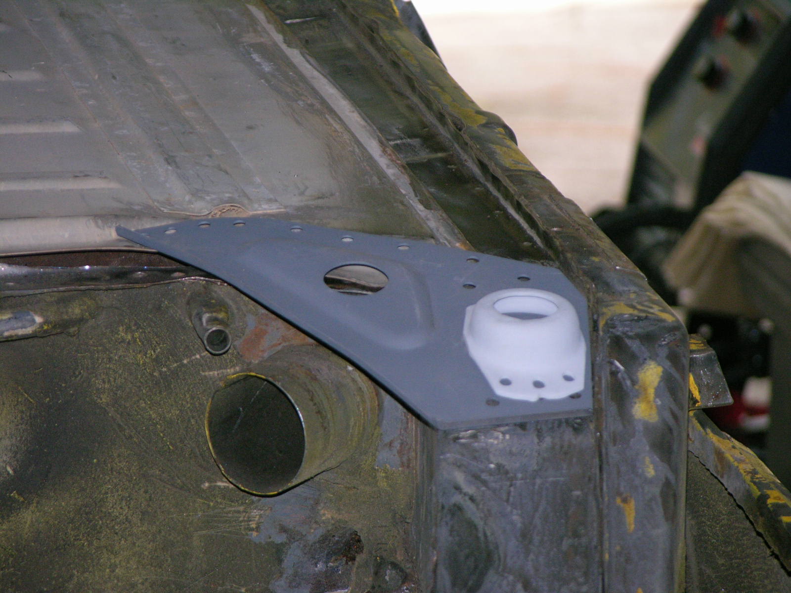

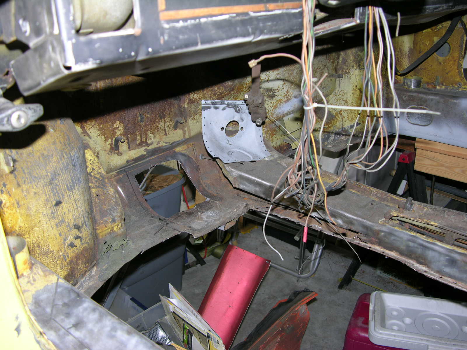

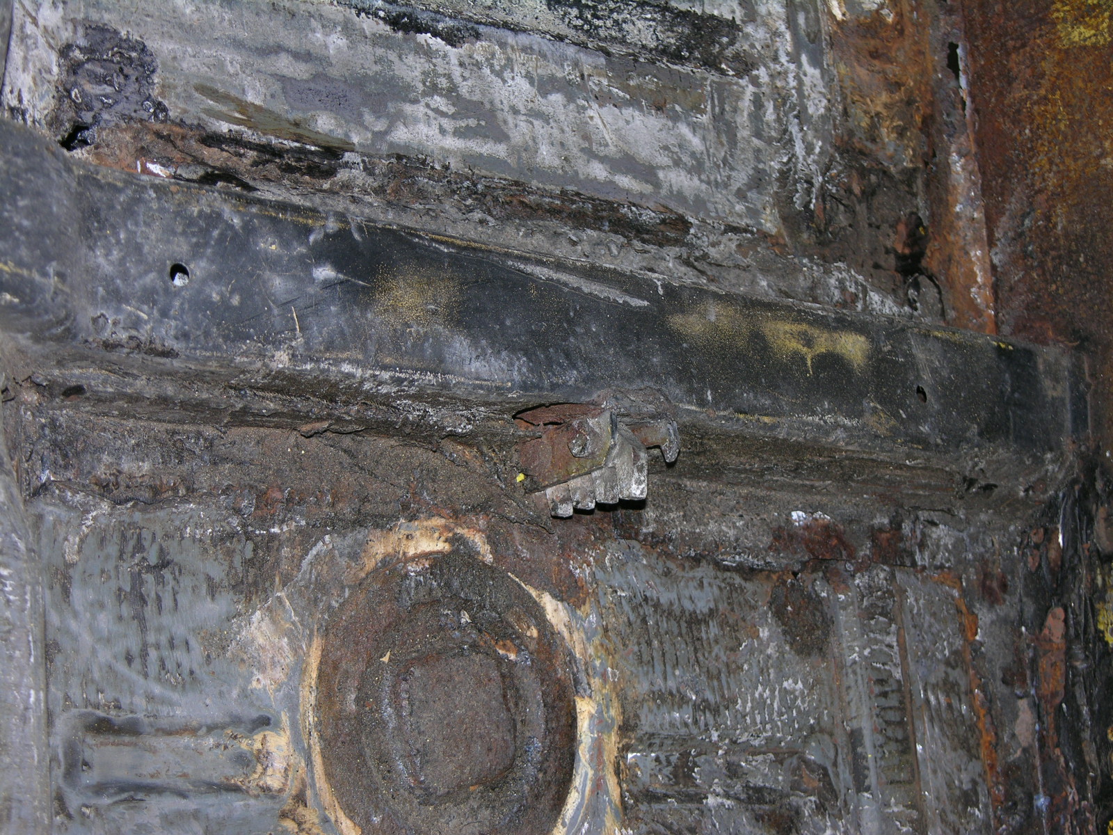

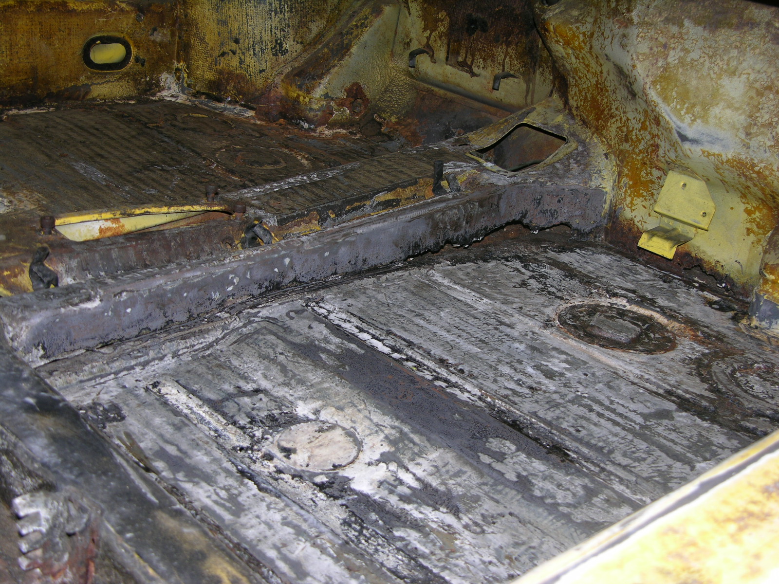

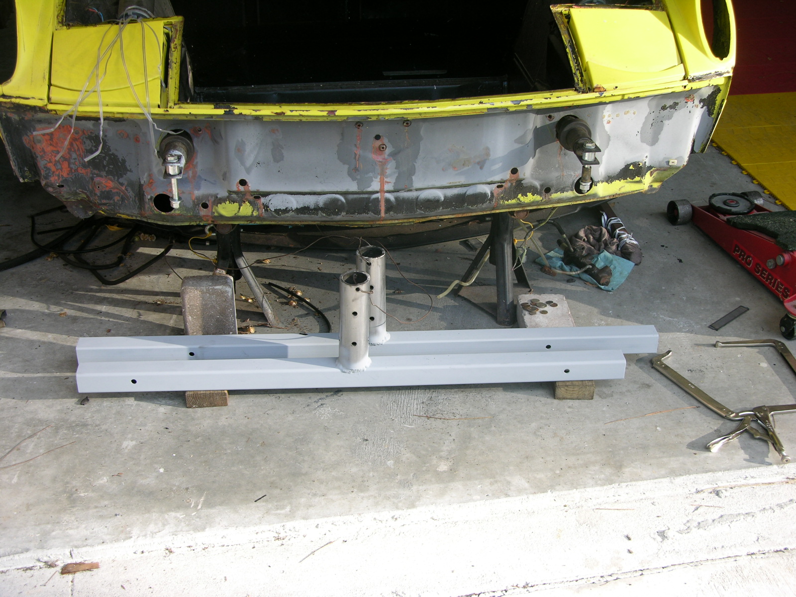

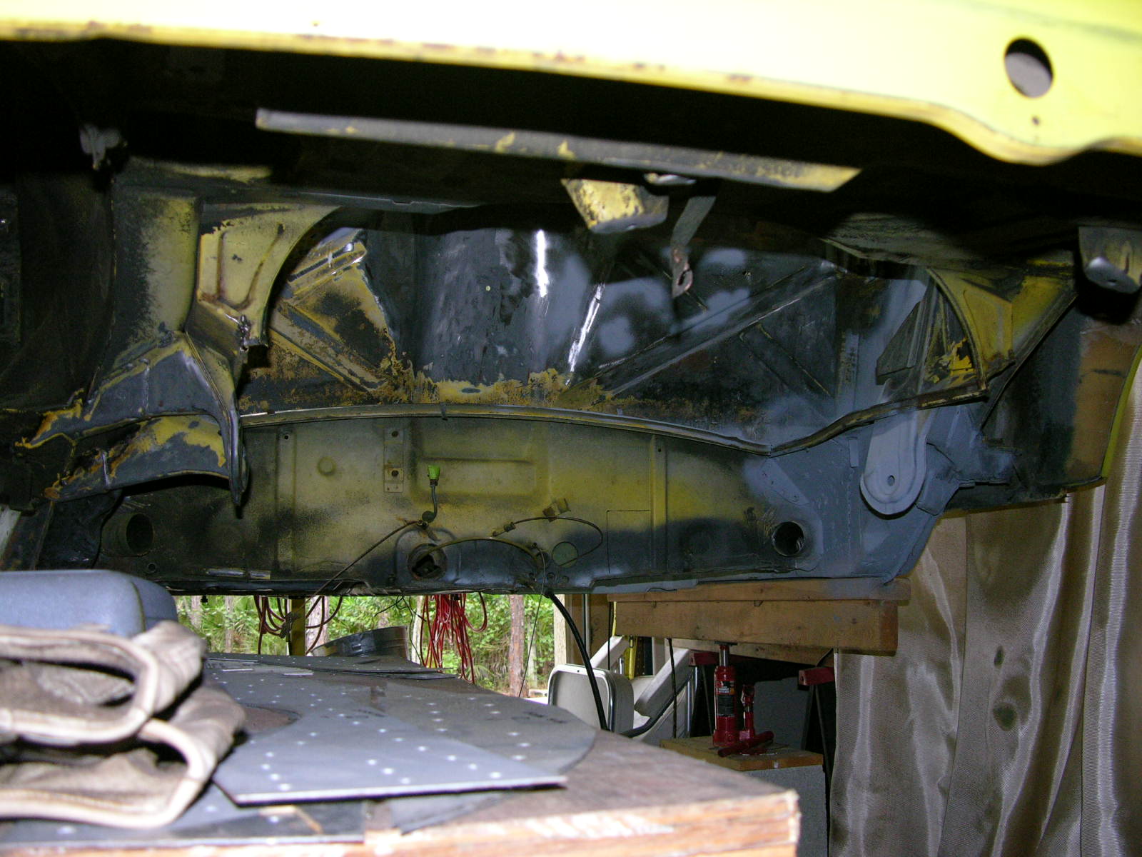

Update to my regular thread as I put the October update on the main thread and did not update on this thread.
This will be a shorter cliff notes edition.
October Floor Pan Fit-Up.
Rear Corner Brace Fit-Up.
November Stuff TIG WELDER

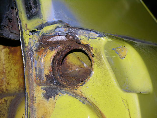

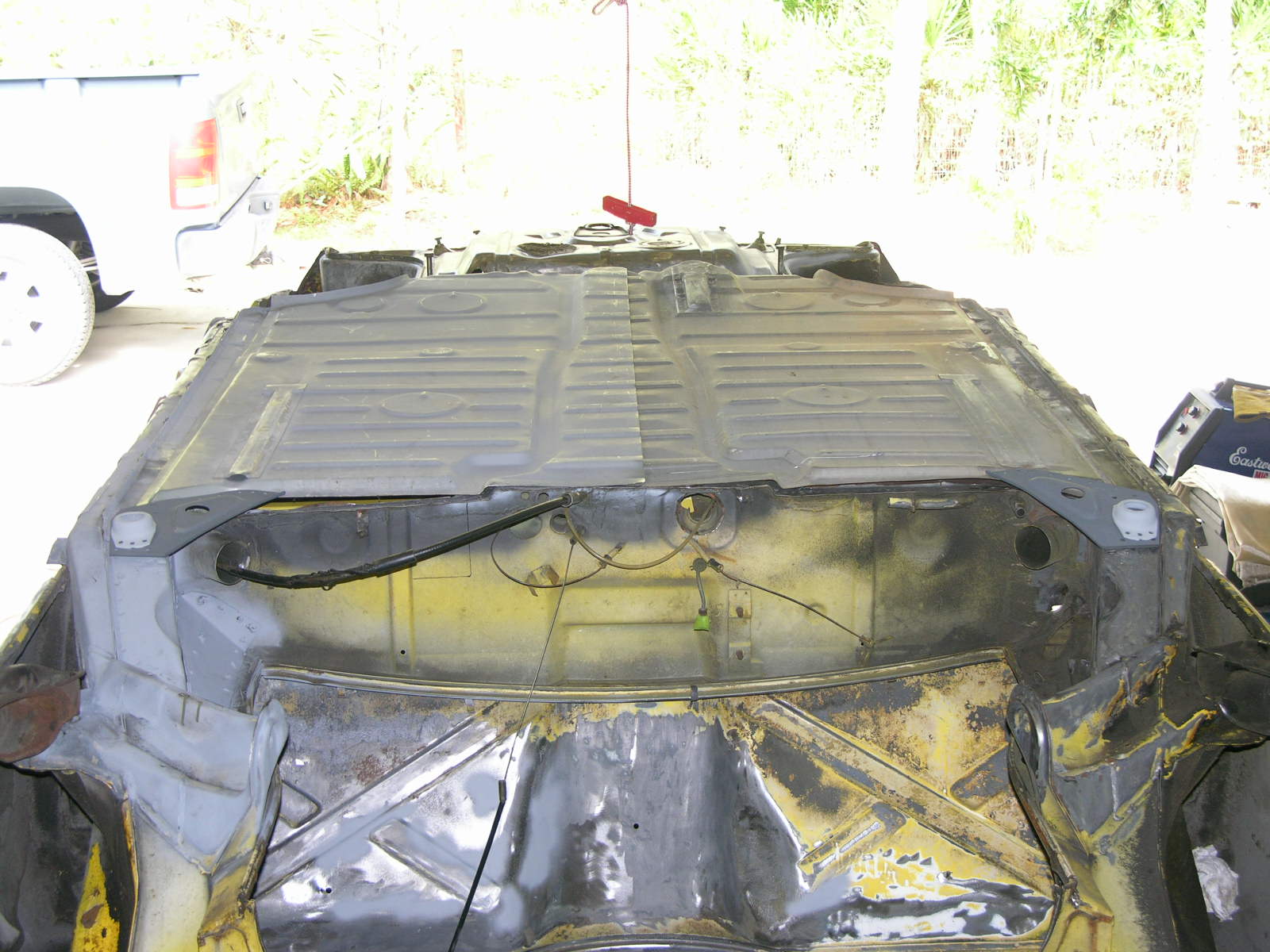

December drilled out all of the Spot welds in the base of the Tunnel. Cut out what I could and prepared myself for what I thought was going to be a rusty mess?
It may not appear that this is clean but I expected a lot more rust and was really quite happy with what I found. Obviously I have to patch in three sections along the tunnel in three different areas, but other than that and to shore up several holds on the Clutch tube, I am happy. I continued to clean up the areas with sandpaper used a little Ospho and put a coat of primer on them to keep them in check. This whole tunnel will get a healthy dose of the Eastwood inside panel green stuff and should be good to go. The Restoration Design Driver's side middle brace is next to get welded in and then I will clean-up all the little stuff while I have such good access before the Floor pan is attached.

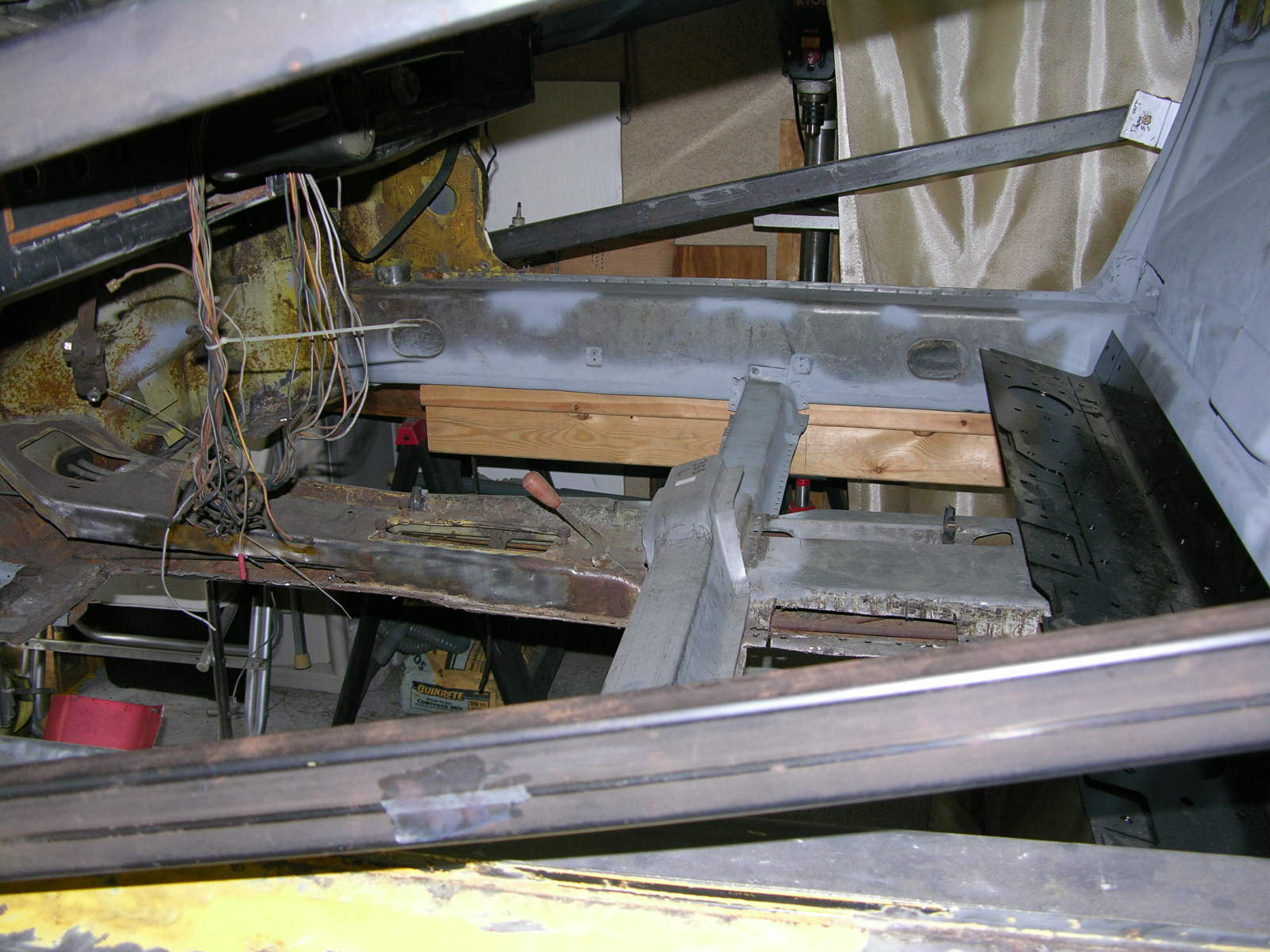

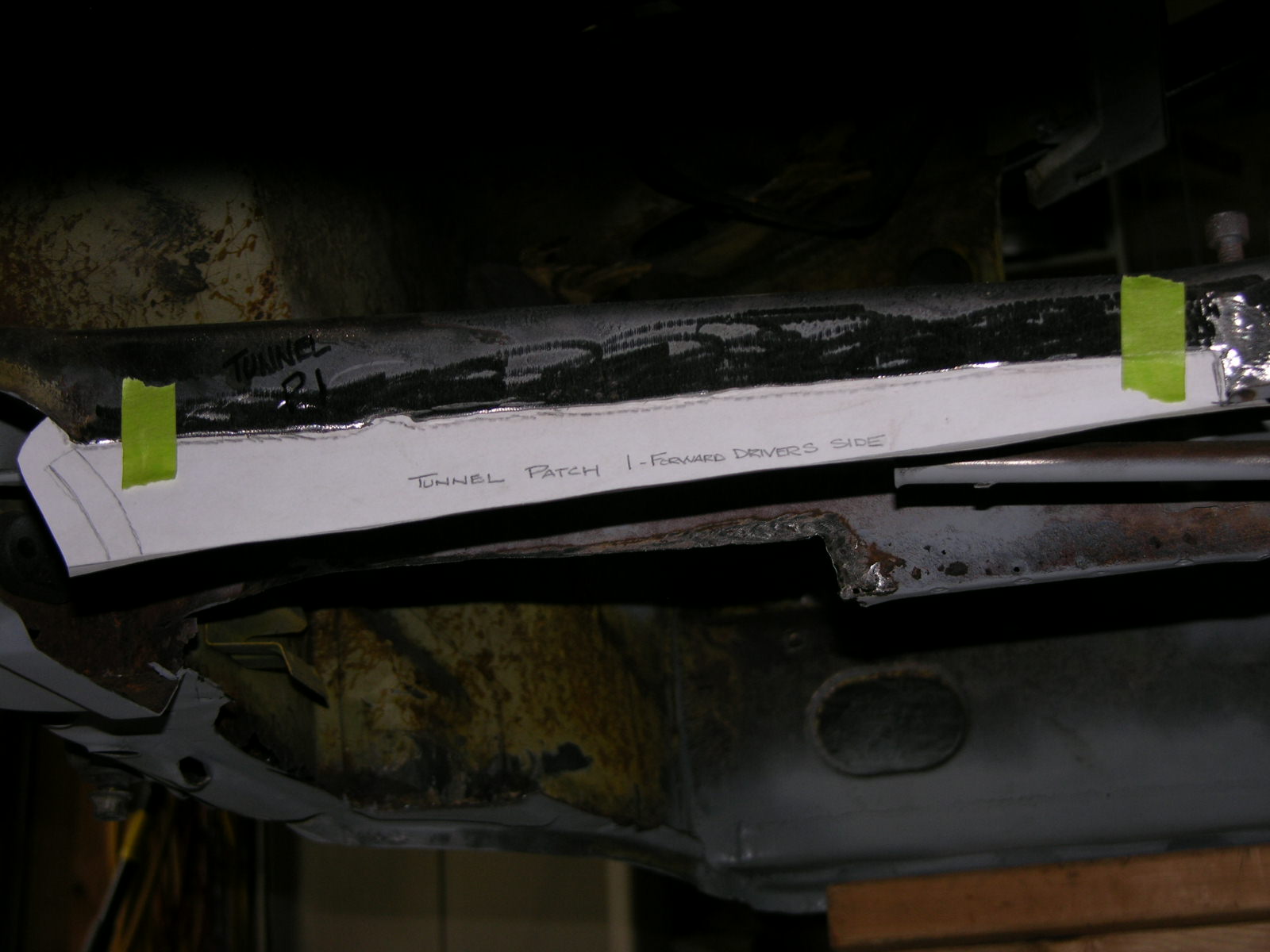

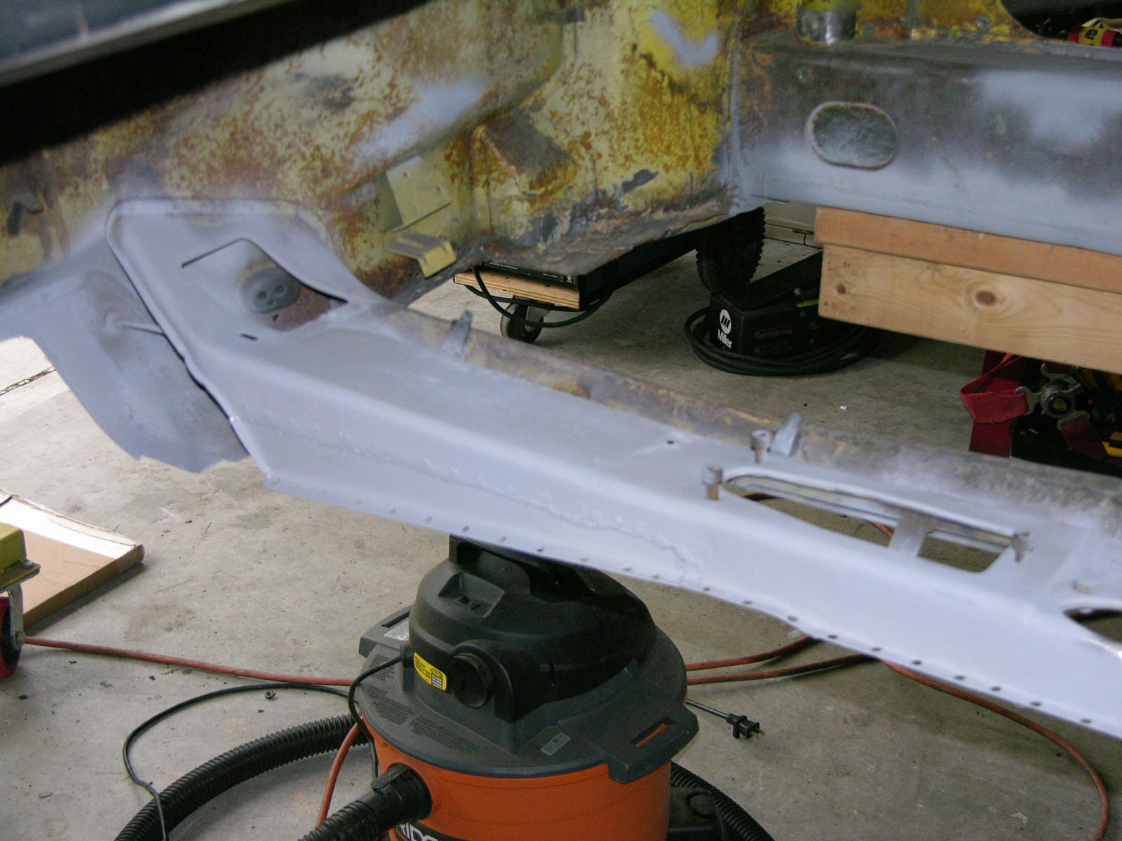

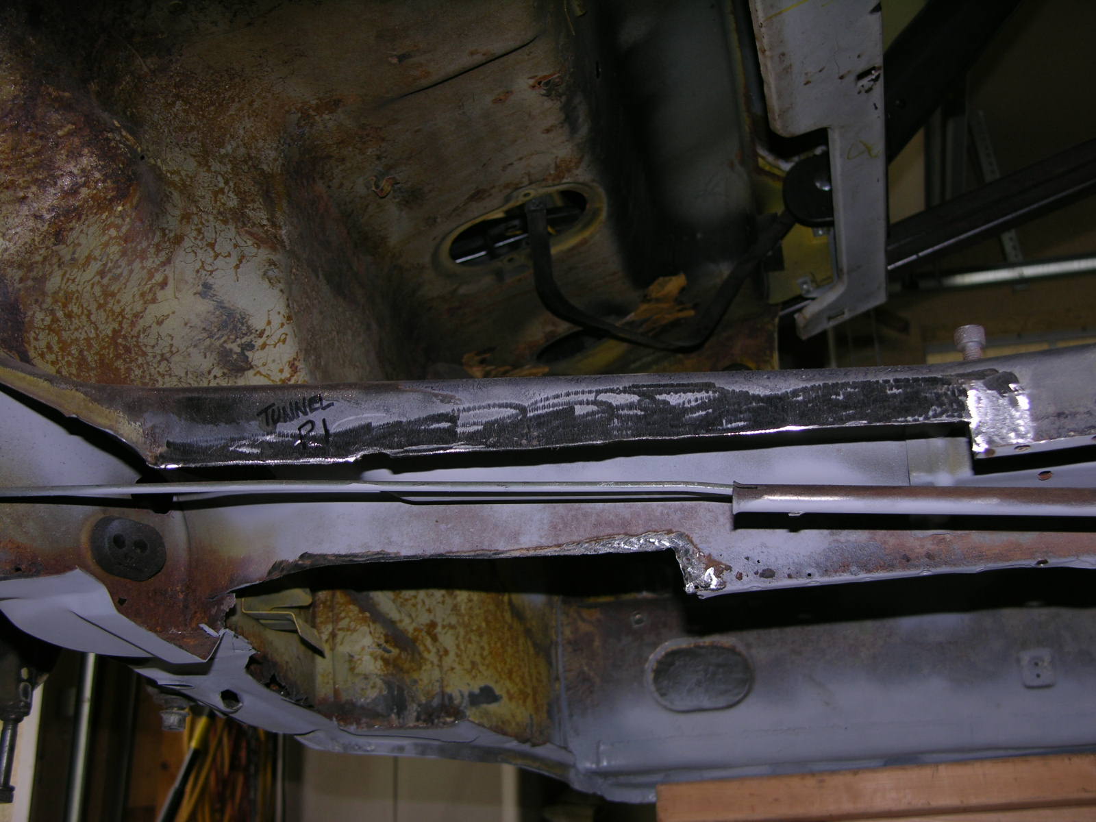

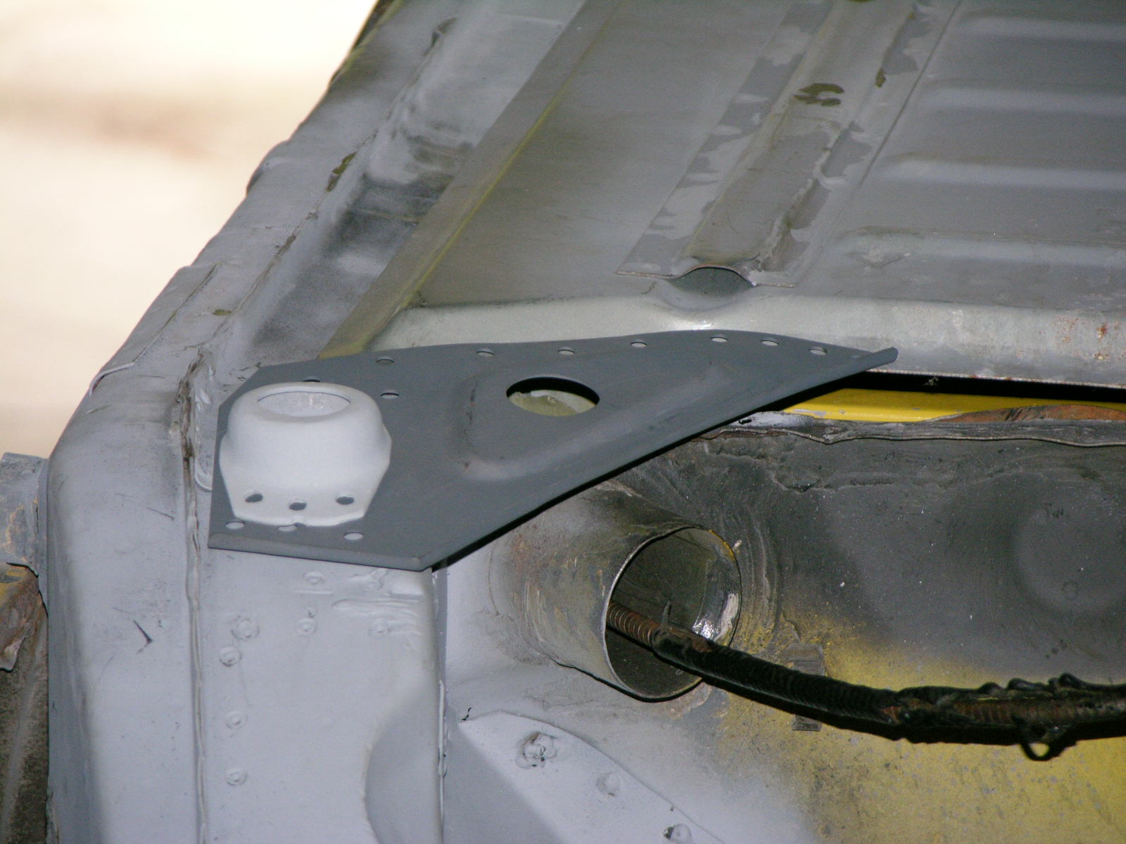

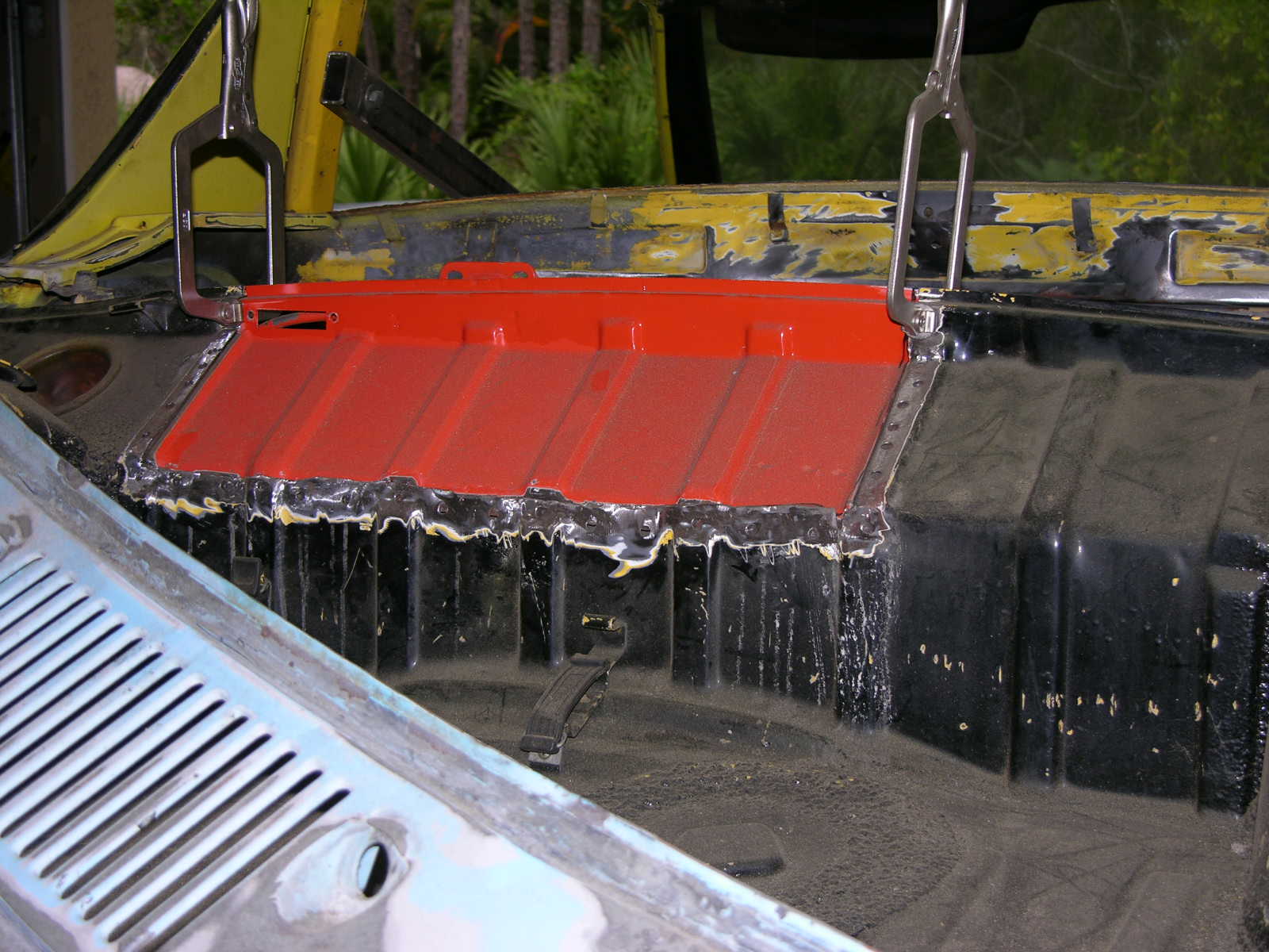

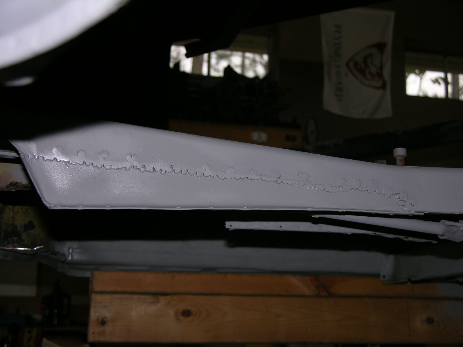

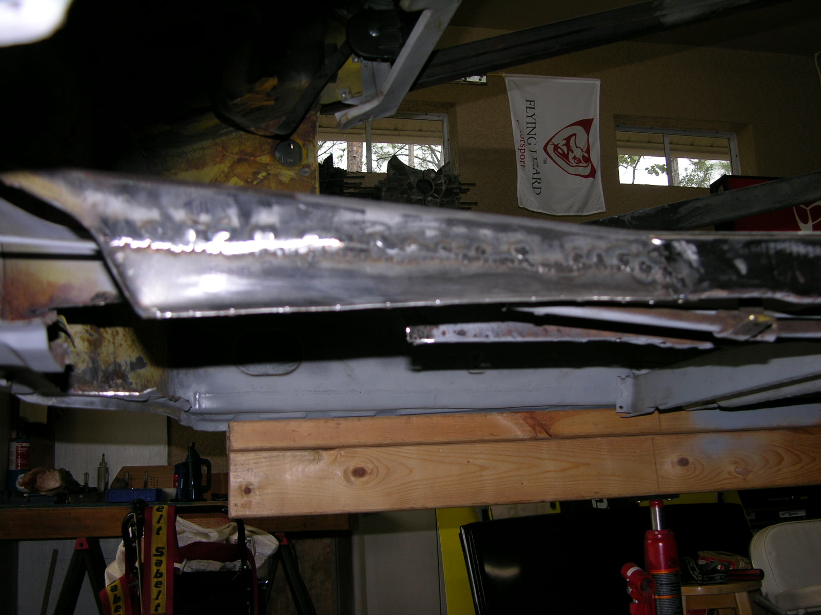

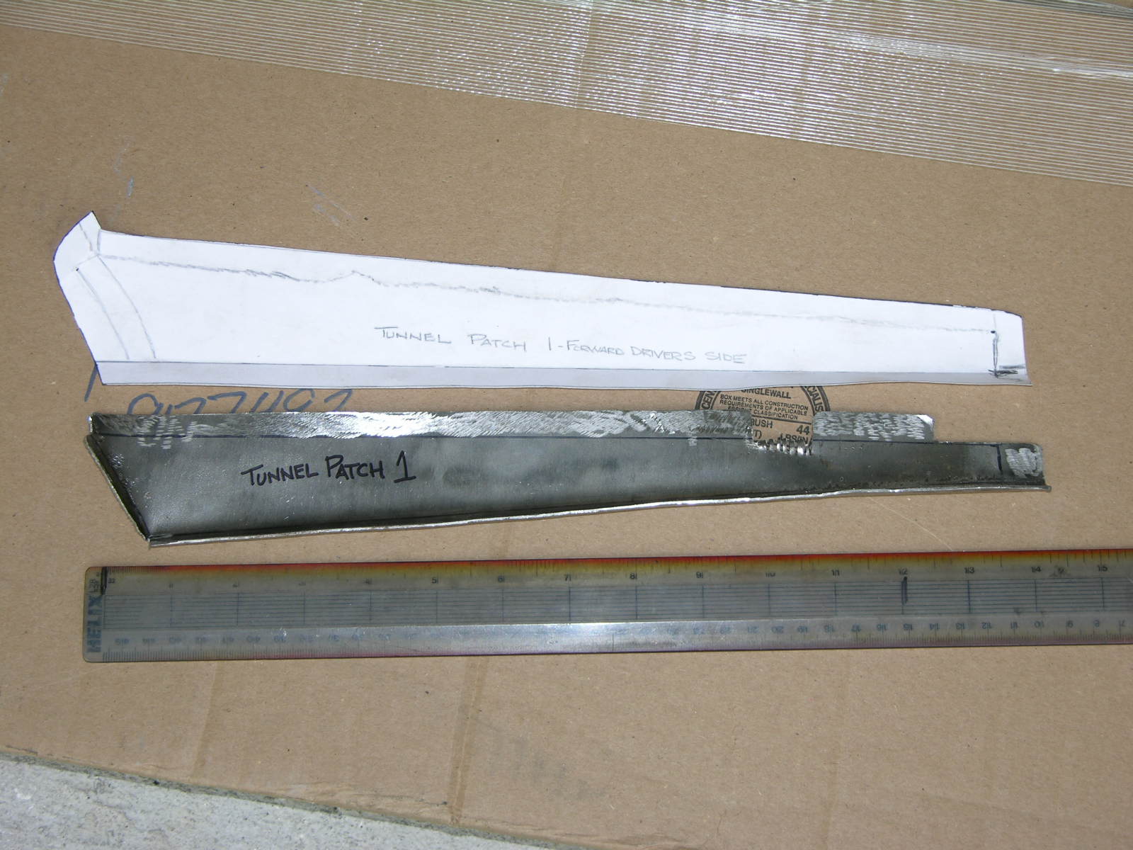

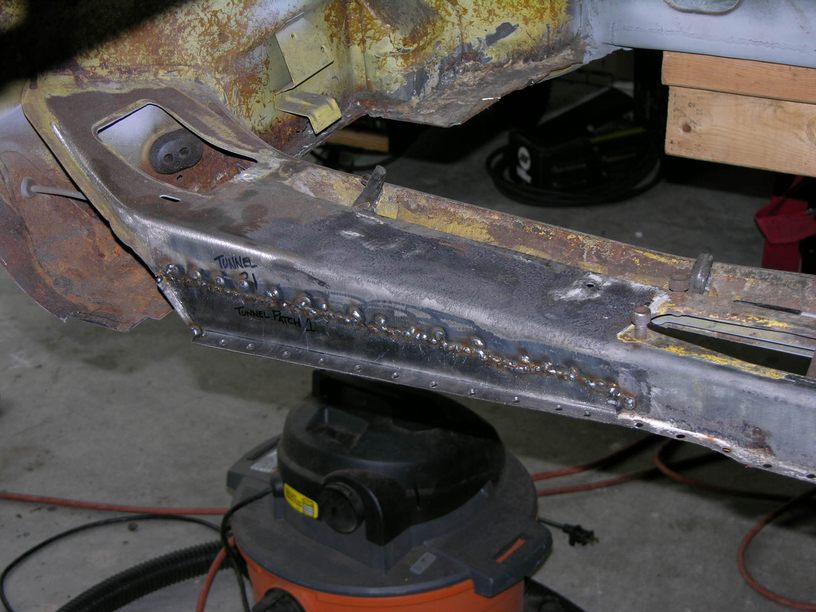

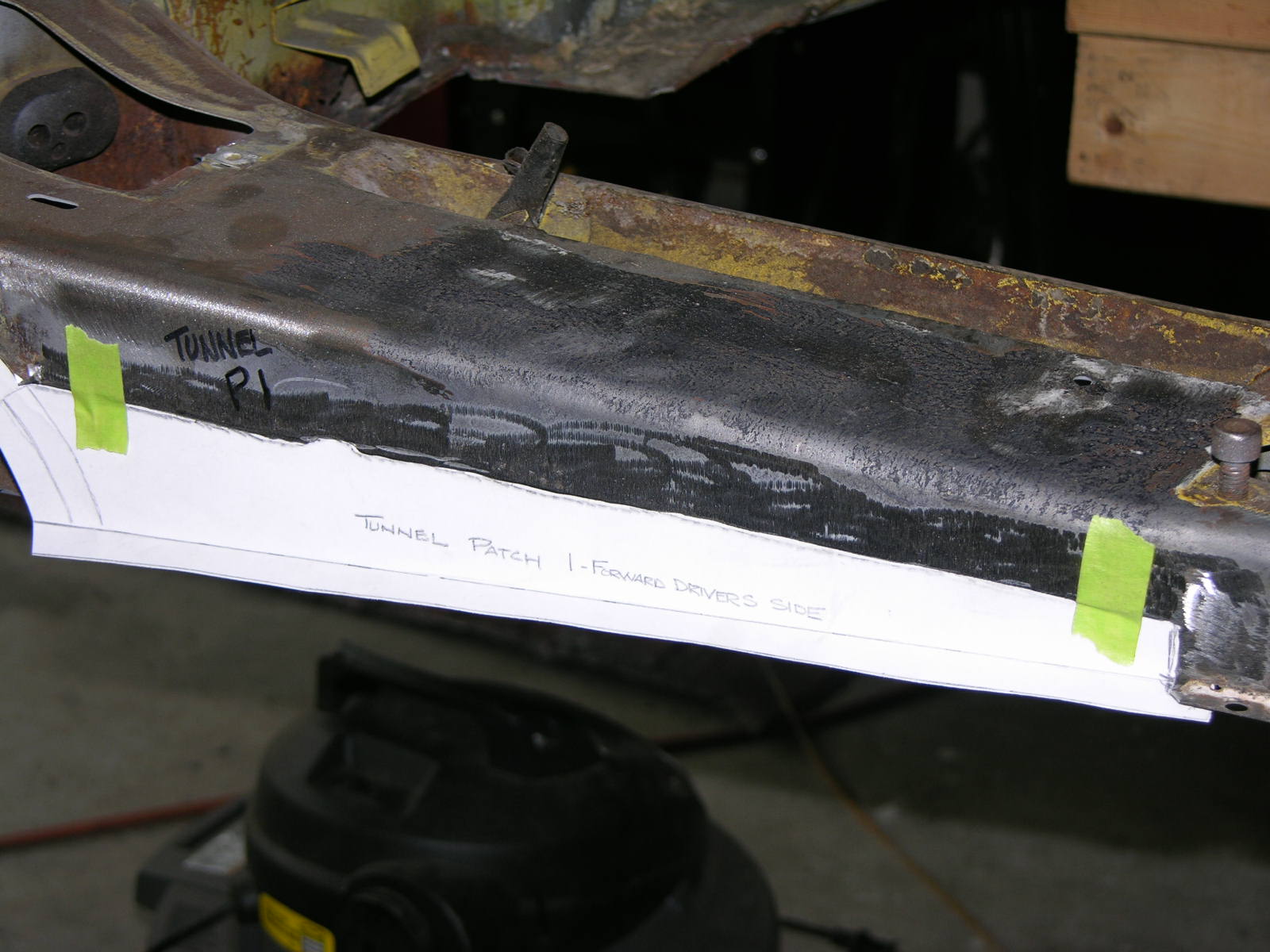

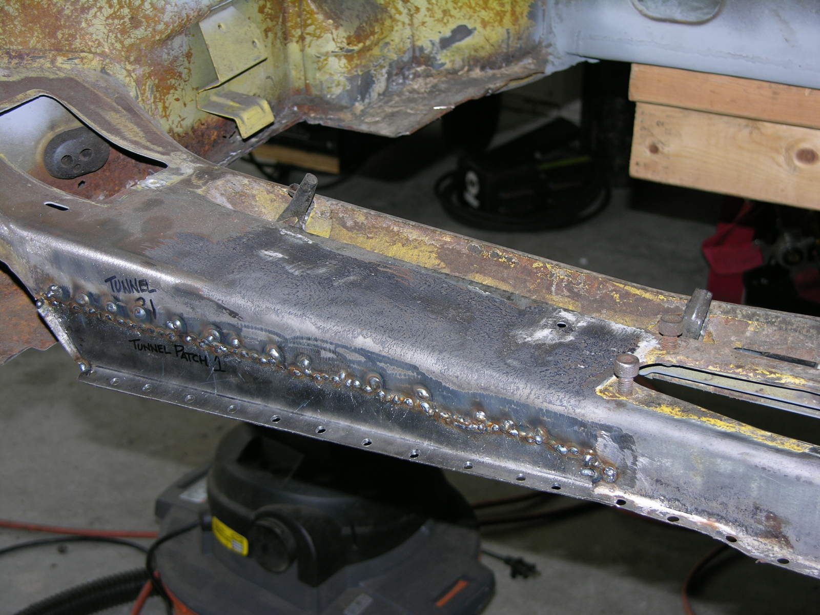

OK December 2015,

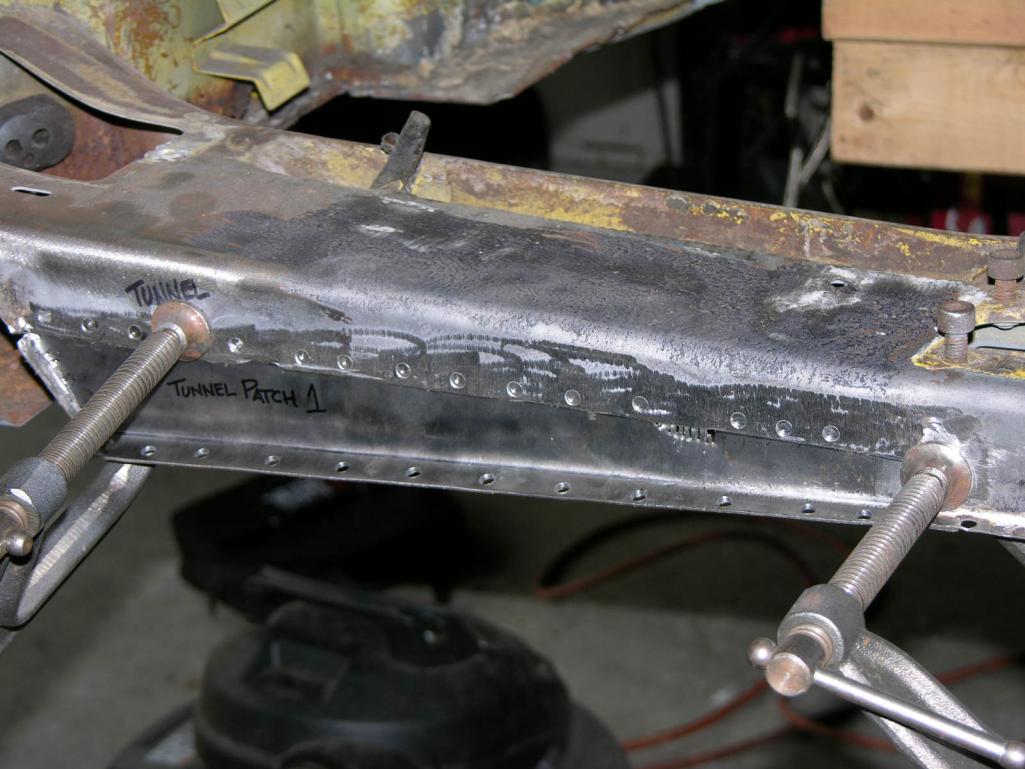

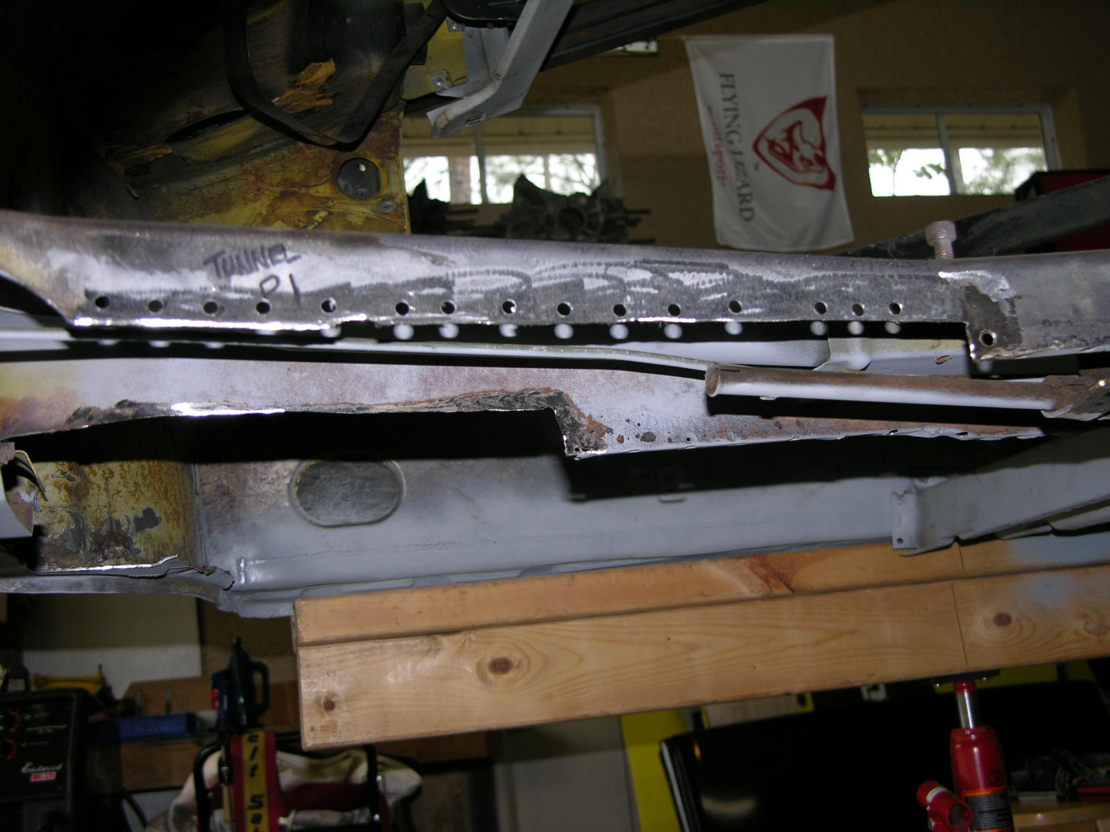

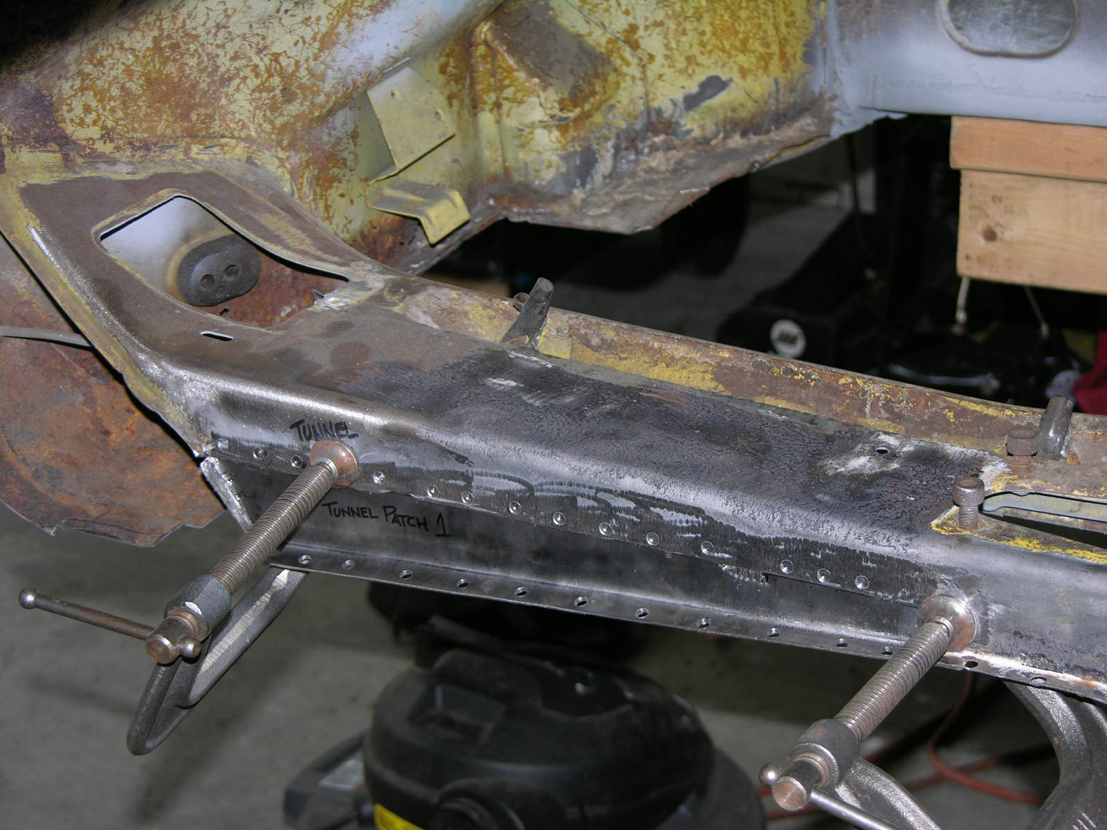

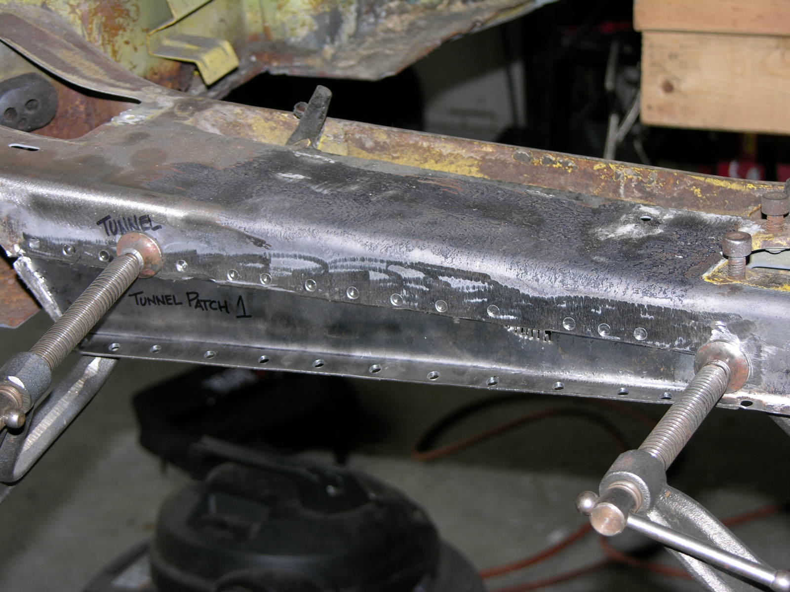

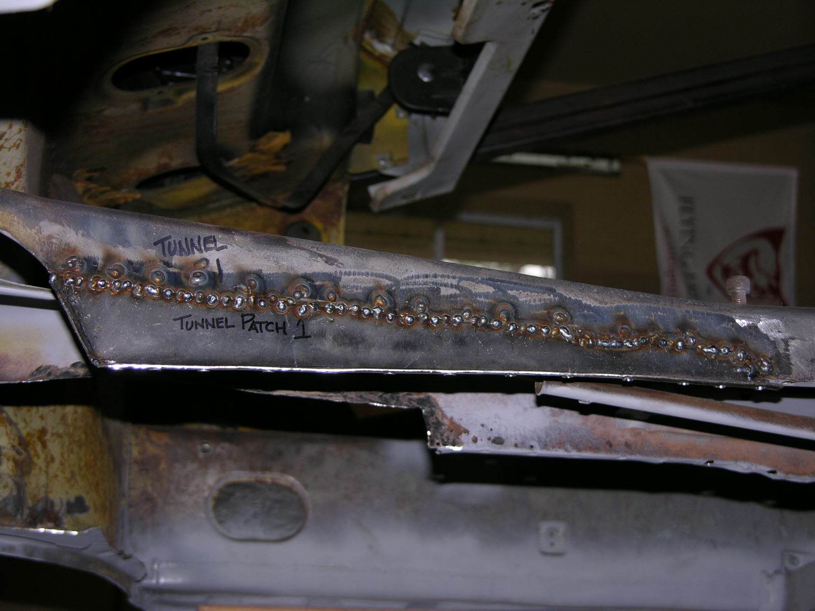

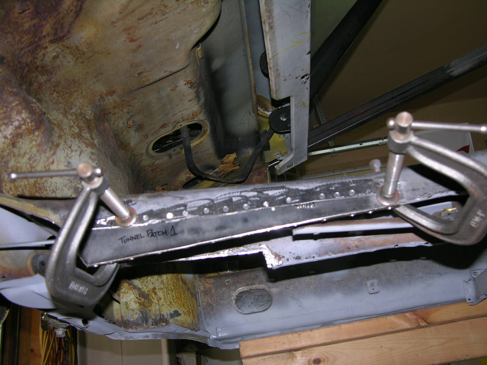

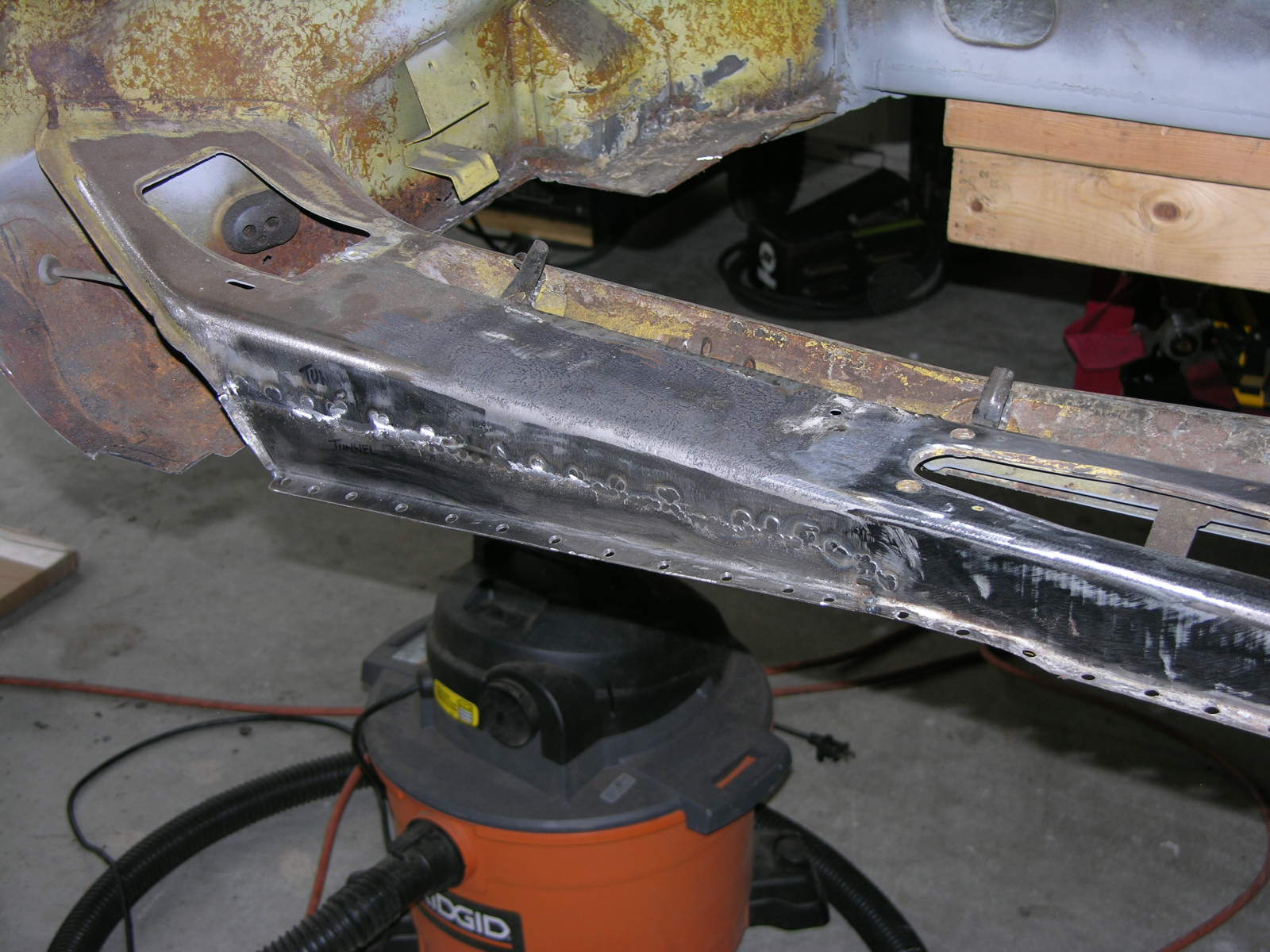

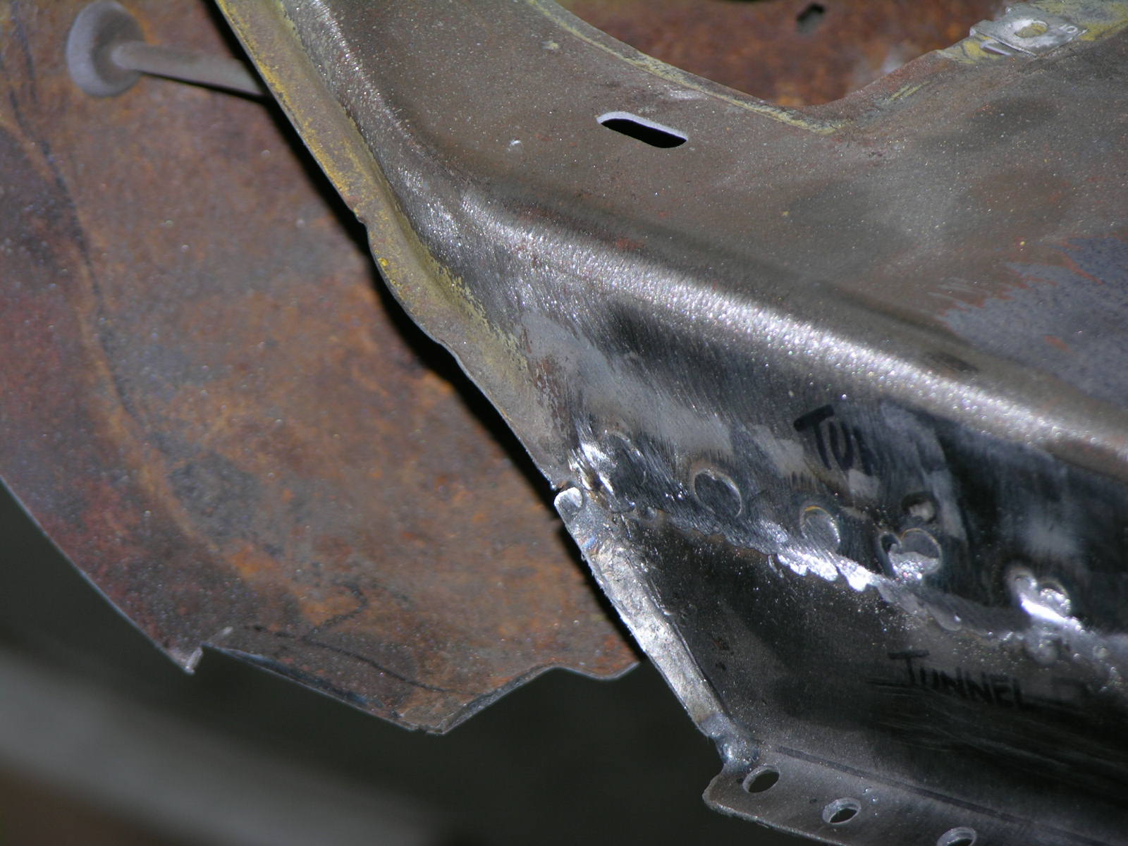

I was able to take advantage of Thursday the 10th of December and get the 1st of 3 patches welded in on tunnel.
Working with the new TIG welder has strangely helped with my thin gauge work on my MIG welder. Anyway things were grabbing very nicely and I was able to really get things dialed in on Thursday.
I feel like for the first time that I may be creating some forward momentum on this project.
Here are a few photo's of what I got done the other day!
Prior to patch, as you can see water must have sat at the base of the tunnel in several places and the tin worm did his thing.
Another photo of area to be patched - Tunnel Patch 1.
Pattern Designed & Test Fit.
Second Test Fit.
Sheet Metal cut out and formed up.
Tunnel drilled for rosette welds and prepped for MIG.
New piece clamped in with C-Clamps.
In place and ready to join the Yellow Sub forever.
Another Angle.
First welding pass with the MIG.
I think that will hold it.
Another Angle.
First pass at grinding & sanding of the welds, please remember that this area will be covered with Dynamat and carpet other wise I would have done pretty butt welds.
Close Up of the edge, was even able to tie in the little openings on the lip where they attached.
In primer.
On to the next patch!
More coming, once the other two patches in the tunnel are accomplished I can weld the Driver's Side Middle Brace in from Restoration Design!
Thanks,
