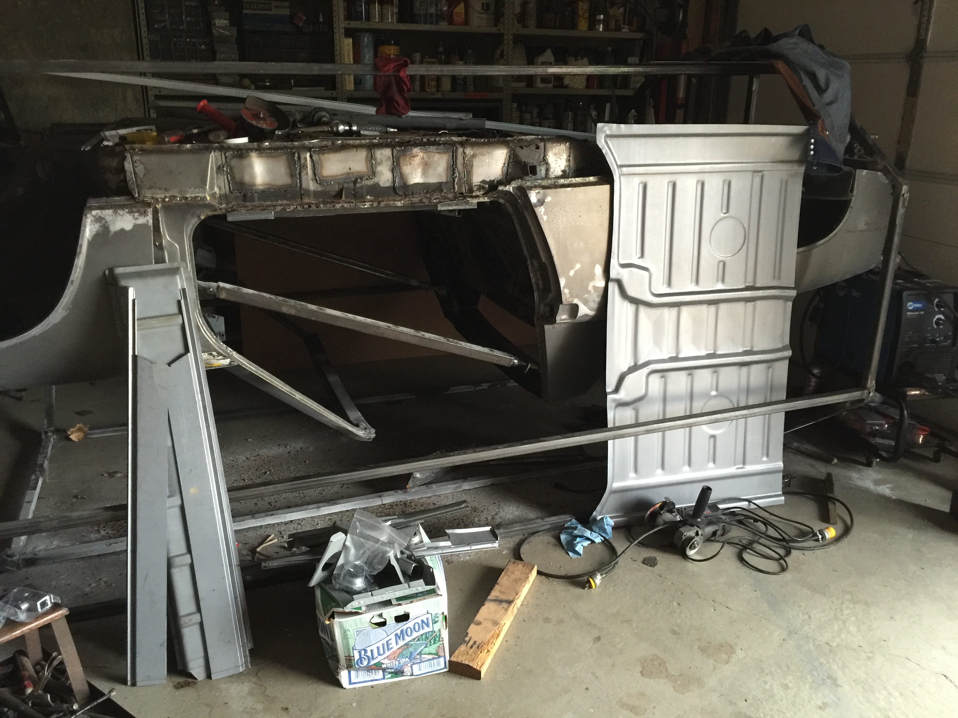

budk   I spent the first two weeks of October removing ev...   Oct 31 2015, 01:41 PM
Andyrew   Great looking rotisserie and bracing!   Oct 31 2015, 02:36 PM
914forme   Wow that rotisserie looks like something I need fo...   Oct 31 2015, 04:37 PM
budk   Wow that rotisserie looks like something I need f...   Nov 1 2015, 05:00 PM
budk   Hera are a few pics of the car in process and a su...   Nov 5 2015, 04:24 AM
DirtyCossack   Those welds make me feel better about my own.   Nov 5 2015, 06:26 PM
budk   Car was soda blasted the first week of November. ...   Dec 1 2015, 05:16 AM
budk   All in all the soda blasting revealed that there a...   Dec 1 2015, 05:27 AM
mepstein   All in all the soda blasting revealed that there ...   Dec 5 2015, 07:57 AM
budk   [quote name='budk' post='2271790' date='Dec 1 201...   Dec 5 2015, 08:50 AM
mepstein   [quote name='budk' post='2271790' date='Dec 1 20...   Dec 5 2015, 09:02 AM
budk   [quote name='budk' post='2273634' date='Dec 5 201...   Dec 5 2015, 04:27 PM
