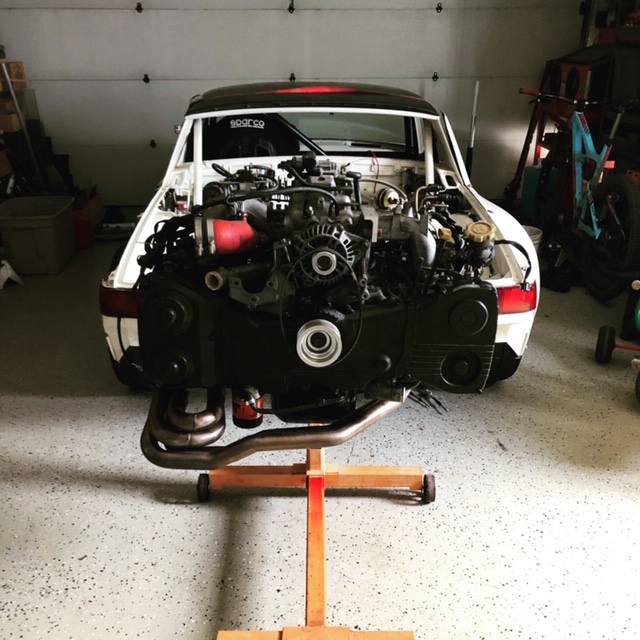

MichiganMat   Its been a busy couple of months since my last upd...   Aug 14 2017, 09:38 PM
mgp4591   Those are some serious LEDs.... are you gonna blin...   Aug 15 2017, 02:16 AM
MichiganMat   First start! 0sIbpQJs0ck But she is smokey: ...   Dec 17 2017, 10:48 PM

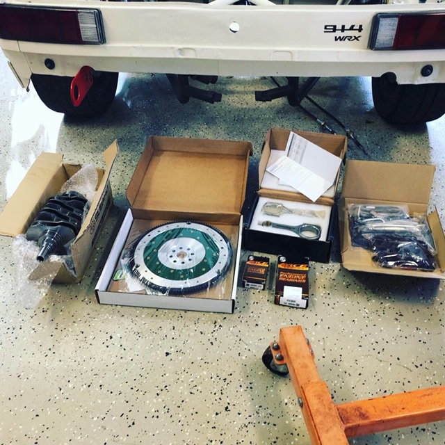

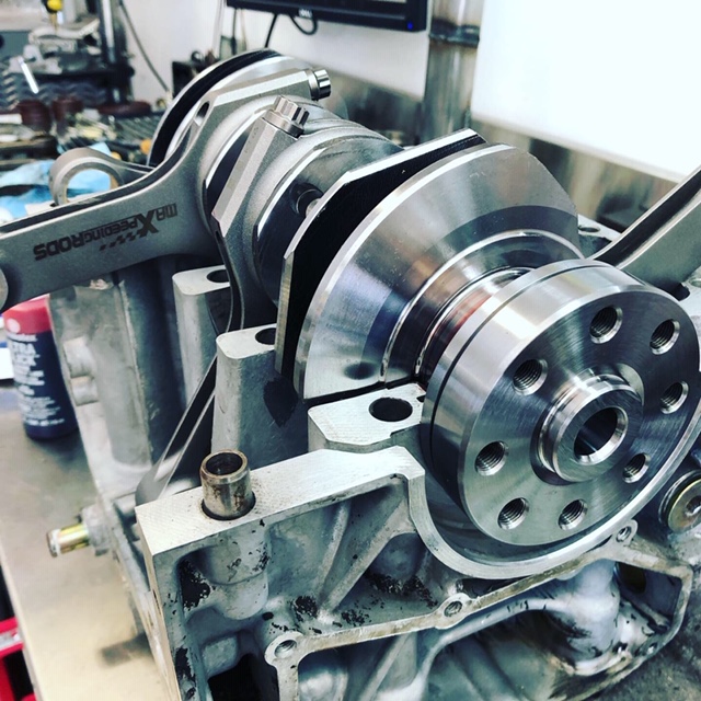

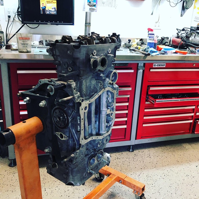

MichiganMat   Time for an update! Been busy with a few thin...   Apr 12 2018, 02:07 PM

MichiganMat   Video updates of the SSM-to-CAN Arduino project...   May 8 2018, 02:15 PM

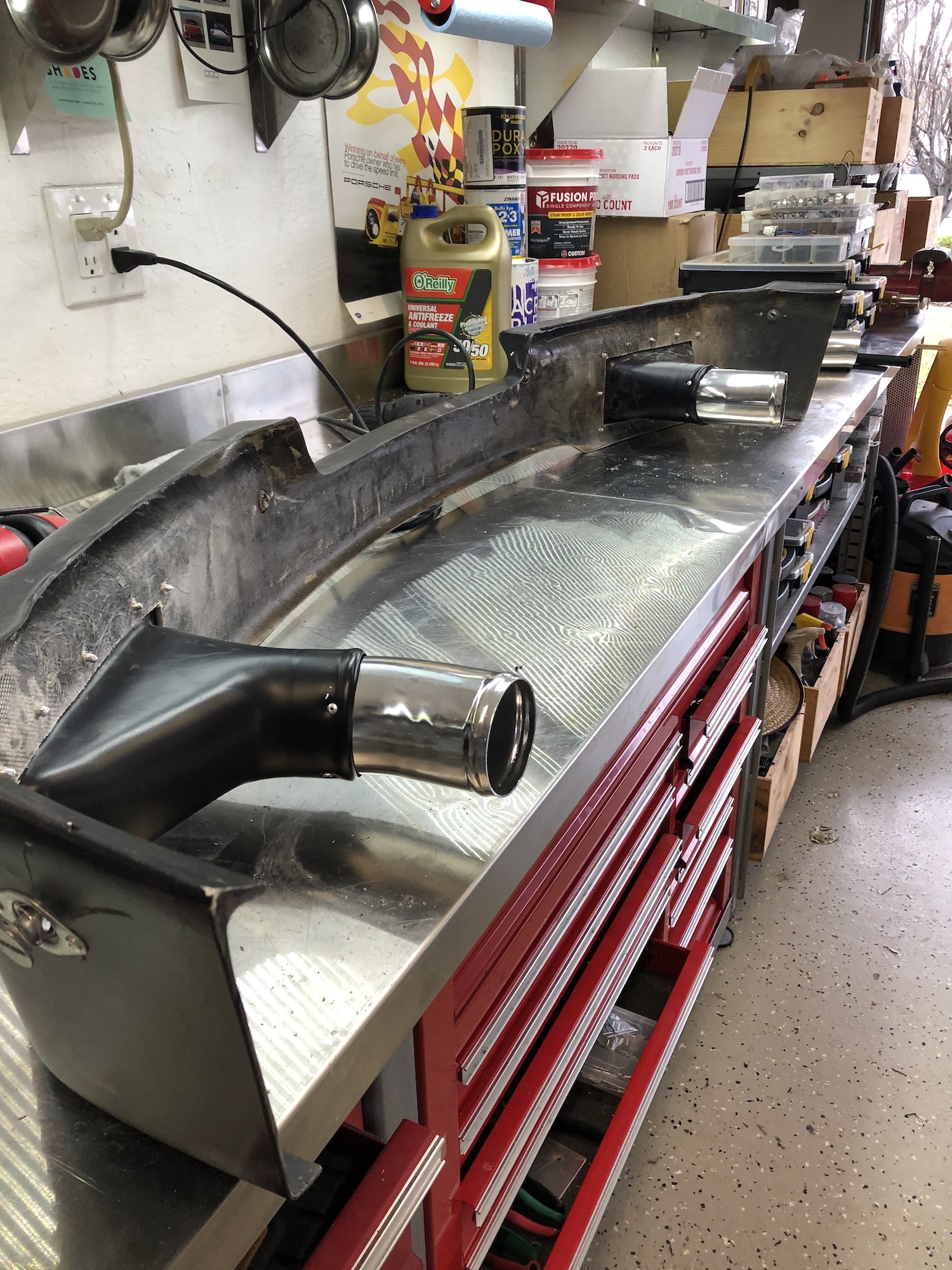

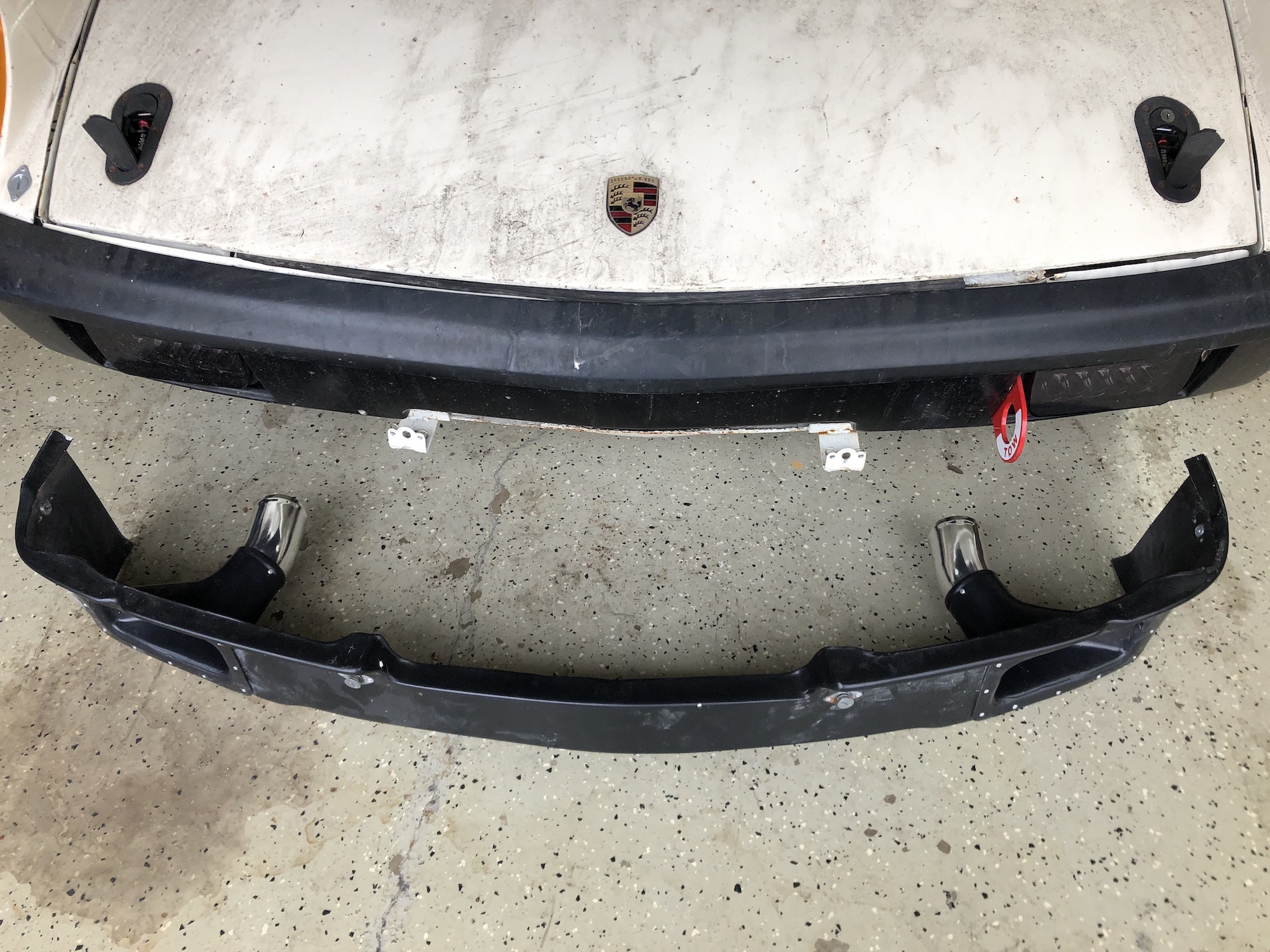

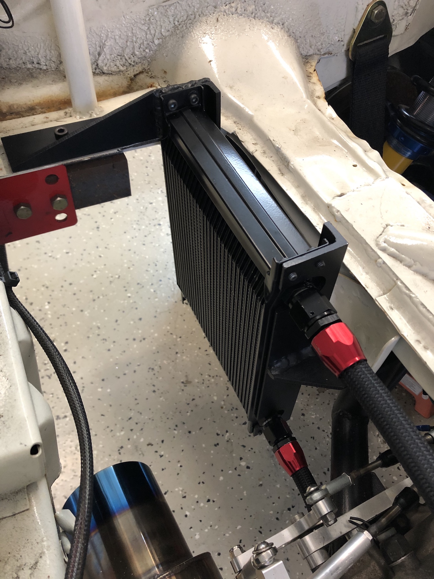

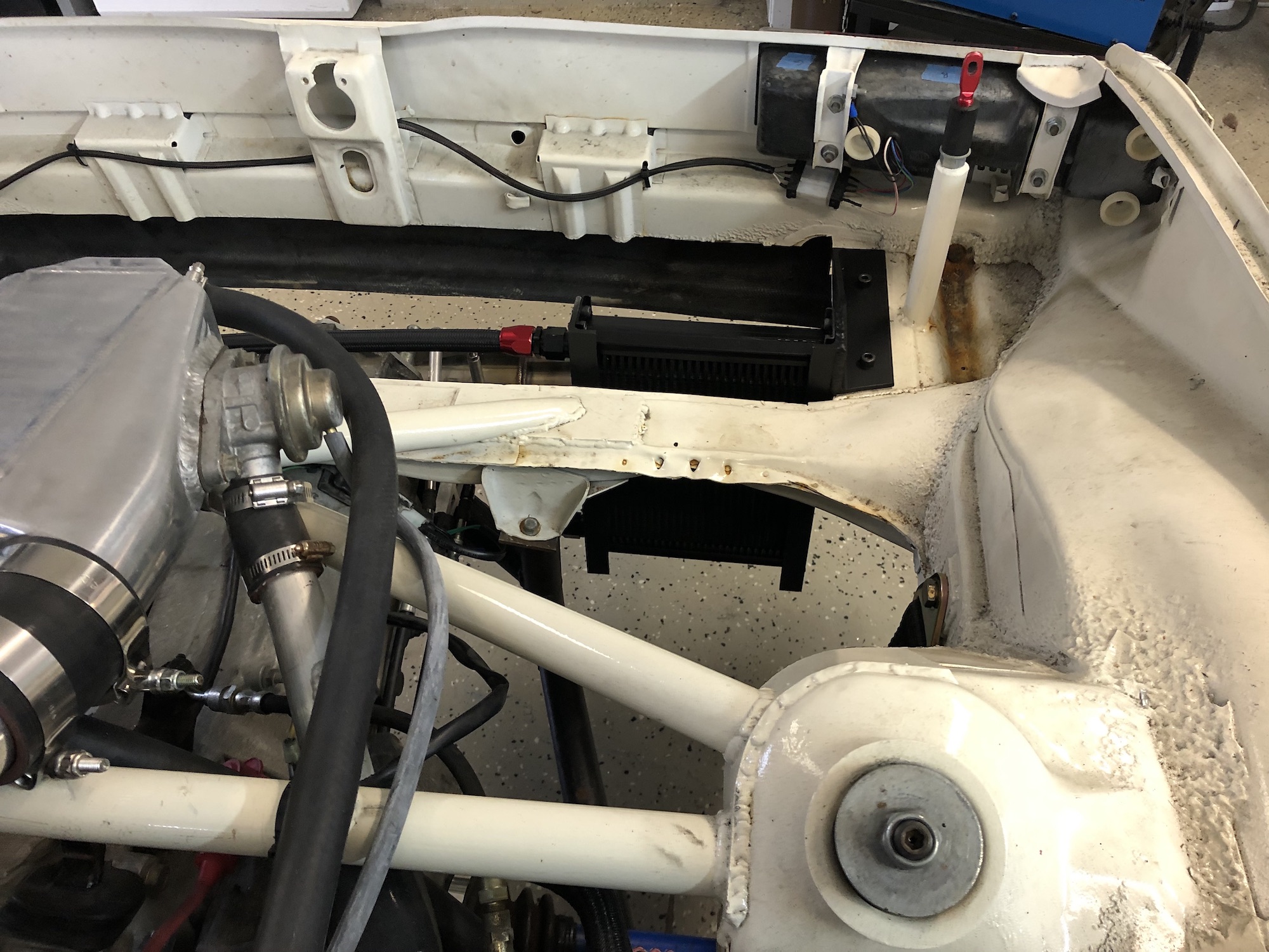

MichiganMat   Made a few changes recently: • Added a front to...   Aug 27 2018, 03:03 PM
Mueller   Cars looking great. What advantage does the racec...   Aug 27 2018, 04:28 PM
MichiganMat   Cars looking great. What advantage does the race...   Aug 27 2018, 08:21 PM

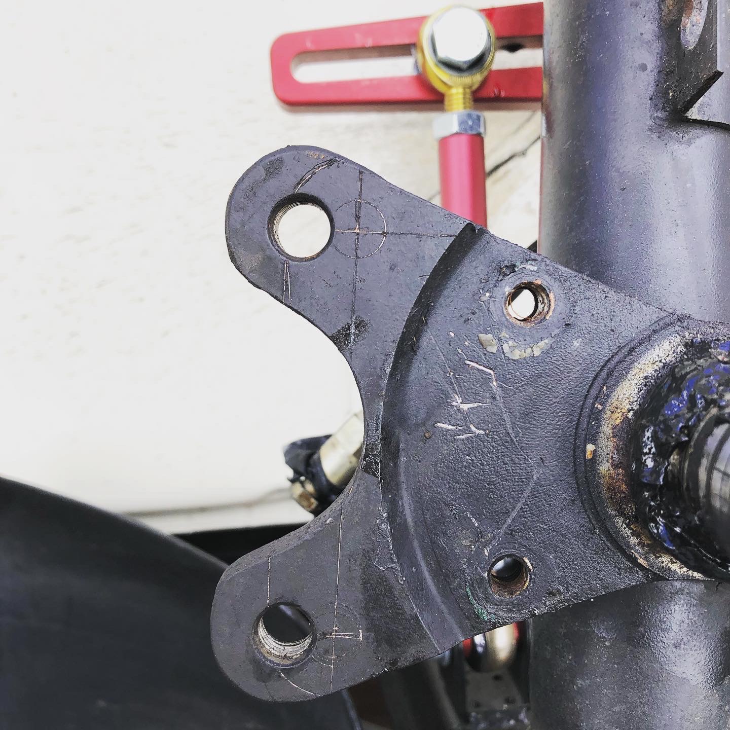

MichiganMat   • Rear: 250lb Swift springs over new Bilstein s...   Nov 18 2018, 11:27 AM
914forme   :WTF: Add a front sway bar NOW!!!...   Nov 18 2018, 02:00 PM
MichiganMat   :WTF: Add a front sway bar NOW!!!...   Nov 18 2018, 02:03 PM
mepstein   :WTF: Add a front sway bar NOW!!!...   Nov 18 2018, 02:11 PM
914forme   I missed the lowered car part, it is fine to lower...   Nov 18 2018, 02:14 PM
914forme   I think your close on the spring rates. Stock wit...   Nov 18 2018, 02:23 PM
