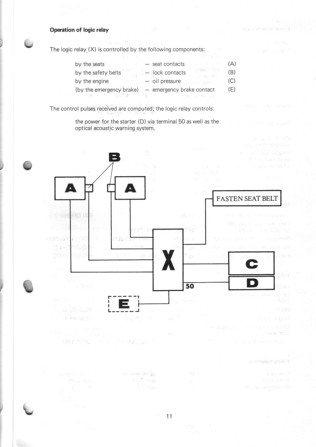

Can anyone explain this seat belt warning light schematic to me?
86 - 12v from the buzzer. 15 - 12v from the ignition switch. G - Ground through the seat belt receptacle switches. (Is your seat belt latched?) 50a - ???? I have 1 car that doesn't light up at all and another that flashes. I thought the seat belt light was not supposed to flash and didn't have anything to do with the e-brake switch. Thanks. Attached image(s)

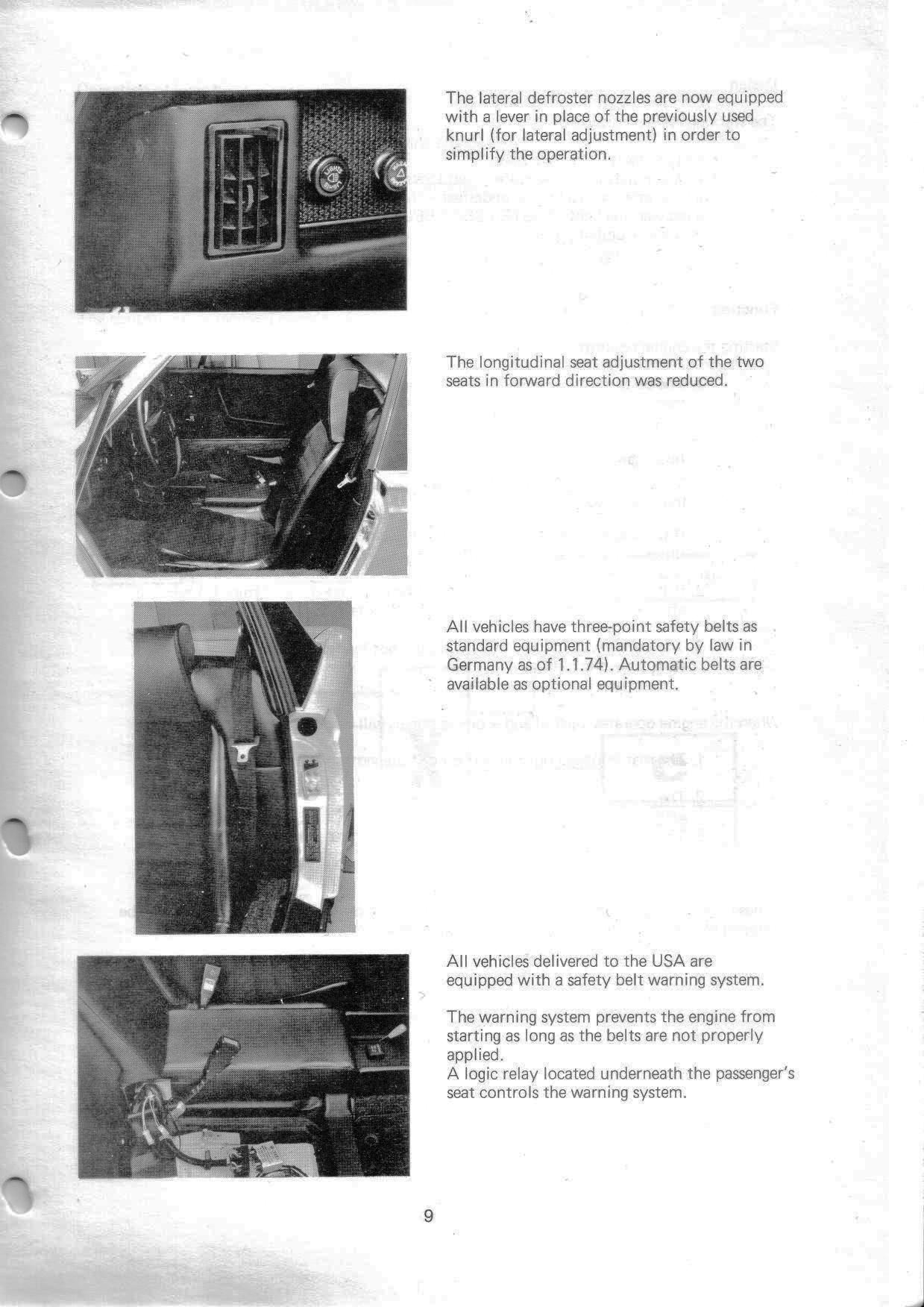

Jeff Bowlsby Mark, here are the 3 pages that address it in the ... Mar 7 2005, 11:49 PM
Jeff Bowlsby http://www.914world.com/bbs2/html/e... Mar 7 2005, 11:50 PM
Jeff Bowlsby http://www.914world.com/bbs2/htm... Mar 7 2005, 11:50 PM
McMark Thanks Jeff. That stuff is the seat belt interloc... Mar 8 2005, 02:29 AM![]() ![]() |
