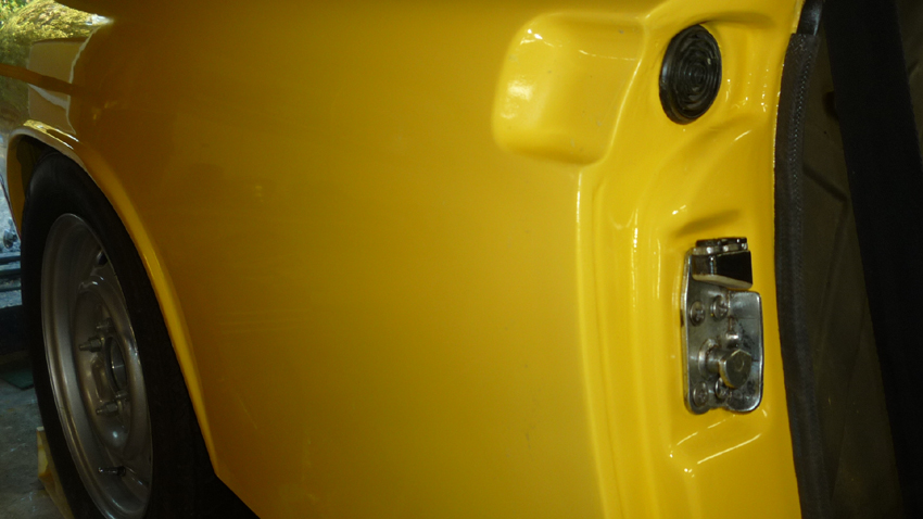

This will be a mildly modified back date look with body color bumpers and early steel wheels with hub caps.simple look of the German delivery first series cars.

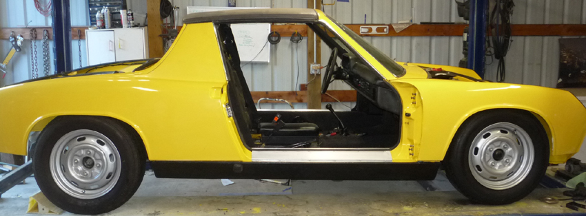

Starting in on the home stretch, glass in and ready for door install

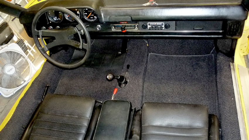

Interior is in and wiring connected. Starting to test systems and wake the long sleeping beauty. So far all go except for one headlight wont wake up.I'll be digging in on that as I work thru the rest of electrical check out.
Should hang the doors in the next few days. Fuel up and brake check out as well.
Original carpet is in pretty respectable condition. Steering wheel will get a going over.

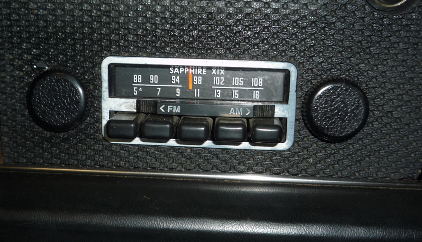

Bumpin' sound system

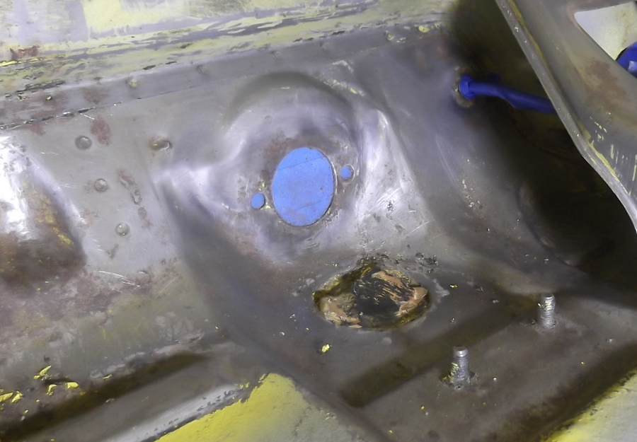

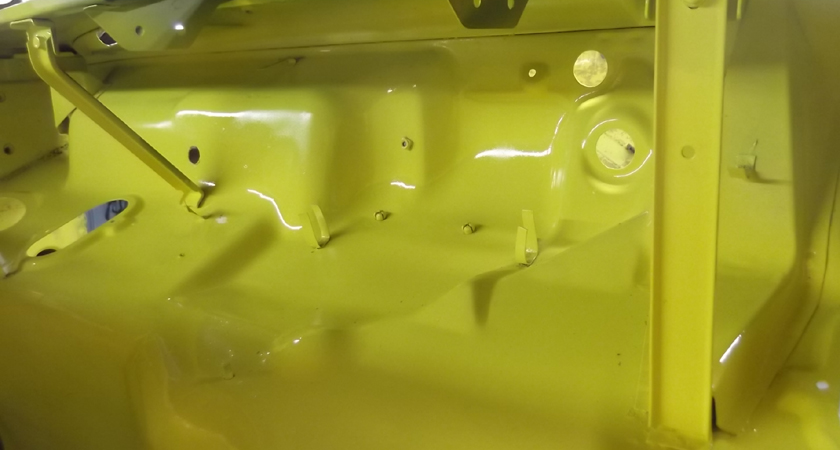

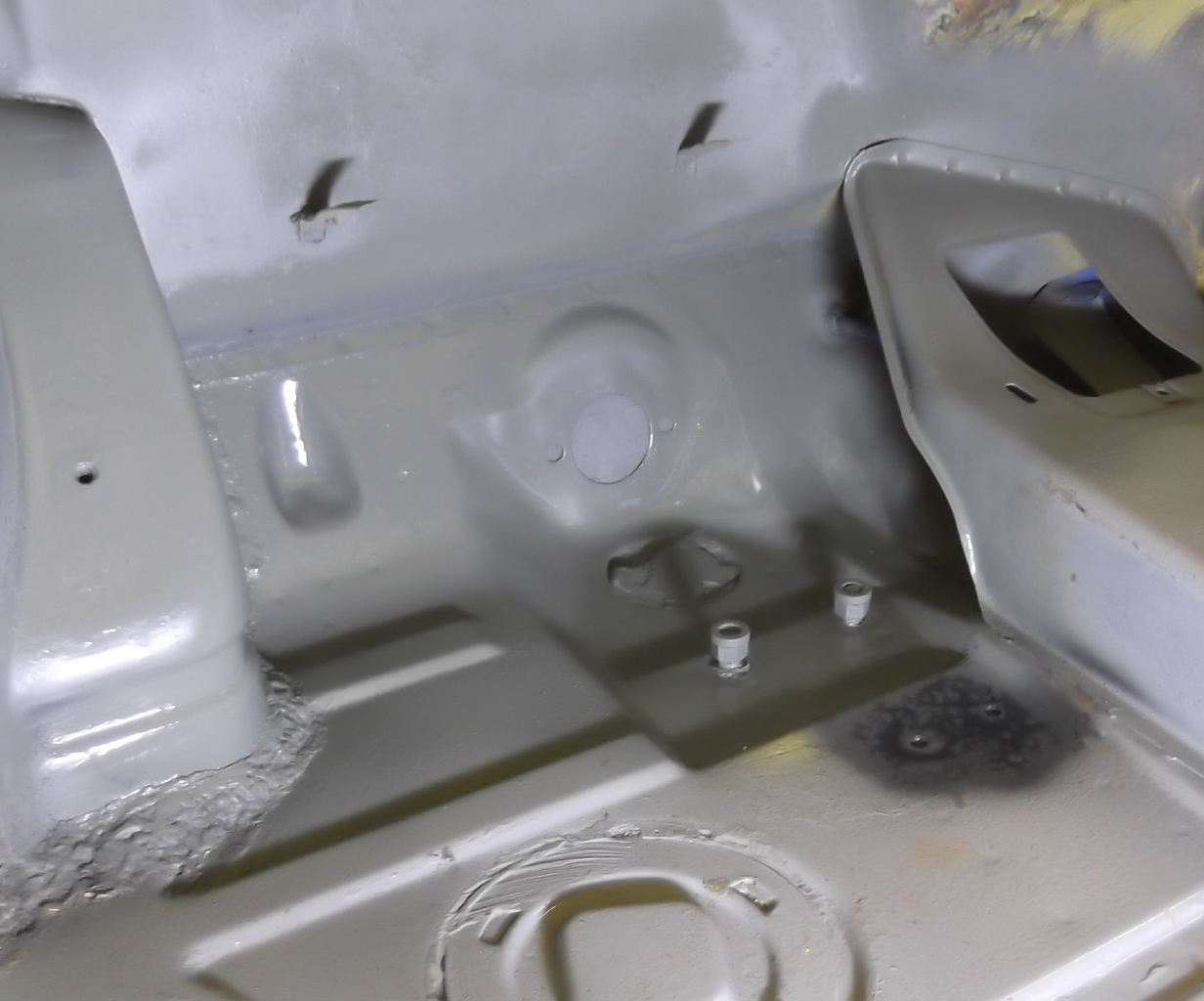

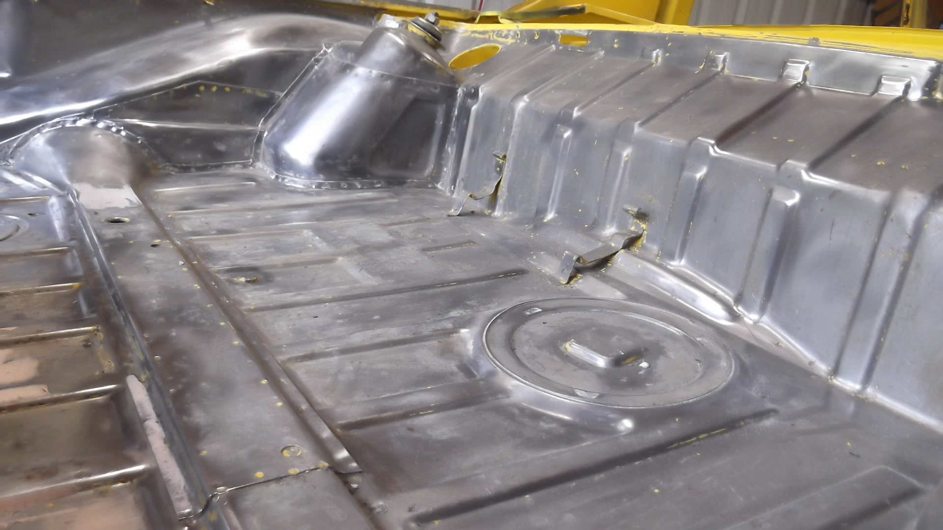

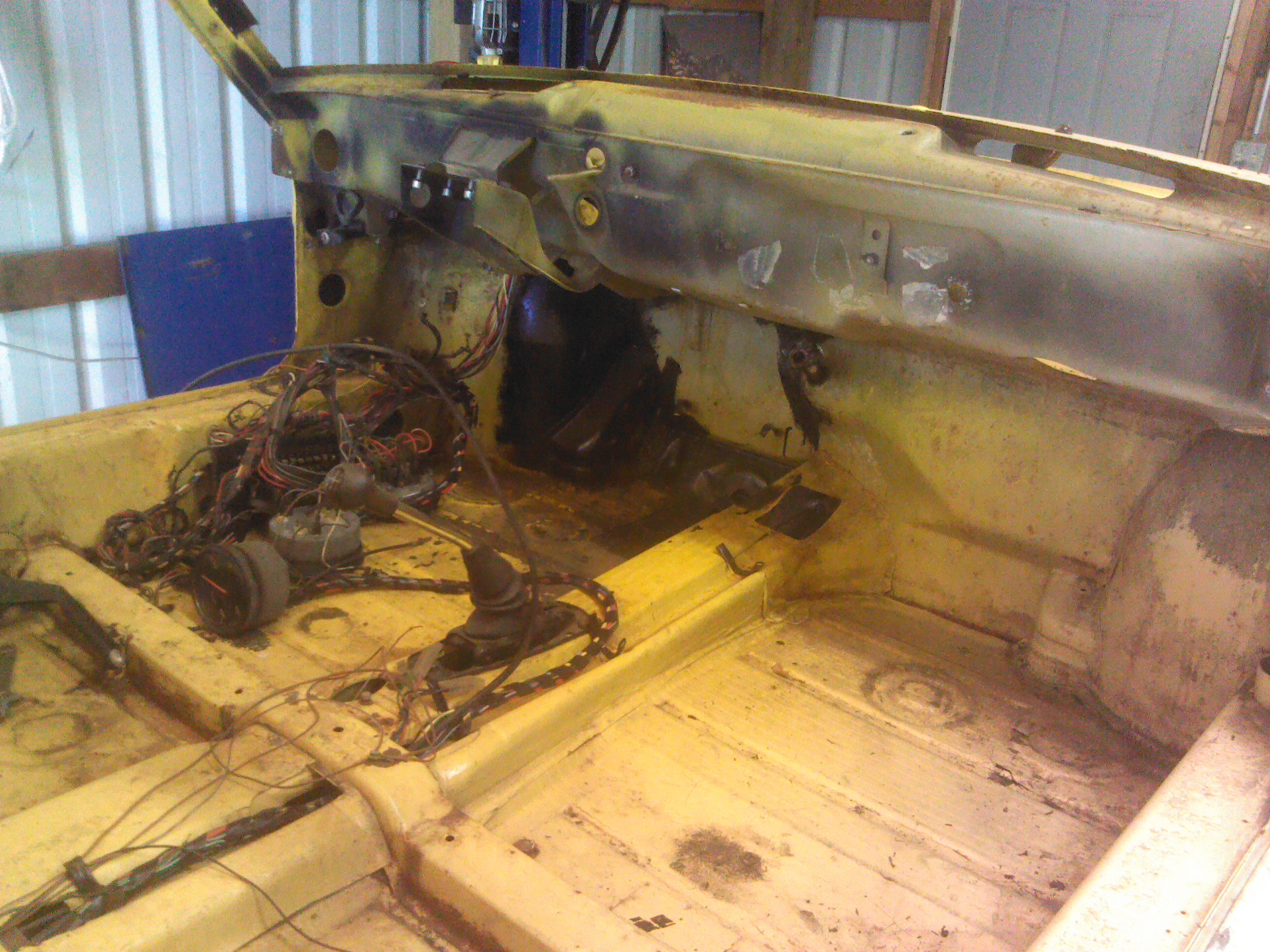

Metal shots

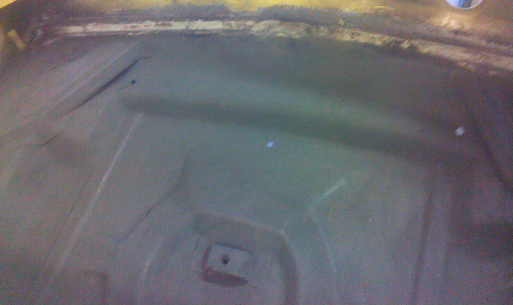

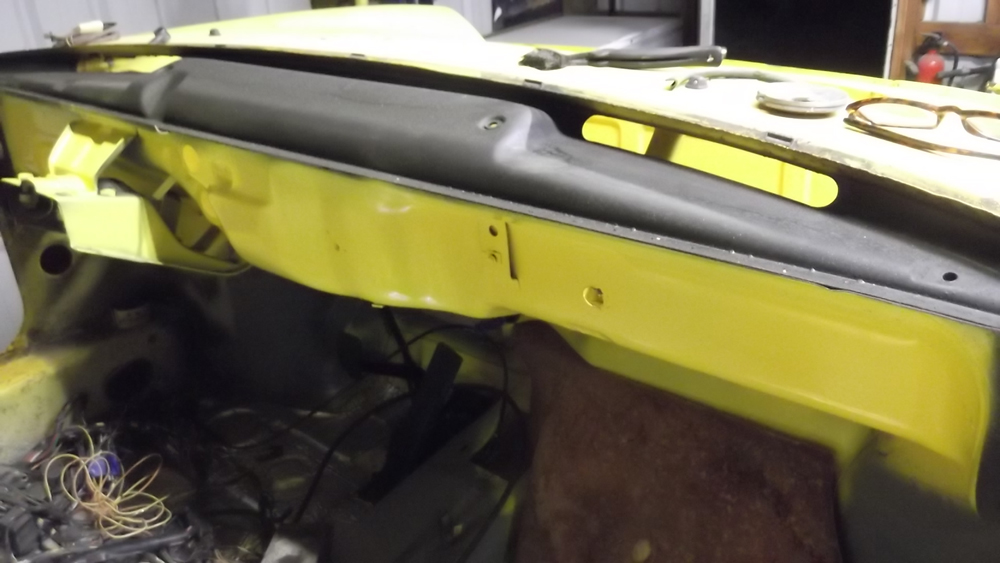

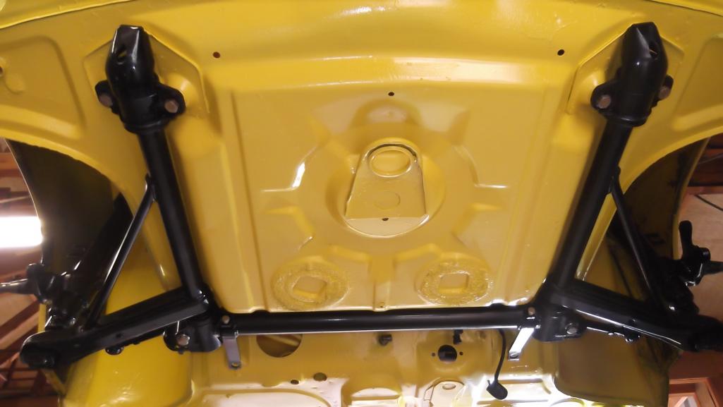

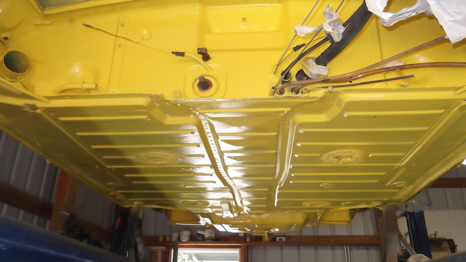

Under fuel tank before
Ugly but nice in a not rusty kind of way

Member No.: 87
Dang, great work on stripping that paint...what did you use?
mrfourteen
post Oct 11 2015, 11:00 PM
Posts: 74
Joined: 1-November 13
From: Oregon out in the Mozarks
Member No.: 16,596

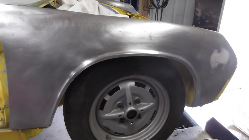

QUOTE(Mueller @ Oct 11 2015, 09:49 PM) *

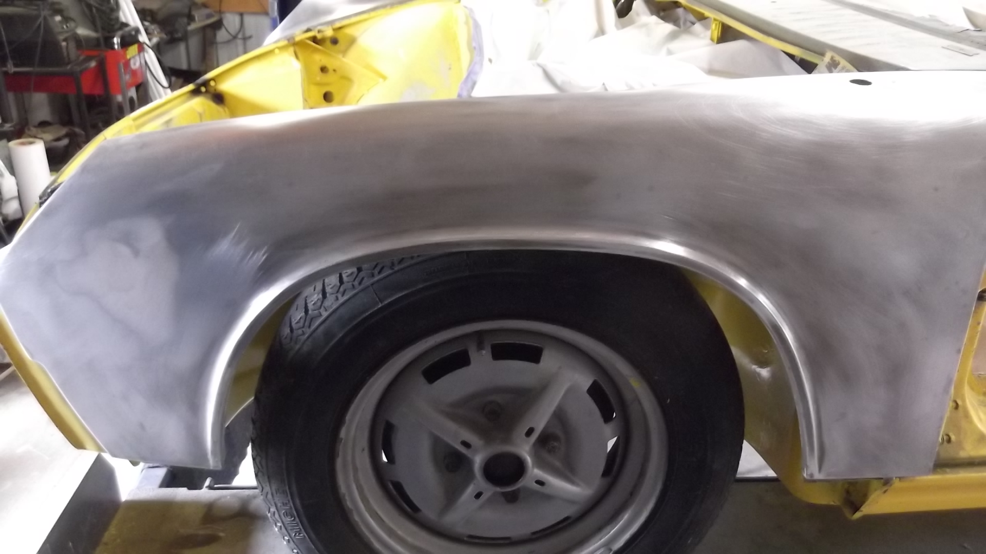

Paint remover, the kind that burns like mad when to get it on you.
I don't like to blast as it gets grit everywhere and not as easy to control if you have other parts finished. I use heat on the OEM seam sealer in the form of a propane tourch. Stinky and not fun.

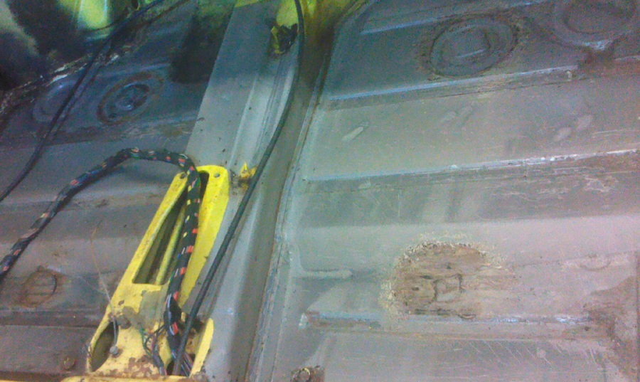

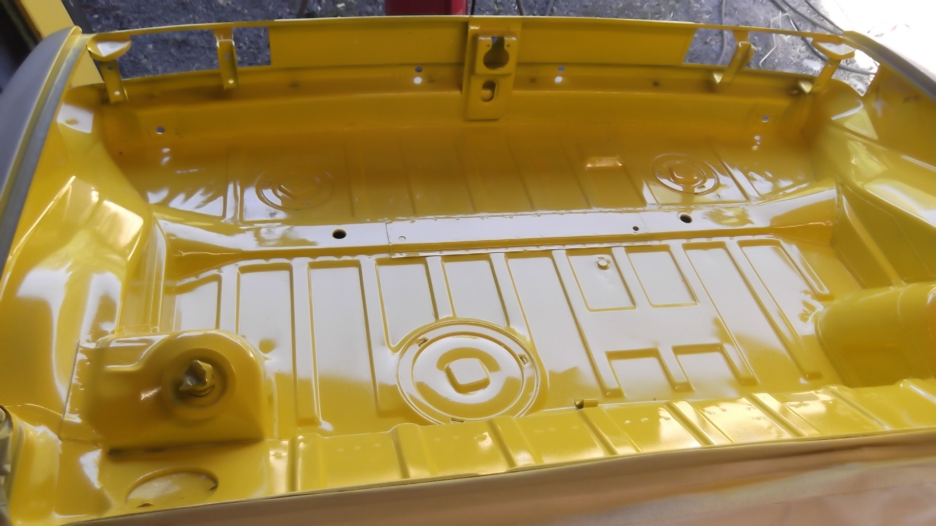

[quote name='mrfourteen' post='2250833' date='Oct 11 2015, 09:41 PM']
Floors with original factory finish. These were striped and epoxy painted before Roadblocker sound absorption mats were applied.
Roadblocker is self sticking butyl rubber with 4 mil aluminum backing, odorless non asphalt, good stuff.

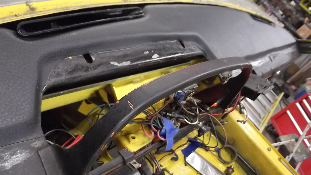

Some dash progress

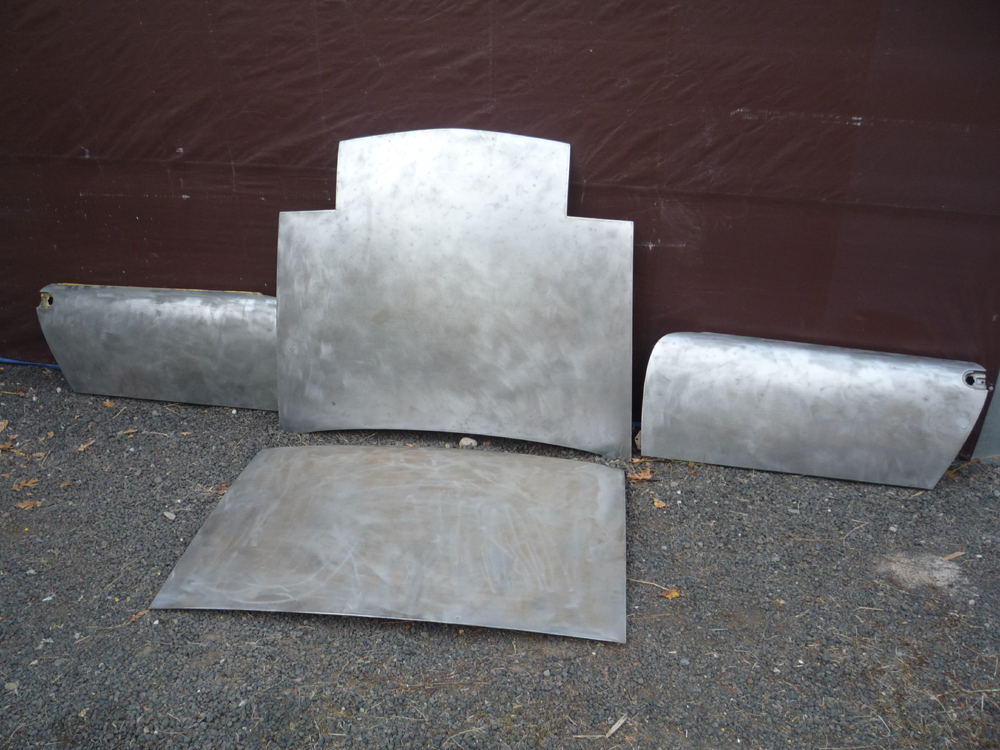

QUOTE(mrfourteen @ Oct 11 2015, 09:33 PM) *
body panels

Looking good. Could you talk a little more about the paint stripping? What brand, what was the process like, did you neutralize.... I want to know all about it!

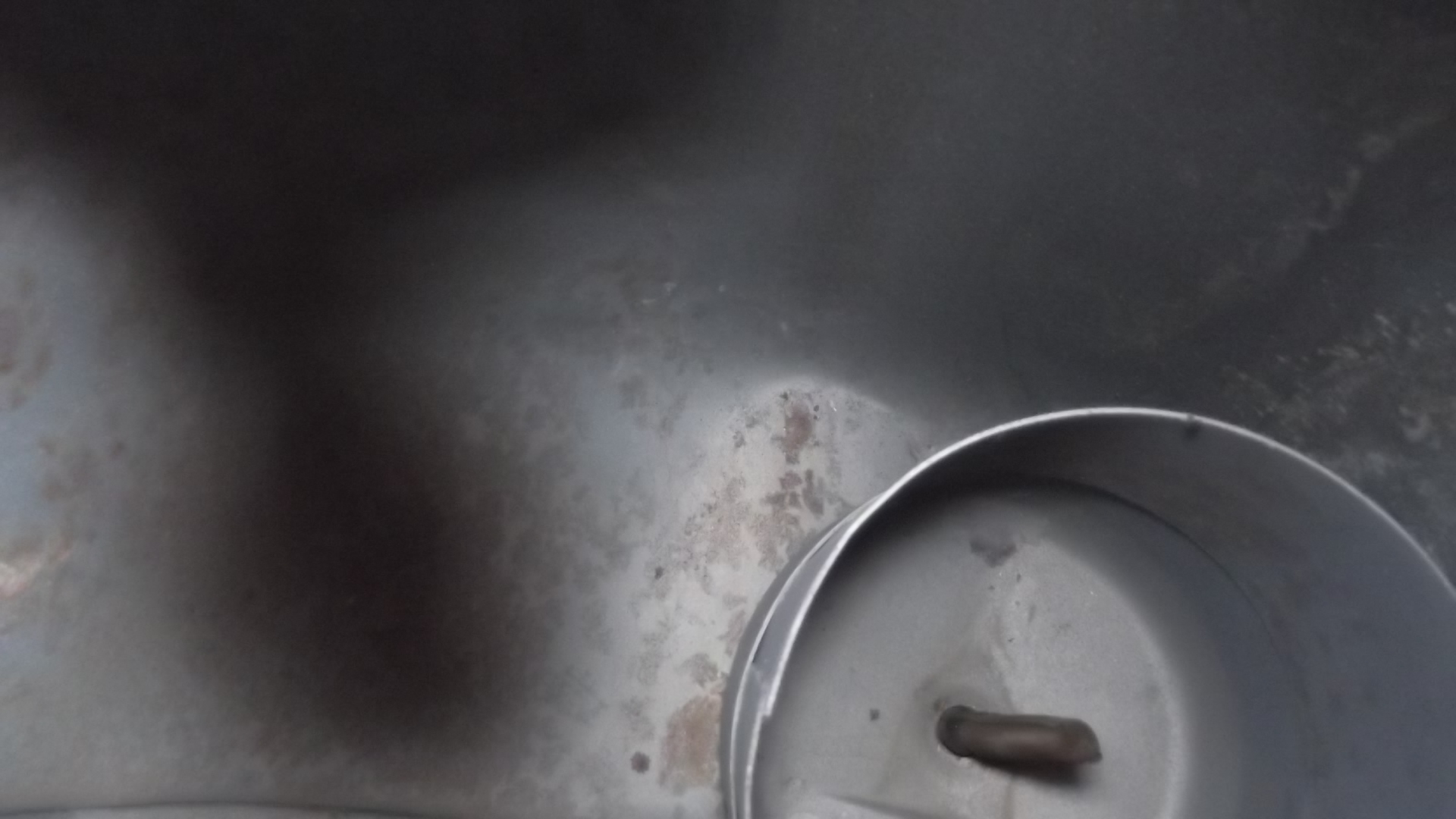

epoxy paint going the floors
A peek inside the fuel tank

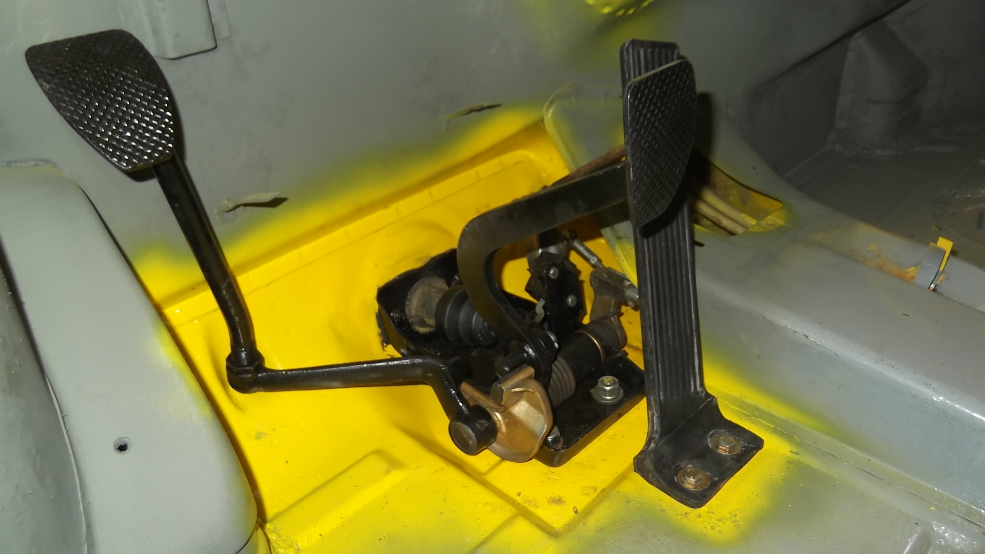

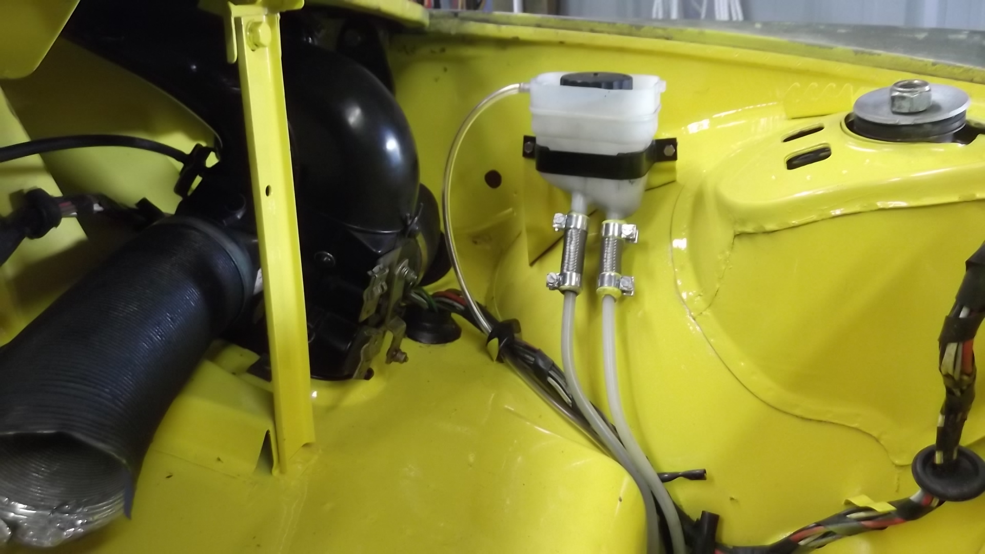

Moving on to some finished portions of the build
The factory heat shield has been removed for access to the area behind.
It's replaced bny an aluminum heat shield is mounted directly to the exhaust.

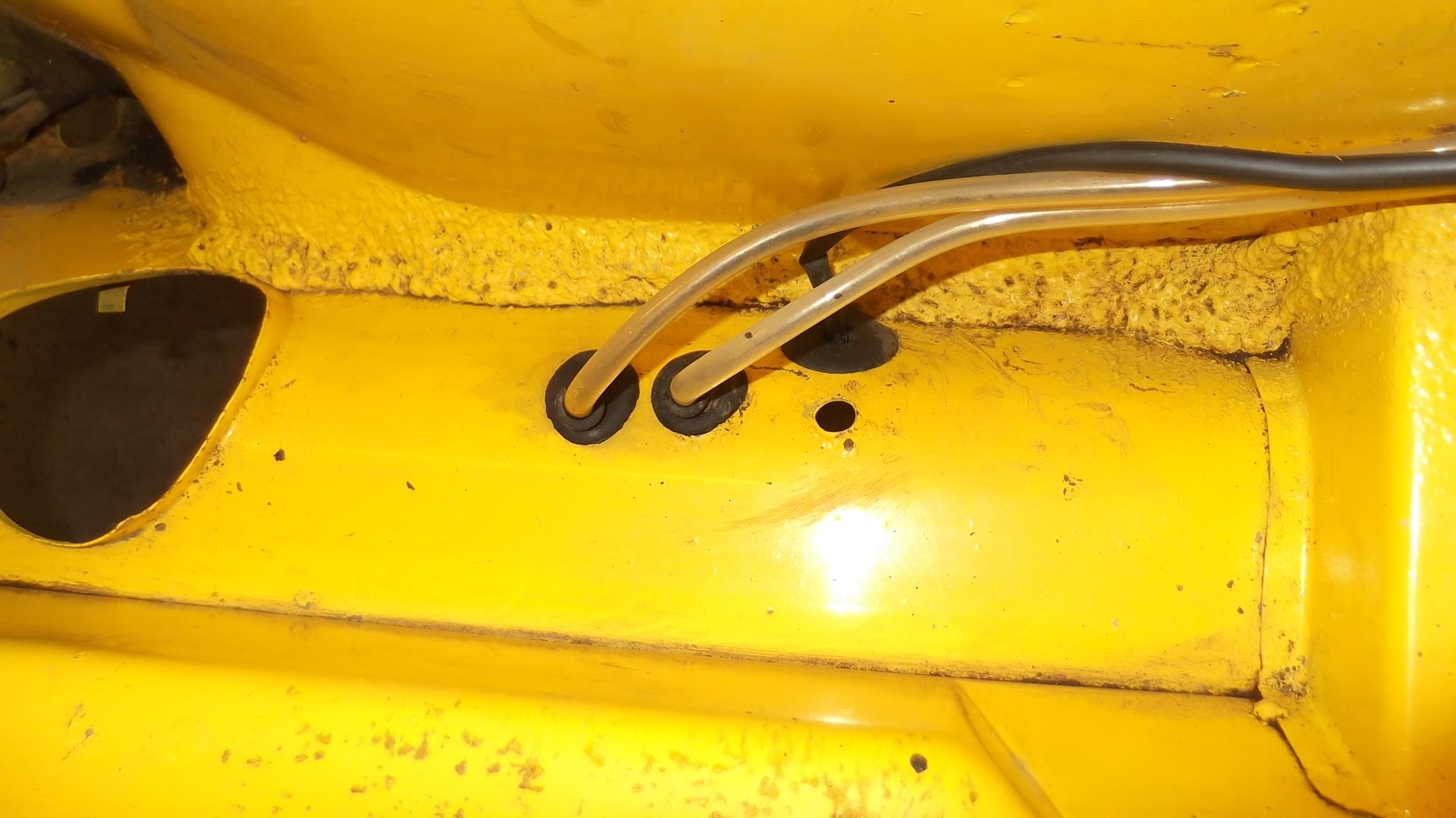

Plastic fuel lines have since been replaced with stainless steel
rebuilt pedal assy.

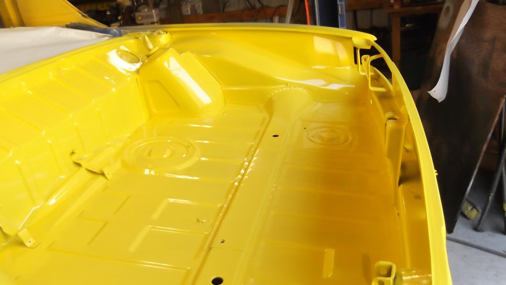

Yeah once you get it off you don't want to replace it, it looks too nice.
There's plenty on the under side. Front trunk got the same treatment.

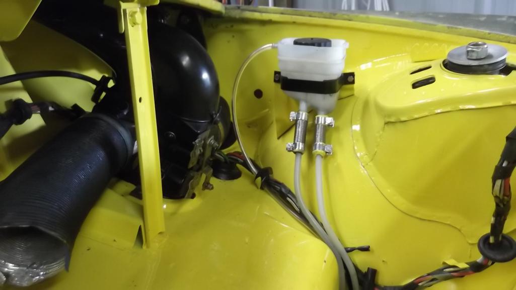

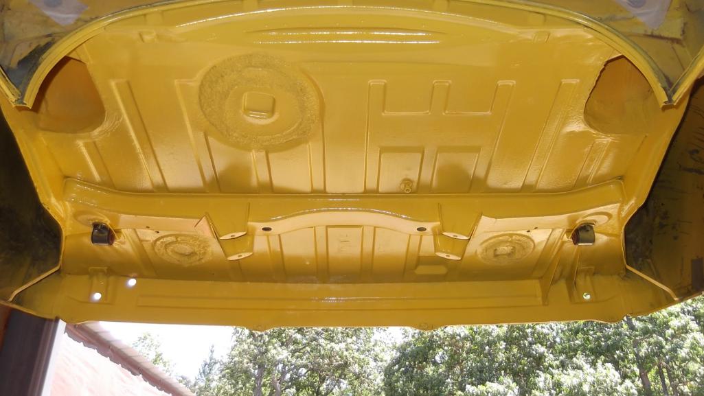

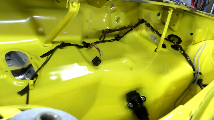

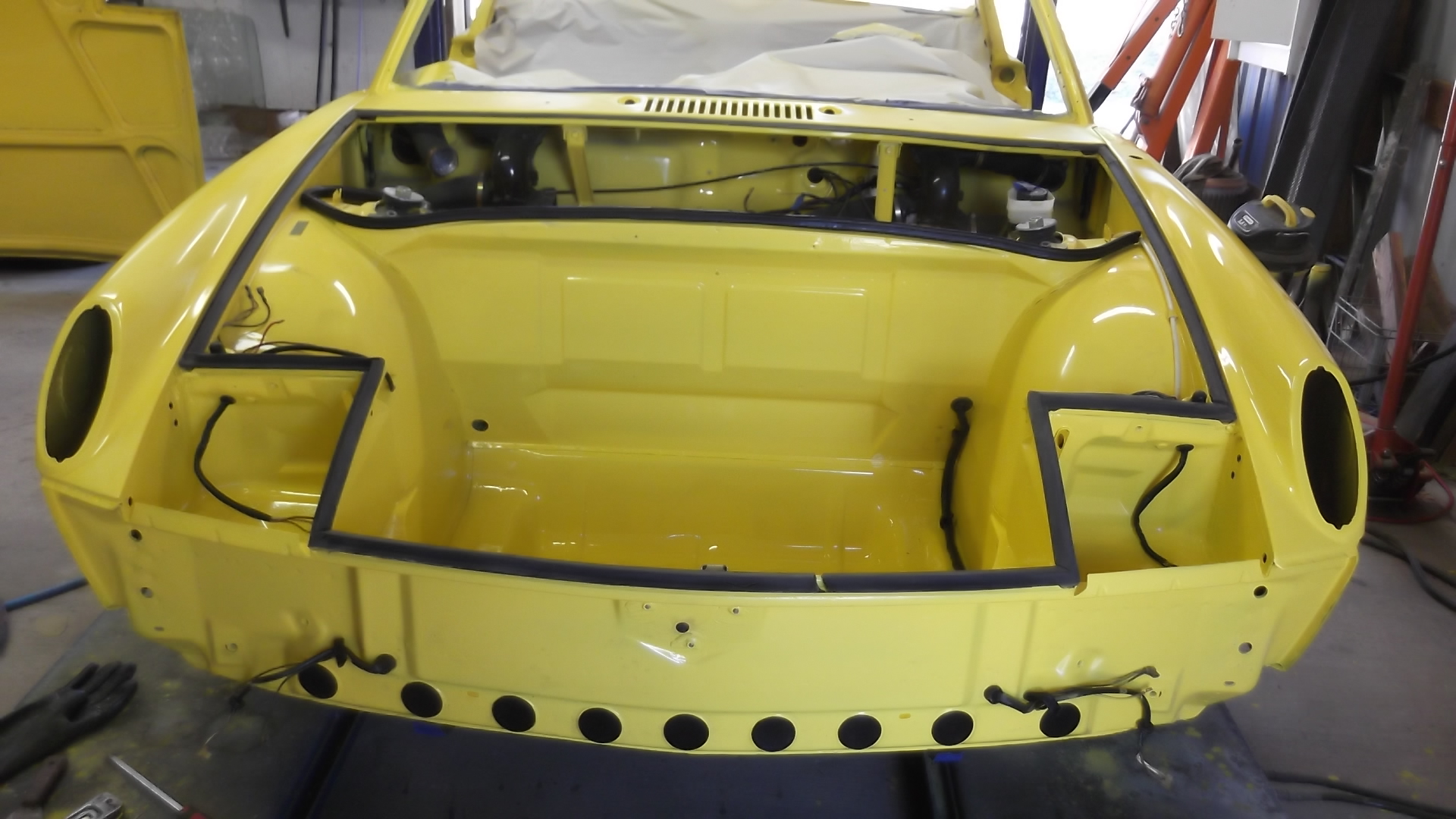

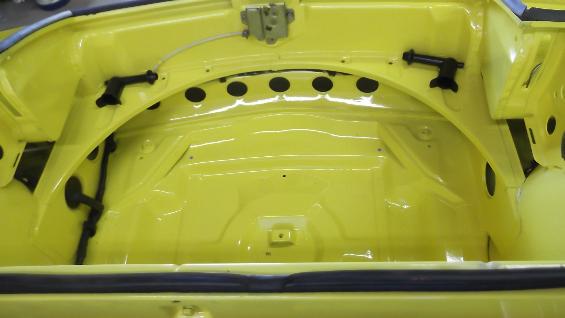

Moving forward to the front trunk and all the fiddly bits that live there.

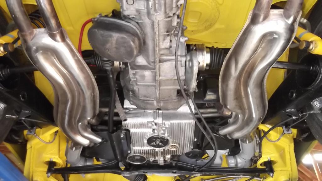

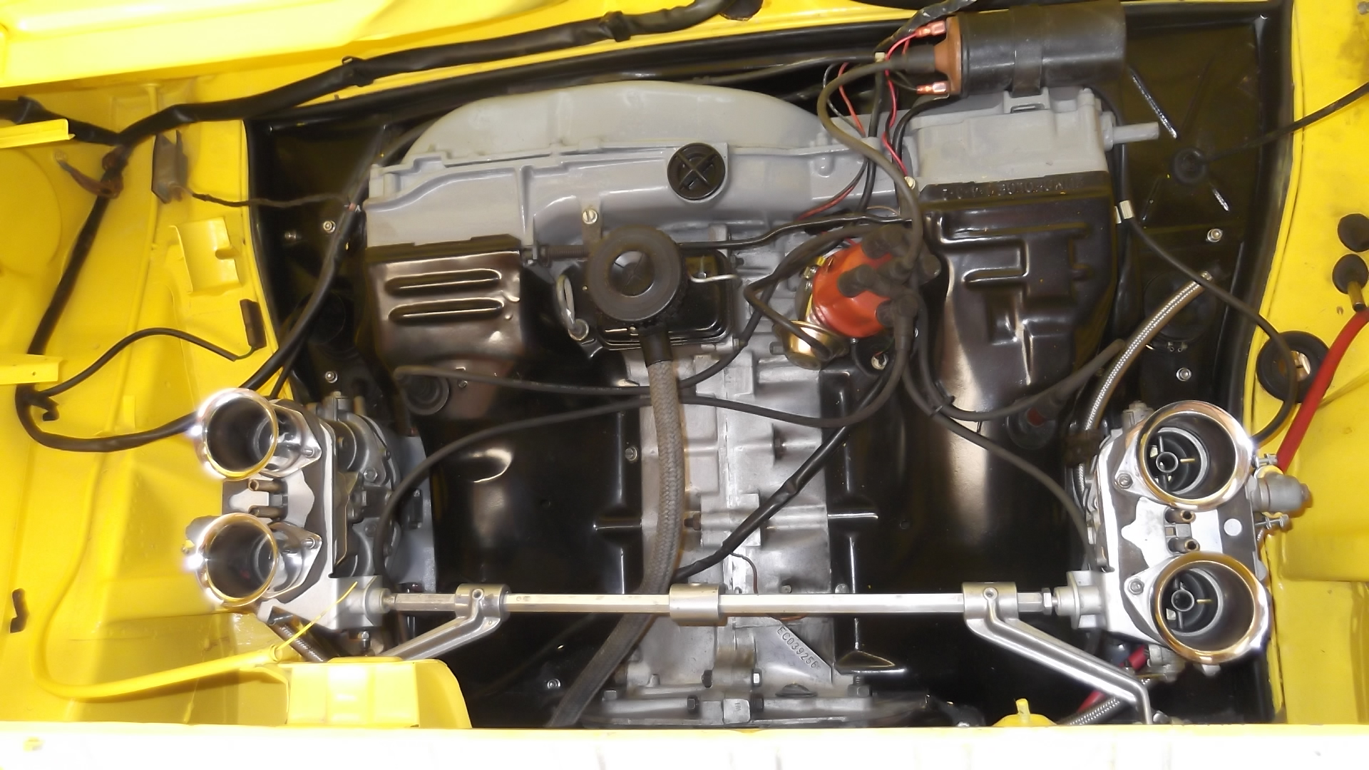

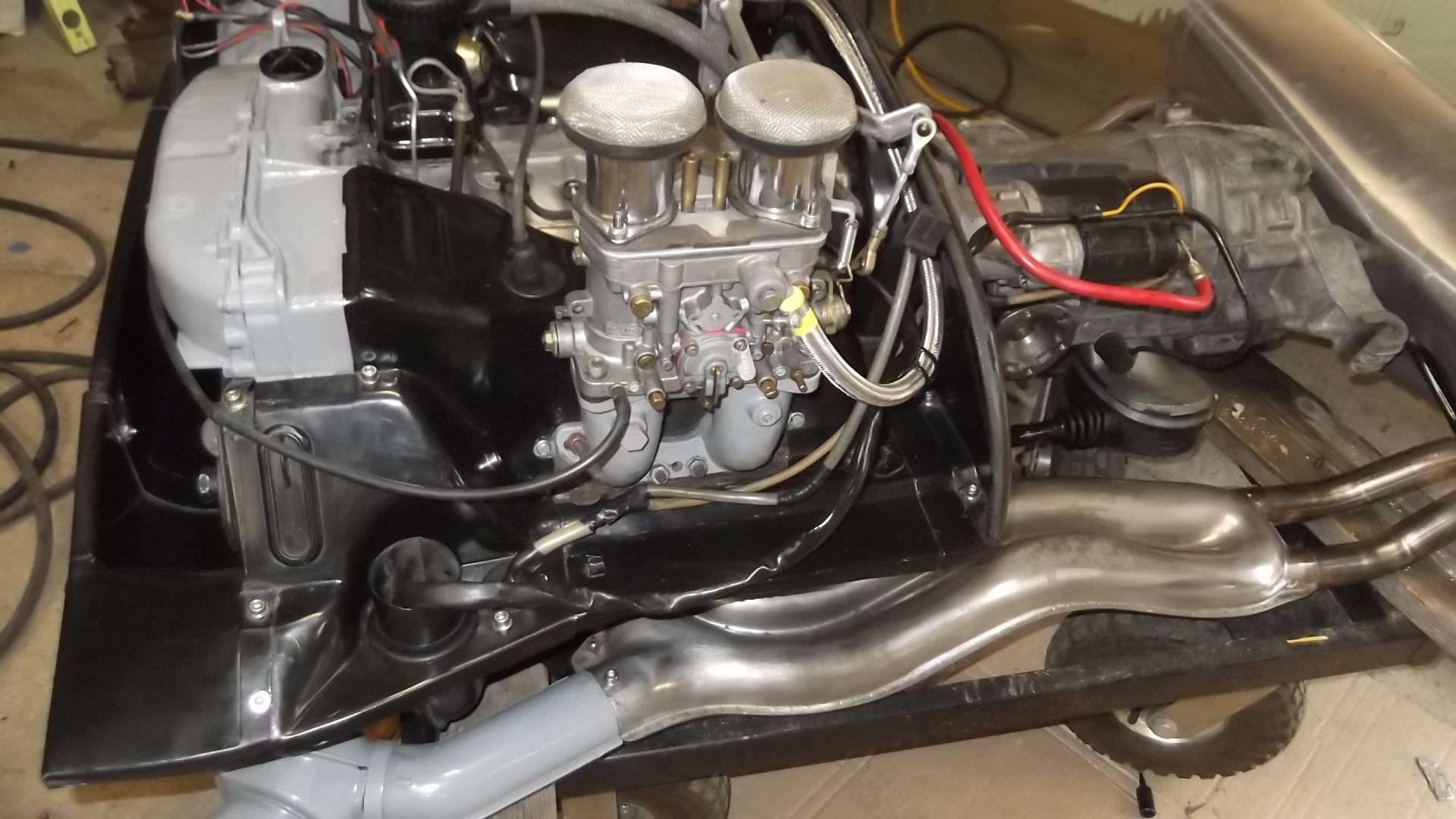

After looking over the other builds here I can see how boring this build is. No dramatic surgery or radical mods. Good thing I not worried about winning any prizes.I think I should pair it up with my engine swap car to spice it up a little.

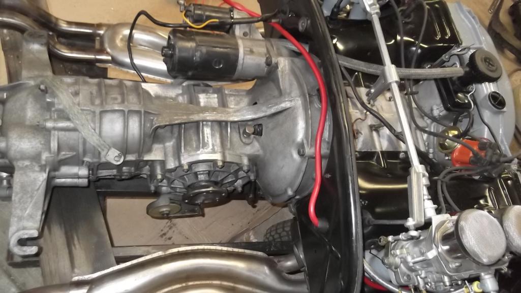

Engine ready to go in after bench testing break in run up and basic tuning.
1.9 with fly cut heads, mild cam Dellorto 36s with 29mm chokes single vac. dual advance dizzy with Pertronics, full stainless exchangers and a header on the back.
in there
top view
I've had and built so many of these it's like sleep walking I'm a 914 zombie just in time for Halloween

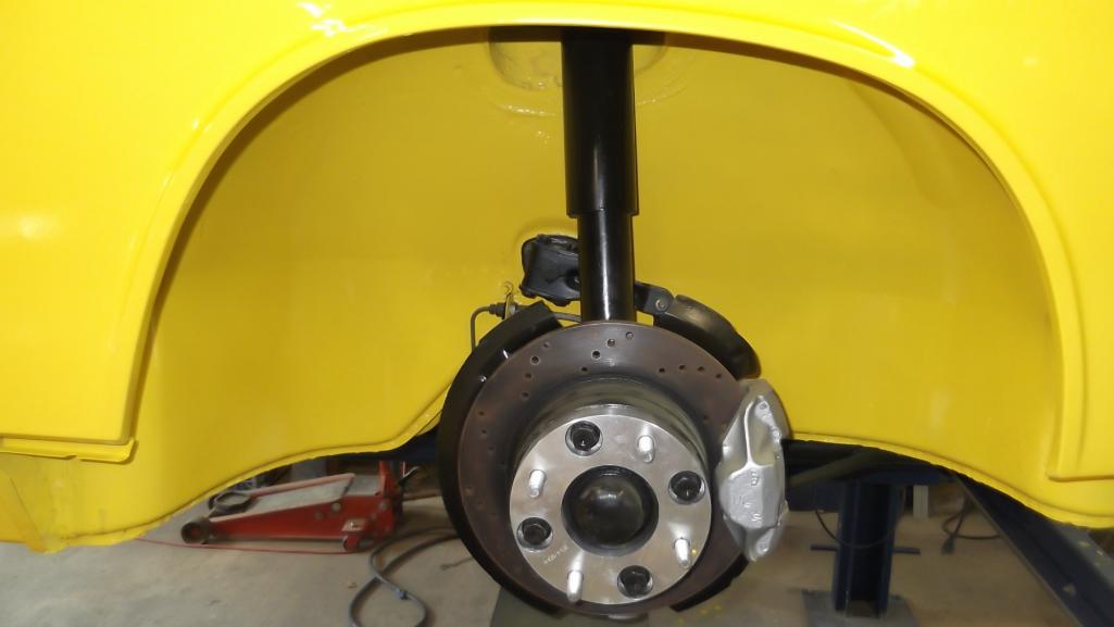

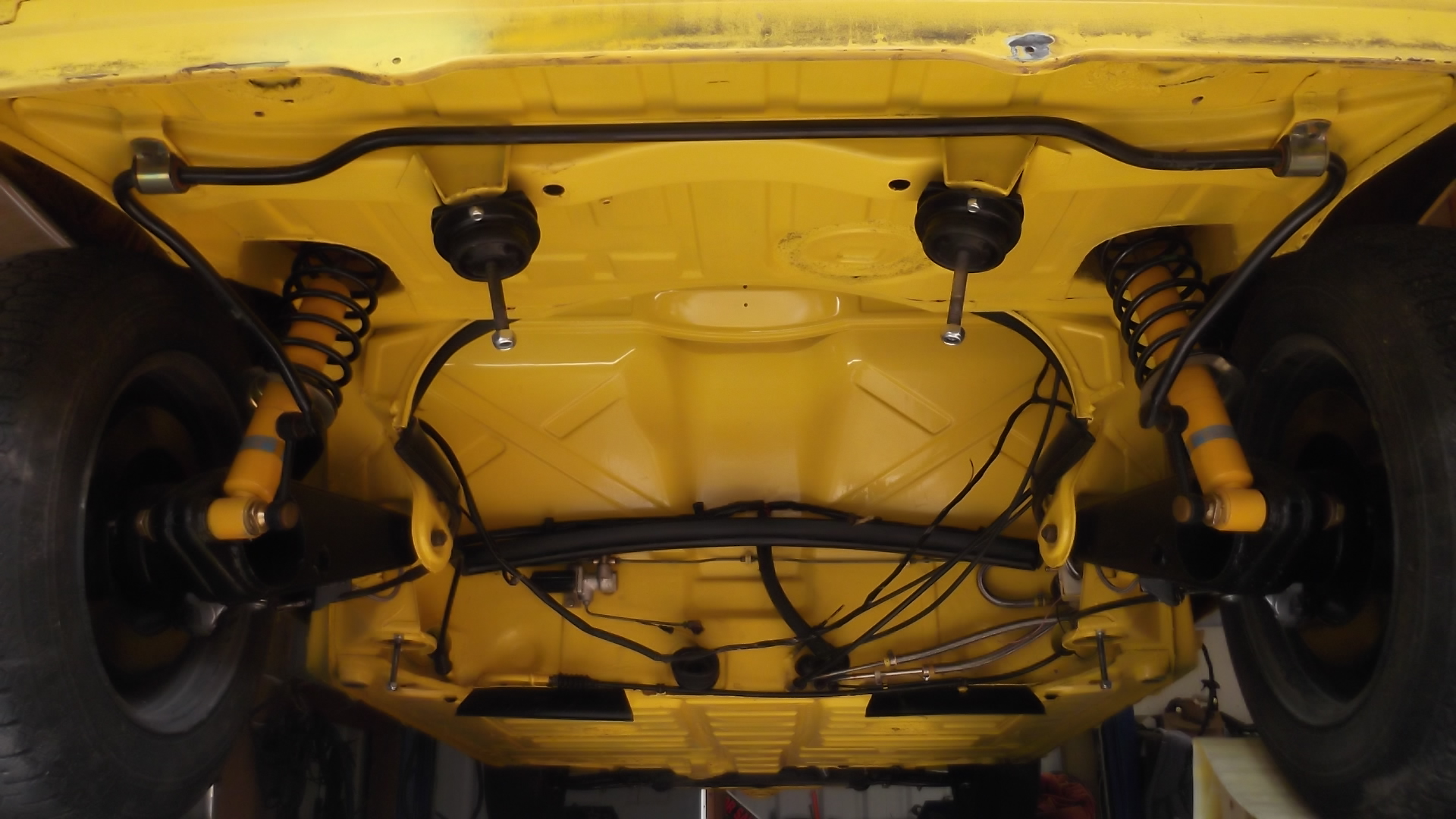

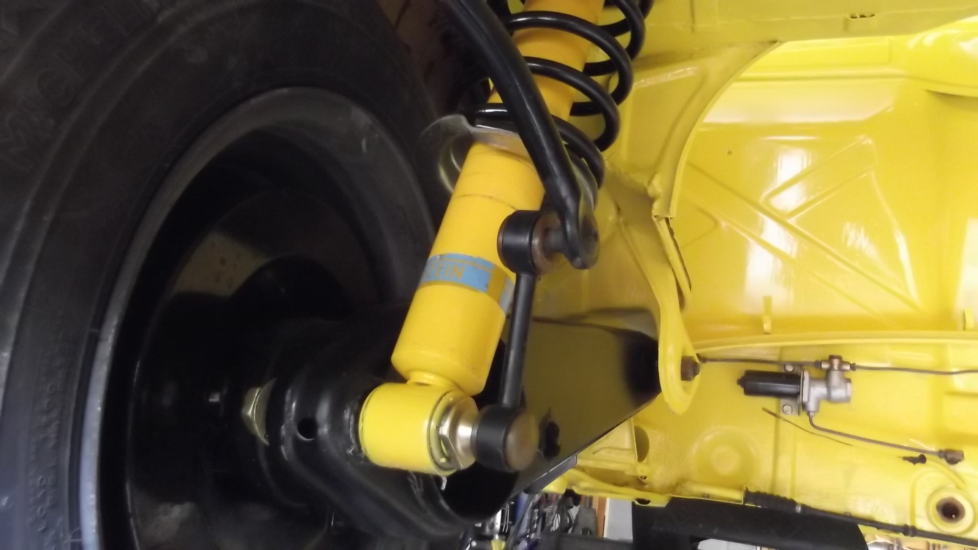

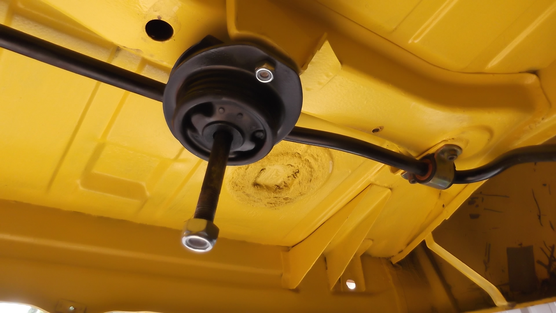

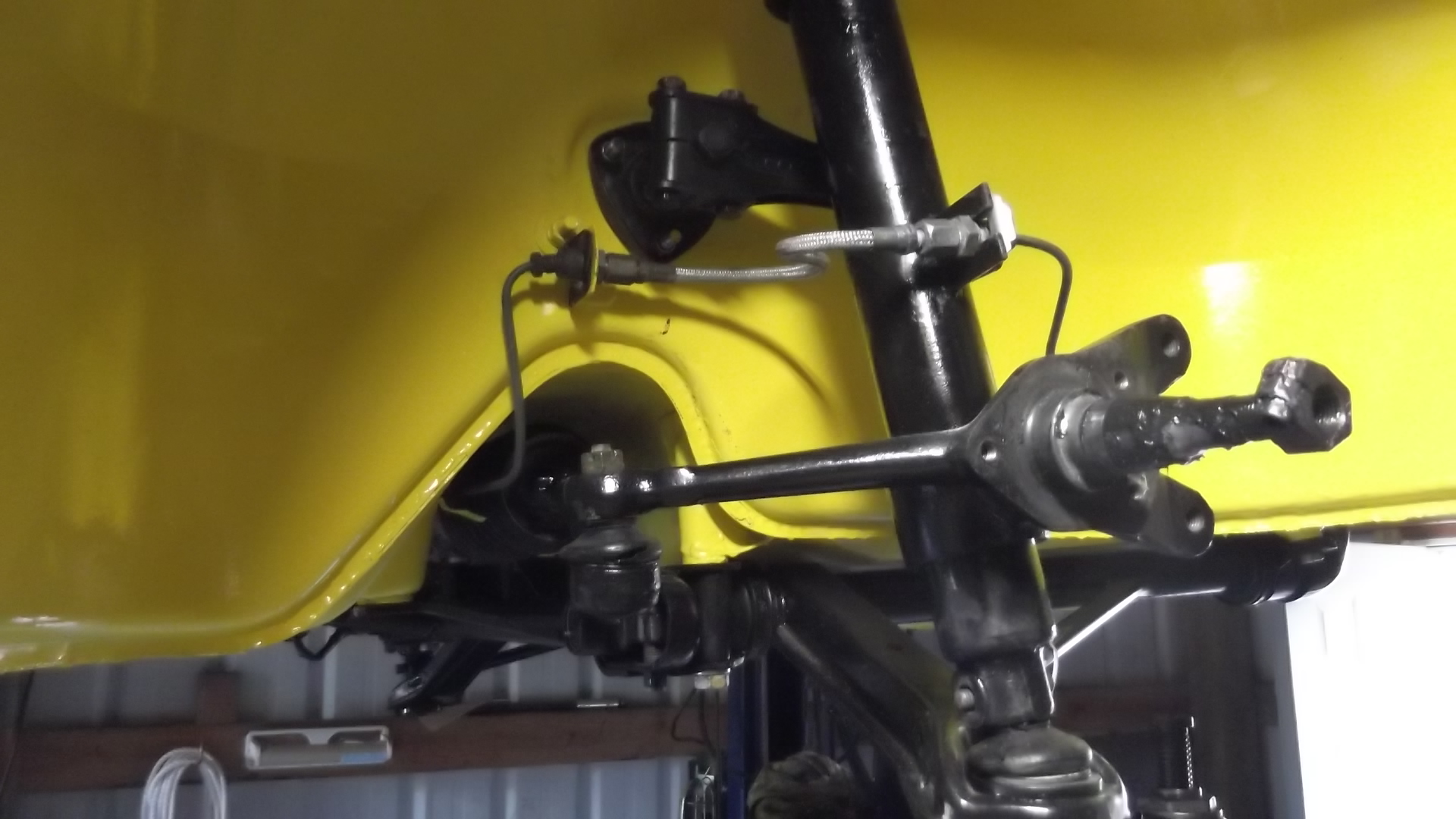

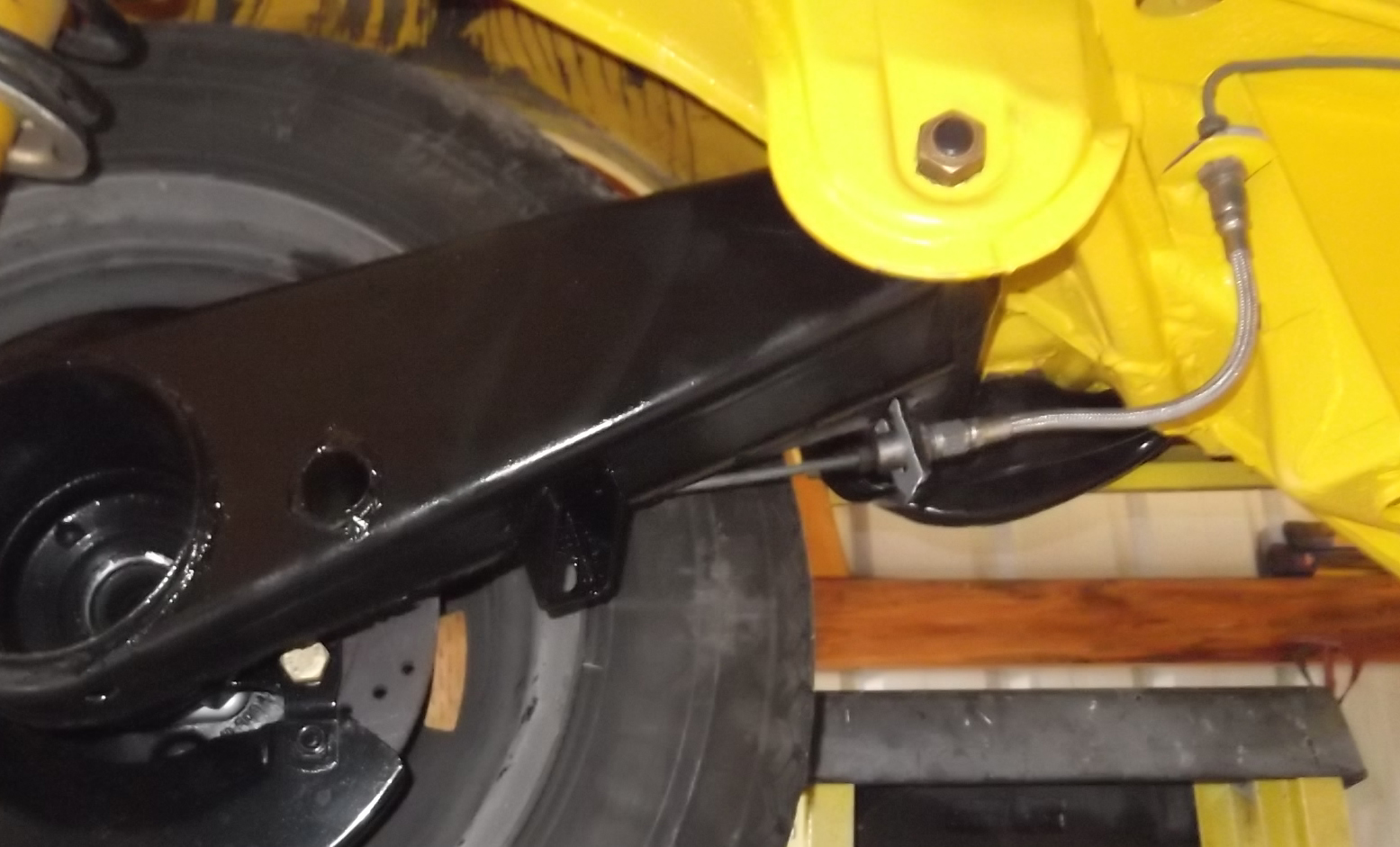

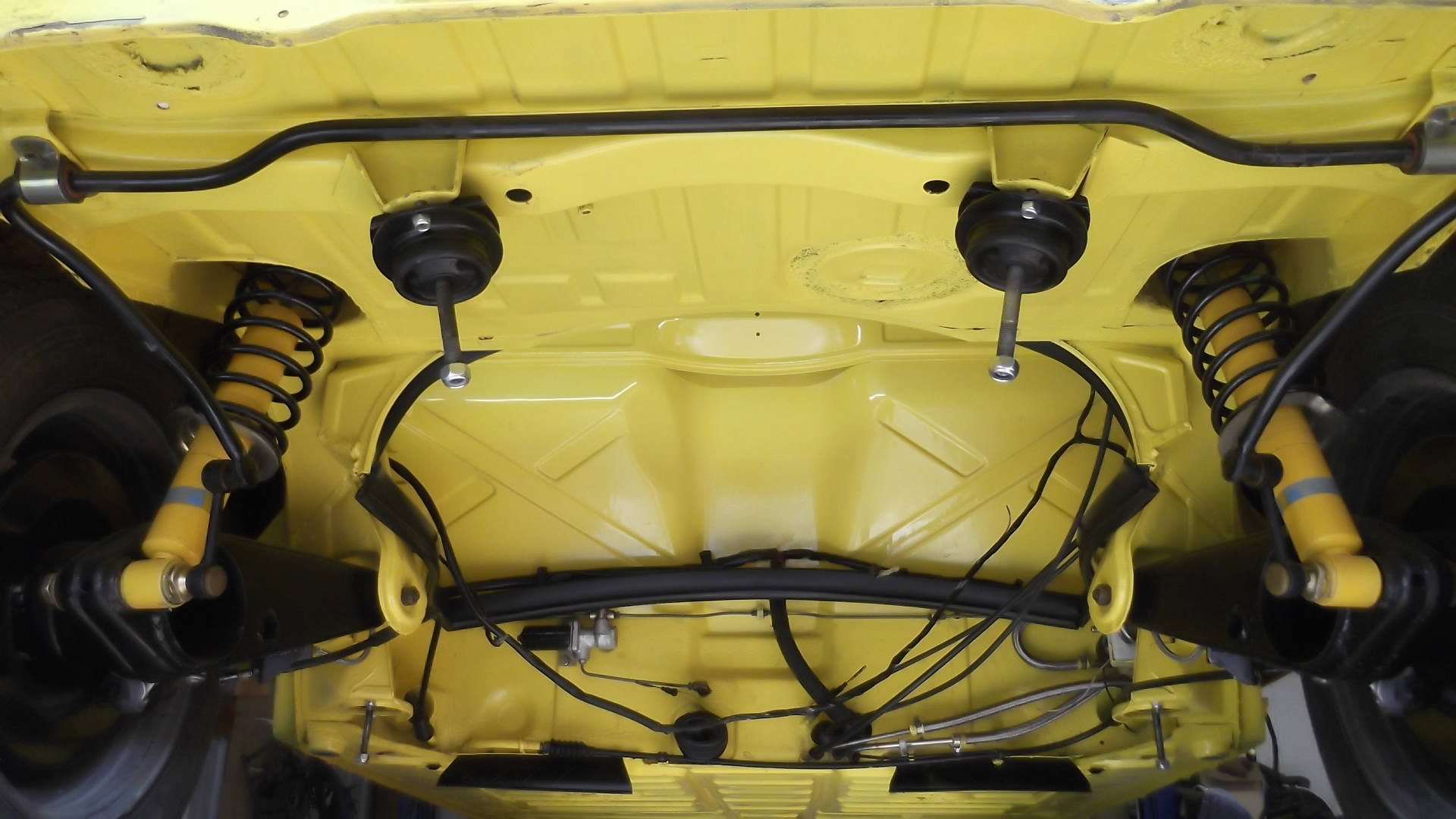

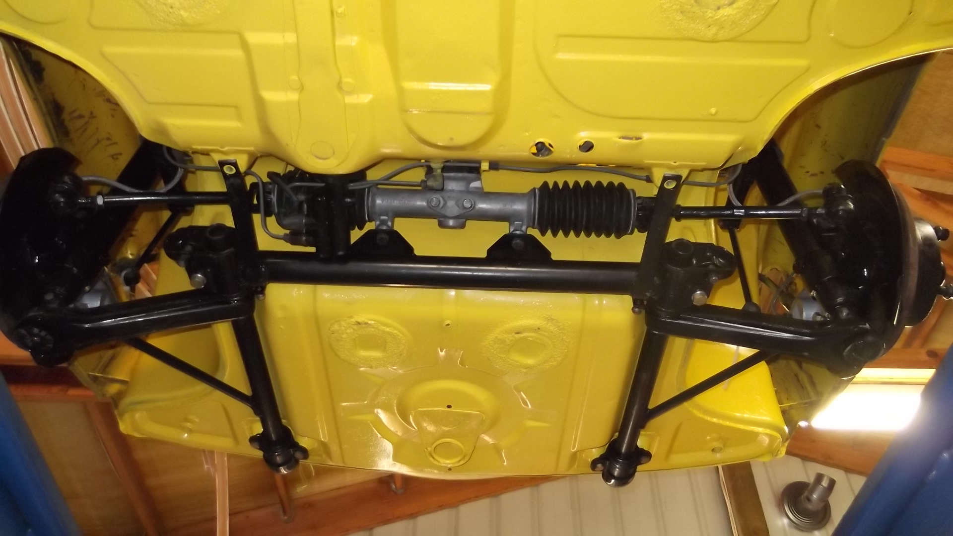

Suspension and brakes.
Adjustable Bilstiens, drilled rotors, 19mm master, stainless soft lines, front and rear sways, graphite poly bushings, new stuff everywhere.
Crap I cant find the pics I'll add more later.

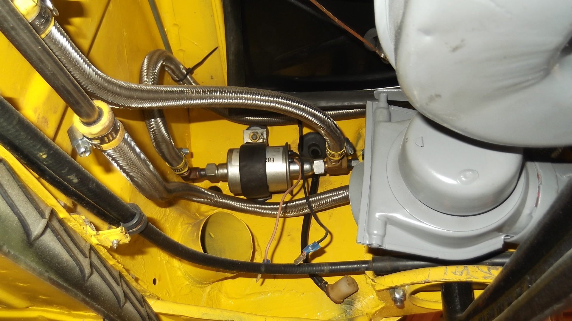

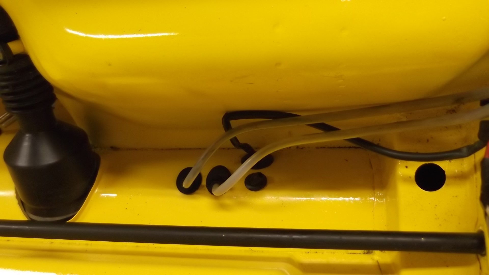

Steel fuel lines and other bits installed.
Fuel pump and filter in stock locations.
Using a return flow set up 4 PSI pump with a flow restricting fitting in the return line yields high volume low pressure.
