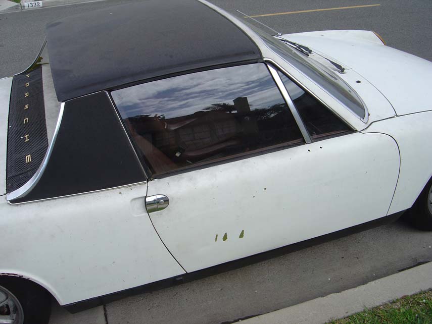

This will be my step by step driveway strip and paint thread. This may not be the way everyone will do it, but this is the way I will do mine. If you like it, you can do it this way also. If not, then you can take it to a body shop and pay $3k to $5k for a paint job. You could also do different variations and run the cost up. I will post what I spend on this entire process. Some have said its like hitting your self in the head with a hammer, ok, this will be my first smack in the head.
First shot, before.

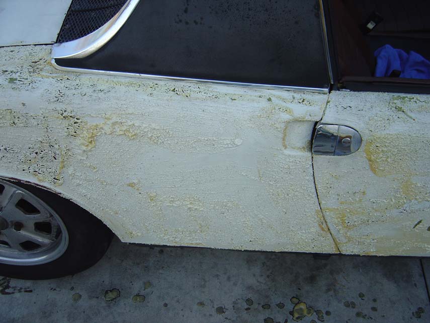

First application of the chemical stripper. Try not to breathe the fumes and dont do this wearing shorts. Splatter will get to your legs. You let it set for about 15 minutes and then using a scrapper, you scrape everywhere you applied the stripper. You will need to do this a couple of times if there is a lot of paint on the car.

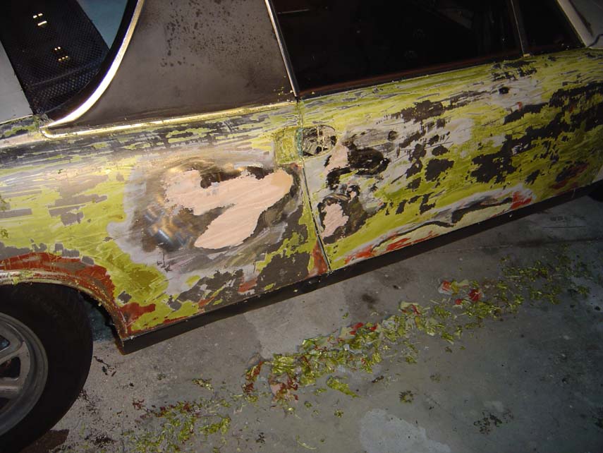

Second coat of stripper, same as the first. However, where ever there is bondo, you will need to remove it all the way. Do not try to just smooth it out and paint over it. The bondo will absorb the stripper and ruin your nice new paint job down the road. Besides, we are going to remove the dents before the primer goes on. You want the least amount of bondo on the car as possible. 1/8" max. With the paint off, you will easily see any and all bondo on the car. Be sure to get all of it off. Places I thought had bondo didnt have any, places I didnt know there was any, there was a lot. Some of it was way thicker than it should have been.

Indecently, the stripper is neutralized in water so when you get all done, hose the car off really well. If you let the stripper stay on too long, it will start to harden and will be difficult to remove. So keep a wet rag handy to wipe off the car when you are done with that panel. I am only doing the door and the rear quarter this round. Tomorrow I will do the front fender and hood and the other front fender. If I get on a roll, I may get the whole car done. Then I get to do the body work. The rear deck is being replaced and the sail panels will be stripped and painted to match the car. Which is why I didn't remove them. I will be removing them tomorrow along with all the other removable parts like trim and lenses.

Scott,
What colors has the car been? I see white and green. And a little red.

Car was tagged Delphi Green with a really bad white spray job over it. The red would be the factory primer on metal parts.

I think Slits is right, the red seems like a filler primer of some sort. It was under the factory green. Along with some geen filler of some sort. Like nothing I have ever seen before. I wonder if the factory used bondo to smooth the cars a little before painting? The rest of the bondo on the car is normal pink stuff, but there are some spots that have a light green filler masking body imperfections.
