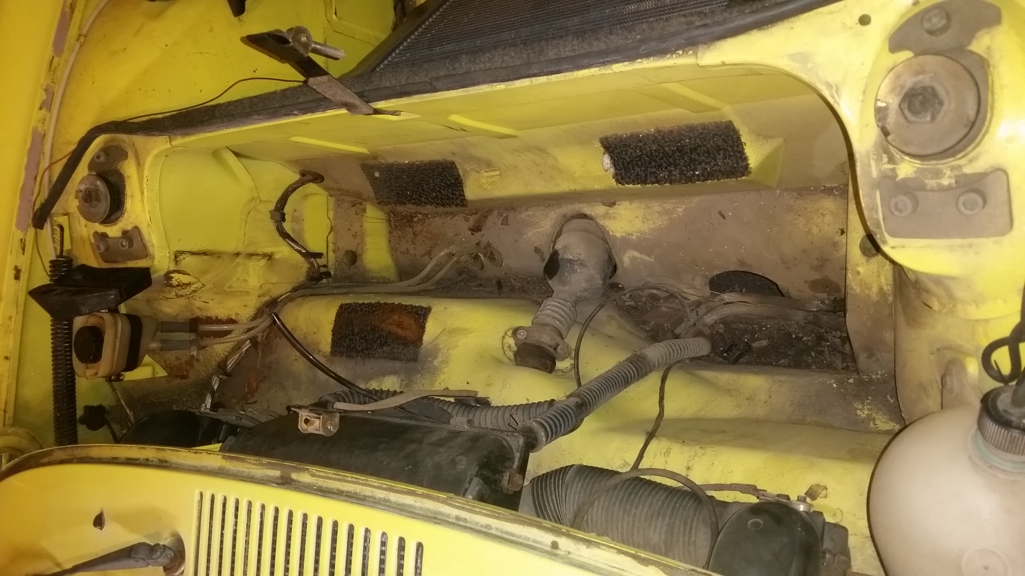

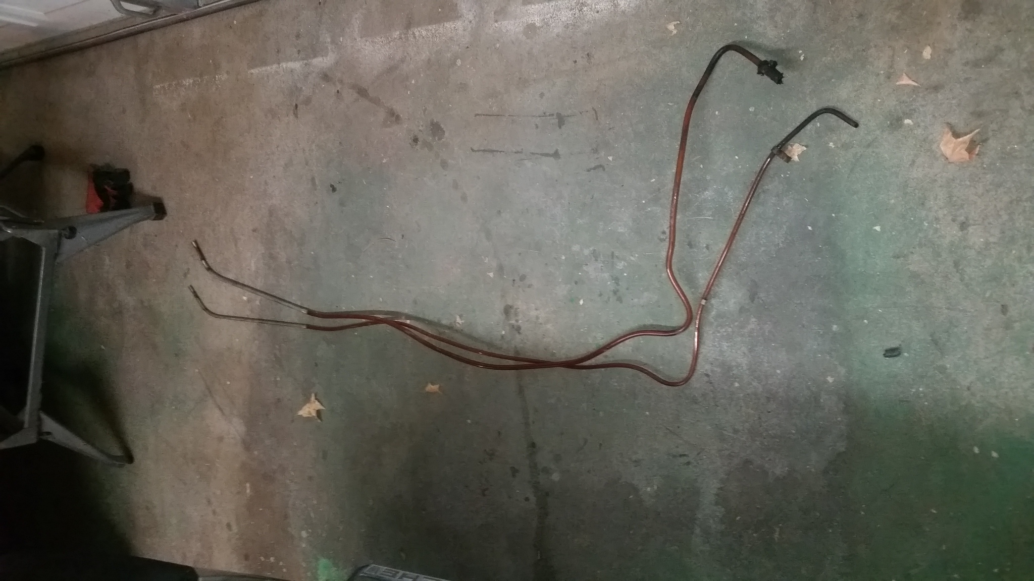

Progress from last night.
Ready for installing the new prebent lines. Going to remove the shifter and rod and the fuel line grommet up front to hopefully make the install easier. I dont anticipate it to be fun...

(IMG:style_emoticons/default/popcorn[1].gif) Were the OE plastic lines still good? Mine were. WD40 that front grommet and they will slip right thru w/o effort. Are you using Robert's or Chris' lines. Robert has a "how to" video for his lines. Probably the same for Chris'. 26 hr's huh? That's old age for ya. I take that long to decide if I want to, anymore. (IMG:style_emoticons/default/sad.gif)

Plastic lines looked good. Fabric lines were ready to explode.
To many 914 fires for me to let a 914 go through my garage without new fuel lines...

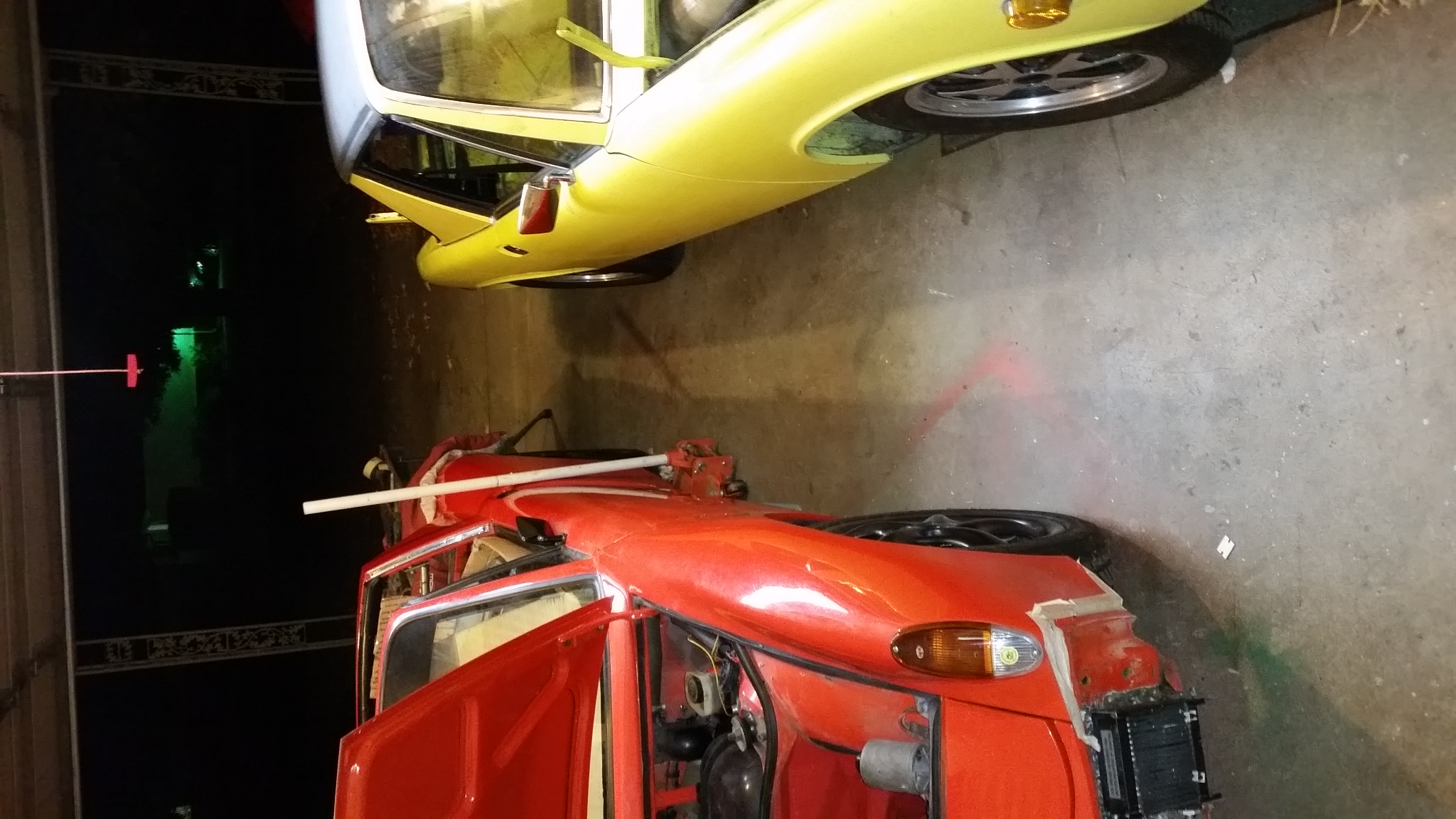

In response to the oil cooler question
http://www.914world.com/bbs2/index.php?s=&...t&p=2206628
Regarding time frame, I am pretty confident in my time. There is no fabrication involved, I have this figured out pretty well, I mean I uninstalled everything from the orange car(mine) in 4 hours, I have a detailed spreadsheet with hourly figures on what things will take me. And I have done this before multiple times... There is wiggle room figured in. (IMG:style_emoticons/default/sawzall-smiley.gif)

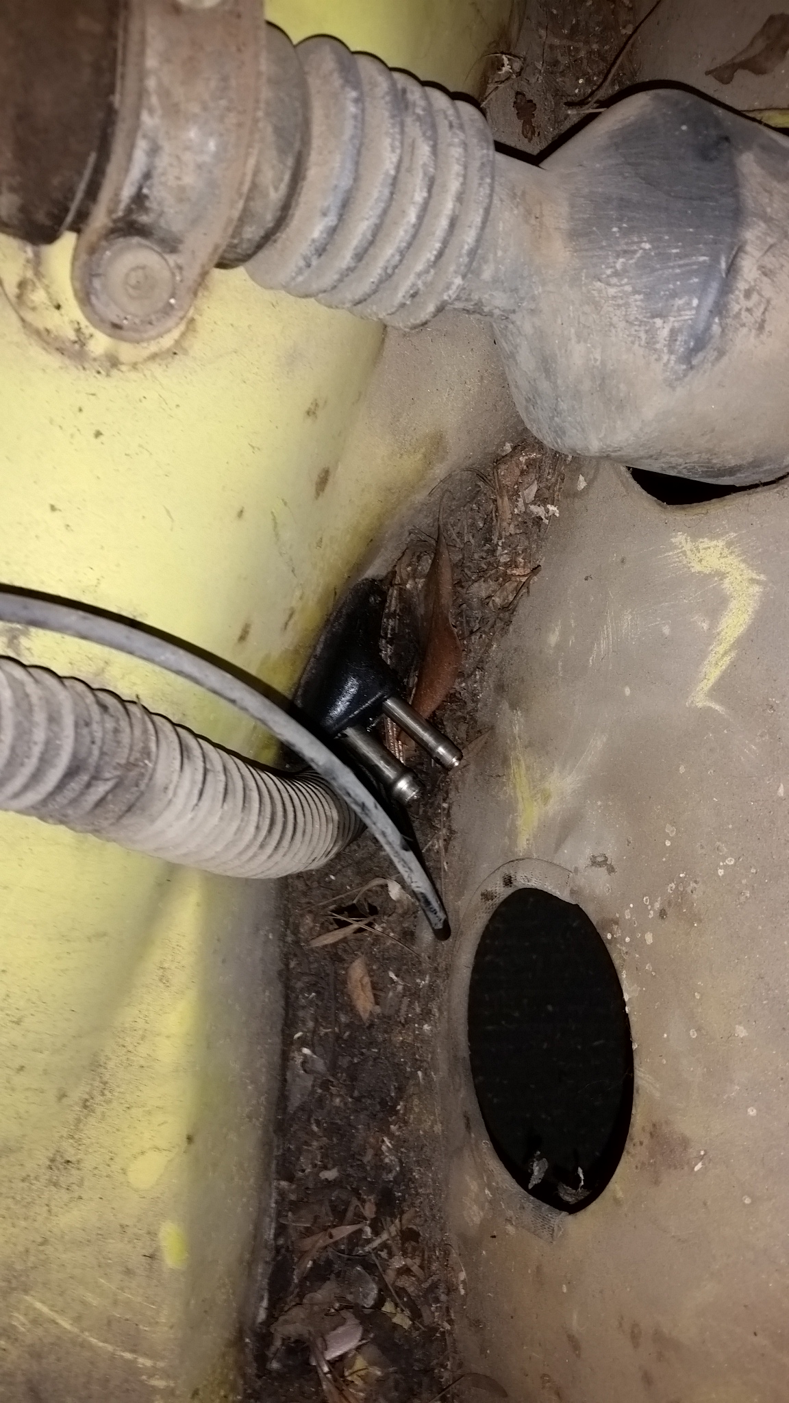

Progress from tonight,
Fuel lines in
Just kidding (IMG:style_emoticons/default/smile.gif)
Still have about 45mins to install the rubber lines tank side and put in the tank, then I can cross that out. Right on schedule (IMG:style_emoticons/default/smile.gif)

on my V8 car i cut that hole below the fuel lines much bigger so i can access the fuel lines easier and get clamps on easier.

I will likely take the typical route of making the hoses ~ 2.5' long and coil it up under the tank, this way I can remove the tank and set it on top with the hoses connected.

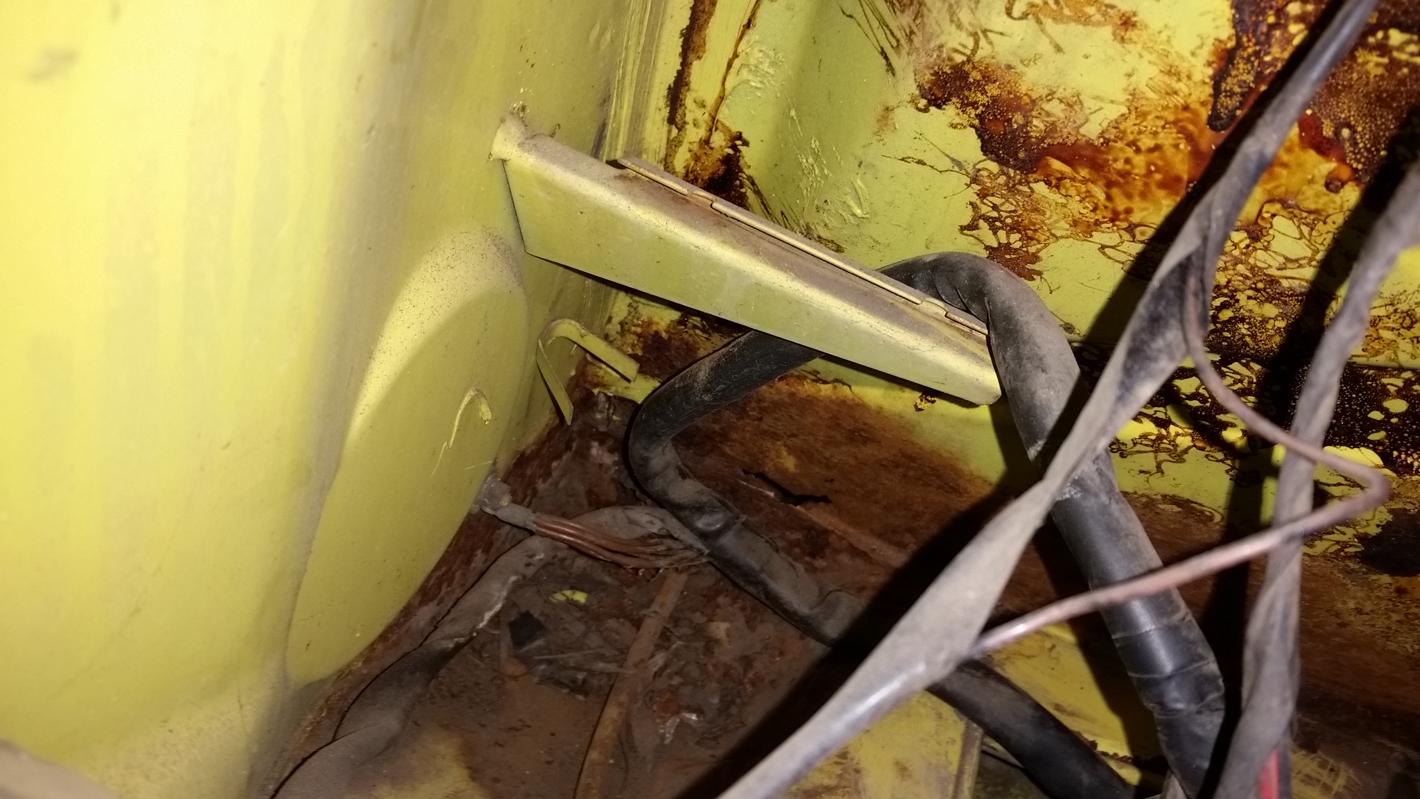

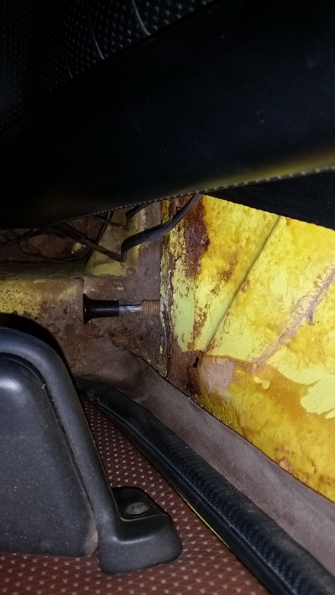

Firewall rust (IMG:style_emoticons/default/sad.gif)
The owner and I are discussing the possibility of me doing the rust repair.

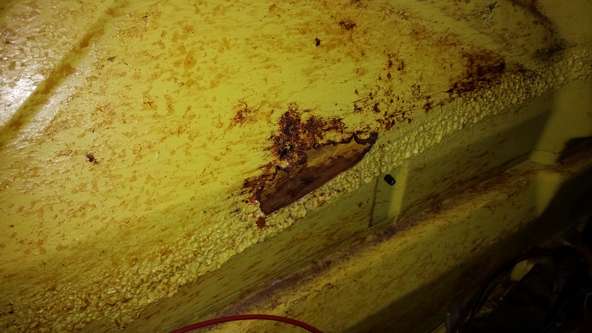

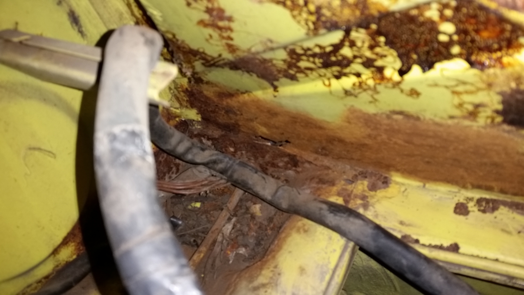

More..

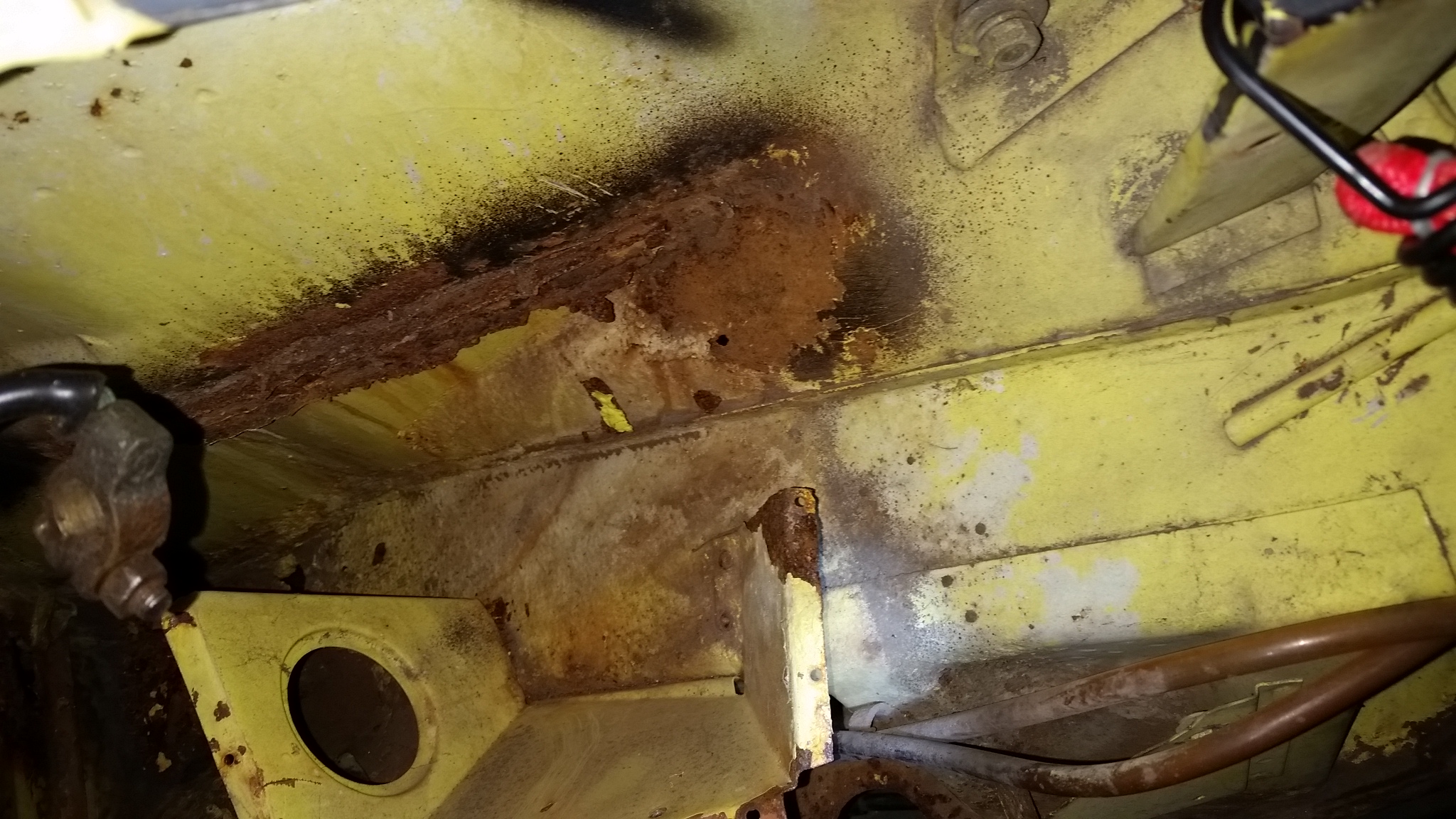

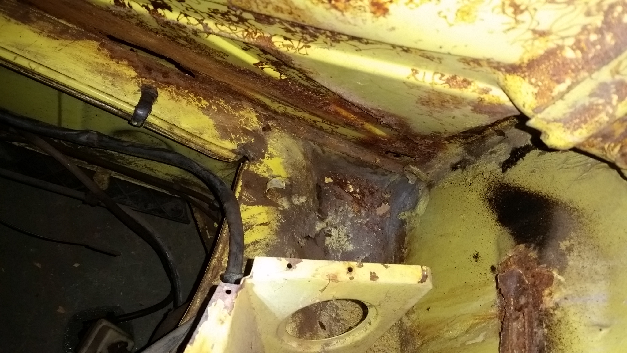

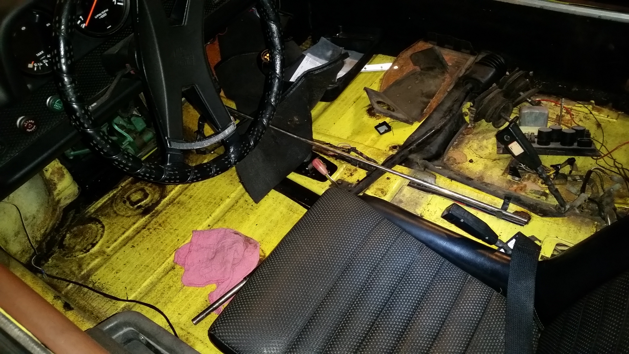

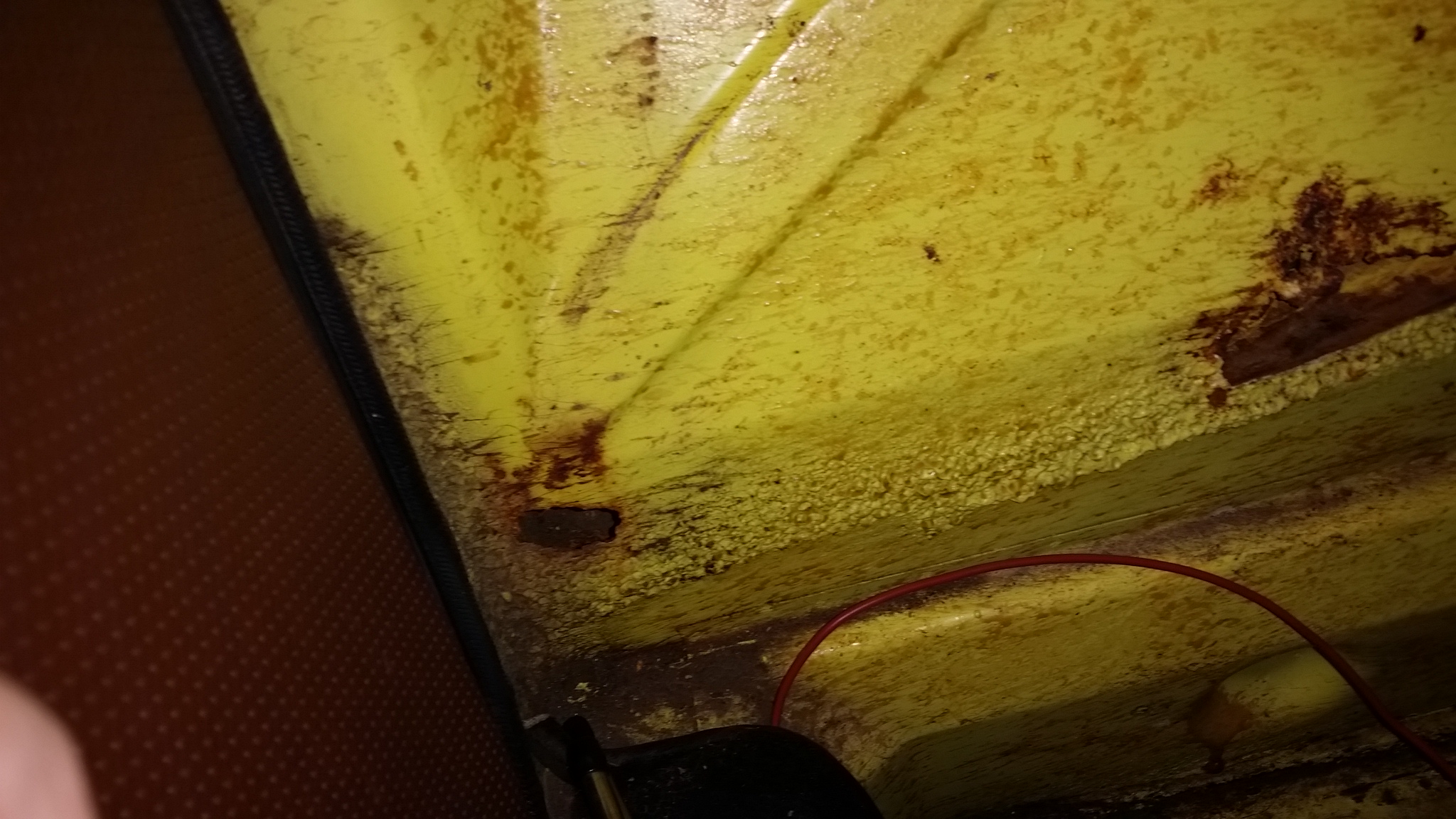

A bit more digging of the rust. As I anticipated it was a bit more than what you could originally see. I see the longs are going to need some work as well. The firewall near the drivers side is pretty bad.
Drivers side below the battery tray
