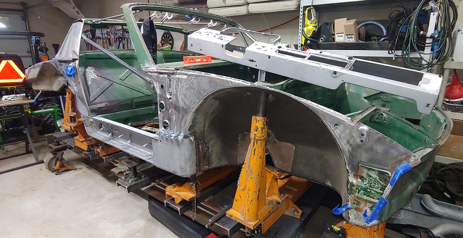

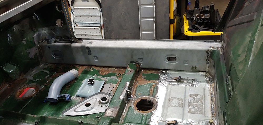

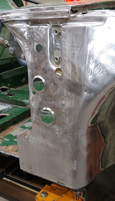

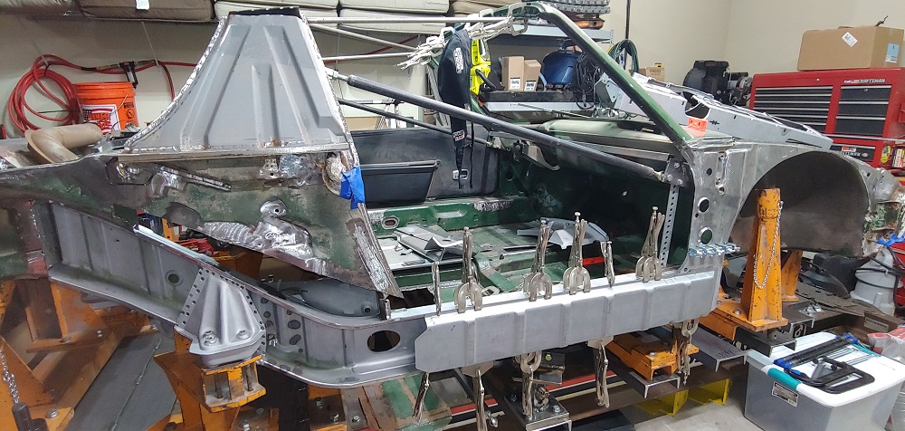

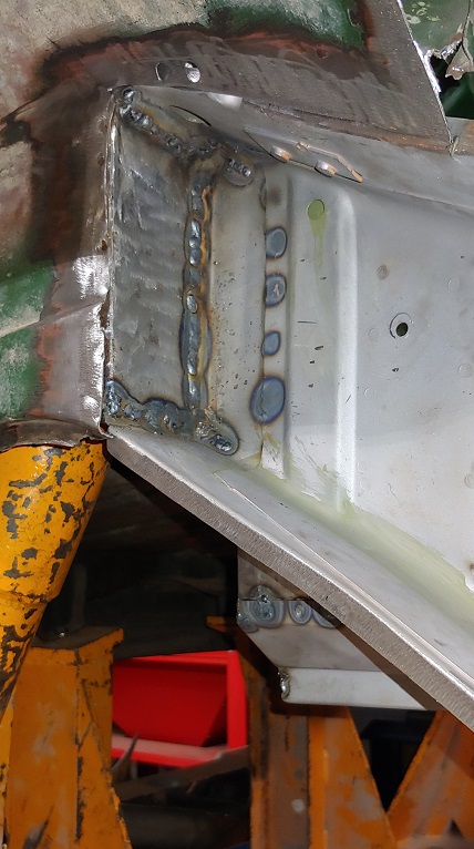

Got the right inner fender patch in. Installed the nos right long and test fitted the inner rocker. I need to make some final tweeks to the long prior to welding it in.

QUOTE(930cabman @ Mar 30 2021, 06:34 AM) *
Lookin good Luke, how is the new spot welder working?
Works great. I have a few plug welds to do as well. I'm gonna try and use the spot welder wherever I can to make it look factory. I got a set of 12" CLOSE QUARTER WELDING TONGS but still having a clearance issue at the front fender channels. (IMG:style_emoticons/default/dry.gif)
I may have to modify one of the welding tips.

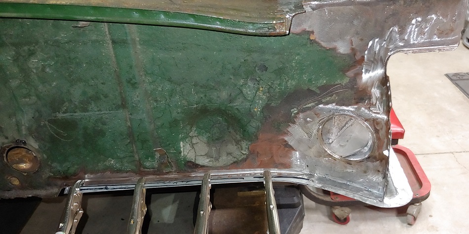

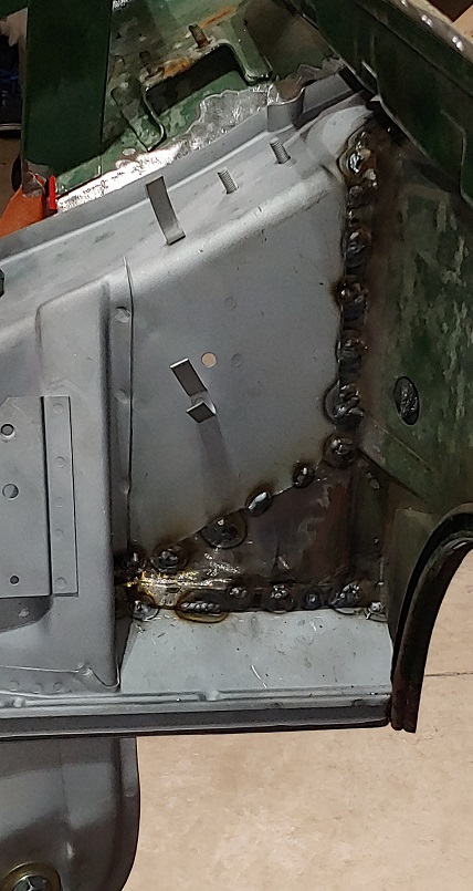

Patch panel is all welded in and also started the pass side floor pan install.
Ran out of gas for my mig welder so I'll get the tank swapped out tmrw. (IMG:style_emoticons/default/welder.gif)
How I hate grinding but turned out pretty nice.

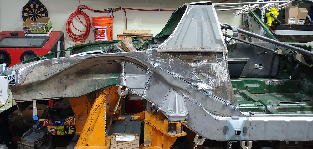

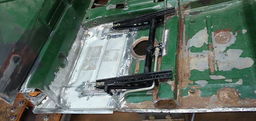

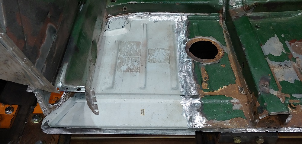

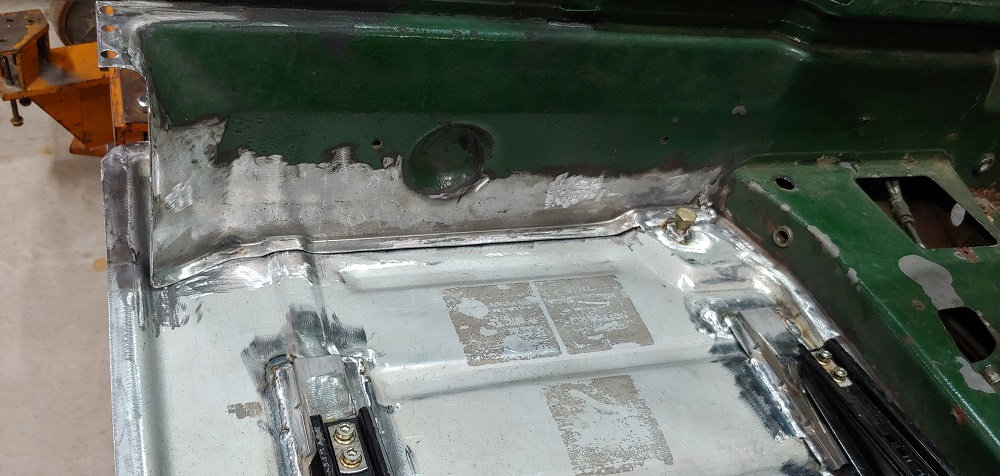

Got the pass floor pan done. Installed the adjustable seat brackets, welded in the lower inner and outer fire wall repair patches. Check that off the list.

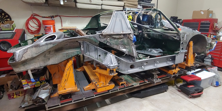

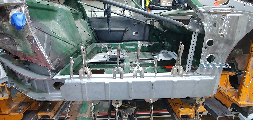

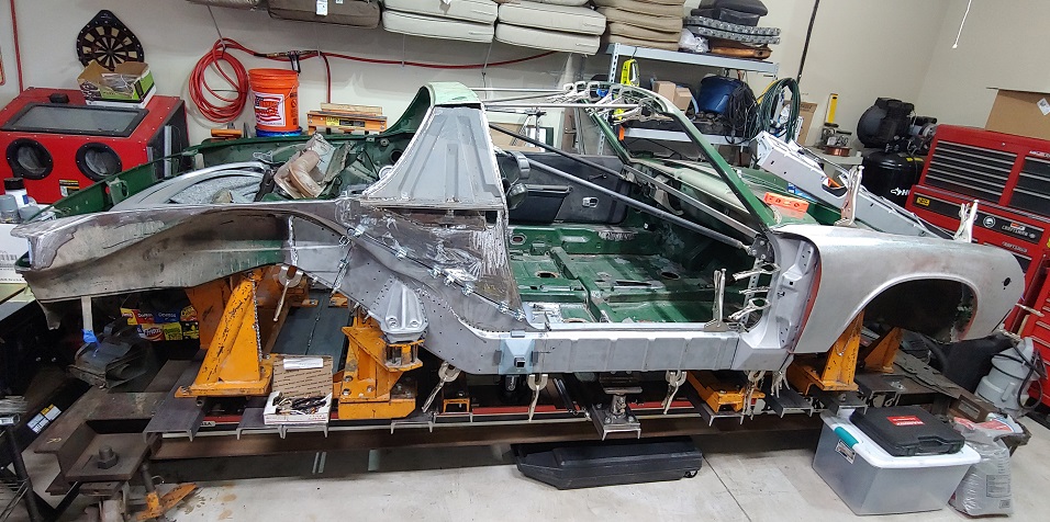

It's official the right long is in... (IMG:style_emoticons/default/piratenanner.gif)
Good thing I have the bench fixtures while doing this.
The whole rear portion was off by a good 1/4'' to the outside and 1/2'' to the rear.
After about an hour of dealing with the issue the welding started. (IMG:style_emoticons/default/welder.gif)

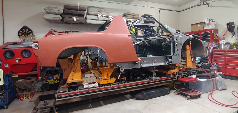

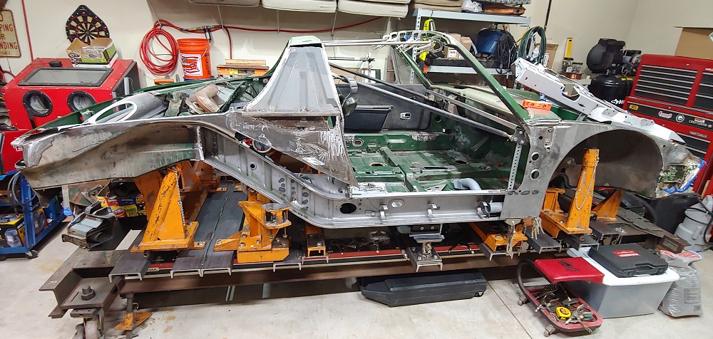

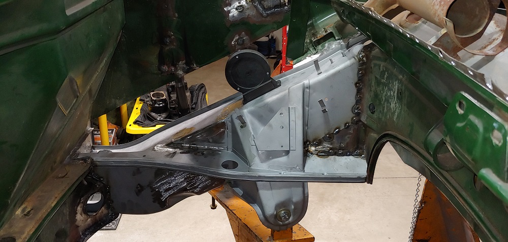

Tested fitted some panels this morning. Looks like everything needs to be shifted backwards 3/8'' . Starting to look like a car again.

@Luke M - I am now using the picture right above this is my screen saver. That is the coolest picture I have seen laying the chassis bare. Outstanding work! (IMG:style_emoticons/default/beerchug.gif)

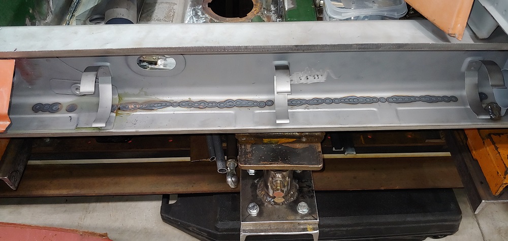

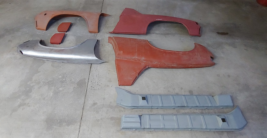

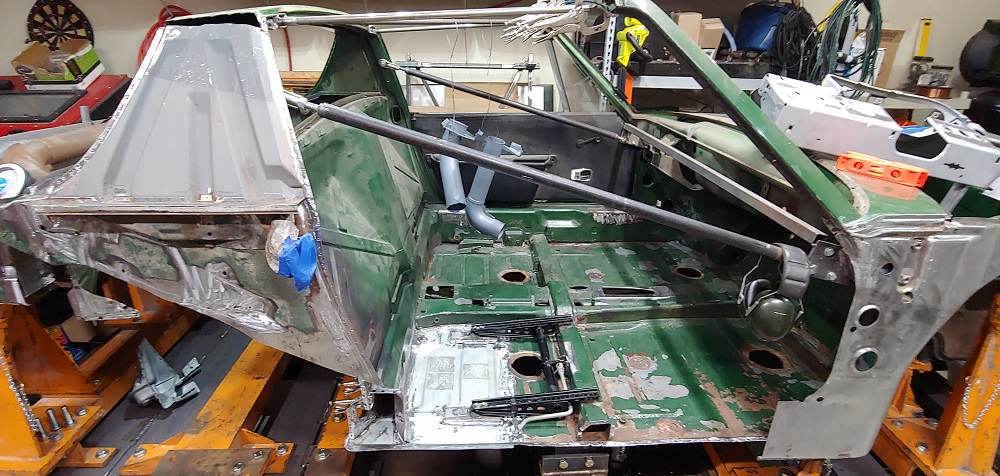

Thanks Guys. Working away here today. Started to spot weld the floor pan to long. Michael I watched your 6 being worked on by Kent. I got a lot of knowledge by watching how Kent removed the panels and fitted them. Today I spent several hours test fitting the NOS panels and adjusting the inner fender/inner rocker. First I have to seal the inside of the long then weld her up. (IMG:style_emoticons/default/welder.gif)

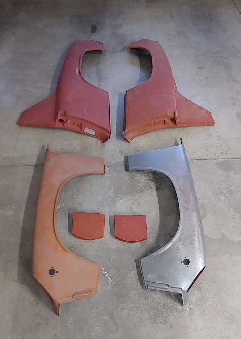

So Glad it made It.. Undamaged.. nos flairs are next ?? offers..
