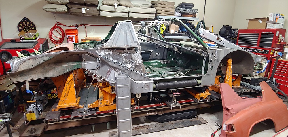

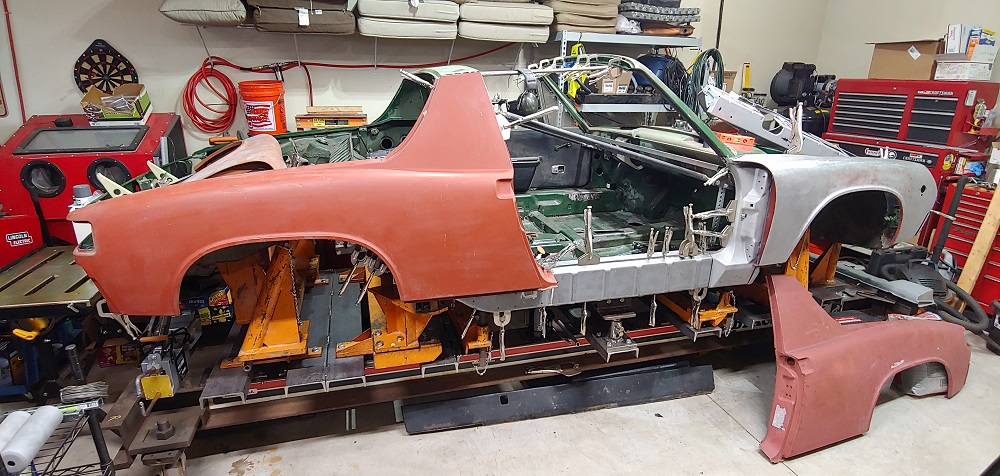

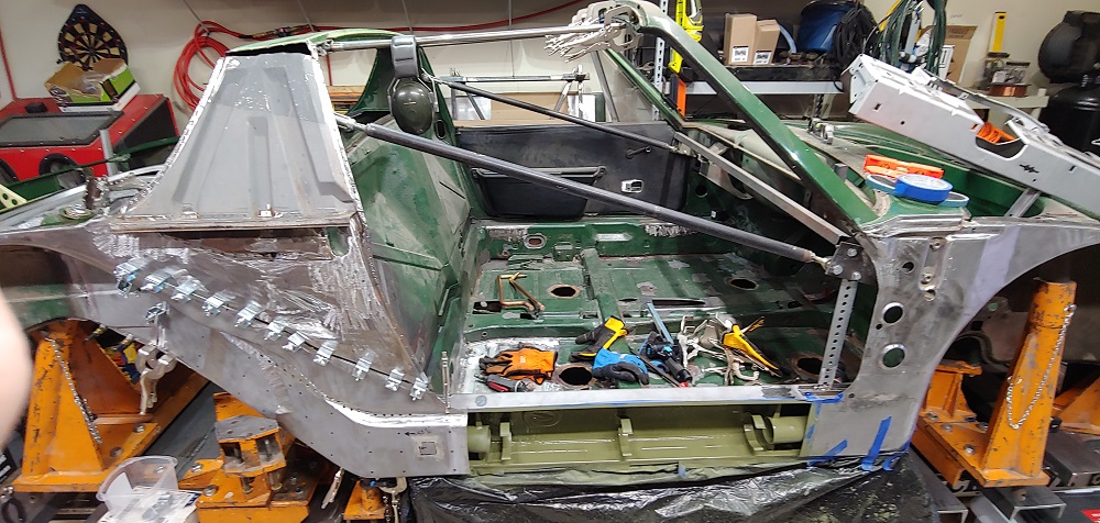

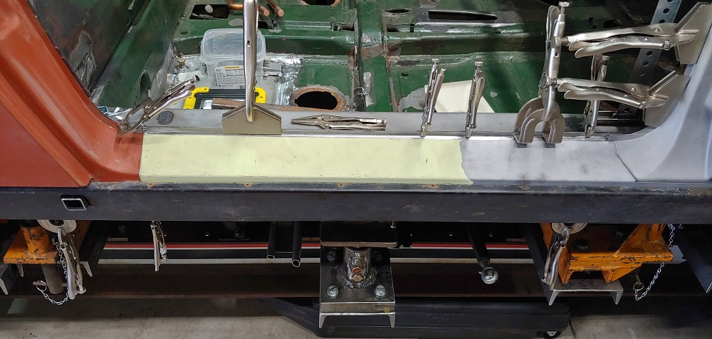

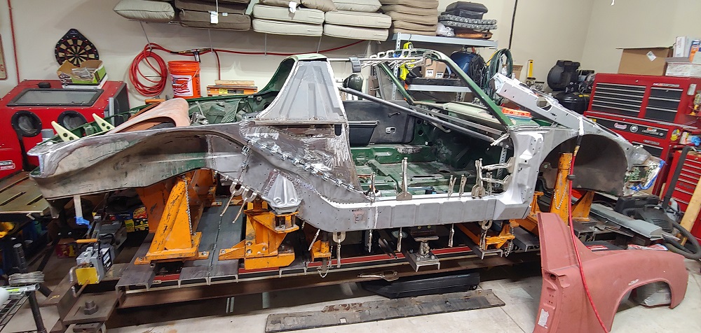

A few more things checked off the list. Installed the right rear triangle, sealed inner long, and the backsides of the sheet metal that will not see day light. If I have time tmrw morning I'll test fit some panels if not it'll have to wait until Thursday.

Hey Luke didn't the right long come complete with the outside suspension console ?

QUOTE(rgalla9146 @ Apr 7 2021, 04:48 AM) *
Hi Rory,
The right long came with the inner (engine side) suspension arm attached.
The outer console is attached to the inner fender portion. I have a pretty nice and rust free outer suspension console that's going back on. The org console was badly rusted out. I'm heading out in the garage soon here to test fit the panels. I want to measure everything then on Thursday I'll start welding everything up.

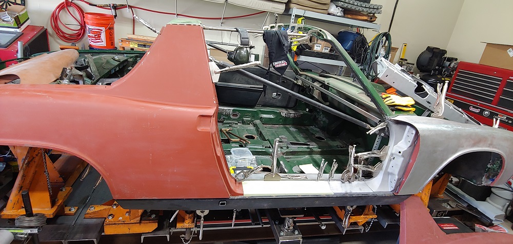

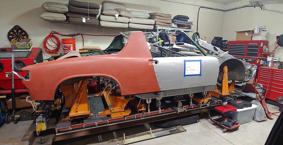

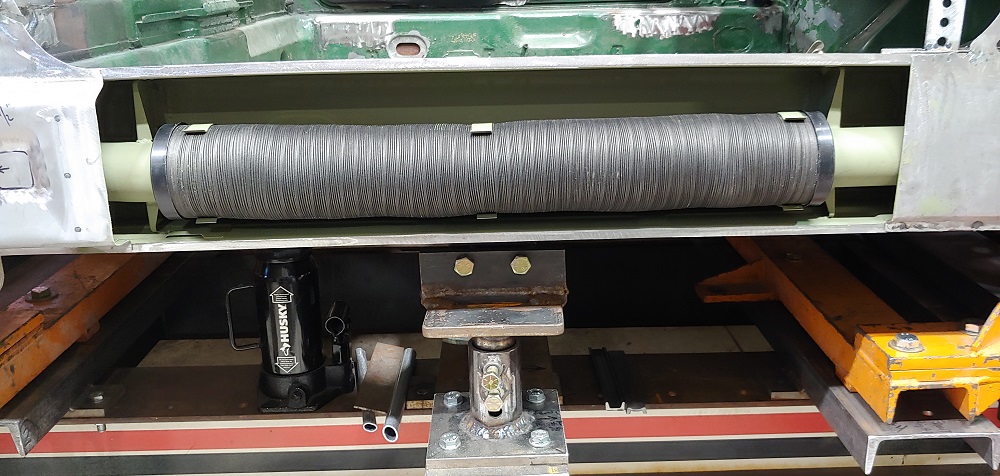

Installed the new heater tube, and tested fitted some panels. It's starting to look like a whole 914 again. That's all for today.

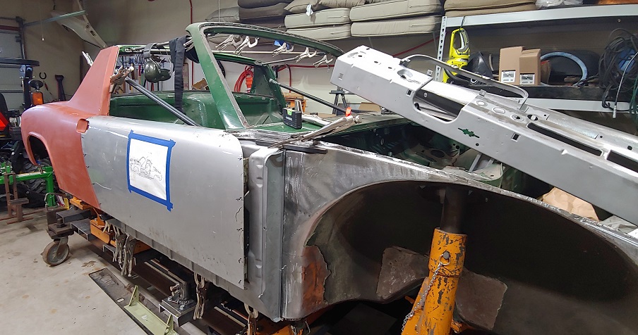

I did run into a snag today while test fitting the outer rocker and door threshold sill.
The door sill needs to be adjusted so I can move it forward 2 mm. Then all the upper rocker mount holes will line up and the sill will be in the proper location. Right now the most forward part of the sill is too far away from the door post/lower fender section.
The lower rocker to inner rocker mounting holes were slightly off so I addressed that.
Then I found the RD inner wheel housing didn't have the lower mount/hole for the outer rocker. So off that needs to come so I can drill and weld a nut inside it. Good thing I was checking everything before I started to weld everything up. I deal with that on Sat.

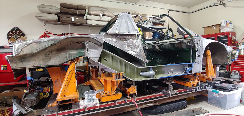

Well the last several days I've been fighting with the darn door post. The measurements went way off and couldn't figure out why. I had my son help me with installing the door and figured out the issue. The inner rocker kept dropping down under the door post which in return the door post also dropped enough to screw things all up. Now that that's figured out, I have to figure out a good way to keep everything in place so I can test all the panels prior to welding. 10 days to blasting party so I need to get it done.

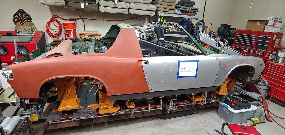

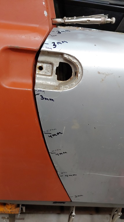

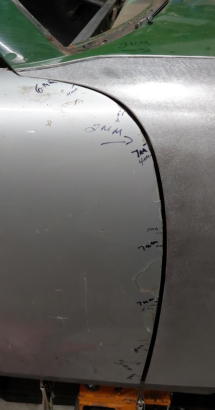

What a PIA it is to line up all the panels. I'm getting close but still off 2 mm at the bottom of the door. I'm trying to set the door to q-panel and door to front fender gaps to a max of 5 mm all around. Seams like that's gonna be harder then I think. Right now I have a 4 mm gap but opens to max of 7 mm and as tight as 3 mm. The pics posted are of the measurements prior to cutting of any sheet metal and right now. Thick sharpie is prior and fine sharpie is current measurements. I believe I can get a 5 mm gap at both of the door bottom ends. See how Sat turns out. As of right now the rear q-panel is set, outer rocker is set, jack post set, door sill is set, front fender is set, inner rocker needs a slight adjustment and the door post needs to be moved forward another 2 mm at the bottom only.

post Apr 16 2021, 07:20 PM
Post #180
Michael
Posts: 10,771
Joined: 1-November 08
From: Auburn, CA
Member No.: 9,712
Luke, those gaps, as they sit right now, are probably better than most 914's on the planet. (IMG:style_emoticons/default/beerchug.gif)
