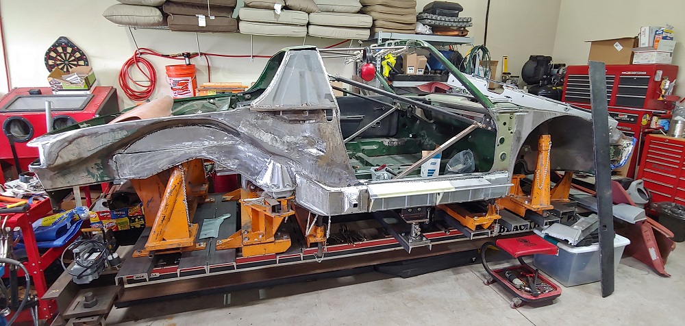

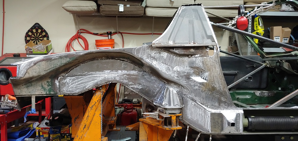

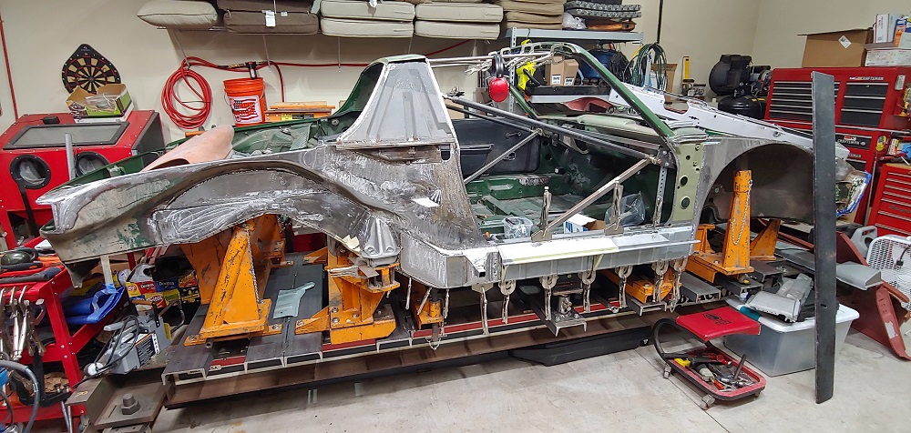

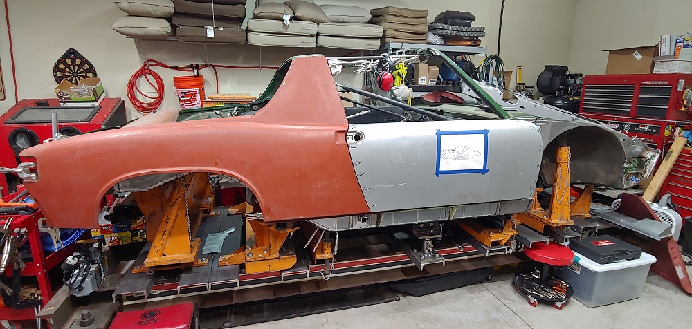

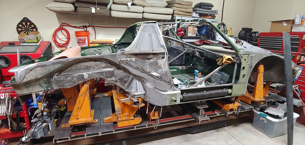

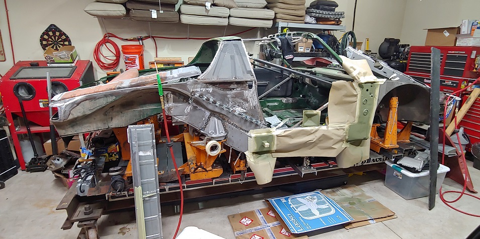

Working away here.. ready to close up the right long for good. I lost count on how many times I tested fitted all these panels. I did it for the last time this morning. Started welding things up. Got to love spot welders. I spot welded the door sill on the inner rocker prior to welding it on the right long. Sealed the internal sections with some Eastwood internal frame coating. My brother dropped his 914 off at my house for the weekend blasting party. That is if the weather co-operates.

Speaking about gaps: You have your car on the "Celette" which is the most valuable thing to do. Is there any experience out there what might happen to the gaps when the car sits back on it´s own wheels? Is there any body sag to be expected that must be compensated beforehand?

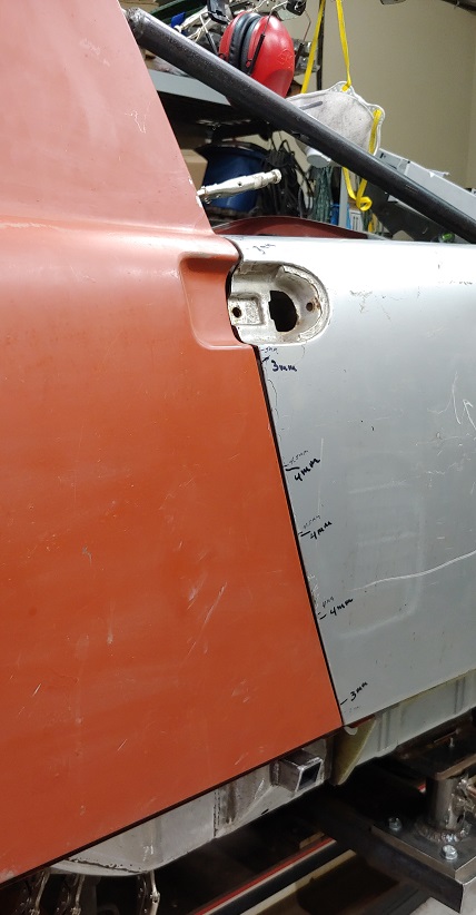

QUOTE(Arno914 @ Apr 22 2021, 12:31 AM) *
Awesome work! (IMG:style_emoticons/default/aktion035.gif)
The bench fixtures do help a lot. I had a small issue fitting the NOS right long in the chassis. Had I not had the fixtures I would've messed up the install for sure. It wasn't off by much but 13 mm here and a few more mm there gets things all screwed up. I had an issue fitting the new NOS door post too. Once I figured out the issue there the door gaps were spot on. I get a 4 to 6 mm gap now. I believe once the chassis is on the ground the gaps will show very little movement or at most 1 mm which gives me a 5 mm door gap.
I'm also installing a GT kit along with the RD long frame stiffeners. I also plan on stitch welding the seams just to strengthen the chassis.

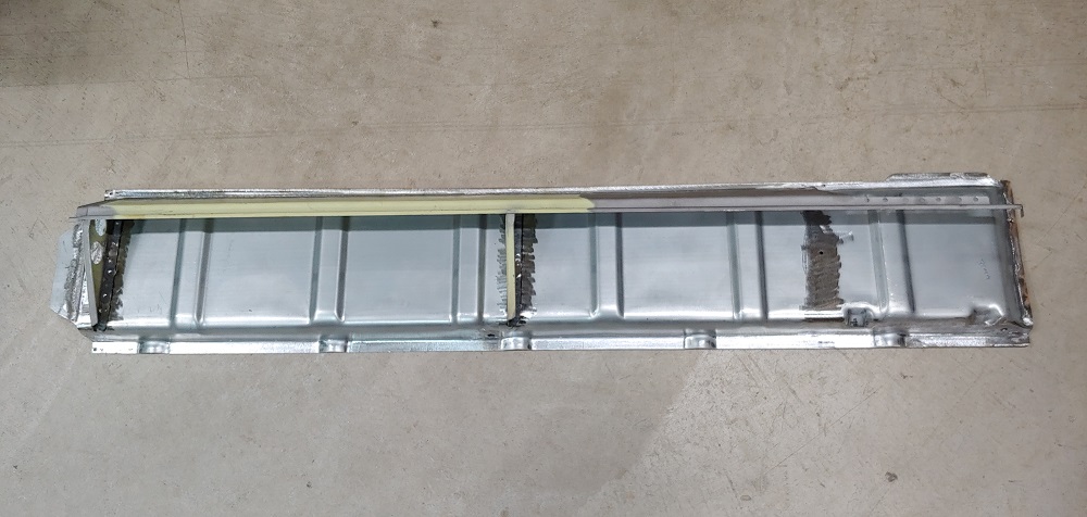

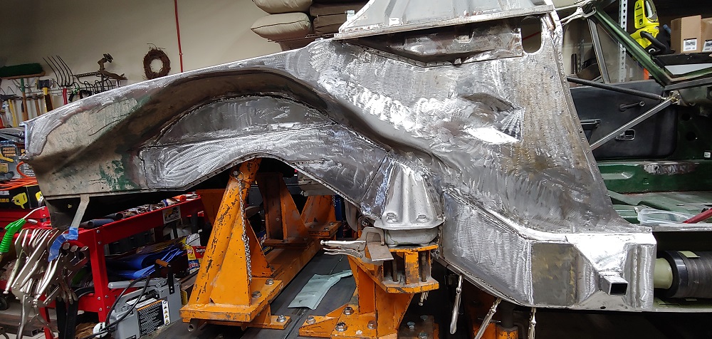

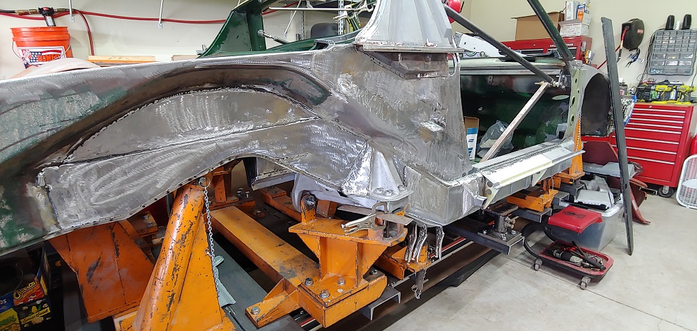

Got the GT kit welded in the right side. Did some grinding as well.. Did I mention that I hate grinding.. Anyways, welds are ground down and prepped the inner rocker to be spot welded on. (IMG:style_emoticons/default/beer.gif)

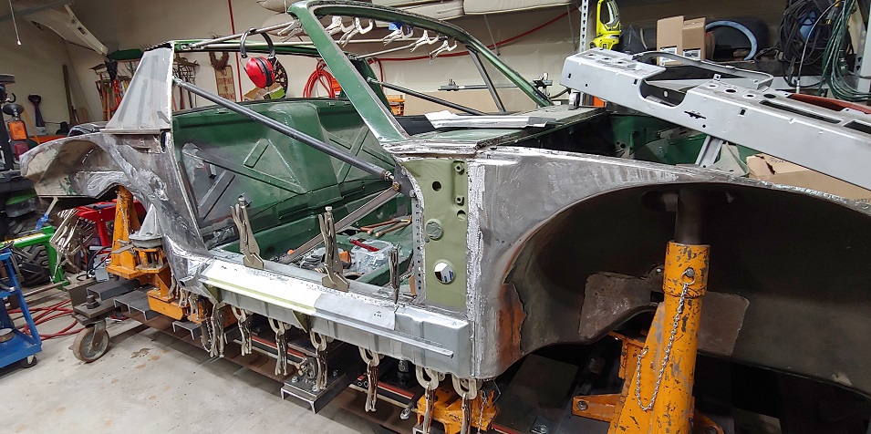

I got the inner rocker spot welded on Saturday. Today will be attaching the door post and checking final door gaps. Then I'll be grinding some welds. (IMG:style_emoticons/default/welder.gif)

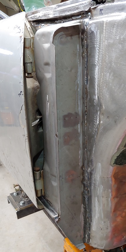

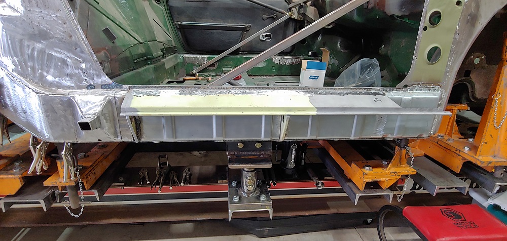

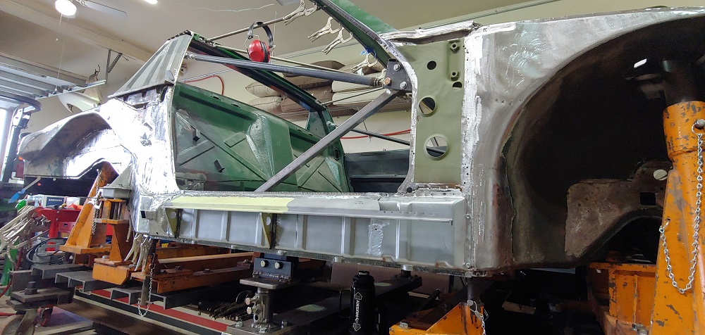

Member No.: 3,574

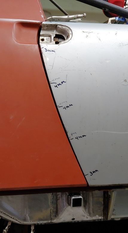

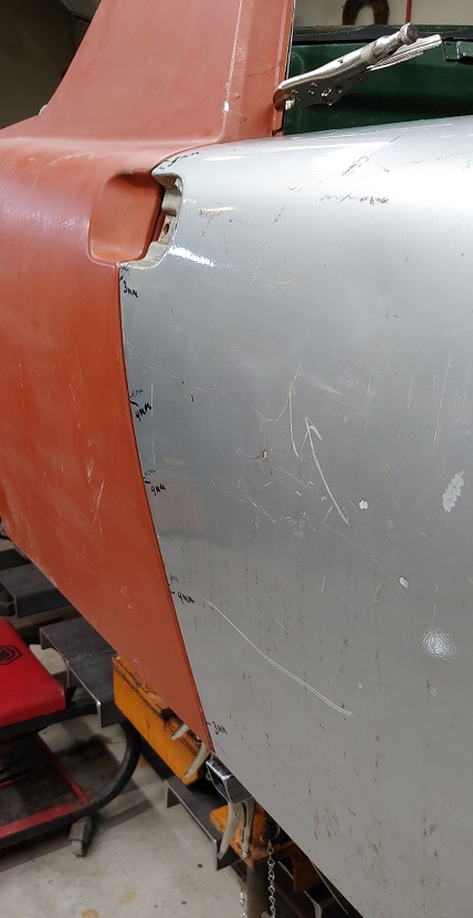

The door post is in and done for most part. I have to grind the welds down and clean up a few spots underneath. Test fitted the door and checked the door gaps. They came in at 4, 4.5, to 5 mm all around. I can't complain about that.

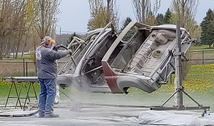

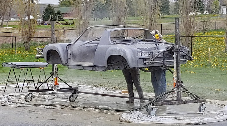

My brothers 914 was blasted yesterday and my 6 is up next.
The weather is messing with the scheduling now as rain is in the forecast for the next 8 to 10 days. The blast guy said if there's a chance of rain he won't blast it. We did get about a 20 min rain fall here as they were blasting my brothers 914. It didn't flash overnight which is good. The blast guy washed the whole car down with some rust inhibiting stuff once he was done blasting.
