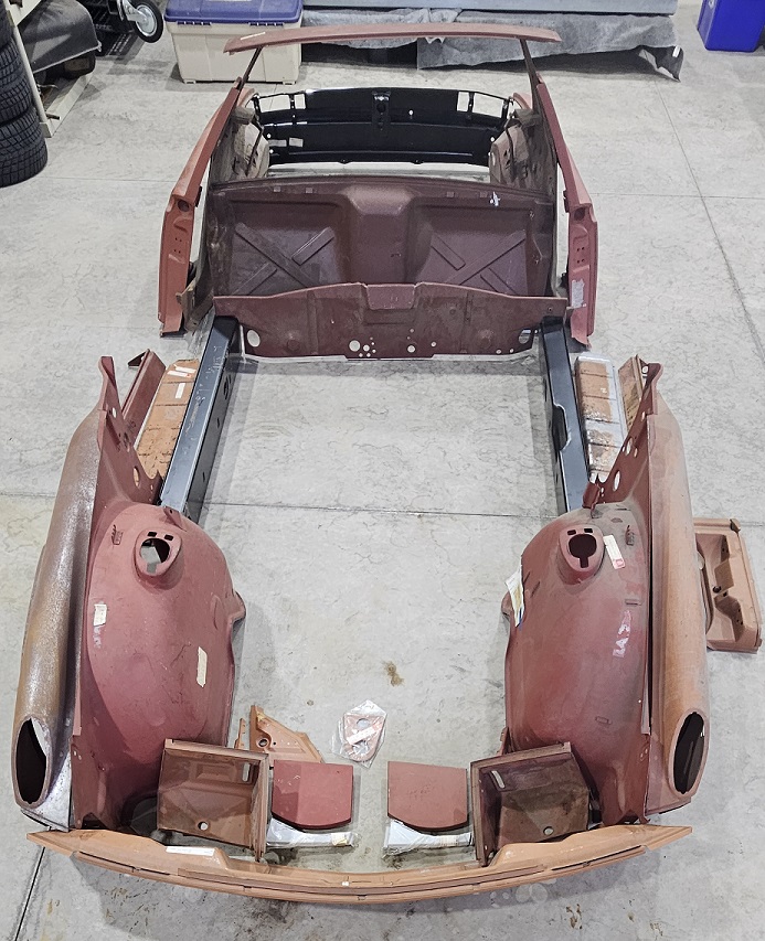

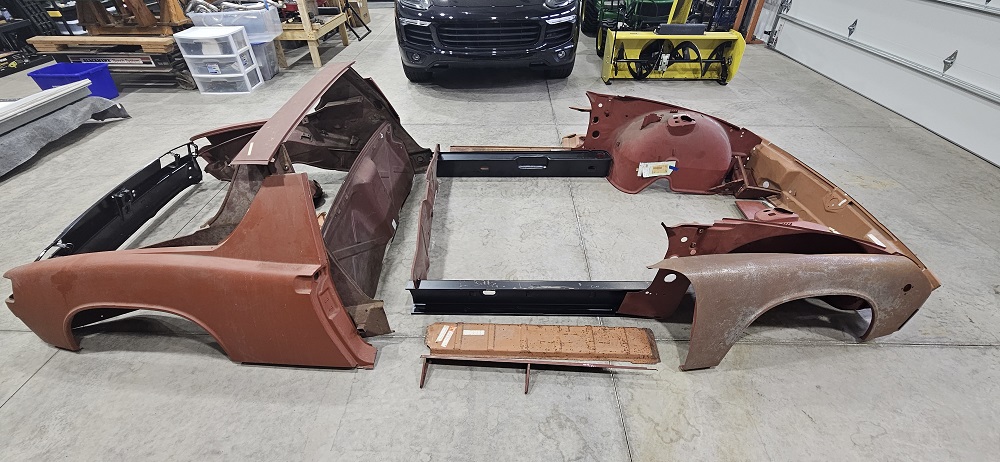

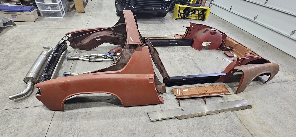

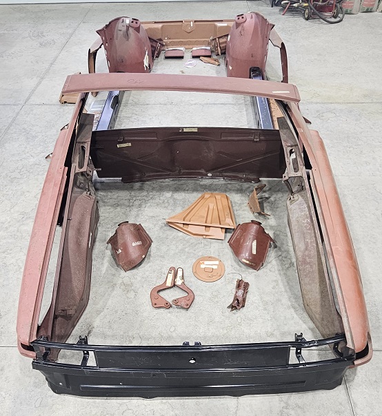

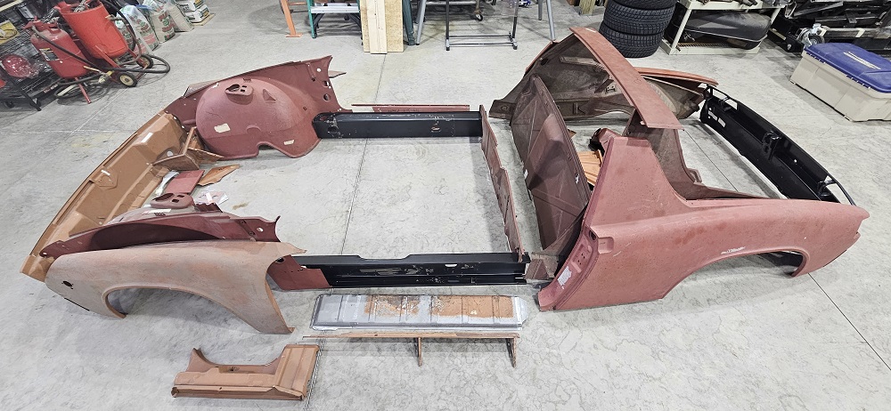

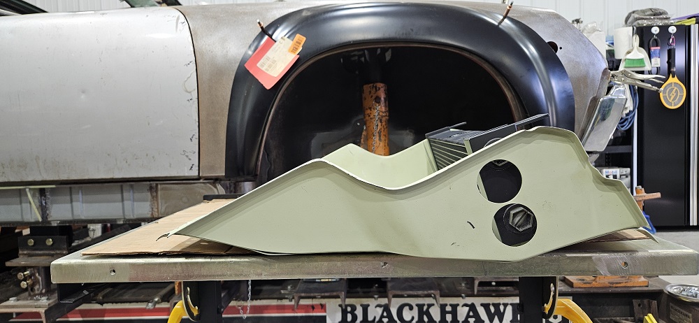

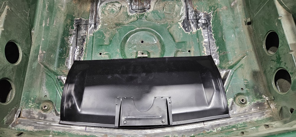

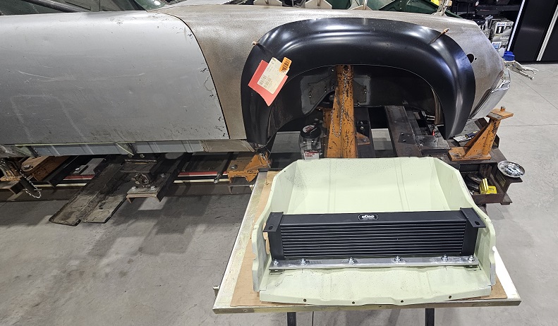

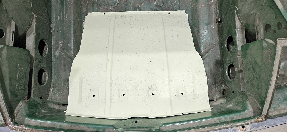

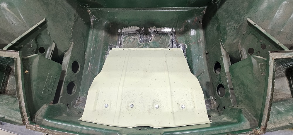

Well it's gotten to be that time finally. I've been collecting parts to do the repair on my 914-6 and now the work starts. The main issue is the hell hole/inner engine long, inner pass long, pass inner rocker panels are rusted out. The last part I was trying to source seams to be NLA. I sourced most of the parts from the good guys at Restoration Design. I received my order today for the last batch of things. Based on a few threads that I've looked over the outer shell to the inner engine long is currently not being made by RD. A few guys have made their own which looks like a real pain in the rear to do. I laid out all the new metal to see how things lined up. By the looks of things it will need some fine tuning to mate things properly. Before I start cutting into the chassis I'll build a few braces to keep things true.
Time for the pics...

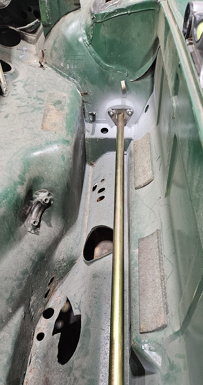

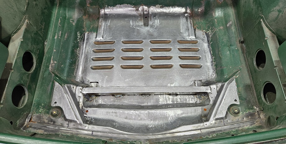

Luke M   Fabricating the interior brace which is now done. ...   Jul 14 2018, 05:38 PM
rgalla9146   Great work ! Good to see progress. P...   Jul 15 2018, 06:24 PM

Luke M   I got started on the lower bracing and found a lit...   Jul 23 2018, 01:44 PM

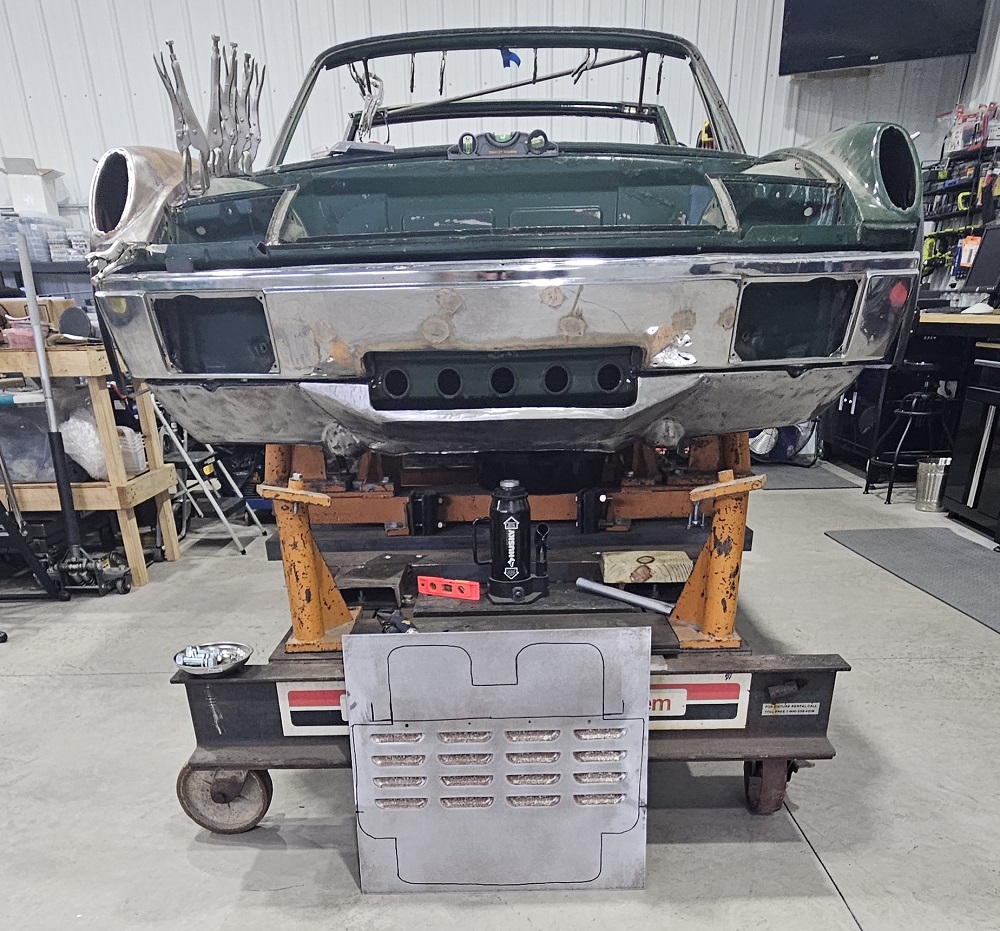

Luke M   Finally got the bench under the 6. This weekend we...   Nov 21 2019, 07:58 AM

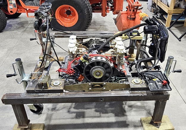

Luke M   Got all the fixtures attached between the chassis ...   Dec 5 2019, 12:43 PM

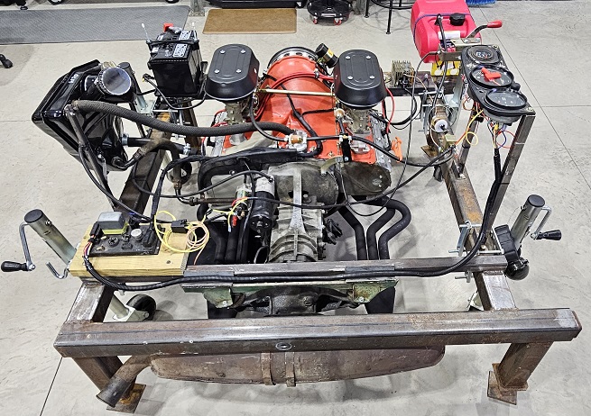

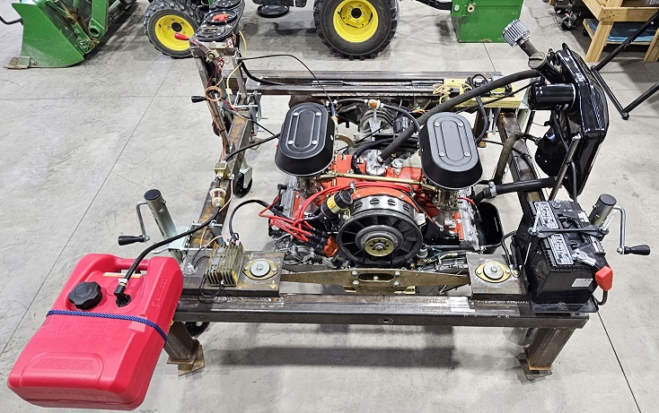

Luke M   Started the tear down on the 3.2. I'm gonna re...   May 1 2020, 09:16 AM
Mark Henry   For the Supertec head studs you'll need a thre...   May 1 2020, 10:49 AM
mepstein   I removed studs from about 25 engine cases when I ...   May 1 2020, 11:31 AM
Luke M   Got the head studs all off without any issues.. G...   May 2 2020, 02:47 PM
Cairo94507   Luke - I am loving that transaxle :wub:   May 2 2020, 04:26 PM
rgalla9146   Looking good Luke Make hay while the sun shine...   May 2 2020, 06:58 PM
Luke M   I split the case today.. Main bearings looked good...   May 3 2020, 01:19 PM

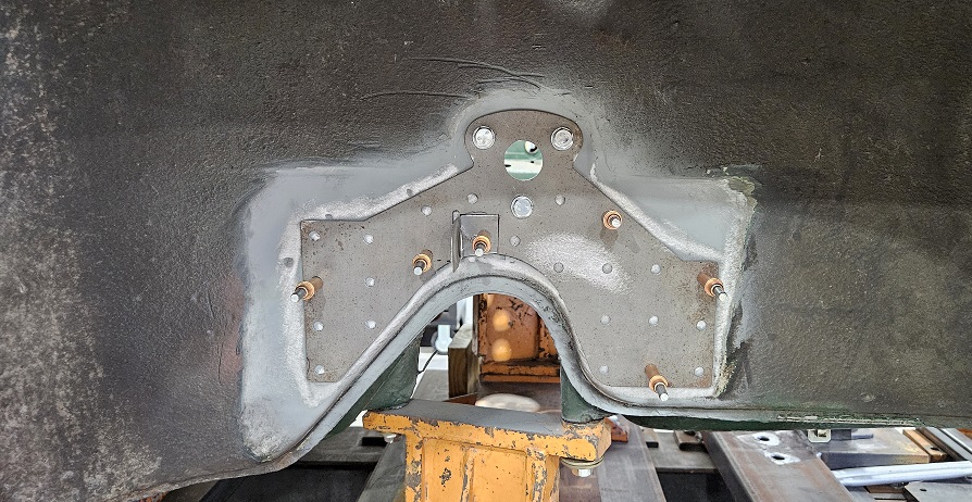

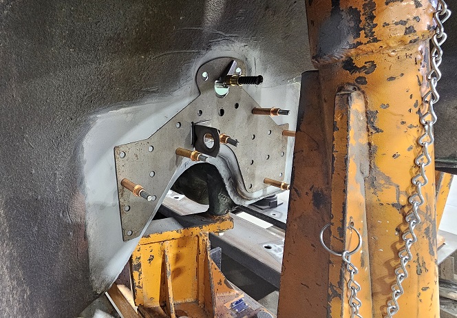

Luke M   Work on mating fixtures to bench..   Jan 23 2021, 08:30 AM

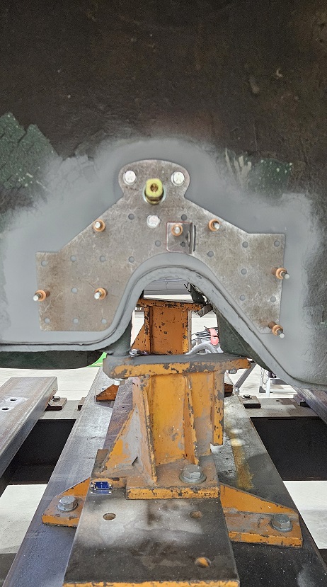

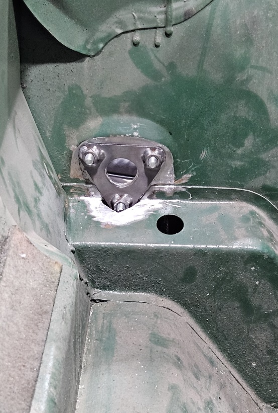

Luke M   Right A-arm mount issue to be addressed. 5-8 mm up...   Jan 23 2021, 08:38 AM

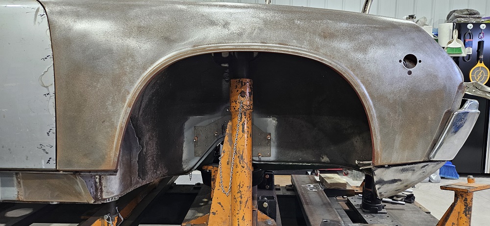

Luke M   Front end fixtures are done. I need to rework the ...   Jan 24 2021, 06:56 AM

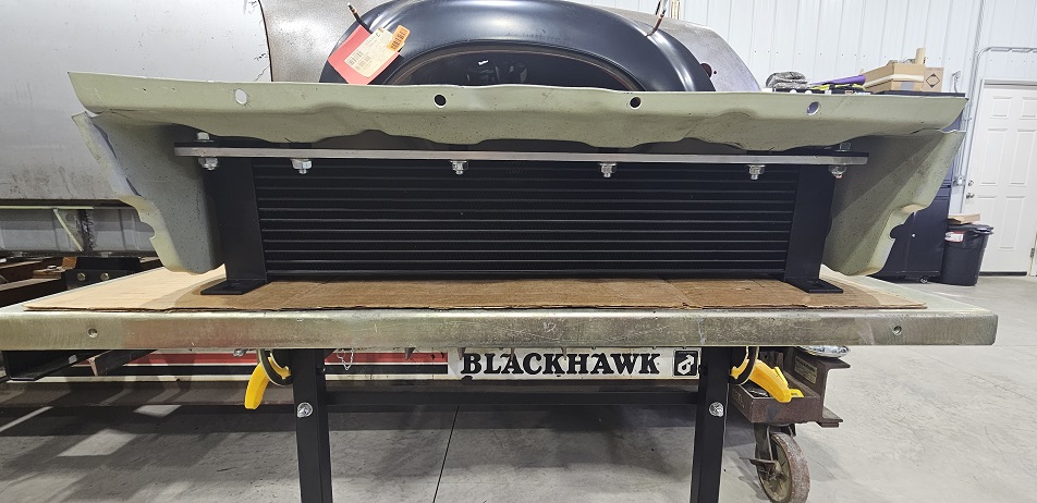

Luke M   Got some new tools... I need to wrap up these rear...   Jan 25 2021, 10:51 AM

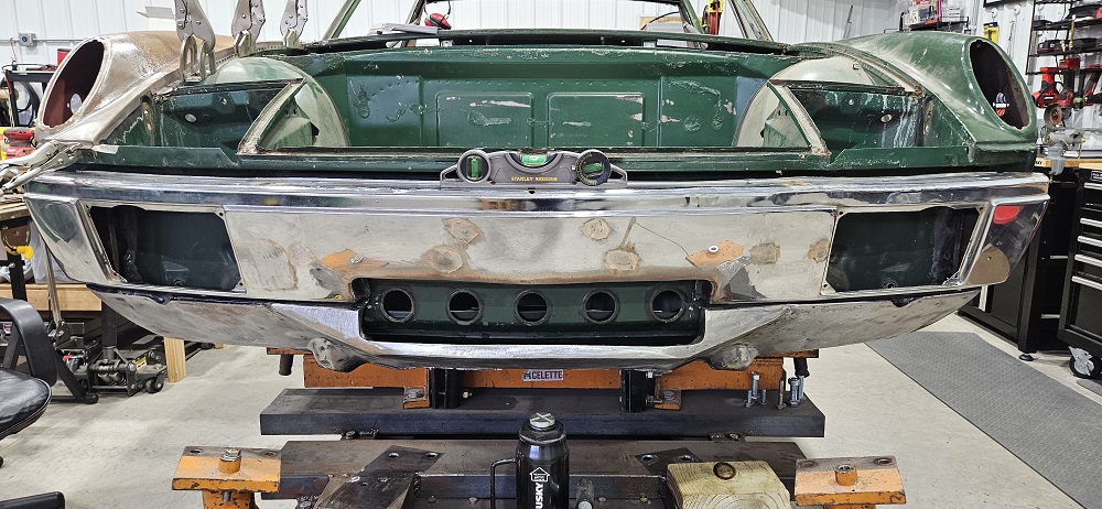

Luke M   The chassis is now locked down on the fixtures and...   Jan 27 2021, 08:10 PM

Luke M   Did a rough cutout of the right long. Now to cut a...   Jan 28 2021, 06:47 PM

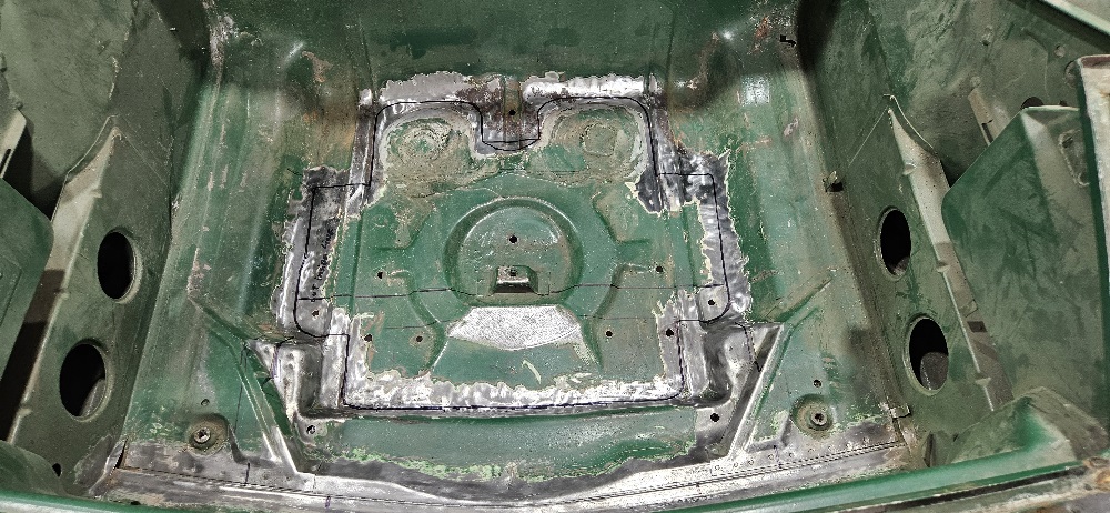

Luke M   I spent all of Friday afternoon drilling out spot ...   Jan 30 2021, 07:11 AM
