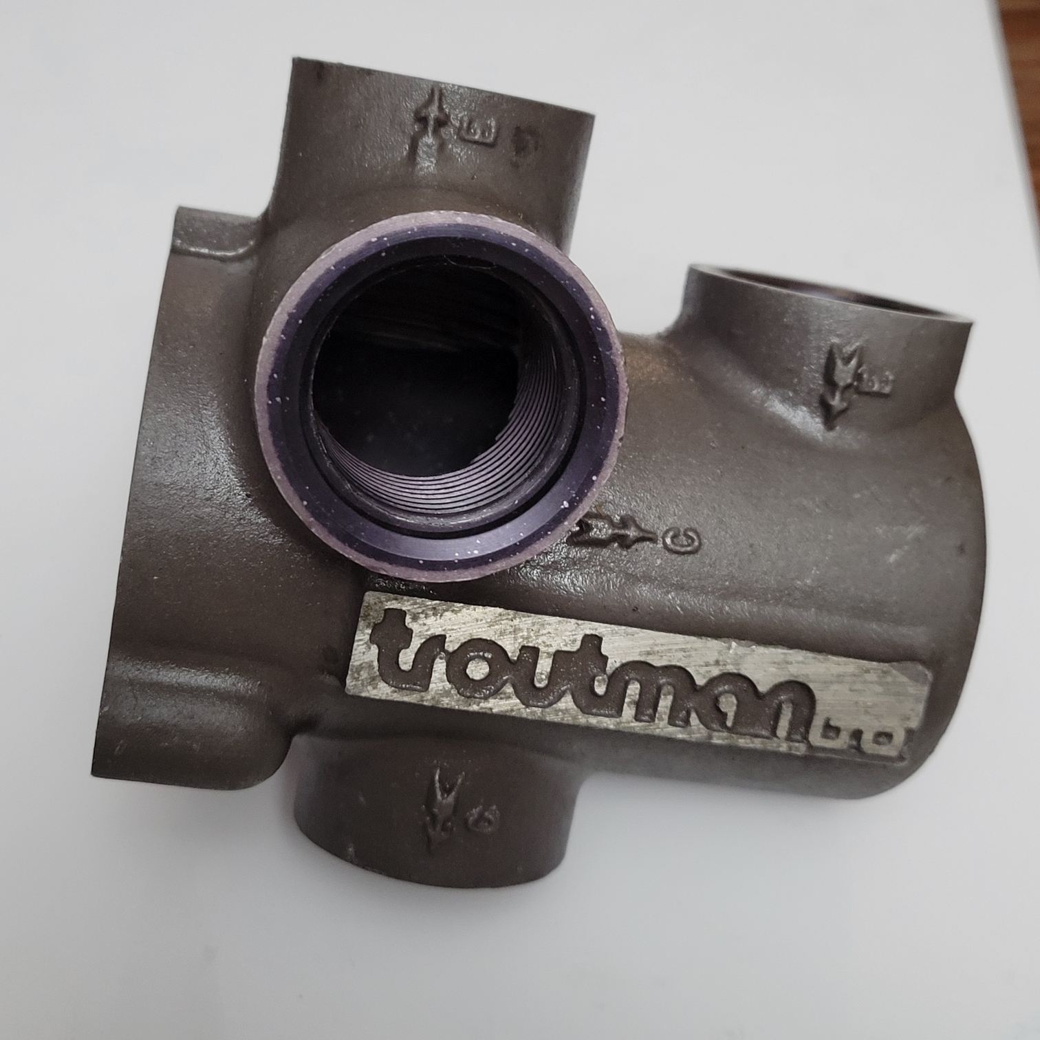

Wow Luke you are committed ... I have my no rust six I wrecked 30 yrs ago on a rack ,,almost straight..
But in trying to keep up.. I found my Troutman thermostat...
its the small things sometimes,,

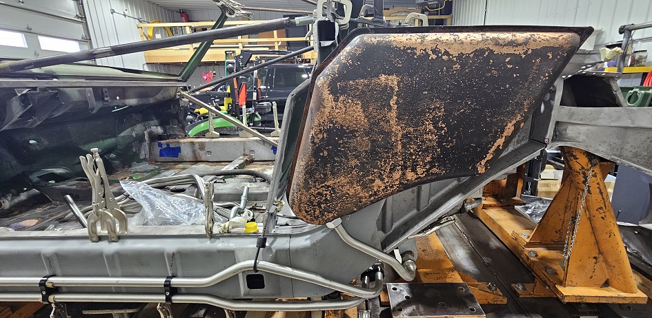

Is that the left rear fender I sold ??
Yes, that's the nos l/r q-panel that I got from you. All of the new panels will get stripped and epoxy painted before installing them. I'm heading out to the shop to fix the sand blaster. Hopefully this update will fix the issue and I can get to blasting the chassis.

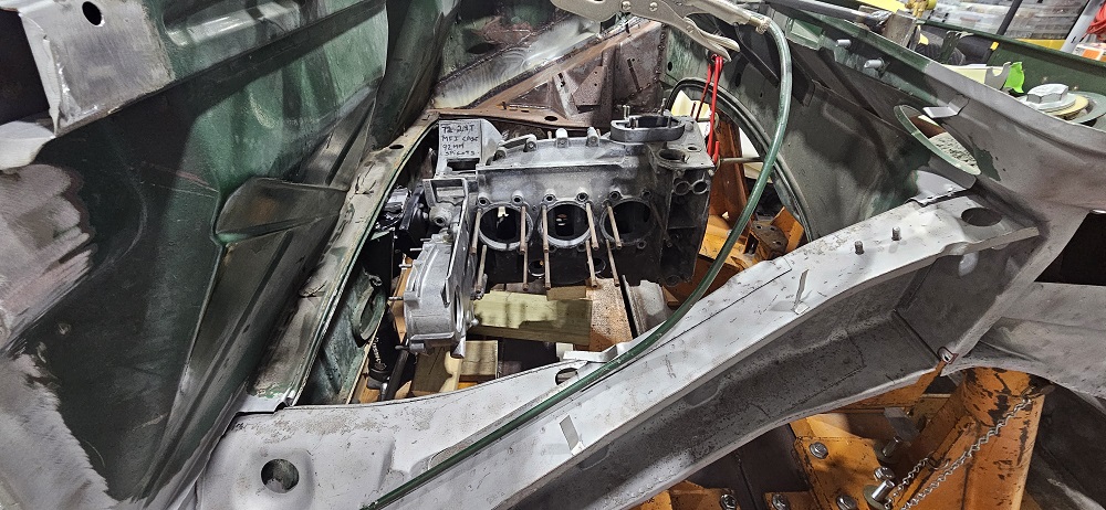

I tried to blast the chassis on my own but it didn't work out too well. I made more of a mess and had all kinds of issues with the blaster. I think I also smoked my air compressor motor too. (IMG:style_emoticons/default/headbang.gif) I just didn't give it enough time to cool between rounds of filling.
I'm pretty sure I got most of the media out of the hidden areas. I used air and a vacuum for a good two hours. The nice part is there's only one long to deal with and I had sealed that up pretty well before I started.
I should've just paid to have this part done but I wanted to give it a try. I had good luck blasting the new panels but blasting a painted/undercoated chassis was way more work involved. It went fine in the areas where I had ground down but once I hit the old paint and under coating it just stalled. I went through several bags of media to get very little results. So now I'm going to make a few calls to either have a company come out to blast it or take it to the guy I spoke to over the winter. He's on a first come first serve so I'll have to see where I fall in that line.
If all fails I may rent a compressor and blasting pot from a local rental shop and try again. Lesson learned here is don't waste your money on a HF blasting pot and trying to modify it to work better. It was a costly failure on my part. I have a 60 gl air compressor but pretty sure I needed more cfm then what it puts out.

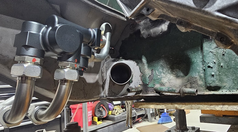

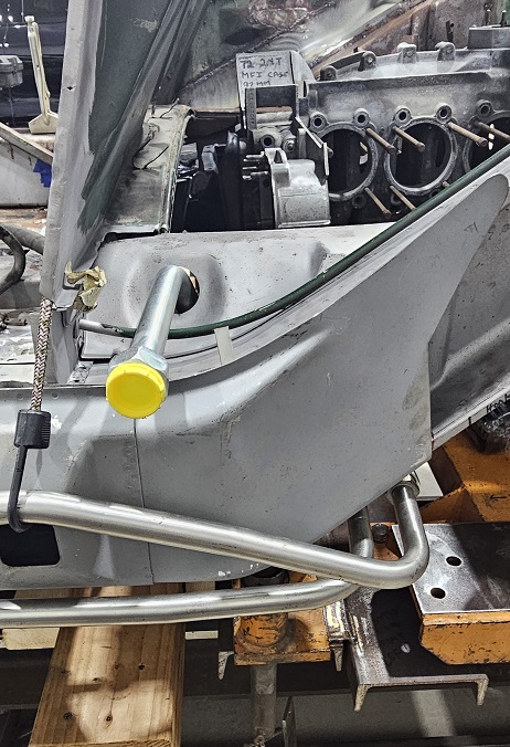

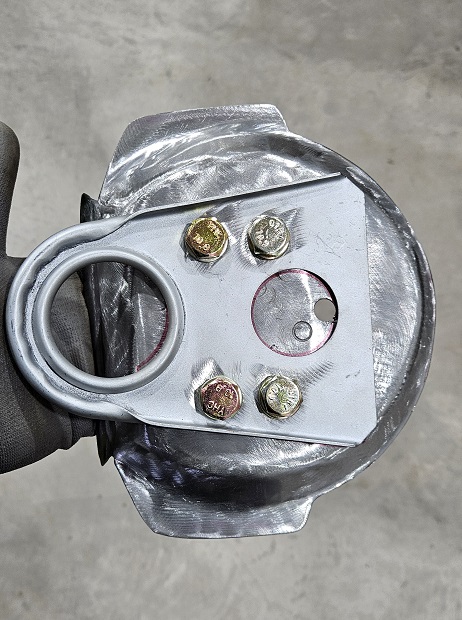

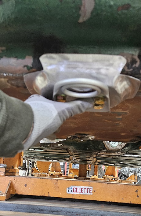

I've been chipping away at small tasks here. For those who run a front oil cooler and removed the tow ring for venting what was your fix to this? I came up with a bolt on tow ring almost like what Arno did on his GT project. I figured I'd ask before I commit to welding this in.

@Luke - Hi Luke - We just removed the tow hook all together when we did the louvered trunk floor panel. I added Tangerine Racing's tow "loops" to the front control arms which I feel is a much better solution.
In reality, my car would not be towed like that. But, if we need to trailer it, they make a great tie down along with his rear tie downs.

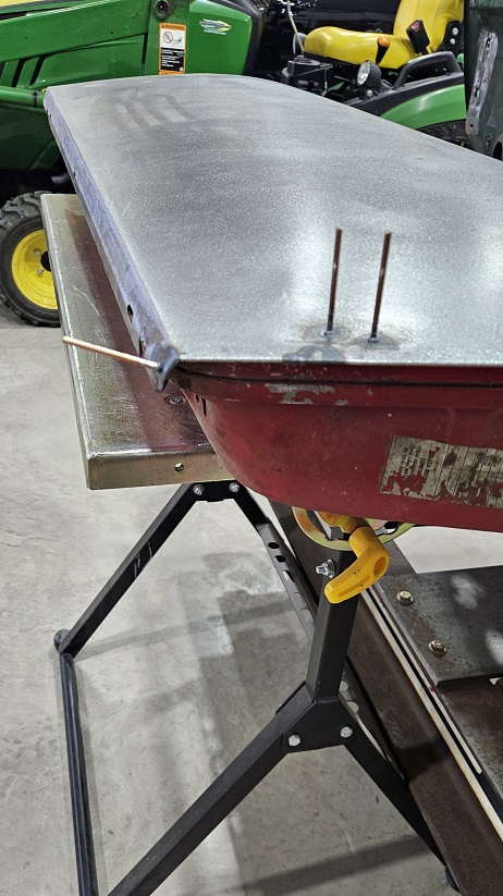

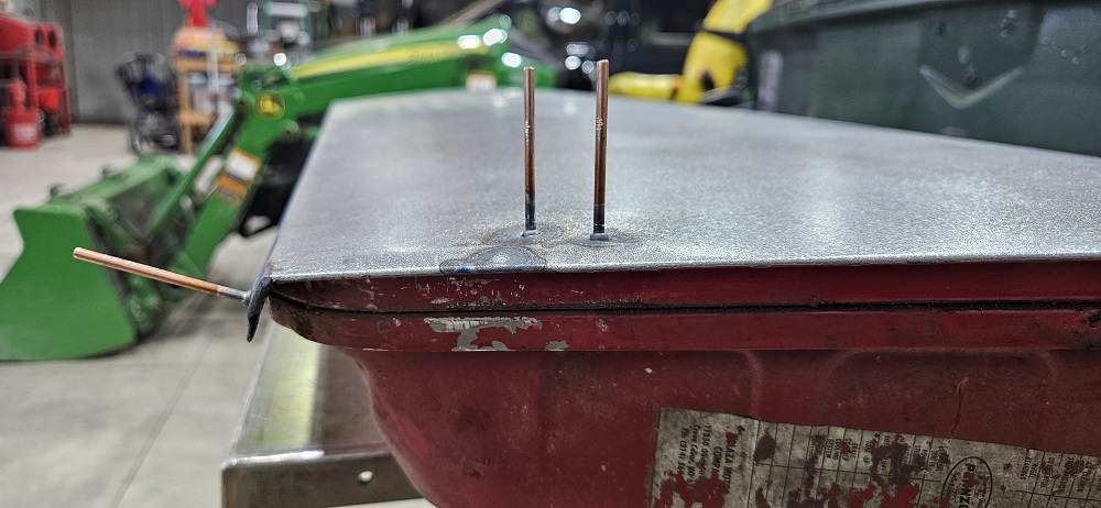

Working on the replacement drivers door ( Thanks Perry ).
The door had a small dent at the lower end. I broke out the spot welder and my body hammers. About 30 mins later and all is well. I may work the corner a little more but want to install the door first.

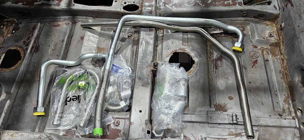

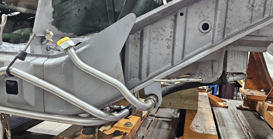

I've been playing phone tag with the blasting guy and the darn weather here isn't co-operating. When the blasting guy is free it calls for rain. I've been doing some other tasks while I wait. I got the new long prepped for the front oil lines and mocking up the rest of the oil cooler setup in the engine bay. I plan to run a return filter before the oil goes to the t-stat then through the rest of the oil system. I think I figured out a good location for the filter/housing. I installed a spare engine case to make sure things clear and things can be accessed. I'll have to modify a few oil lines to make things work. I'm using a 95 993 return oil line which I'll modify to mate with the return filter housing then make up some lines to mate with the oil t-stat. I've decided to use the new Elephant Racing ERX T-stat and all new metric fittings. This should all work pretty well with the 3.4.

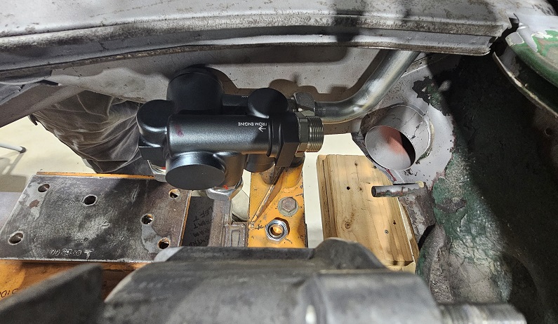

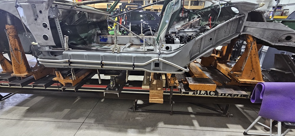

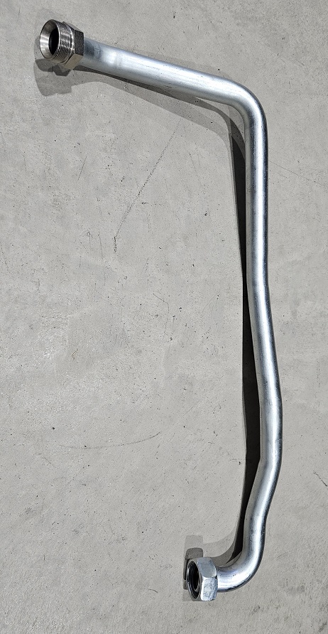

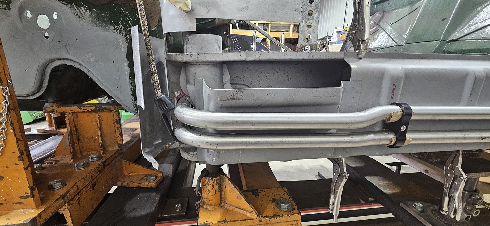

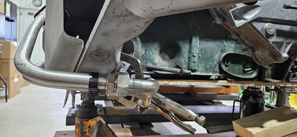

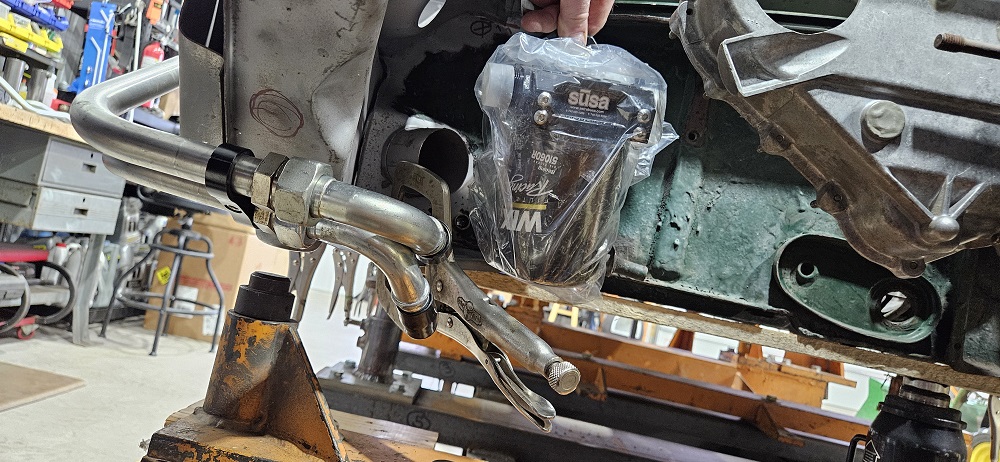

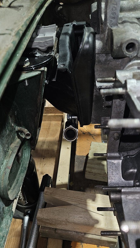

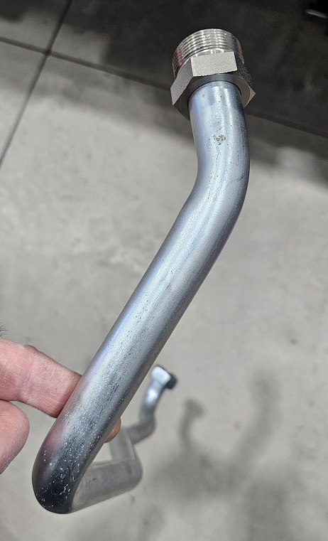

Got a few things done today. Made the hard line from the tank to the engine oil cooler.
Test fitted things and all seams like it will fit well. I figured out the mounting spot for the oil filter housing and the t-stat. I have to make some lines up between the two but first I need to hard mount the housings. I should be able to wrap most of this up by the weekend.

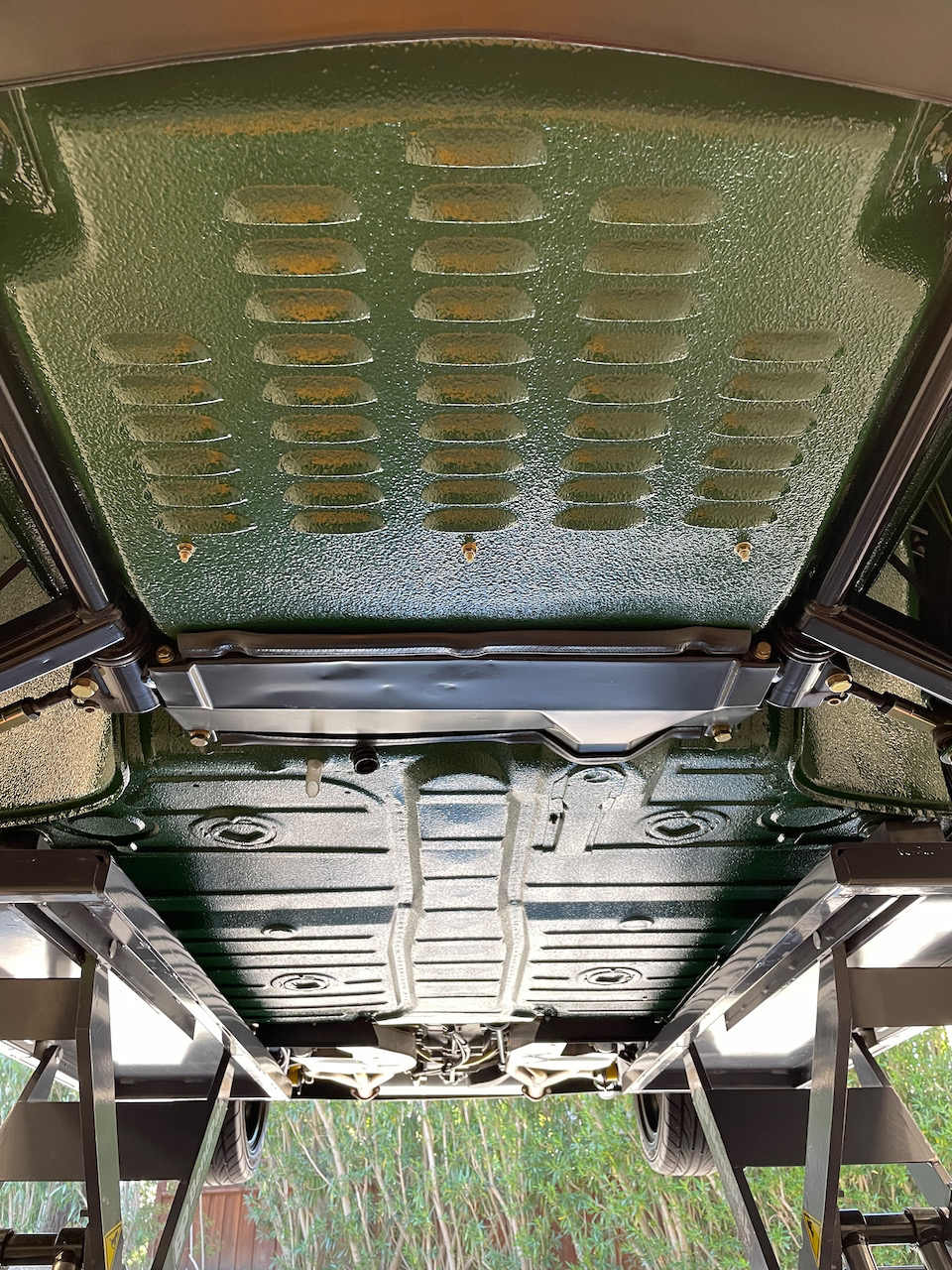

@Cairo94507
Hey Cairo,
You have enough airflow with the louvered frunk pan?
I'm wondering about the adequacy now that I have mine in and working...I don't have oil radiator fans as the radiator is only about 4" tall...hard to size fans for my set up.
Thanks, Todd

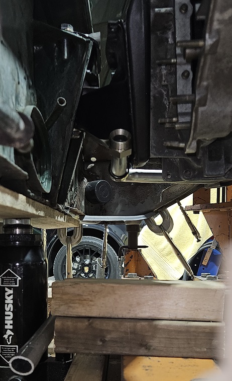

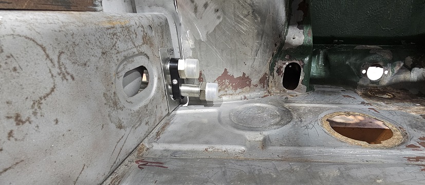

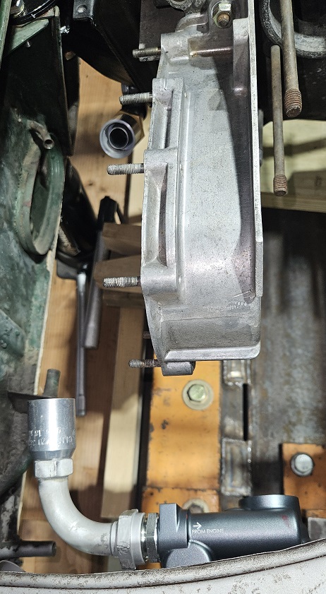

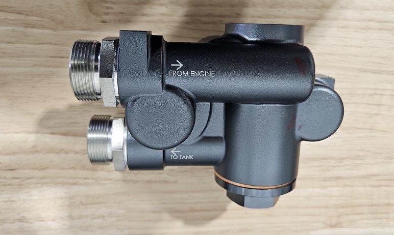

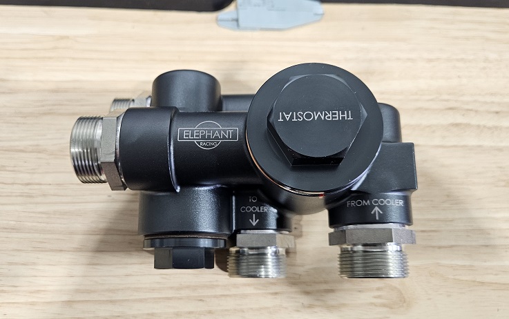

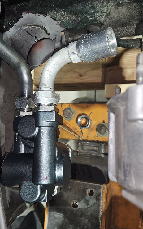

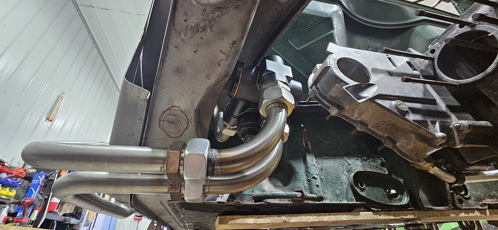

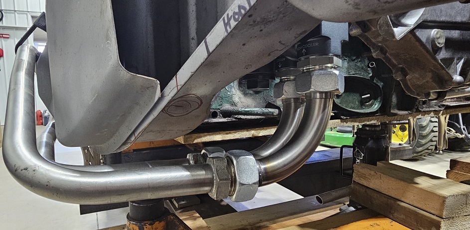

I'm almost done with the fittings at the T-stat. I have one more line to make that goes from the oil filter housing to the t-stat. This one is going to be a real pain in the rear to make. I have to make the rubber hose from the engine return line to the oil filter housing. I modified a factory 95 993 return oil line to fit the 6 chassis. It worked out well as the other end was used from the oil tank return to the t-stat return side.

Wow…….Better than new!

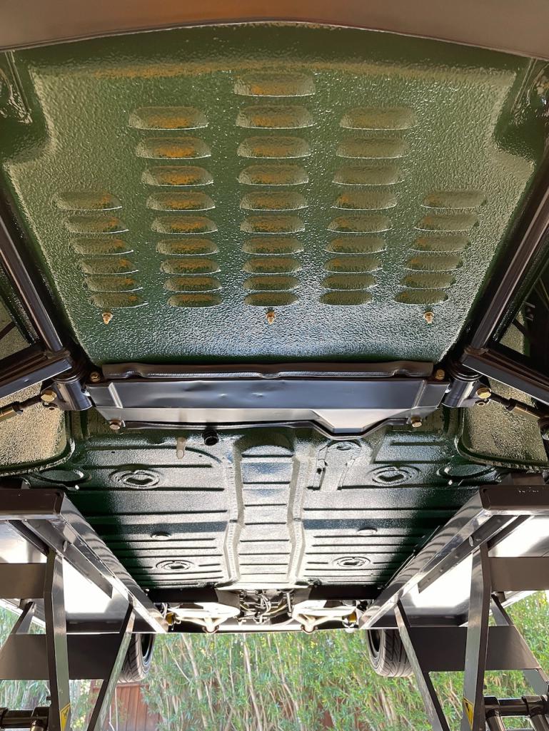

Cairo94507
post May 13 2026, 07:15 AM
Post #333
Michael
Posts: 10,771
Joined: 1-November 08
From: Auburn, CA
Member No.: 9,712
Very nicely done! (IMG:style_emoticons/default/smilie_pokal.gif)

Wow great job ..that thermostat..100% ...finally Improved.. (IMG:style_emoticons/default/smilie_pokal.gif)

We used Wurth on the underside of my car and then painted it body color completely. Still looks like new with about 12K miles on it. I do try to get under it every few months and clean it. I just use detail spray and a microfiber towel. (IMG:style_emoticons/default/beerchug.gif)
