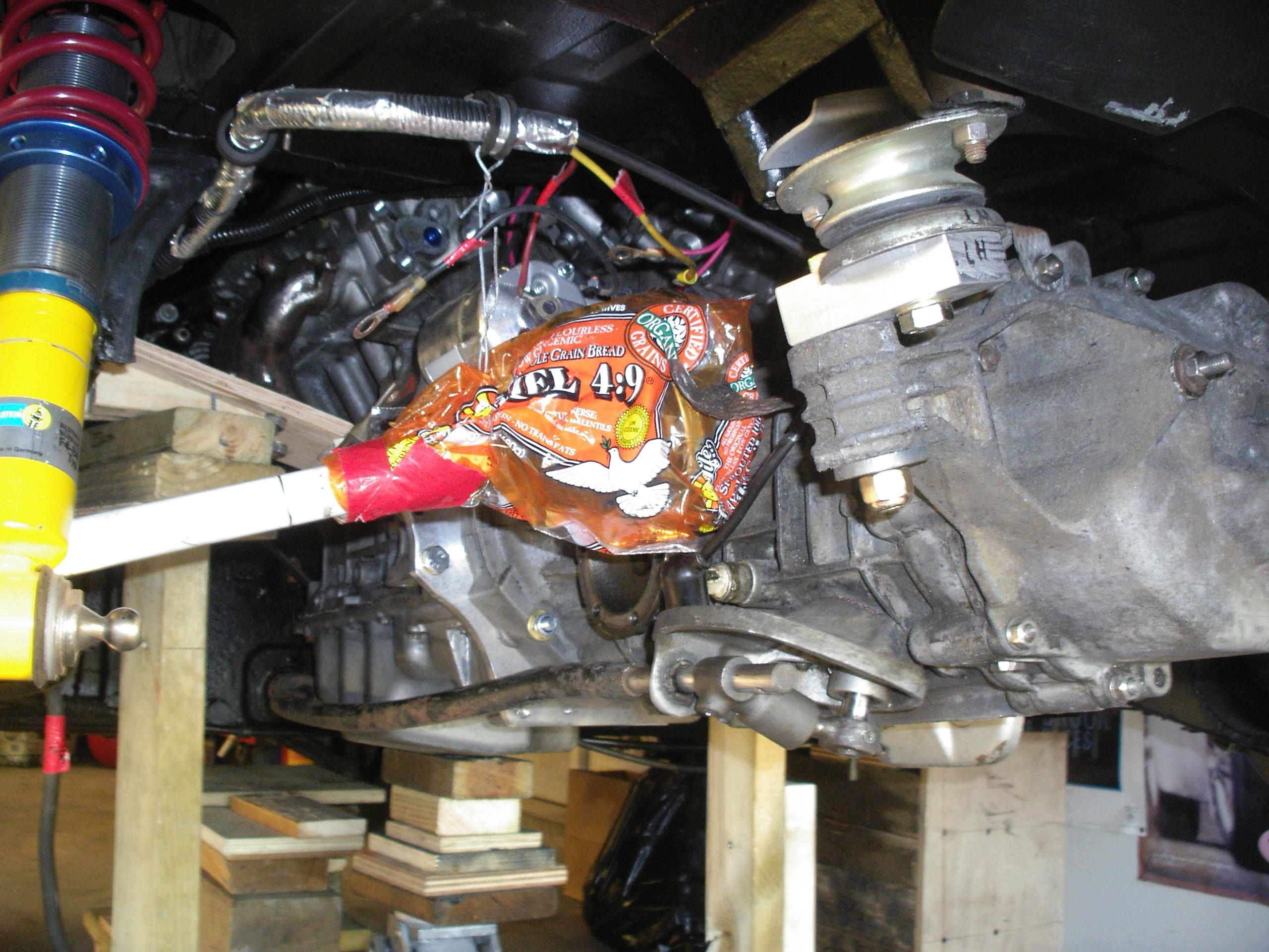

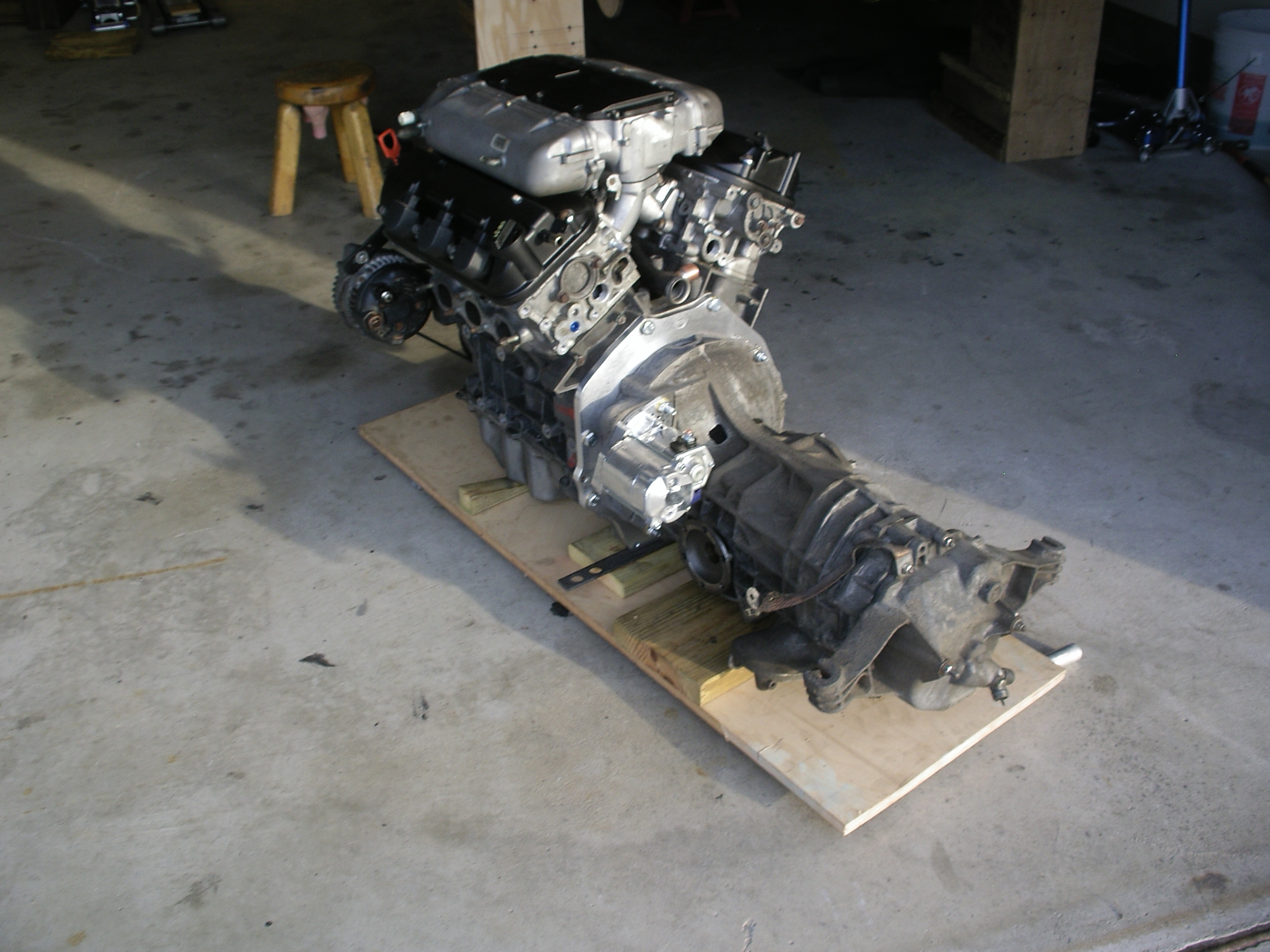

No kidding! note the chunk of plywood over pipe lengths. Trying to raise the package up, without having it tip over is a scary process, as it is pretty top heavy. I forgot to mention that I had to eliminate a 1-5/8's in. spacer between the lower intake runners and the upper air box section.The 3.0, and 3.2 motors don't have it. It lower's the torque curve for the heavy, automatic trans minivan, and won't matter in the light 914. I was so happy when I figured out it could go, as it would have made the engine too tall to fit. Then I figured the engine lid catch would be in the way, but it too clears by a tiny amount. Yes!

QUOTE(RobW @ Dec 20 2015, 05:52 AM) *
Wow, what a mock up on boards! Can you spin plates on sticks too? (IMG:style_emoticons/default/av-943.gif)
Nice eh? Had to start somewhere, so i could think out the front engine mounts, but it was a SLOW process raising her up without losing control of the whole thing. Up until the end, it did not look good, like the shifter would be un-useable, etc., but after the last few inch's, suddenly the shifter was unshrouded, the engine lid shut, and the only body mods will be a small bubble cut, made in the forward trunk floor, for the thermostat housing, and the targa top will be able to fit as original, which I couldn't do with the Chevy installed. I could even re-use the Chevy spacers made to locate the trans rearward, by flipping them forward 180 deg., and still have a nice open area between the engine and firewall. Marking and cutting the trunk pocket will be next.

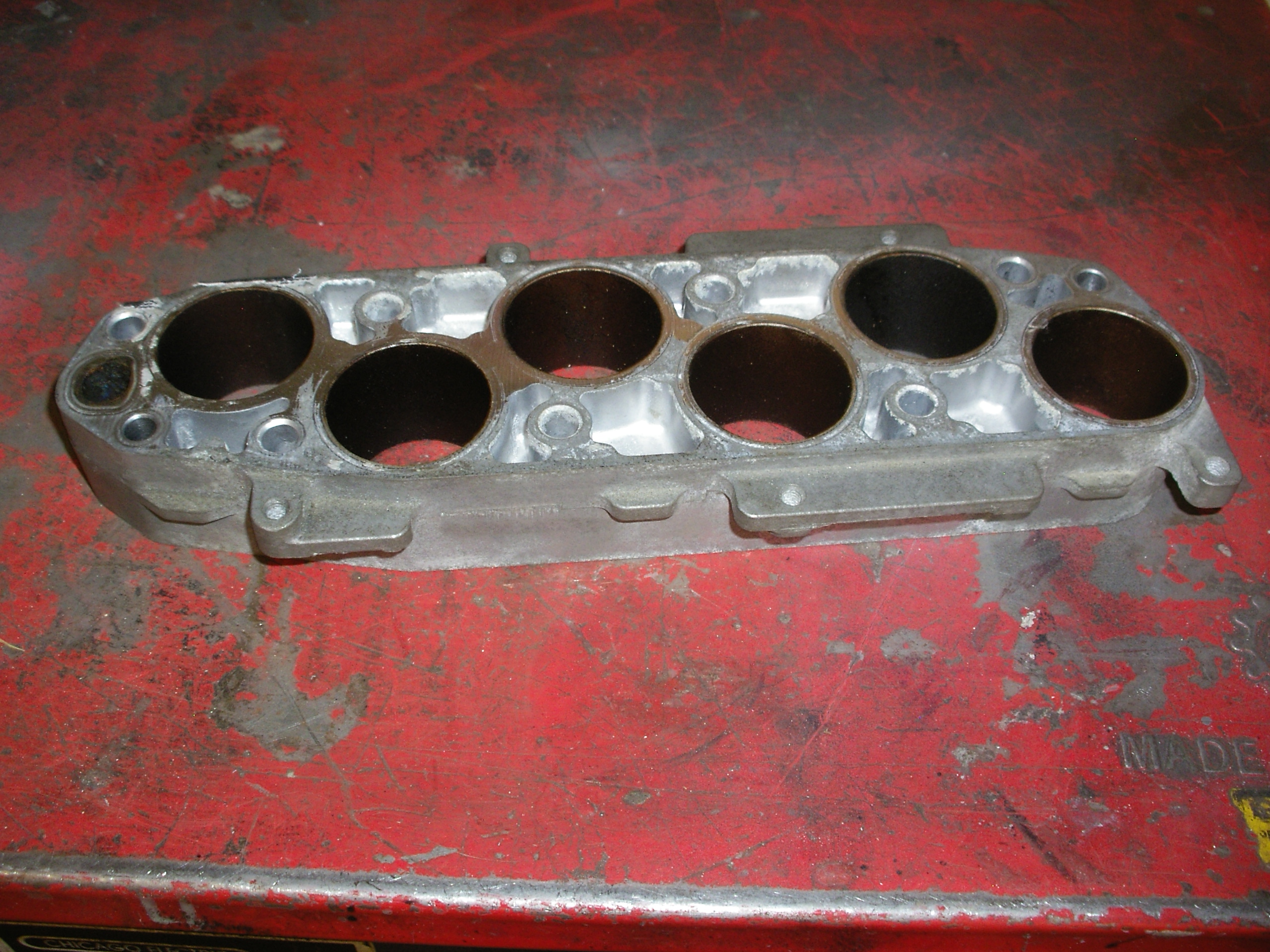

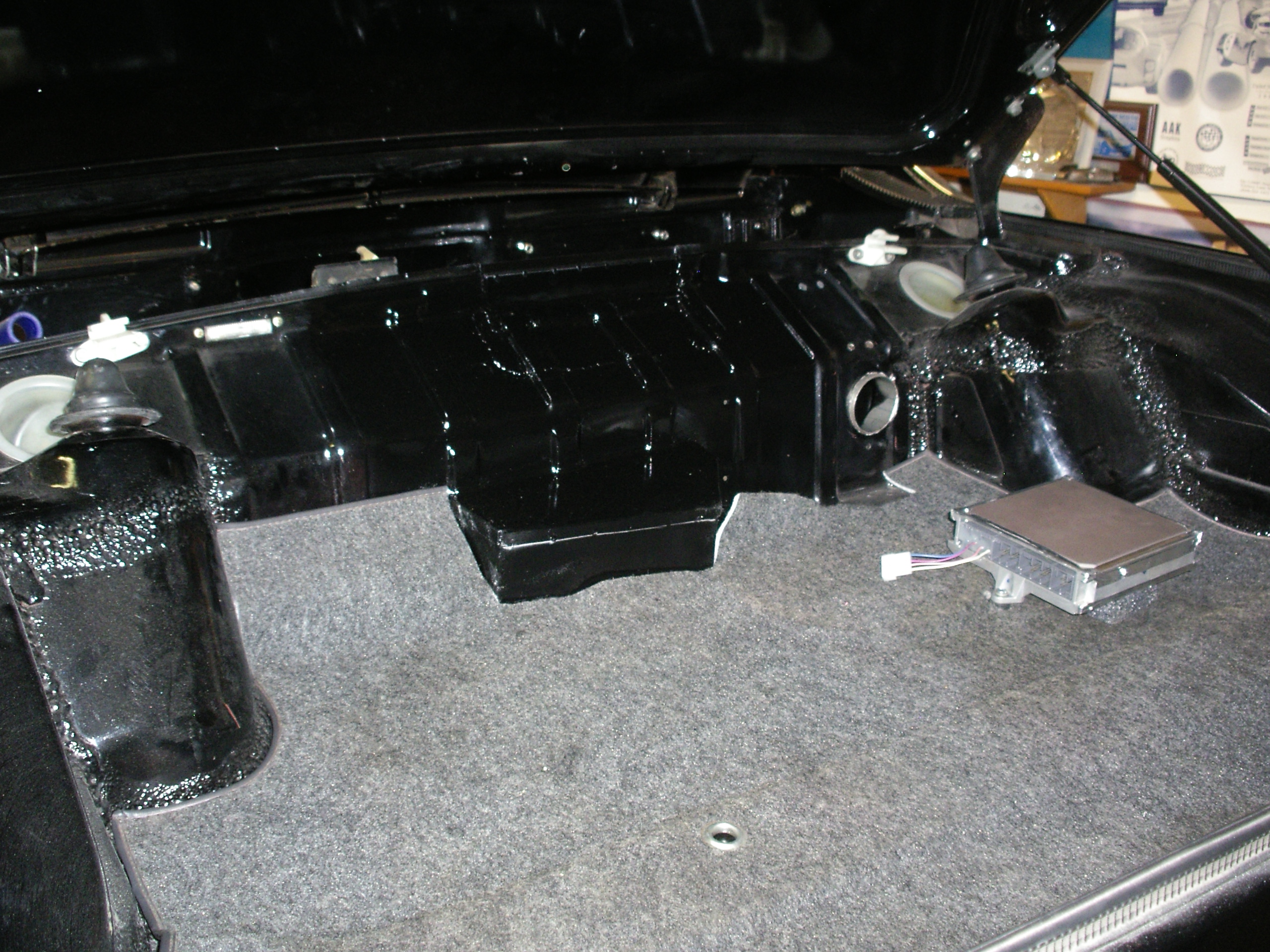

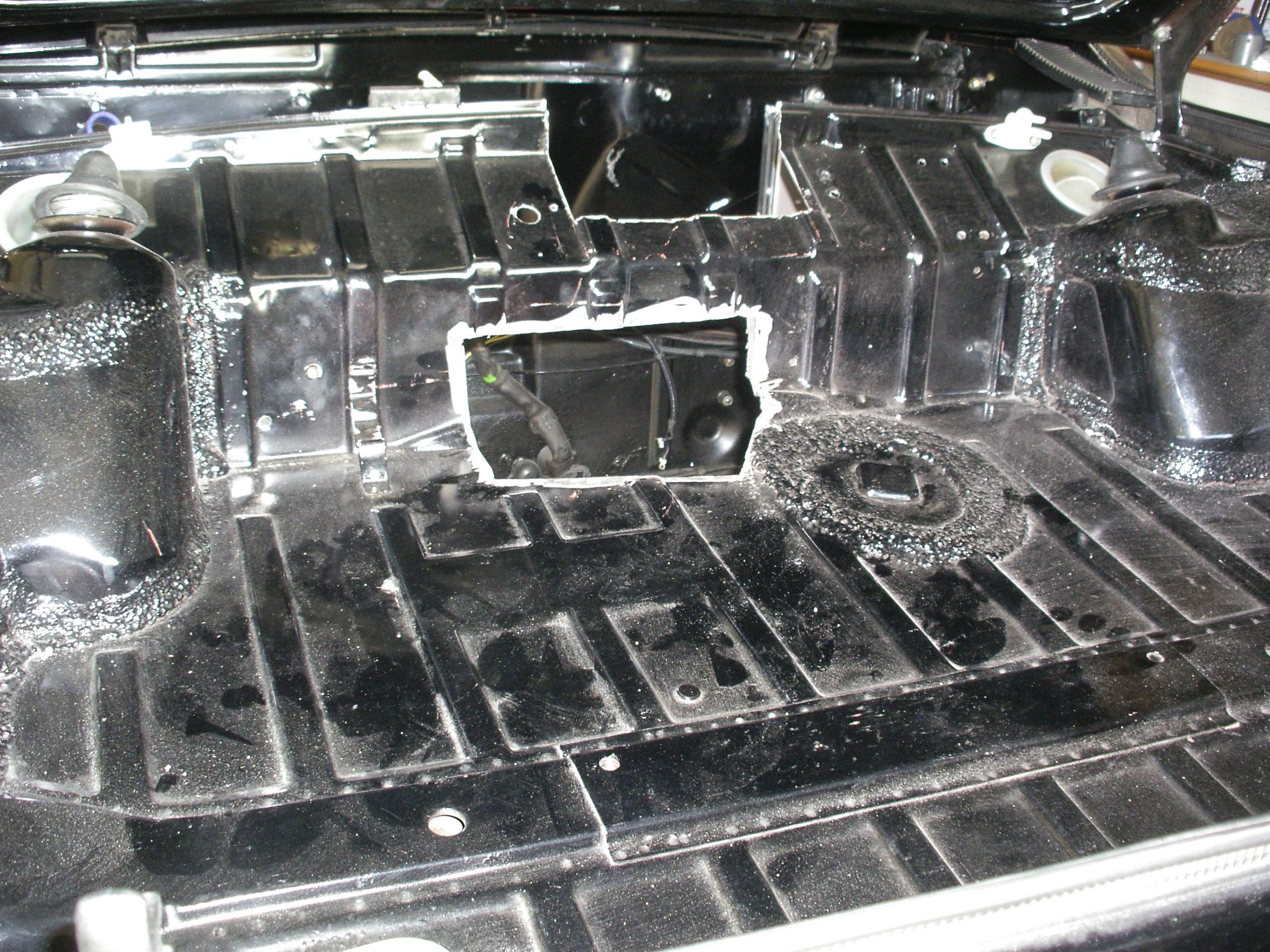

Marked and cut out the pocket to clear the water passage; will weld up a box there to retain some structural strength. Also pic of the intake spacer that came out, to shrink the engine height. I'll also be able to rebuild the upper hole made to clear the Chevy dizzy.

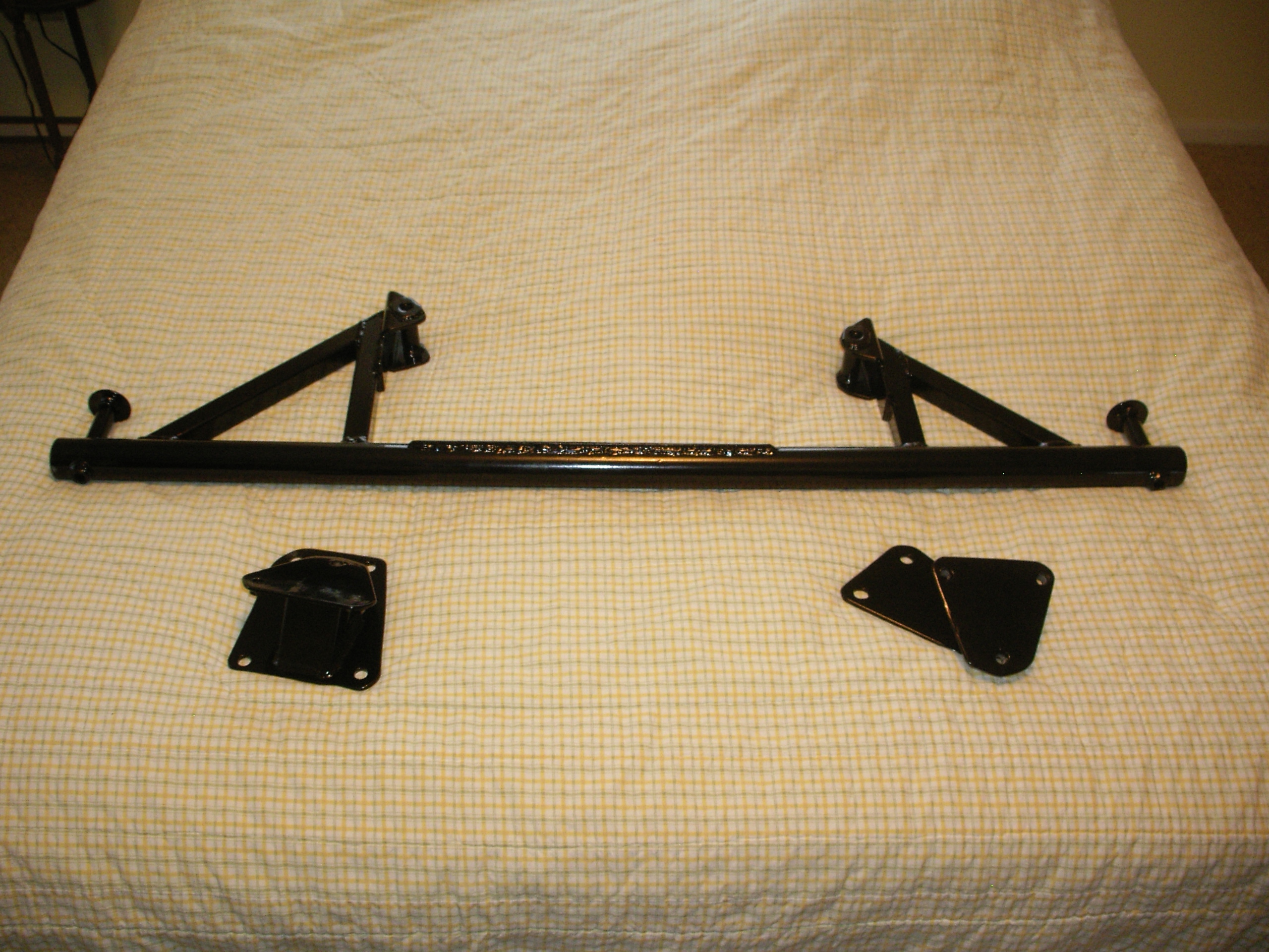

Some progress: motor mounts, and bar back from the powder coater this morning, new fuel lines are run, trunk area welding finished, wiring about finished. Will slip her back in for good, (I hope) tomorrow, and start the exhaust fabbing.Attached Image Attached Image

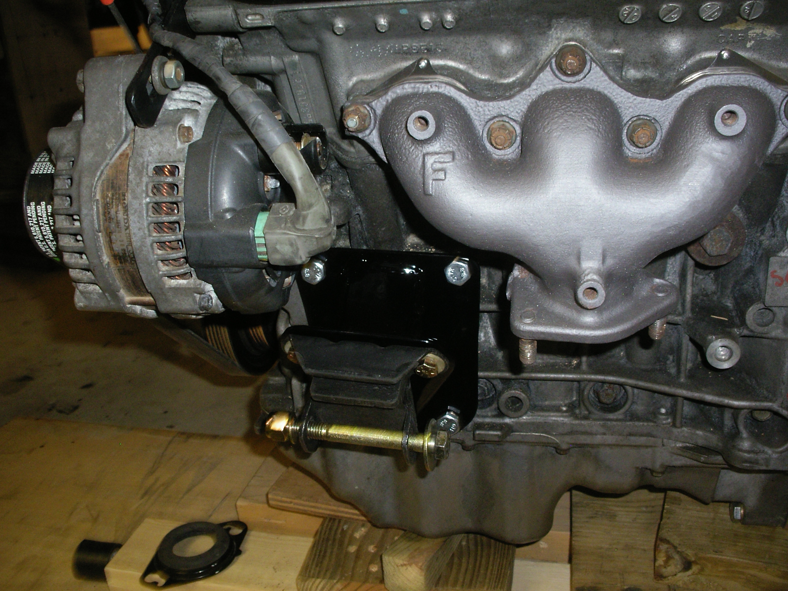

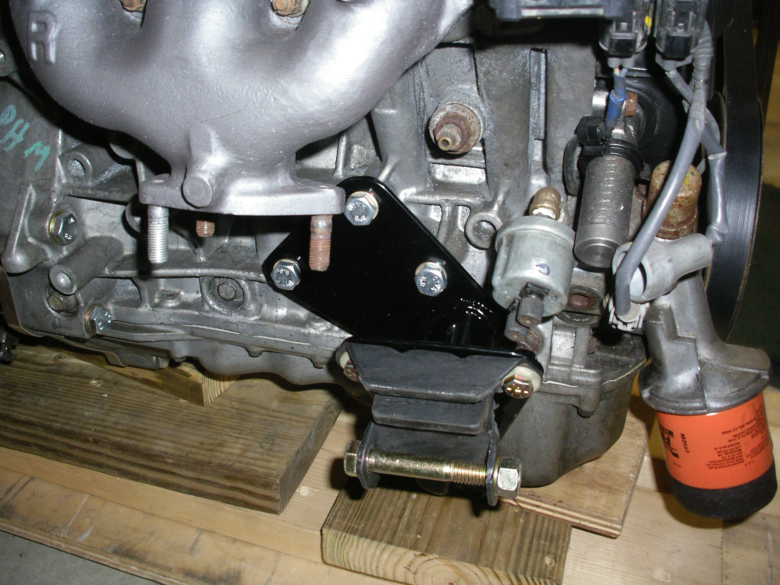

The block has useable mount's cast into the sides, that aren't used by Honda in their install, but thoughtful of them to think ahead for me!

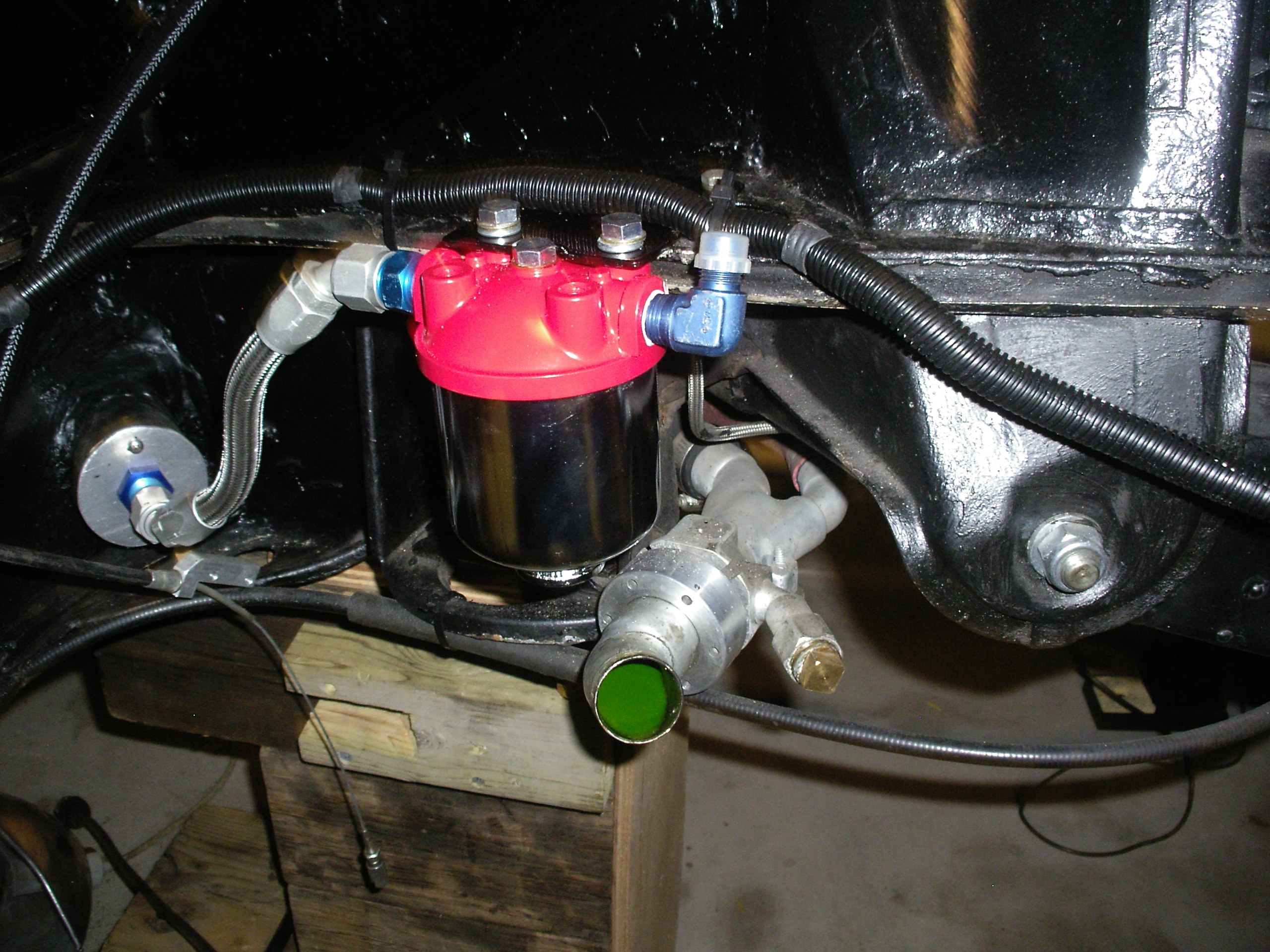

Shot of plumbing; the supply fuel line is -8, run thru the longs, and into 10 micron final filter. There's a 100 micron filter in the trunk, between the tank, and the pump. Coolant has twin lines on each side, run along outside of longs, behind the side valances. Return will be -6 back to tank.
