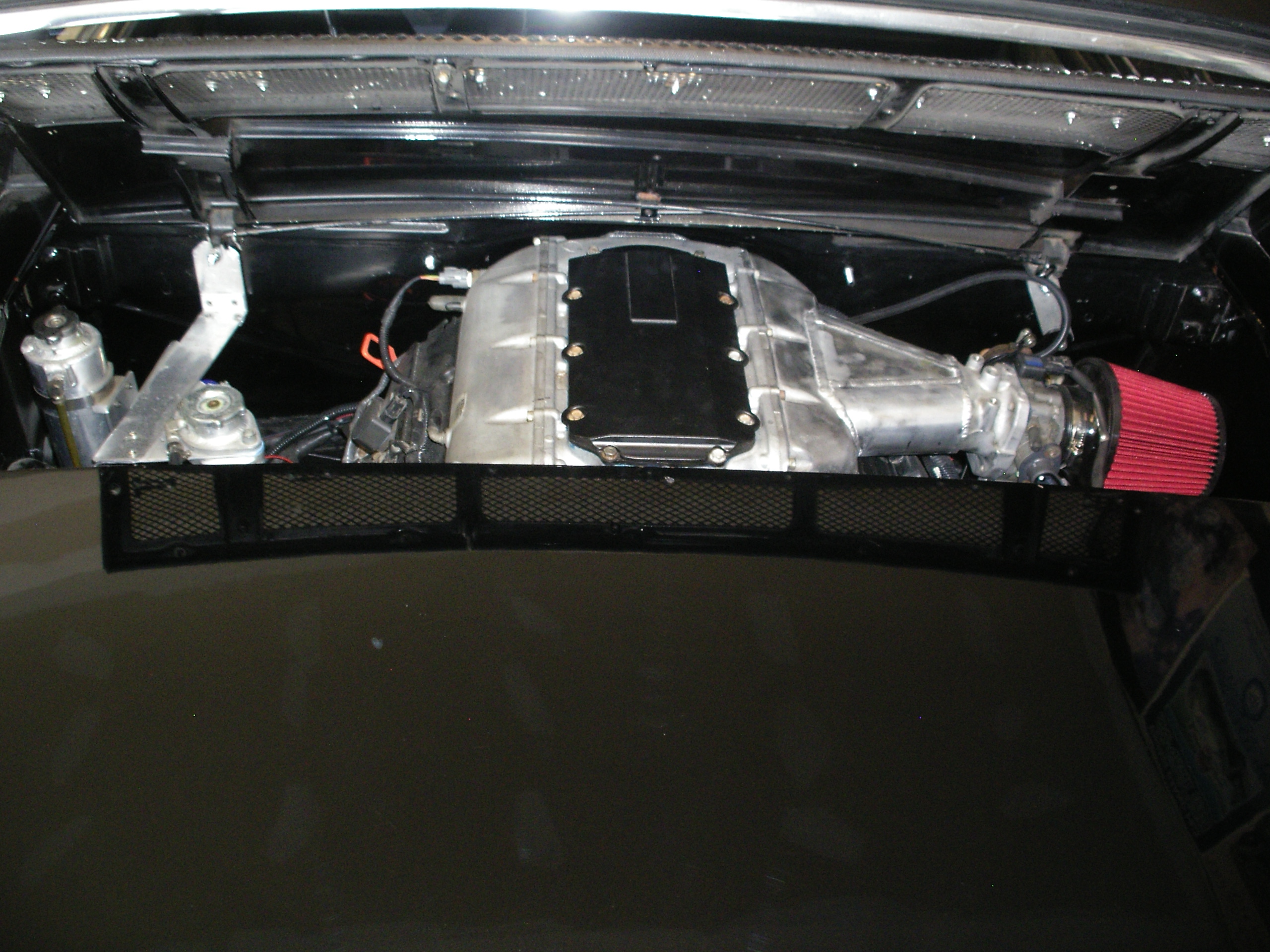

Did you purchase or fabricate the radiator fill that is circled in this picture?
I have been looking for something like that for my Subaru conversion.
Ray

QUOTE(A&P Mech @ Jan 2 2016, 08:06 AM) *
Ray
Hi Ray, It is fabricated, milled lower portion, with welded cap mount. Spent some time today relocating it for the Honda.

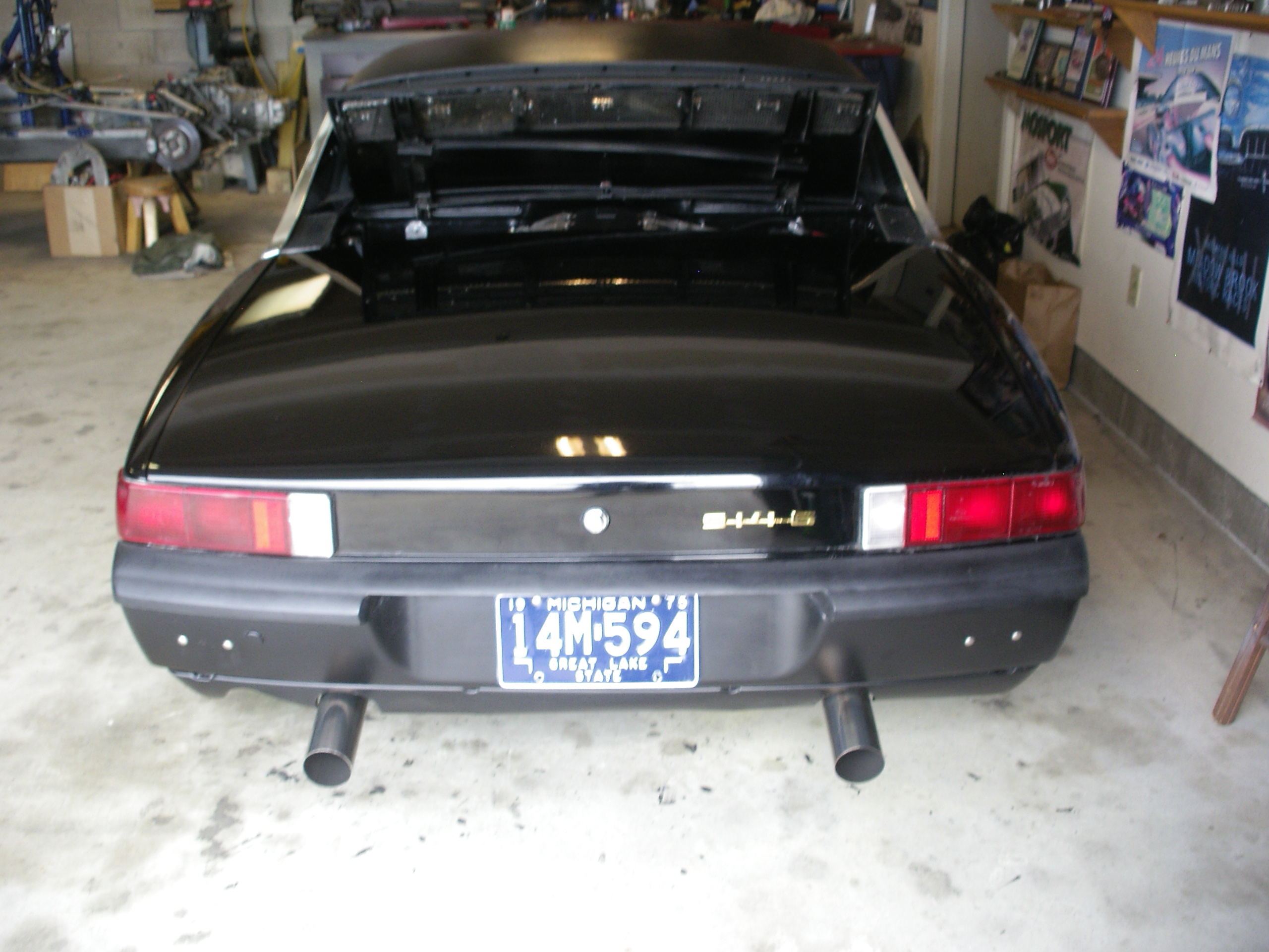

She is a runner; finished up all but the tach mod. Now just have to wait a few months for the snow to melt. I knew it would sound good, but it surpassed my hopes, as it sounds like the NSX's i had some years back! Rev's super freely, and idles quietly.

Sound clip indeed! I see you relocated your throttle body for clearance - nice job! Do you have any idle or running problems due to the internal EGR tube or the vacuum path dividers inside the manifold? Great conversion by the way!

QUOTE(mgp4591 @ Feb 24 2016, 01:10 PM) *
No, she idles perfect. I eliminated the EGR, and tapped and plugged all the EGR tubes/ports in all sections of the manifold. Without relocating the TB, (and flipping the intake 180 deg.), there was no way the engine would fit, without a lot of body/trunk mods, and the plan was to leave the car unmolested, as much as possible. It has been a super fun project, with lots of stuff to fab, and $$ stayed pretty low, at $2K total. I think the power level is well suited to the 901 box, as well.

Yeah this really messes things up for some of us Tom (IMG:style_emoticons/default/biggrin.gif) . We WANT THAT! Was a little worried about that side mounted intake. Sounds like it breathes fine.
Looks great. Congrats on getting it up and running.
Did you say you got the engine harness done somewhere? How about the ECU? Who did that work for you?

[quote name='Chris H.' date='Feb 24 2016, 02:53 PM' post='2307445']
In stock form, the TB flows into the outer air box on the intake, so by moving it to the side, it still enters a common box, and seems to be a non issue. I researched the dune buggy shops that are using the Honda, and found a couple who will clean up the stock harness. Settled on Don's Buss Box, a guy in Az. who builds gearbox;s for buggies, and will supply a modded late 90's ECU, and go thru your harness for $850. He in turn has another buggy shop do the harness work, based out of Wa. It was done cleanly, and allowed me to concentrate on the welding / fab end of things, which I like best, and then just change the chassis wiring to mate up with the Honda parts. It only needs 6 wires to run, and control's the fan and fuel pump, as in a stock setting.
