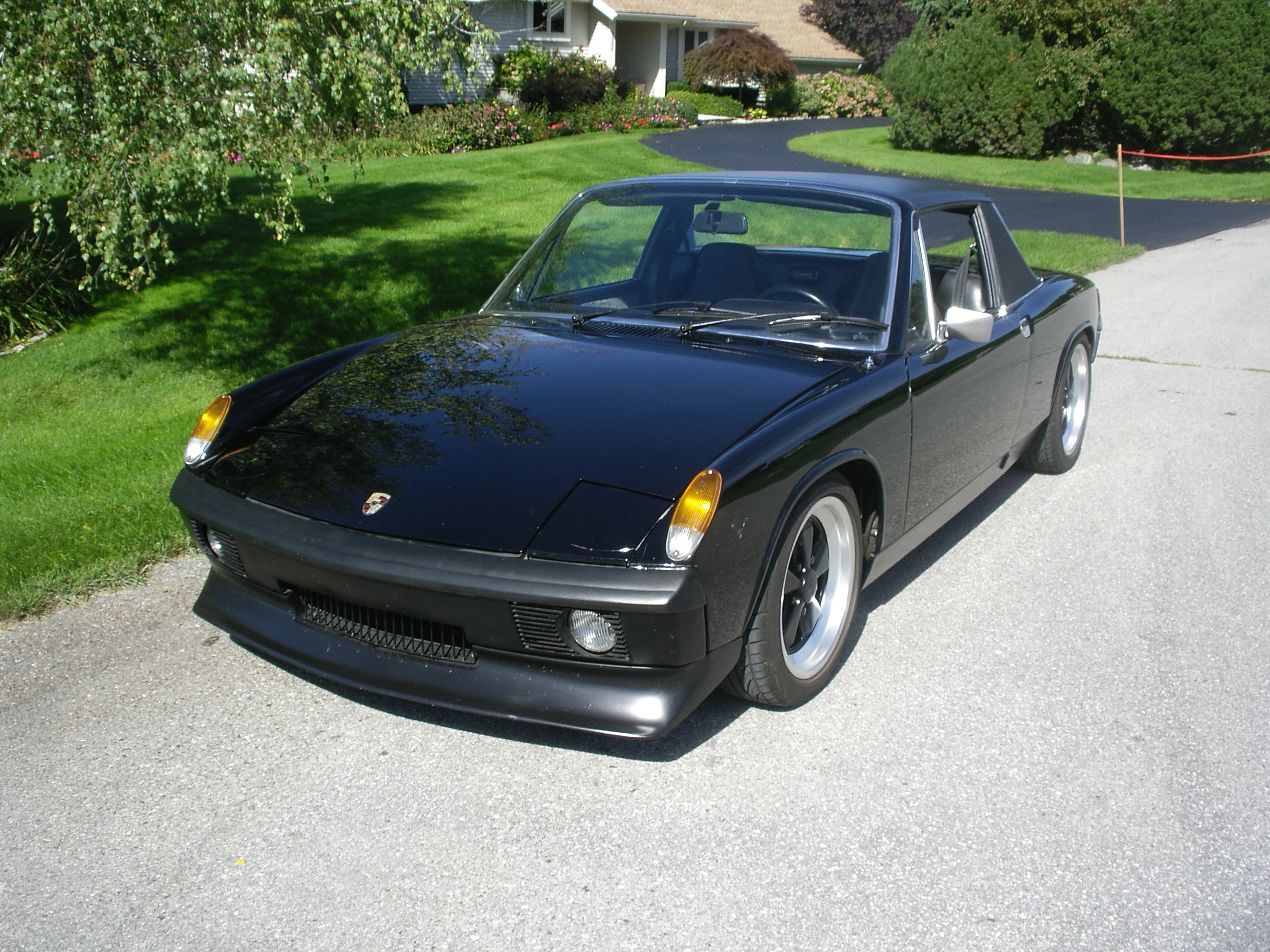

tomrev
post Oct 27 2016, 10:22 AM
Post #67
Posts: 231
Joined: 25-February 14
From: N. Mich.
Member No.: 17,037
[quote name='westtexass2k' date='Jun 14 2016, 06:57 PM' post='2359430']
Great job on the conversion. Love Honda engines. I put the S2000 motors in several cars and its my favorite engine. Currently following Micheals lead and installing F20c in my 914. I set myself a 6 week deadlne to get it done.
What brake upgrades do you have.
Sorry for my delay in response; as I had installed a 911 Carrara front suspension, it already had the big rotors, and calipers, but I swapped out the calipers for the alloy Boxster Brembo's up front, and used stock 914-4 rears, that were rebuilt, because I want to retain the parking brake. I have been driving it all Summer/Fall: it runs very well, is fast as expected, with a lot of torque, and because of the modern design, and ECU management it always runs crisp, easy starting, etc. First gear is fine for starting, but it has enough torque that second gear feels like 1st., you can pull easily away from a stop in 3rd if you want. Nailing it in 1st, it will hit the rev limiter faster than you can react to shift, so for speed runs I just launch in second. As a few guys have noticed, I am selling her; the addiction for projects is hard to shake, and garage space and $$ dictate this. With all the cool parts, and the original miles at under 21K, I hope to get around $17K. It has been a very fun project!Attached Image
