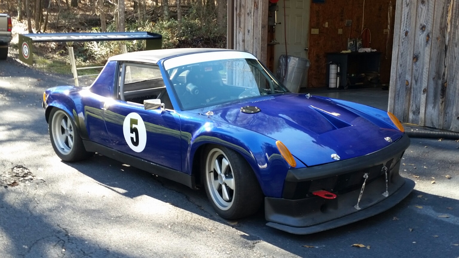

John - I'd take the subjective opinion that 17's "don't look right" with a grain of salt. To some this may be the case; to others maybe not. Nobody mentioned how the wheels "didn't look right" at the track recently and certainly didn't stop them from taking pictures of the car ALL weekend long. Performance wise, the 17"s are better choice for several reasons - no need to beat that to death. Regarding the fitment, I have AA steel flares and run the 7/9 combo. I have plenty of room but also have the flared rears. I run 245 Front & 275 Rear - no issue. Tons of room up front and I run a .5" rear spacer. All the best!
PS: The weight difference is negligible - I went fairly quick.

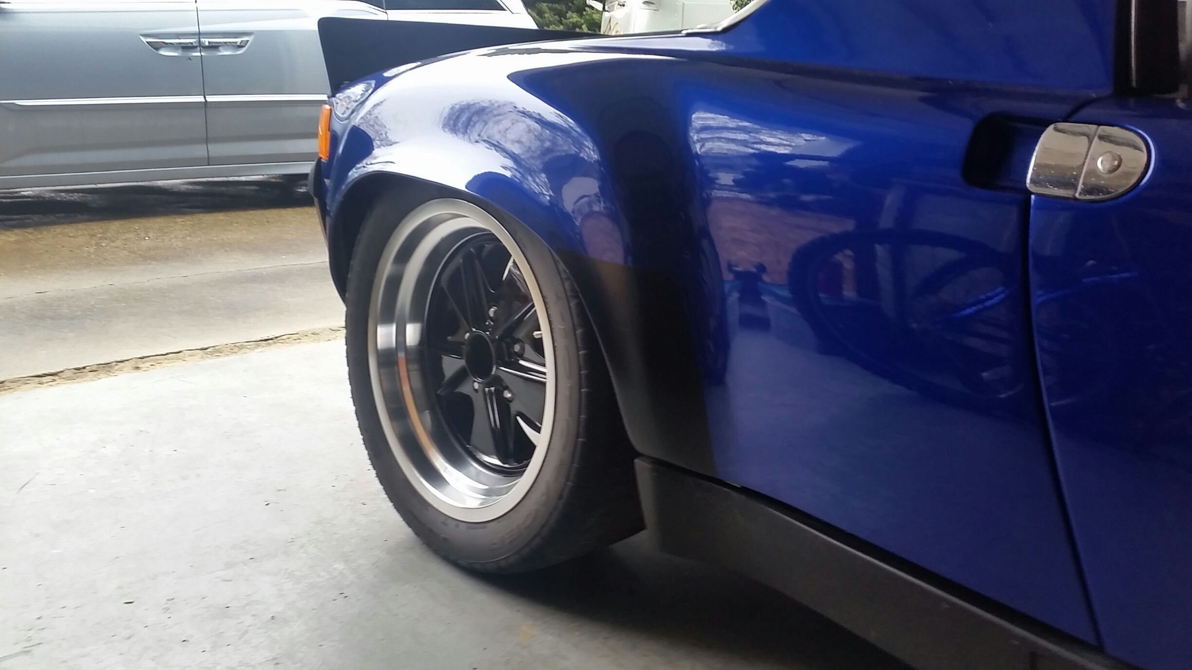

Cracker,
Your flares look different than mine, looks like the lip has been pushed out. I have stock (un-modified) GT flares and the 275 just will not fit. I would be interested in hearing what is different about yours. I need to get the tires to fit. (IMG:style_emoticons/default/smile.gif)

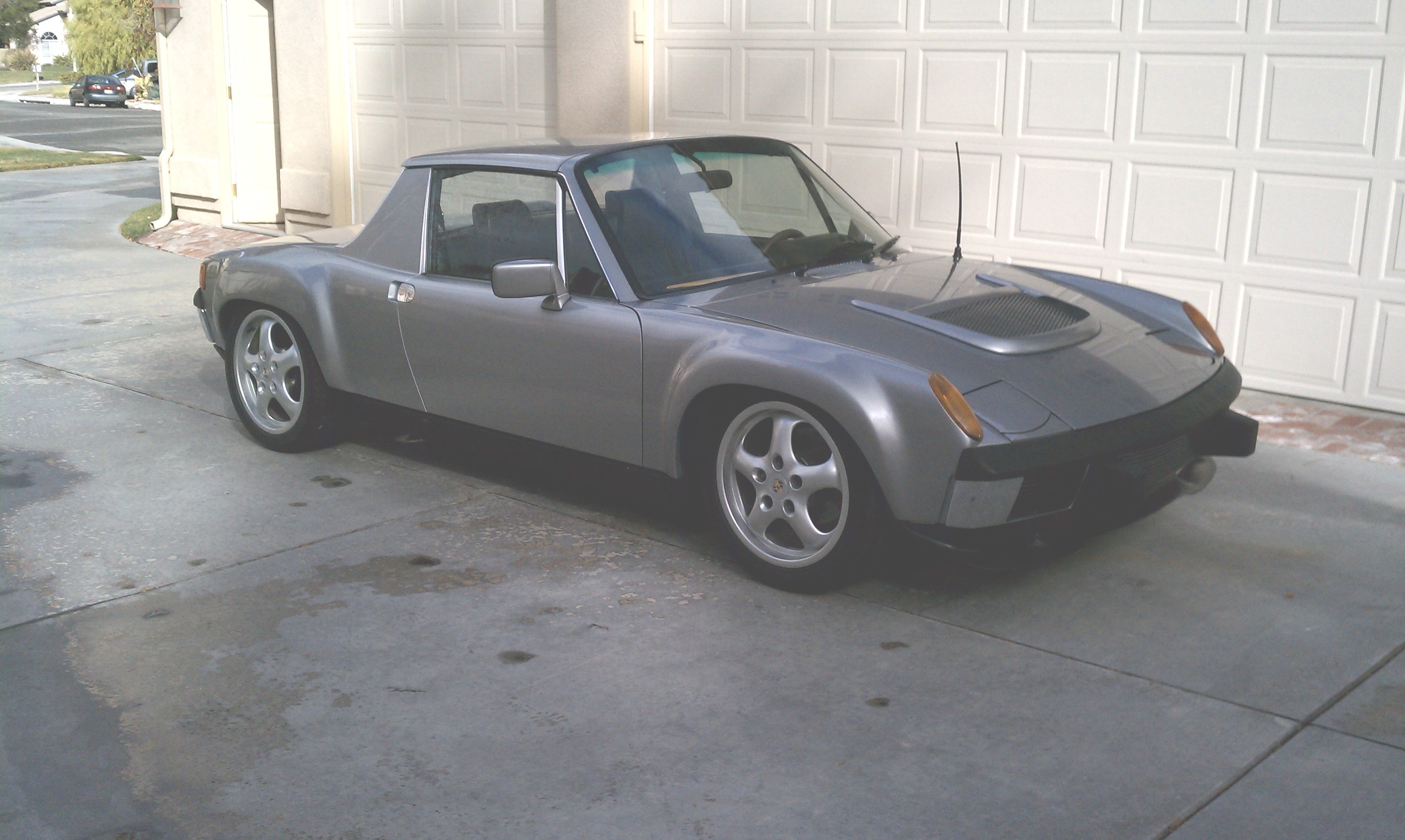

QUOTE(Series9 @ Dec 22 2015, 01:34 PM) *
The RS has 17x9 Cup IIs with 255 rubber.
We rolled the lips, but they would have fit without doing so.
I have the same wheels with 255-40's and didn't go steel flares because they didn't fit; or at least I thought so until I read your post. I went with Mitcom flares simply because they offer more room.
