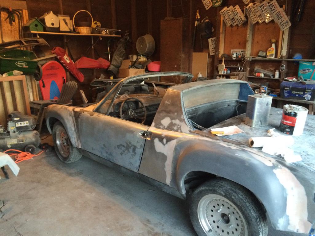

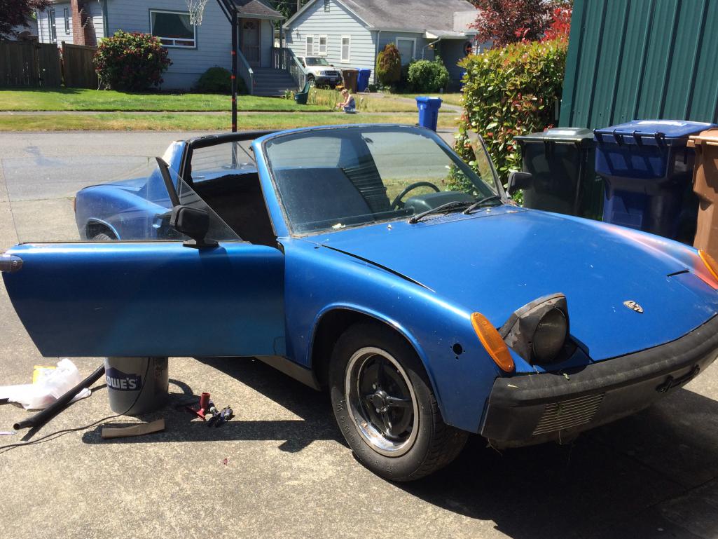

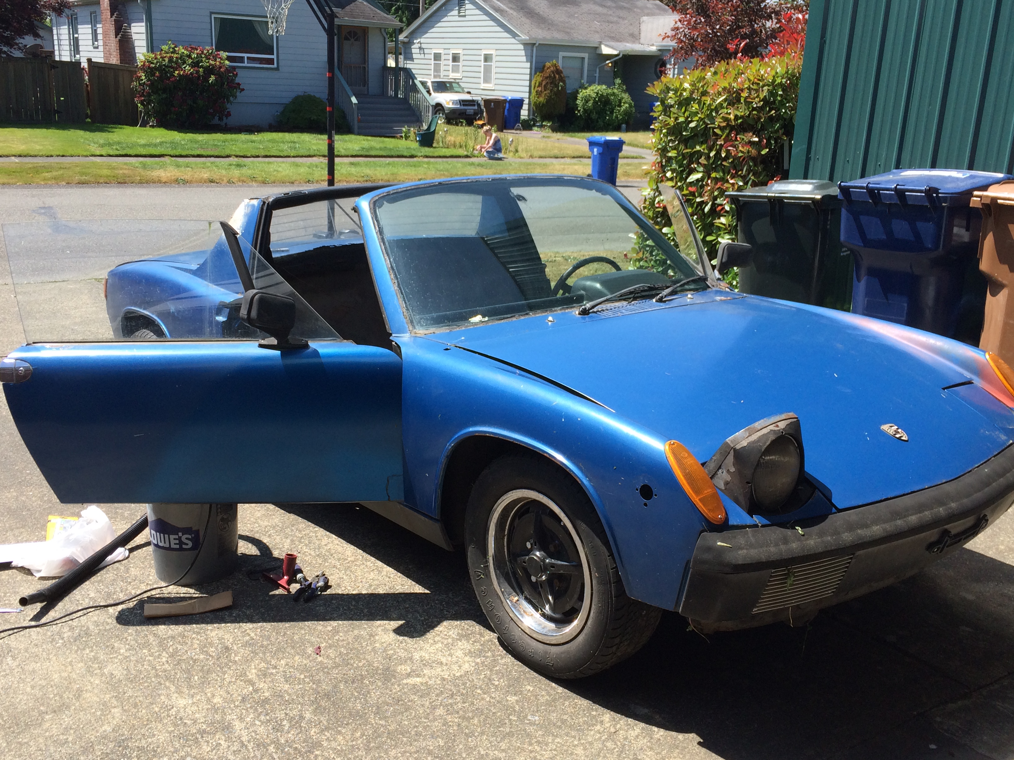

When I bought it i was told it was crip blue, this I didn't like. this picture is more of a glamour shot, someone went to town with bondo and fiberglass but on the other side. same day i bought it i began stripping down the interior, and finding rust holes (IMG:style_emoticons/default/mad.gif). From this point i began the (IMG:style_emoticons/default/sawzall-smiley.gif).

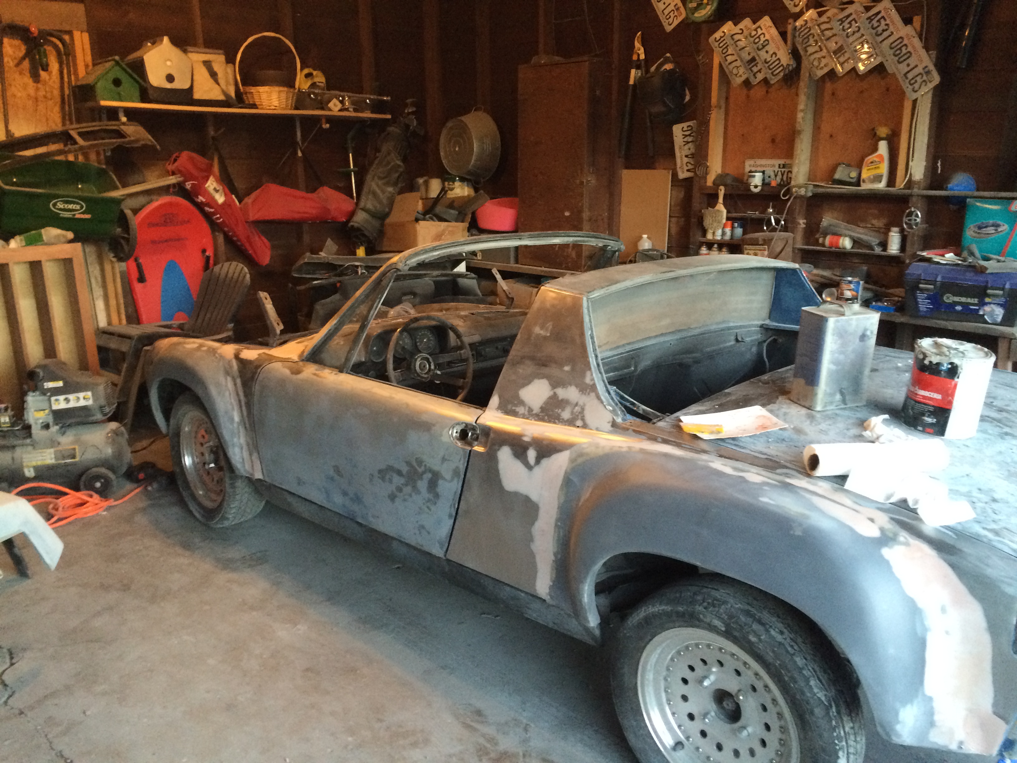

Within a month i had cut out most of the rust and got a repair panel from Pelican Parts welded it in and began sanding the car in my moms garage. Note; never sand inside EVER! it makes everything always dusty forever dont do it! Anyway i cut the fenders glassed on the flares. this part took forever but hopefully you're not as unlucky as me and find a half inch of crip bondo on your doors! (no joke)

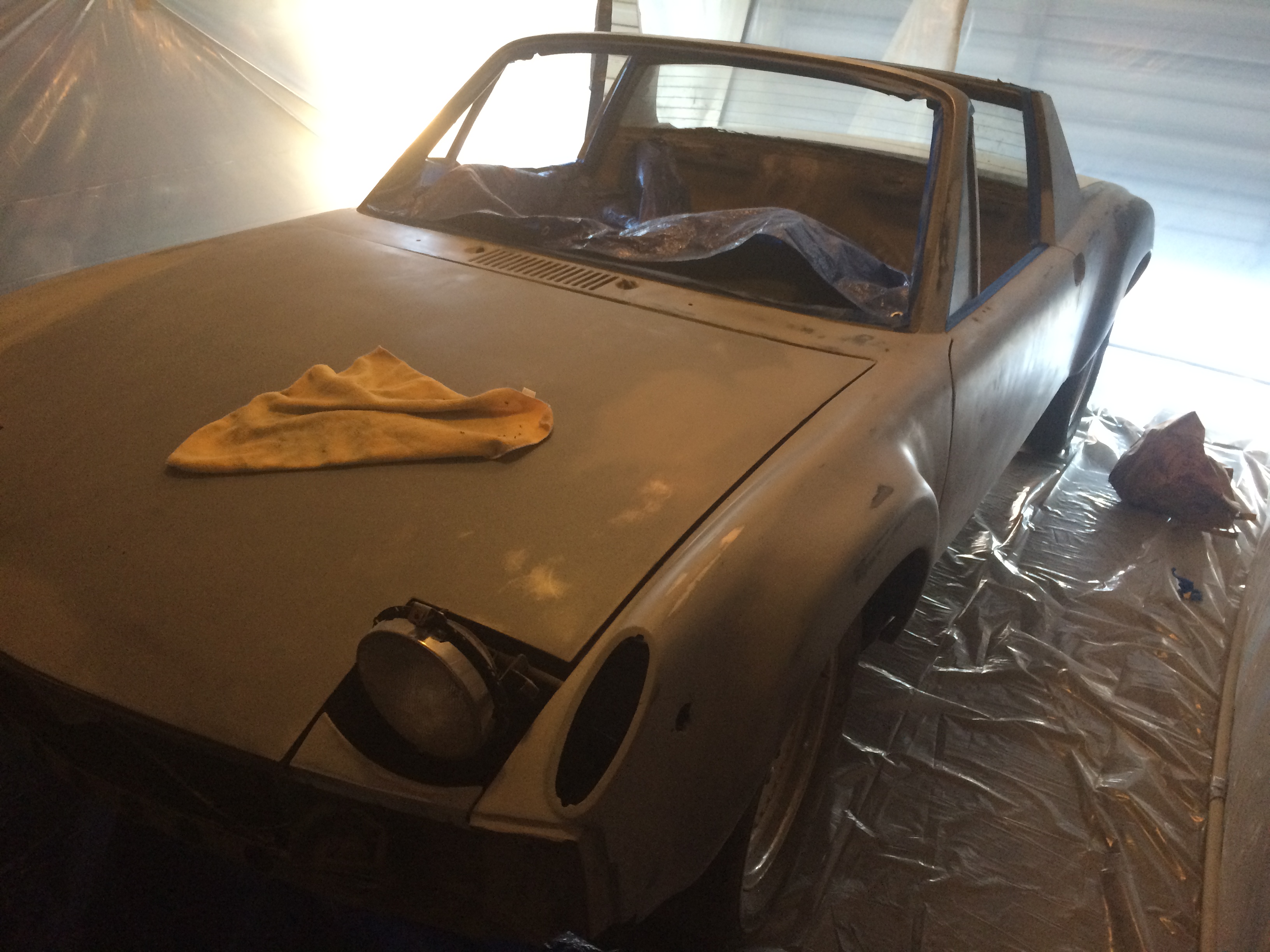

Next the painting stage. After many days of sanding and dust filling the ground and everything the light does and doesn't touch I cleaned the garage with an air compressor and a garden hose. my street was stained blue from all the dust. I decided to paint my car at home. im not the type of person to rattle can it so i built a paint booth. i put on my custom garbage gag painting suit and started laying down the orange (IMG:style_emoticons/default/smile.gif)

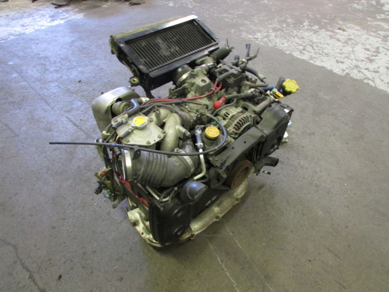

now into the good bits; the engine! I purchased an ej205 off ebay for 1200$ with only 50,000 miles. The turbo has no shaft play and is ready for boost! This engine should be enough to kick ass at autocross, track days and the street. Ive replaced the timing belt switched over the usdm stuff and is ready to be mounted to my subaru 5 speed.

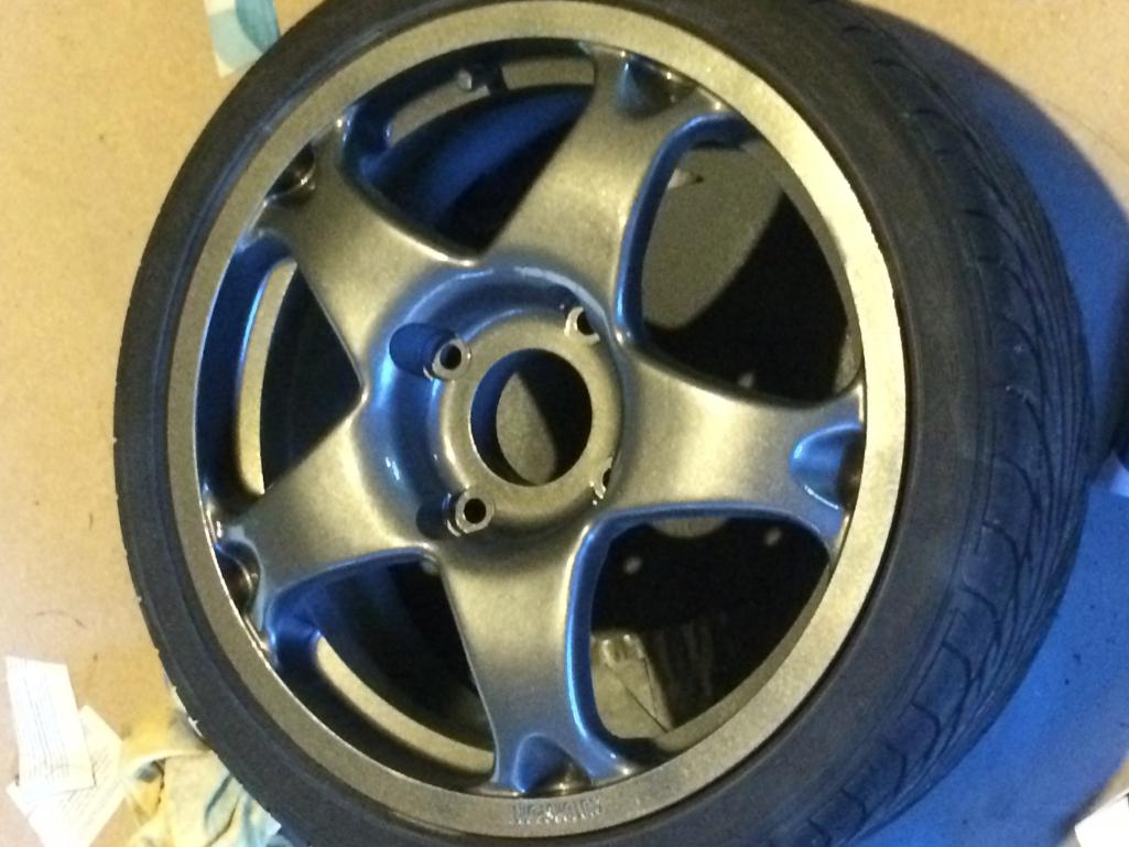

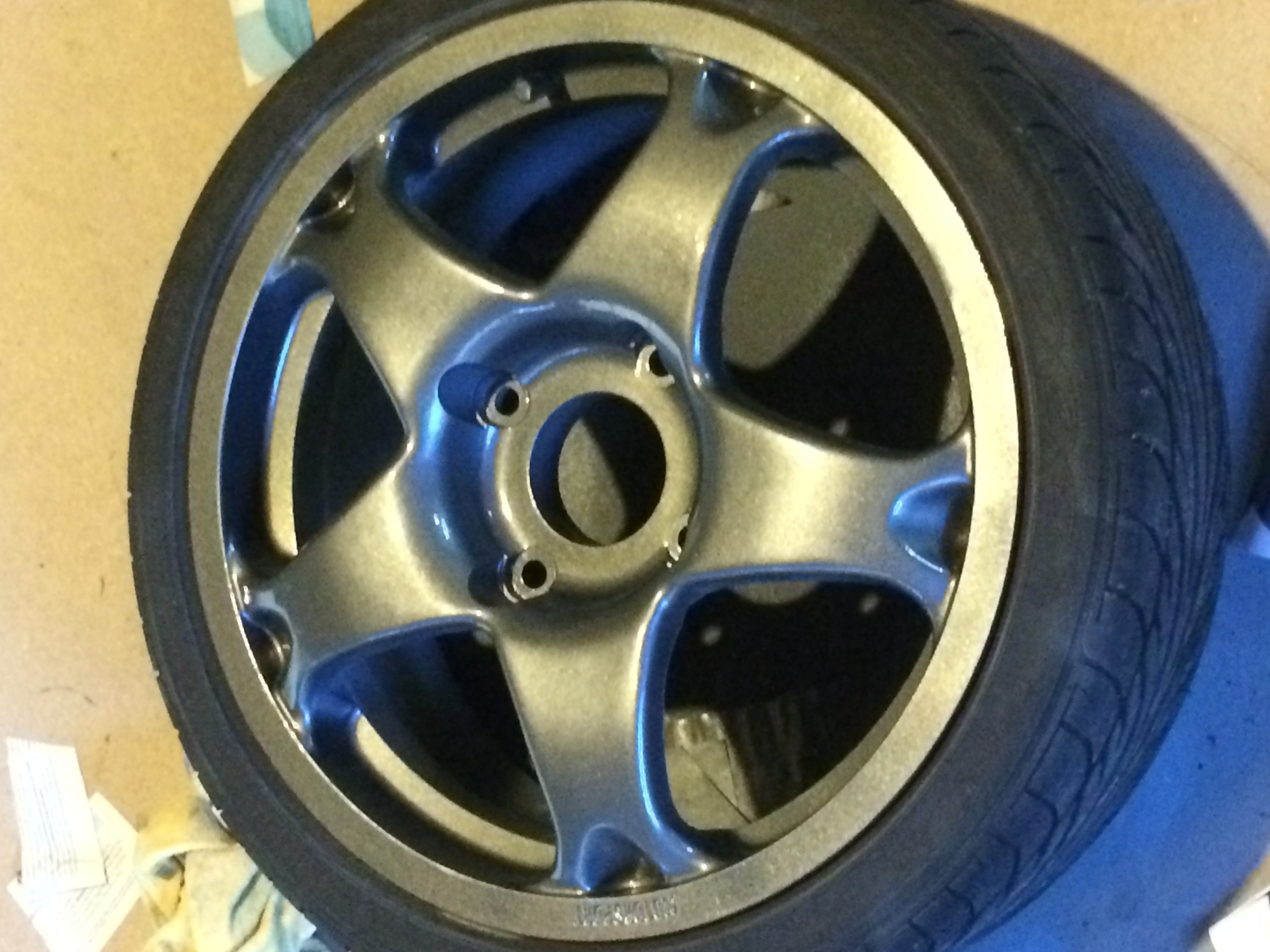

Handling: For the rear of the car I purchased bilsteins and autoX springs. All around i got 17"x7" wheels and a good set of tires for autoX. Finally on the purchased list was bmw front calipers and new front rotors. what I plan on buying is swaybars on all corners and new rear rotors.

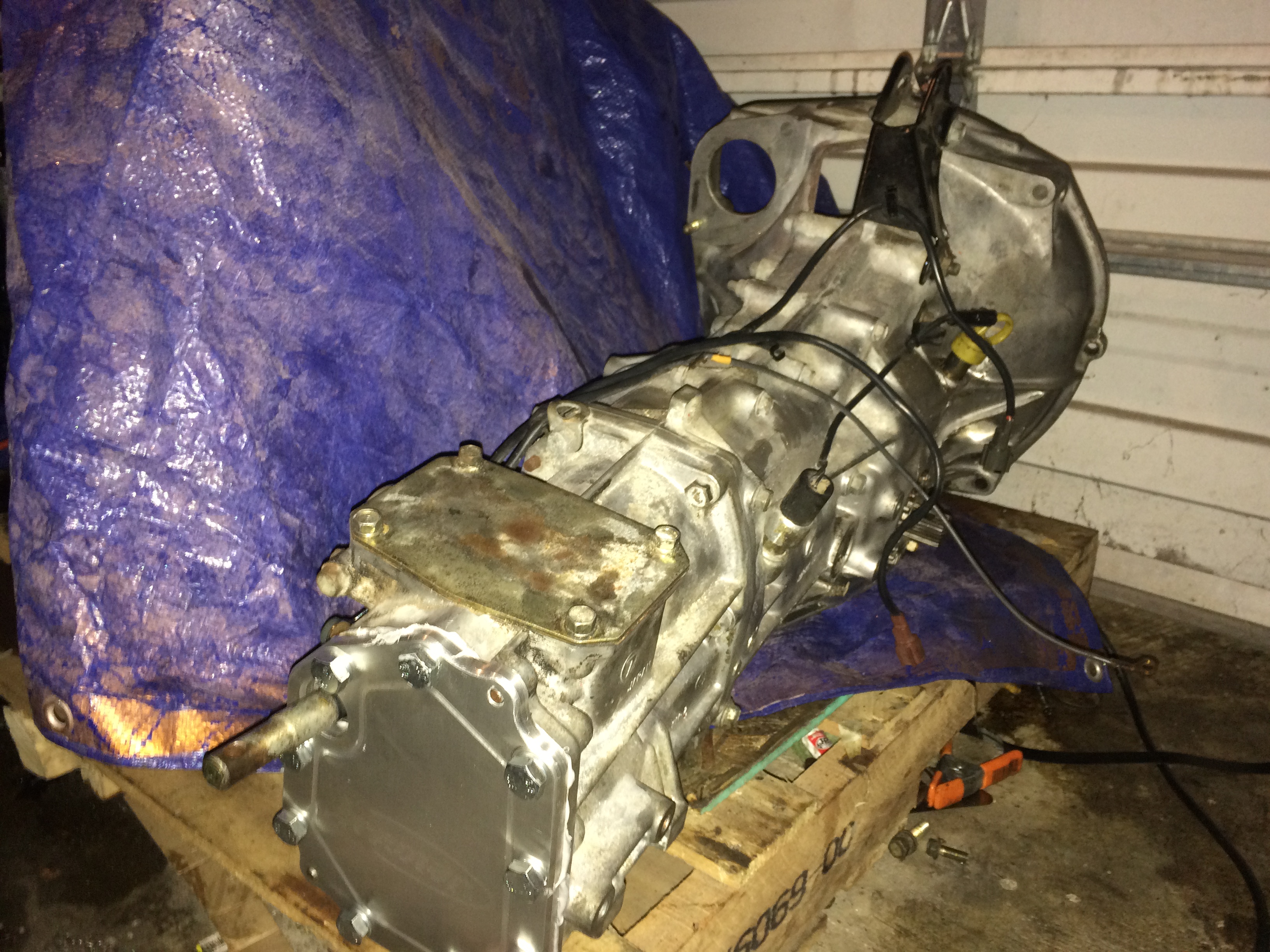

Now finally the final catch up post:Transmission I purchased a 5 speed Subaru trans from a town far away for 60 or 80$. It was of unknown condition, found in a storage locker. I strapped it into my baja bug for the most uncomfortable hour an a half ive lived (IMG:style_emoticons/default/biggrin.gif) Since then it's been sitting in my garage hasn't leaked except when its upside down (lets hope that isn't ever a problem) Yesterday i got the bremar 2wd converter yesterday and i cant wait to install it because it's pretty! (IMG:style_emoticons/default/wub.gif)

QUOTE(tazz9924 @ Jan 19 2016, 08:02 AM) *
You might want to save your money on the rear sway bar and spend it on adjustable perches for rear springs or the front sway. Since installing the shocks and springs for autocross the rear sway bar has been disconnected. Not needed with 200# springs.

Update: installed the bremar 2wd converter and it looks sexy! The 2wd swap was easy the hardest part was taking off the nut on the inside of the trans, nothing a little impact gun couldn't fix. all i need now is a clutch and throwout bearing +fork and the trans and engine can (IMG:style_emoticons/default/grouphug.gif)

What year is your transmission? I have a 1995 5mt in my conversion. I am not happy with the way it shifts. It is sloppy and the shift gates are hard to find. After a little time on the net, I discovered that pre-1998 the 5mt used an external shift return spring. I modified my coldwater 914 cable shifter to include a return spring to mimic the stock Subaru setup and I did see an improvement but it is still not great. I am now on the hunt for a replacement transmission. (IMG:style_emoticons/default/sad.gif)
76-914
post Jan 23 2016, 08:52 AM
Posts: 13,988
Joined: 23-January 09
From: Temecula, CA
Member No.: 9,964
I tossed the spring and mine shifts like a new one. I'm not using Ian's set up so it's difficult to compare. Have you checked the throw and shift gates on the tranny with the shifter disconnected? Should be crisp with definite detents.

QUOTE(A&P Mech @ Jan 23 2016, 06:20 AM) *
its a 98-99 legacy trans, don't know much about it as I picked up for $60 no metal shavings and seems to shift easy
